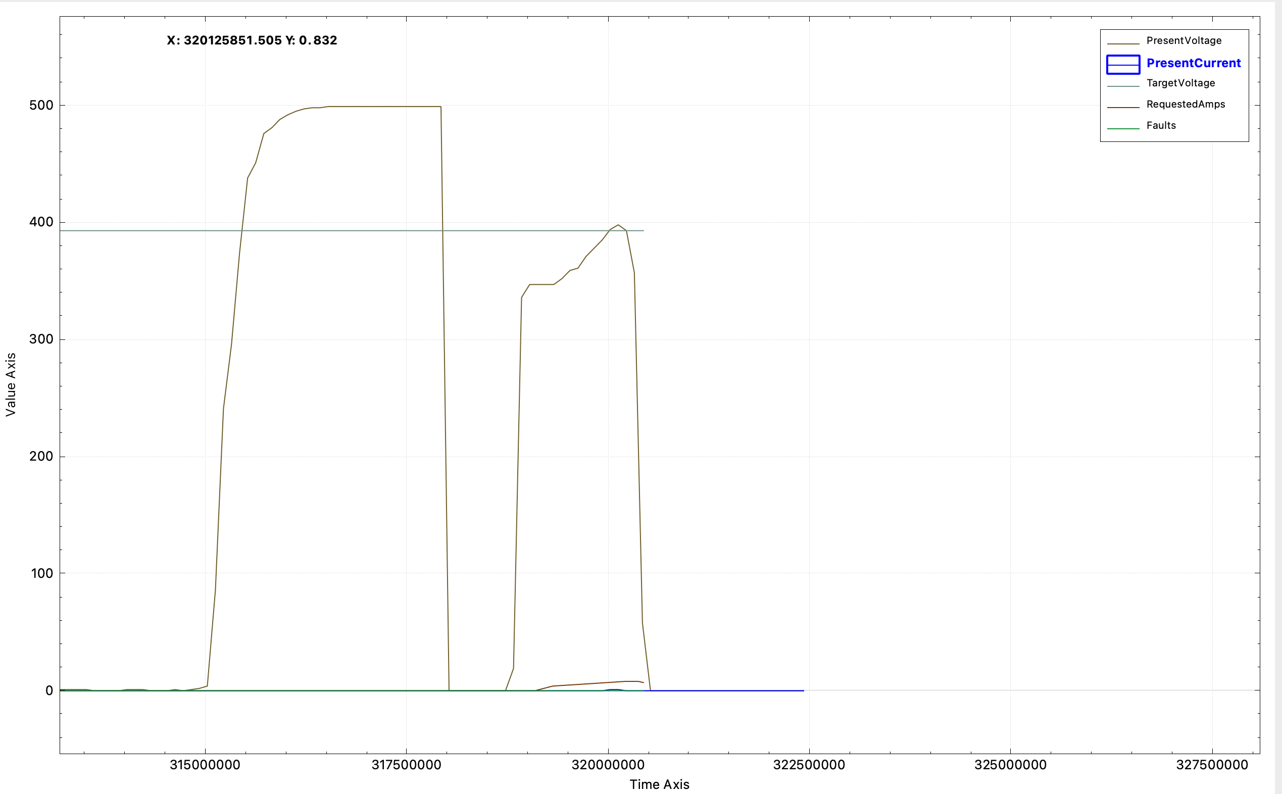

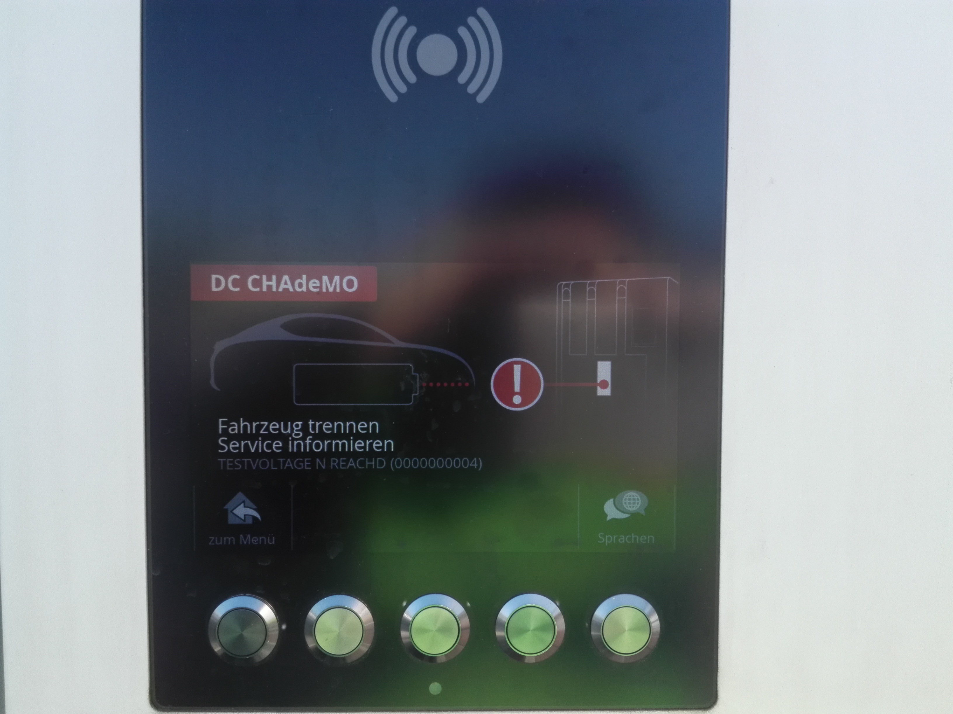

Took a bit of a trip today to test various fast chargers. At first none worked which was down to a quirk in the firmware (needs fixing in inverter firmware also!). With that fixed I tried various stations which did work but then found one that didn't. It's the same 60 kW charger that I have often used in Kirchheim but at a different location close to here.
Basically it would initiate charging including closing the vehicle relay. Now that I think of it the sound was a bit faint but I'm not sure. The environment was quite noisy. Then after quite some wait time it opened the relays again and showed attached error message "TESTVOLTAGE N REACHD (0...04)"
So then I thought I should do a CAN log. Nevermind the BMS messages also in there.
What I saw at first glance was a 135A output capability and then an increasing output voltage that creeped up 474V. Fits the error message quite well. So I wonder whether it failed to actually close the relays and then found itself charging into an open circuit.
Fast charges before and after this worked flawlessly and at full power, so I doubt it has much to do with the car.
UPDATE: just called the support hotline and apparently someone charged after me, so could be a compatibility issue.

Please take a picture of the type label on the charger for future reference next time you are there.
I would judge it as efacec ?

I've seen conditions where the voltage flys up to max if the contactors are not closed properly.
- Been thanked: 1918 times
Re: CHAdeMO fail (with CAN log)
So then that's probably what happens. Maybe they ramp up the voltage into the contactor or something stupid like that. The economizer charges up and the relay ends up not closing via just the 40 Ohm resistors.

First voltage rise and fall is called cable check. Basically verifies cable and vehicle inlet integrity.
Voltage of many converters will fly up if attempting to charge into an open circuit. Many are not exactly stable in voltage mode as they are built to be a current based device.

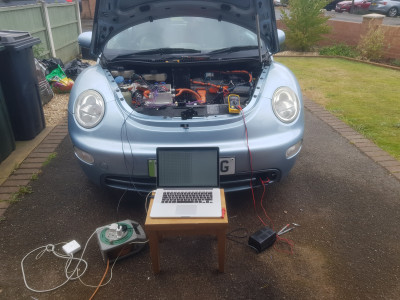

Some subjects just keep reminding you of their relevance. Plugged in poor mans charger today and as it ramped up it suddenly shut off and the fuse tripped. IGBT module blown, knowing what I know now probably because of over voltage.
So broke out rich mans charger only to see that it reported 0V on the battery side despite me hearing a clunk from below the car.
So I hooked up a lab supply to the contactor pins instead. Started out at 12V which resulted in a very tired "clunk" and no voltage on the output. At 13V I got a very rich clunk and voltage at the output. Turns out the threshold is 12.5V. At that voltage the sequencer also acts slower, leaving like 500ms between the relays as opposed to about 100ms at 13V. At 12.4V the sequencer never turns on the second relay.
A possible explanation is temperature. It is almost 40°C today so that might affect turn on voltage. I upped the 12V supply of rich mans charger to 13.8V now and it works. The relays will see about 1V less because of ULN2003 and cable run.
I wonder what would happen on a proper rapid charger today.
That must be why Nissan sequences them relays. Didn't try to record peak current yet but hold current is just 250 mA.celeron55 wrote: ↑Wed Jul 20, 2022 5:53 pm The Chademo spec, saying you're supposed to turn on two 125A 500VDC contactors on just 2 amps is very demanding in my opinion. You need very carefully chosen components to achieve it. I believe CCSKnowItAll on this forum recommended to use an auxiliary relay for Chademo to get around that particular mess.
Anyway, I think something is dodgy with my wiring. Just tested chargers in the area and just one worked. Will check tomorrow.

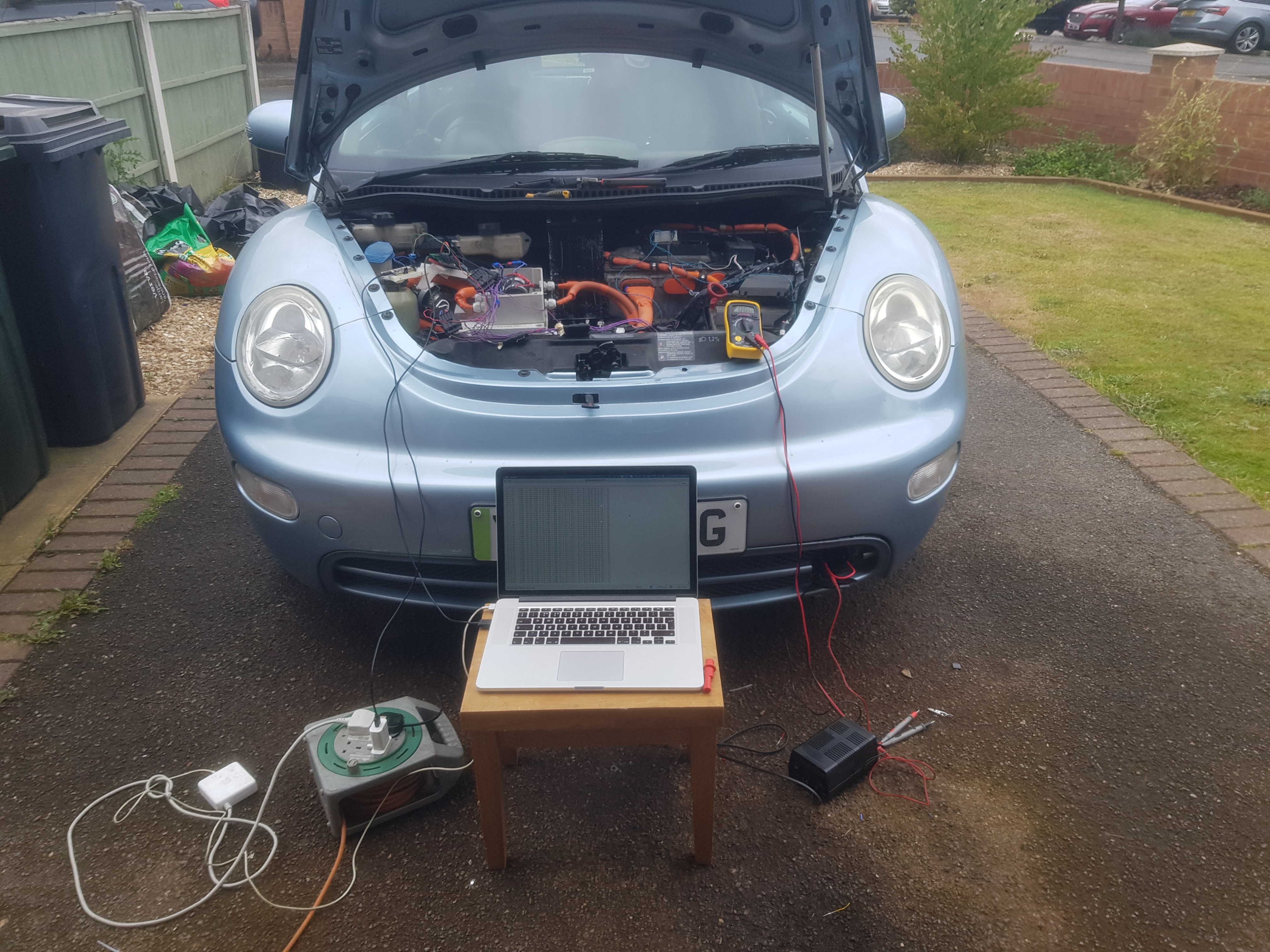

Get any where?
I've rewired so that the contactors are closed with the cars 12v and still the same issue.
Just while I debug, I have the car 12v going to the coils of the contactors and a relay, the MCU is the other side of the coil of the relay (OUT2, open drain)
The Start 1 and Start 2 from the station are just used on the MCU now, IN1 (start 1) active high, IN2 (Start 2) active low.
Happens too fast to monitor with the multimeter, but I put it across one of the contactors in continuity mode and did get a beep, but again the log looks like the contactors don't stay closed.
I had another multimeter on the socket side of the contactors and I saw the voltage climb and above my battery voltage, so it must have been the stations voltage.
Software is https://github.com/Isaac96/CHAdeMOSoftware that numerous other's have used, I've previously had a couple of successes with this setup, but no more.
Contactors stay closed with my 1.5amp 12v supply and savvycan sending out some can messages.
Pretty much out of ideas how to debug further.
I'm using exact same contactors for chademo.
Hooked it up at home again, sending can bus messages that match my voltage. Contactors stay closed. I've added code that monitors the internal switch in the contactors now, so will have that info in the log next time. Doesn't make sense, but maybe will narrow down where to look.
