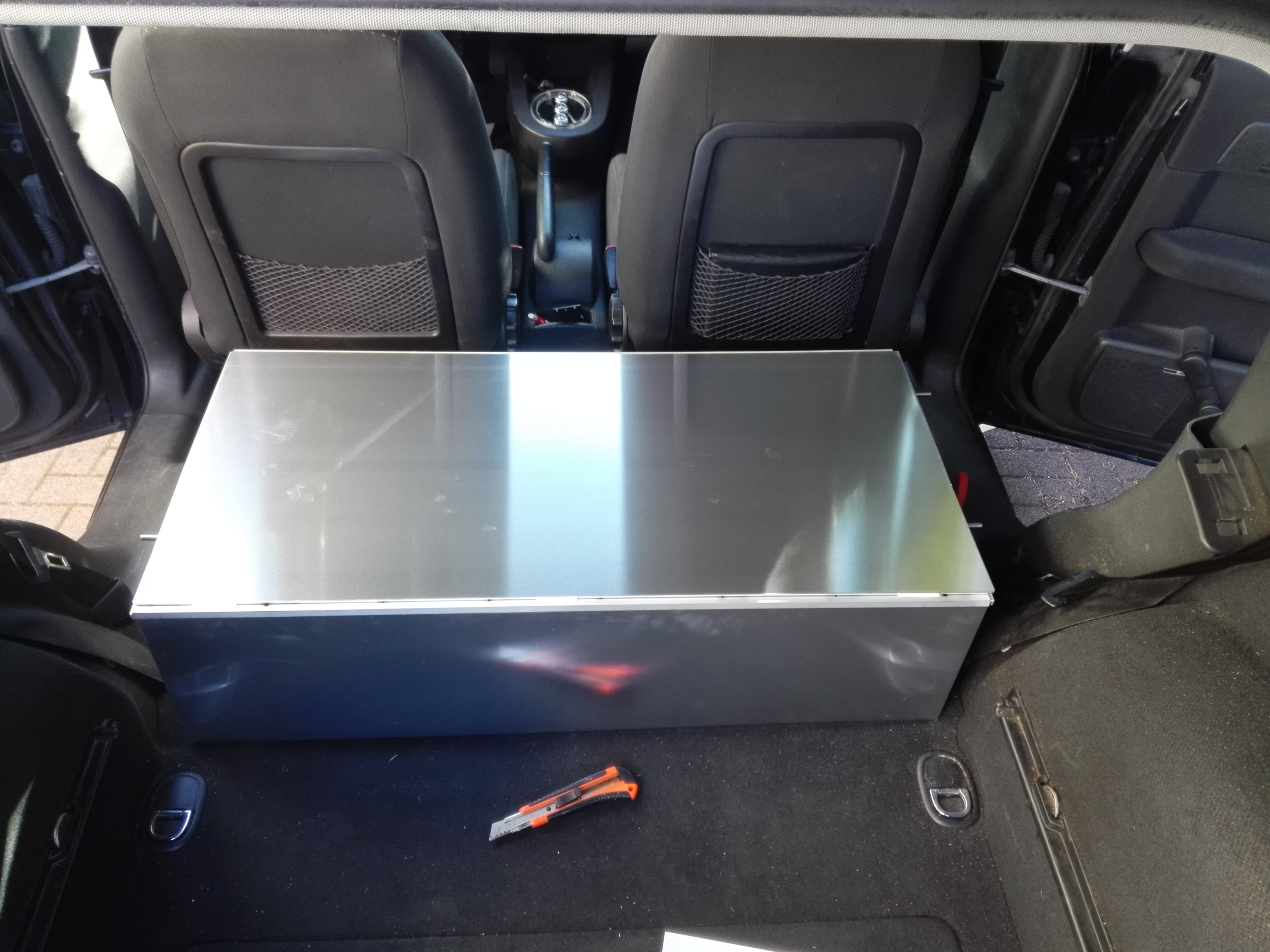

Battery box is coming along nicely. I divided the carpet, the outer parts extend to the front of the box to where they were before. The inner pat folds over contactors, fuse etc. to isolate those from the metal box
