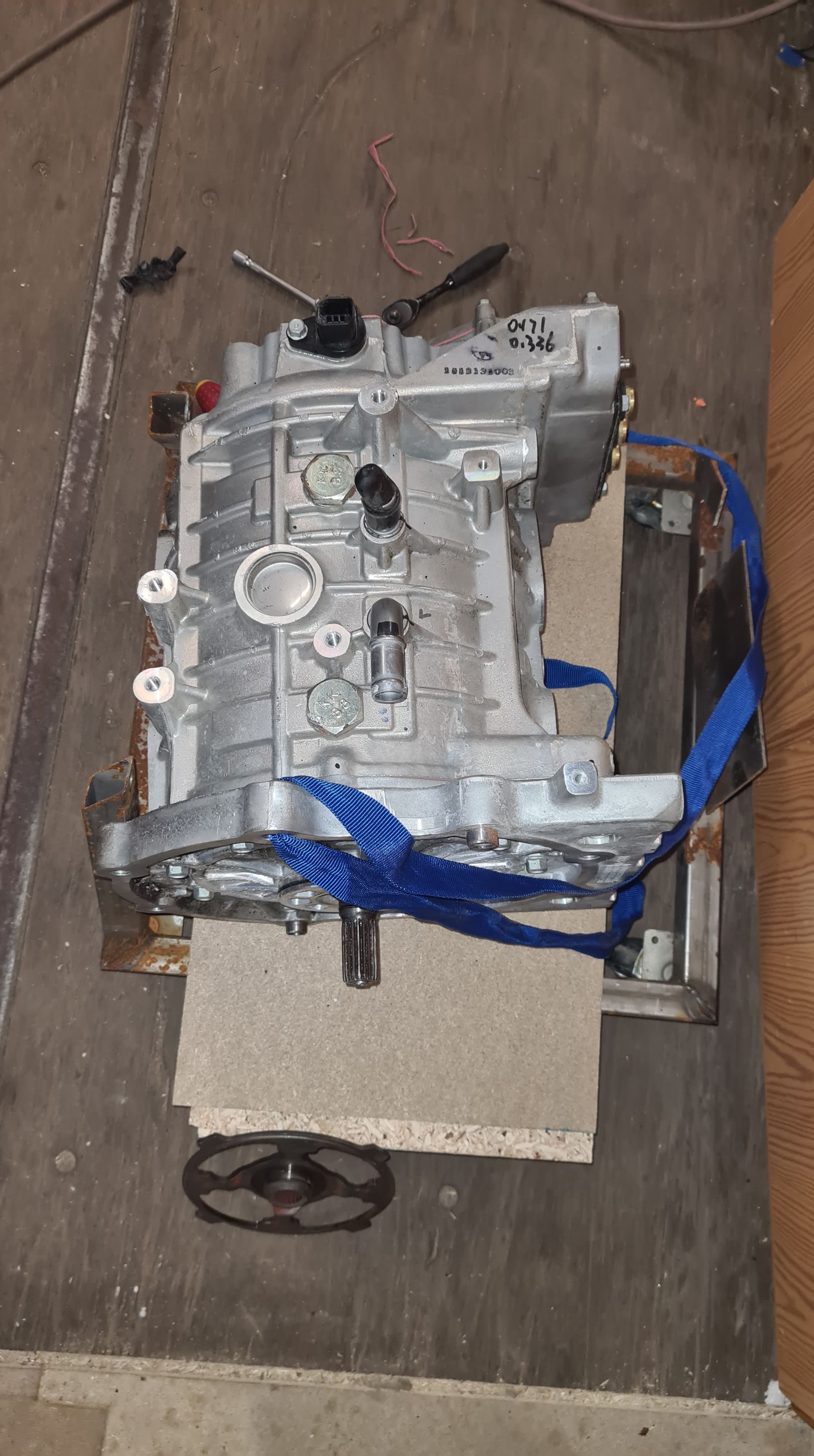

So I got my hands on a cute motor from a kia e-niro.
Its for a full electric car I think since the motor is so powerfull.
The ide i to use it with my prius gen 2 inverter, but I have to read up on how the resolver sync works in the openinverter software.

Here's some images on it, teh resolver and some data from the kia mechanic I bougth it from.

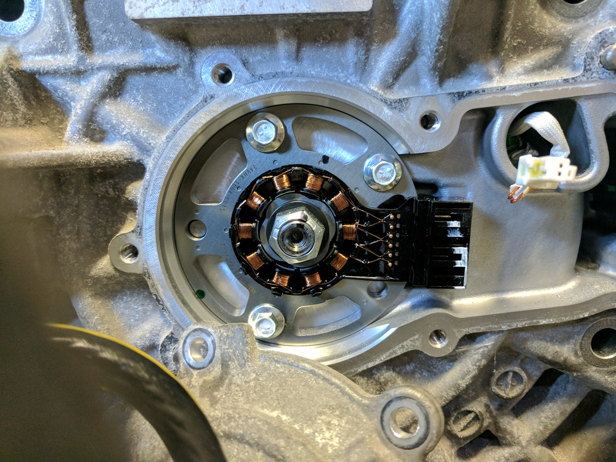

Ok,so started to prod the kia motor this evening, the resolver resistance is quite different from the prius resolver though.
the kia resolver has as follow:
-/+ 26,3 ohm
S1/S3 84,3
S2/S4 75,6 ohm
Compared to the prius p112 that has 8, 14 and 14 ohms on the winings
I guess that the -/+ is the primary winding, and the other two are cos/sin windings, it's strange that the two later differ so much, while the prius cos/sin-windings are almost spot on 14 ohm both...
The resolver is a semiteck korea OE36562700
Their homepage doesnt really disclose anything usefull.
http://eng.semiteckorea.com/products06-04/
Tomorrow Im going to feed sinewave with a function generator into the resolver and see what comes out on the cos/sin outputs on the scope...
Linda out

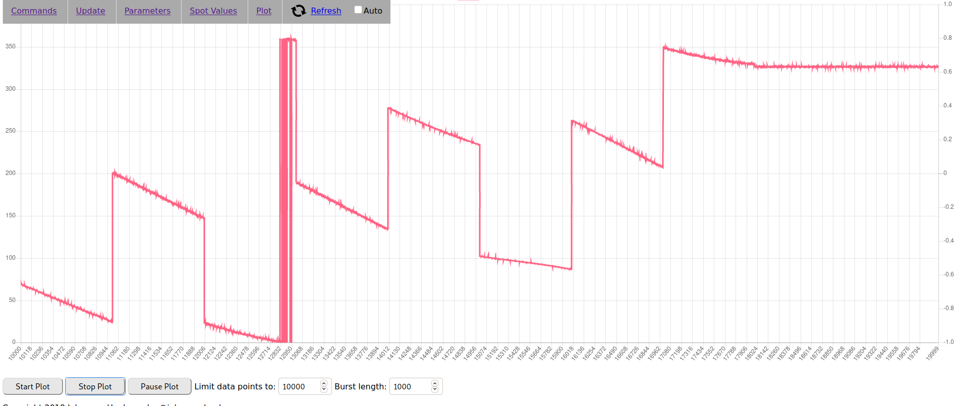

ok, been fiddling with this a few hours today, and now I get an angle from the resolver, but it seems to turn over from 365 to 0 several times in one axle revolution, and that doesnt seem right?
I tried incresaing the "respolepairs" to 4 and then it goes down to 365 degrees per 90 degree turning on the axle.
If i try to set "respolepairs" to anything higher than 4 i dont sem to get an angel at all strangley, 8 or 16 on should give 365 degrees on one axle revolution.
or is there any other scaling parameter for the resolver?
/Linda
/Linda
Re: Kia E-niro 100/150kW motor
The angle refers to the electrical angle, not the mechanical angle of the axle. Thus, it is possible and maybe also expected that there are multiple electrical rotations for each mechanical rotation. Based on the image of the resolver, respolepairs=2 should be correct.linda.ljungdahl wrote: ↑Sat Aug 13, 2022 8:16 pm ok, been fiddling with this a few hours today, and now I get an angle from the resolver, but it seems to turn over from 365 to 0 several times in one axle revolution, and that doesnt seem right?
- bexander
- Posts: 883
- Has thanked: 75 times
- Been thanked: 98 times
Are you sure? The Leaf motor uses a four lobe resolver and usually respolepairs=4 is used?LeonB wrote: ↑Sun Aug 14, 2022 1:30 pm The angle refers to the electrical angle, not the mechanical angle of the axle. Thus, it is possible and maybe also expected that there are multiple electrical rotations for each mechanical rotation. Based on the image of the resolver, respolepairs=2 should be correct.
https://openinverter.org/parameters/view.html?id=10
I’m sorry, I got that mixed up with the 2-pole pair prius resolver – yes, the Kia motor uses a 4 pole pair resolver.

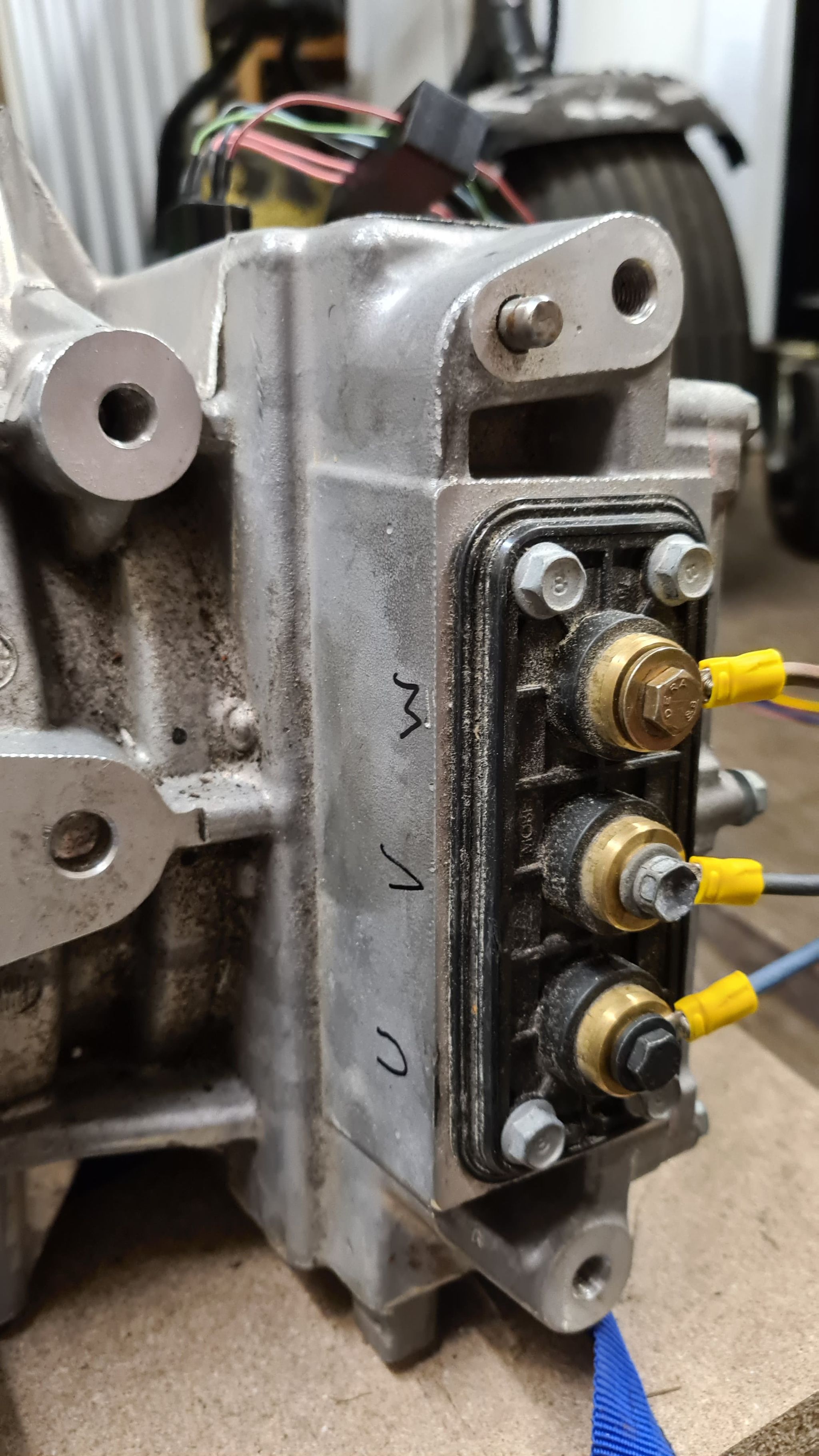

kia was kind enough to actually press the phase letters into the plastics of the connection block,but here are som images:

That is sorted by setting pinswap=5linda.ljungdahl wrote: ↑Mon Aug 15, 2022 12:09 pm Also, are there any simple way of telling which phase on the motor is which according to the resolver, or is it just trial and error?
