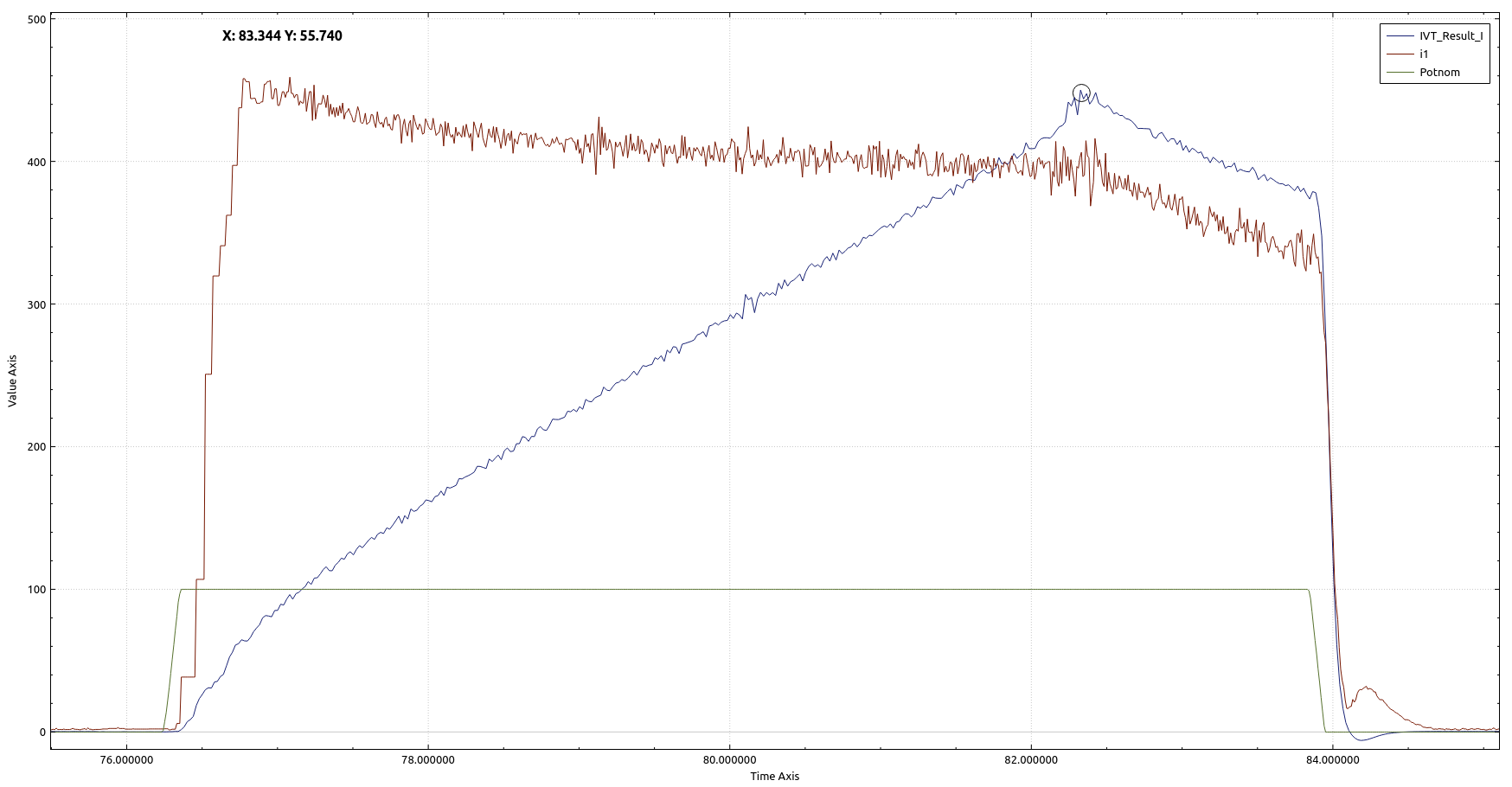

One more test, this time allowing myself 450A. This is probably the final one as I don't want to push my car any harder for now.
Pack voltage: 310V
fslipmax: 3
boost: 2800
fweak: 250
AC current: 440A falling to 390A
DC Current: 0A rising to 440A
Temperature: 26C rising to 57C
0-60: 6.2s
Two important things to note about this configuration:
1) This is based on a very specific battery voltage: 310V, falling to 295V at peak power draw. Running it at other voltages may cause problems. It would probably be worth re-calibrating with udcnom configured.
2) fslipconstmax is set to 3. This means that power falls off above 60mph. Personally that works for me, but anyone who wants to push top speeds would want to configure fslipconstmax higher (between 4 and 6).

Small update, after driving for a while I got irritated with variations in battery voltage (state of charge) causing big changes in performance, so I've now re-tuned with udcnom set. The results are essentially identical to the previous ones but hopefully they are now more consistent.
udcnom: 300 (300V nominal battery voltage, 80 series cells)
boost: 2900 (this is adjusted to give a mostly flat current curve from 0rpm)
fweak: 250 (this vaue has the most impact and ends up setting the peak DC current)
fslipmax: 3 (not proven but this low value seems more efficient)
idcmax: 600 (I'm tuning for 450A peak, but I set this a little higher so that I can tune up to that level without bouncing off the limiter)
0-60: 6.75s
AC current: 420A to 386A
DC current: 0A to 430A
Inverter temperature: 23C to 50C
I plan to squeeze a little more out of it and finish bringing the peak currents up to my ideal of 450A but this isn't far off.
I also spent some time playing with idckp to see if I could make use of the DC current limiter rather than avoiding it. Unfortunately I was not able to achieve smooth results with this, so I will instead persist with avoiding the limits.

I'm sure this thread is getting boring now, but I have more more configuration. Building on the previous configuration, I have increased boost to 3200. This increases the startup current to 450A and increases acceleration but doesn't have much impact on peak DC current. Both now peak at 450A (my self imposed limit).
udcnom: 300
boost: 3200
fweak: 250
fslipmax: 3
idcmax: 600
0-60: 6.1s
AC current: 450A to 390A
DC current: 0A to 450A
Inverter temperature: 28C to 64C
Not too much more testing to do on this now, but I might repeat with identical current and fslipmax=3.5 to see if this has a positive or negative impact.

I wanted to test fslipmax=3.5 for curiosity to see if I did the right thing by bringing it down as low as 3.0. The short answer is that 3.5 is inferior and I don't recommend this configuration, but posting it here for completeness.
fslipmax=3.5
boost=2500
fweak=280
0-60: 7.4s
AC current: 410A to 400A (very consistent)
DC Current: 0 to 400A (it still peaks at 450A but not until after speed exceed 60mh)
Inverter temperature: 29C to 82C (!!!)
So consistent with previous tests, a higher value of slip causes quite a lot more heating of the inverter for similar current draw, and a sight reduction in performance.
It's worth mentioning at this point that a value of slip even lower then 3.0 *might* allow for even greater performance. Conventional wisdom is that inducton motors are more efficient at lower slip. Lower slip mean that more voltage, and hence more power can be delivered while keeping current (and hence heating) lower. However I don't really recommend this. When I tried to run fslip=2.5 I tripped my overcurrent limit. My suspicion is when when ramping the voltages that high, slip control is not sufficiently accurate to keep current stable.

Post by catphish »
Peter wrote: Sat Aug 13, 2022 6:43 pm Hi Charlie. Try a different version of the software, it would be a quick and easy test and may show up a difference.
I am wondering why your temp is rising so much, even on an a fast run around with lots of stop starts and fast acceleration the highest I see for Inverter is 55 - 60 C, this drops very quickly once I back off and drive like a pensioner :-)
You could purchase some stick on temperature indicators to see if things are ok too. https://uk.rs-online.com/web/p/temperat ... ls/7799779
Another reason I am thinking about the temperature issue you have is because my cooling system (not trying to rub salt in your wounds, ok) only uses a 13 row oil cooler, approx 30cm x 15cm with a couple of 90mm dia electric fans. Coolant for inverter and Tesla heat exchanger are in parallel. I dont heat or cool my batteries so they do not affect temps.
If its worth a thought ..... On my first EV attempt using an Enova motor and Damiens first issue of control board (I was the guinea pig I think :-)) I noted that varying pwm frequency made inverter temp rise very quickly and to a much higher value.
The problem isn't the long term temperature, it's the huge spikes that occur *during* acceleration. The temperature can rise by 40C or 50C in less than 5 seconds under full acceleration, and then it falls just as quickly when you let off the throttle. While perhaps this could be helped by better coolant flow, this level of temperature rise is much too fast to be related to the radiator setup.
I'm resisting trying a different version of the software unless I know it will help, because flashing my inverter isn't too easy. I'd need to fully disconnect the high voltage, which is a bit of a pain.
What PWM frequency are you using? I'd love to know if it's not 17kHz! Reducing to 8kHz should substantially reduce heating, but I'm scared to change this setting.

Hi Charlie. Sorry, I dont know the frequency on the version I have, factory default from Johannes I guess :-)
Only relevant data I can see is..
pwmfunc 0
pwmgain 100
pwmofs 0
I dont suppose your rapid temp rise could be due to coolant surging and starving the pump when accelerating ? Does the temp then fall back with a steady throttle ?
