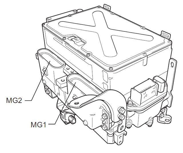

Note that the service manual is not correct for a RHD regarding MG1 and 2 outputs. Neither is the picture you posted.
MG1 is on the left (RHD inverter).
MG2 is on the right (RHD inverter).
As evidenced by the OEM cables, the one labelled "MG2 RHD" has a longer rubber sleeve, it is intended to run past the MG1 connector.
Note that it may all be the other way around on a LHD inverter.
Another way to check is to look inside at the IGBT arrays, each MG2 phase should have 2 pairs of IGBTs, each MG1 phase should have one pair. See here, page 14: https://www.osti.gov/servlets/purl/928684
You can find which is which using a multimeter. Or by connecting the resolvers and spinning the input shaft by hand while holding the output shaft stationary. The motor which reads rpm is MG1.

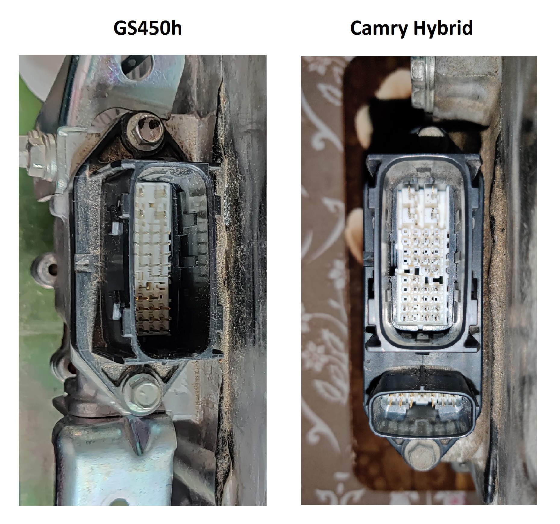

Indeed, there was a problem with resolver connections but not with noise or signal quality.
Problem was again with documentation, I wired resolvers according to Camry documentation using inverter's external connector (keep in mind Camry inverter has this dedicated 13 pin connector for resolvers unlike GS450h). All of GXX(X) signals for Generator (MG1) and all MXX(X) signals for Motor (MG2). Turns out that does not work, in this configuration MG1 was matched wih MG2 resolver and vice versa. I was able to spin motors but reported positions were not accurate therefore I was getting rattling noise and stalling (great catch Damien!).
Fix was very easy, just swapped resolver cables at the transmission end and I get silky smooth response from motors! They now seem extremely powerful, spin up super fast and without an effort. Amazing!
However, again I have a problem getting DRIVE and REVERSE working properly
I modified code to control each motor independently in an effort to isolate the problem and I found out I can only get good results by applying negative torque for MG1 and positive torque for MG2. When I reverse torque: positive foe MG1 and negative for MG2 they turn very slooooowly and do not produce much torque. I do not judge speed by simply looking at the shafts but I can tell by noise and RPMs reported by inverter based on feedback from resolvers.
Something is definitely not right.
I do not really trust pinouts for the resolvers from documentation I have. I know that I have excitation connected properly but I wonder if there could be an issue with polarity of Sin and Cos signals. I am going to open up inverter again and trance/verify connections back to internal control board based on xp677 diagram.

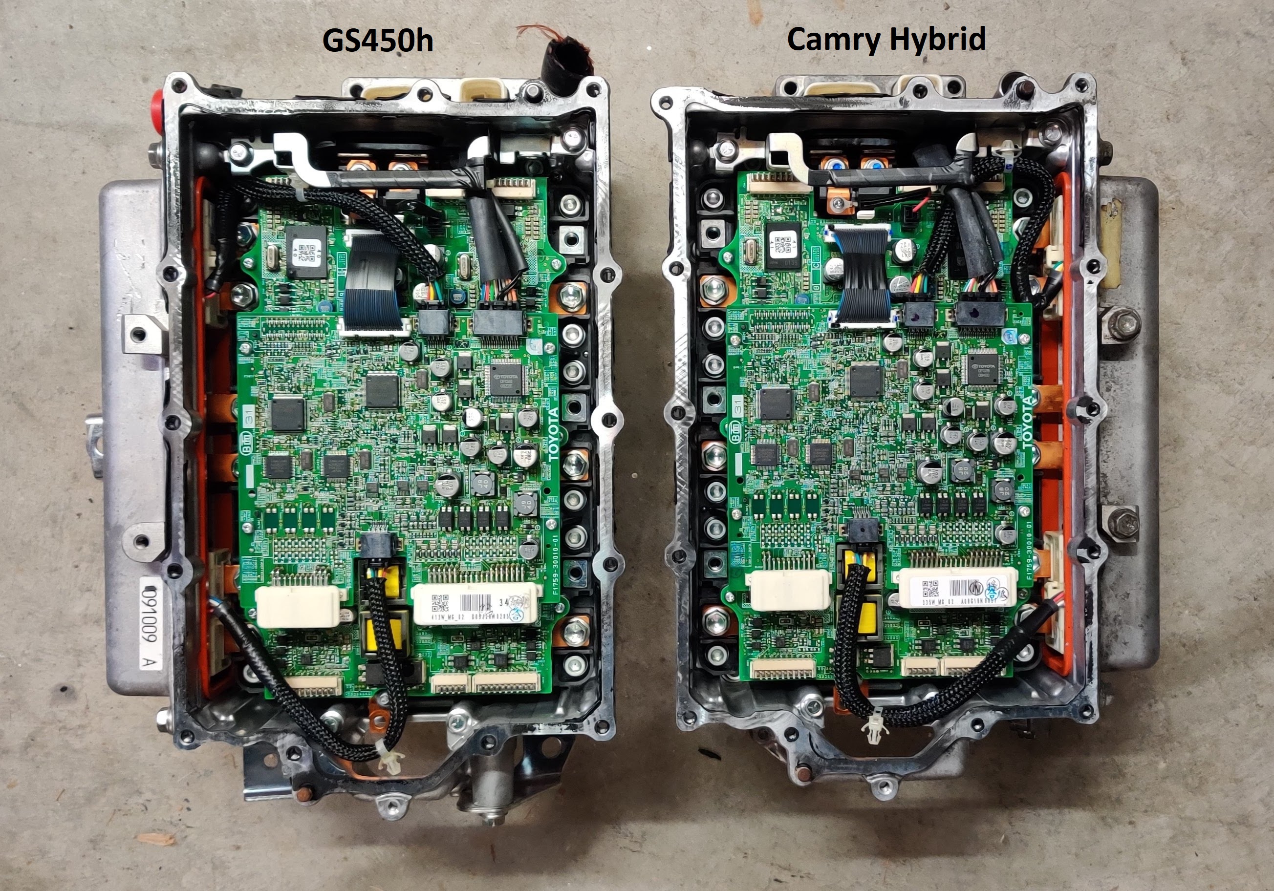

Also, I have purchased GS450h inverter which I will be getting in a few days. This way we will be working with the same components.
So, thanks again for your help. I will not trouble you for few days until I am done with my homework

I have just received GS450h inverter and want to report results as soon as possible.
I simply swapped Camry inverter with GS450h.
All other components and wiring remained unchanged from my previous setup.
Quick testing revealed that entire system (now with GS450h inverter) works as expected and reported by xp677 and Damien.
I can successfully spin up motors in both DRIVE and REVERSE modes using latest code posted by Damien.
This is both good and little bad news.
Good because I was able to get it working.
Bad because it became apparent that controlling of Camry's is limited (both motors spin reliably in one direction only).
Either there is something wrong with my inverter (I doubt that) or because Toyota changed something in serial protocol
I do not have means to investigate it further.
Anyways, for now I am going to stick to GS450h inverter to avoid distractions.
Hopefully at some point in the future we will have resources to figure it out.
Here is few comparison pictures of both inverters.
- Posts: 440
- Location: UK
- Been thanked: 15 times
Re: Communicating with the Lexus GS450h Inverter/Converter
Interesting. Many try swapping the control boards between them, if you dare.
Also perhaps have a look at comparing the MTH data.
The issue may be a compatibility issue between the inverter unit and the transmission, I can't think how, perhaps there are slight variations.
There are quite a lot of unpopulated components around the resolver interface ICs on the GS board, what does the Camry one look like?
