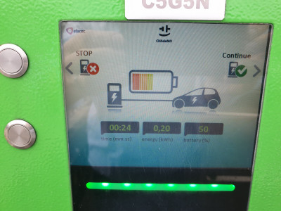

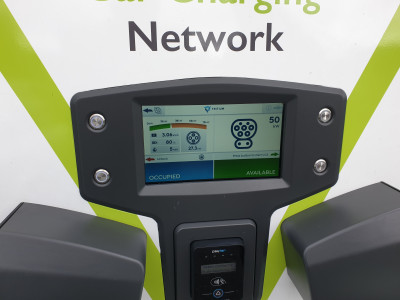

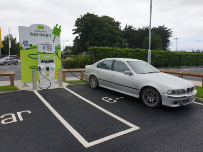

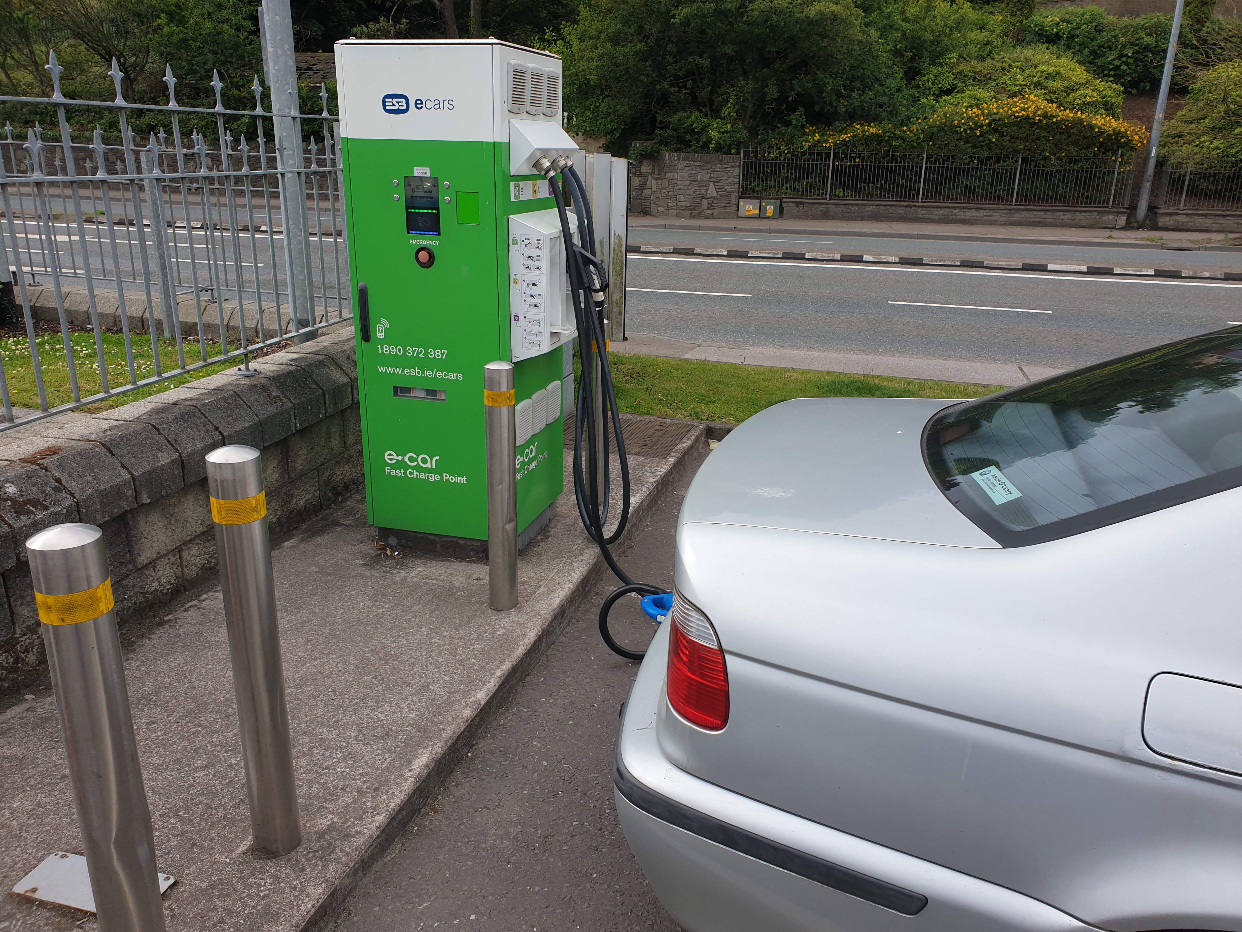

Testing of the integrated Chademo dc fast charge continues with now 3 brands of station working perfectly.

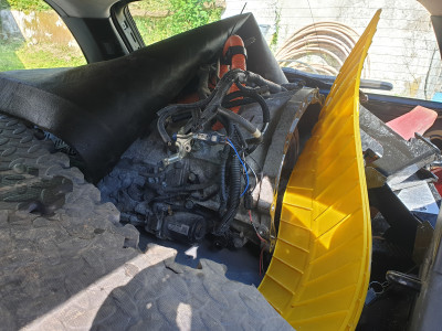

Its hiding in there:) 334 miles, 5 hours of blood sweat and some tears, 7 ccs fast charges and we have a GS450h system ready for bench testing....now if I just had a bench....

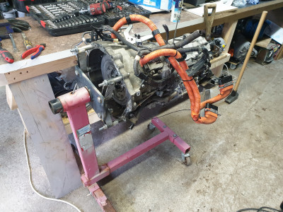

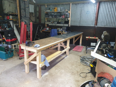

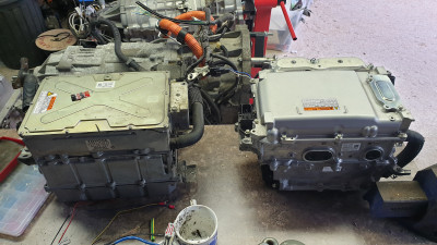

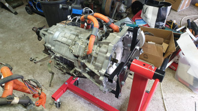

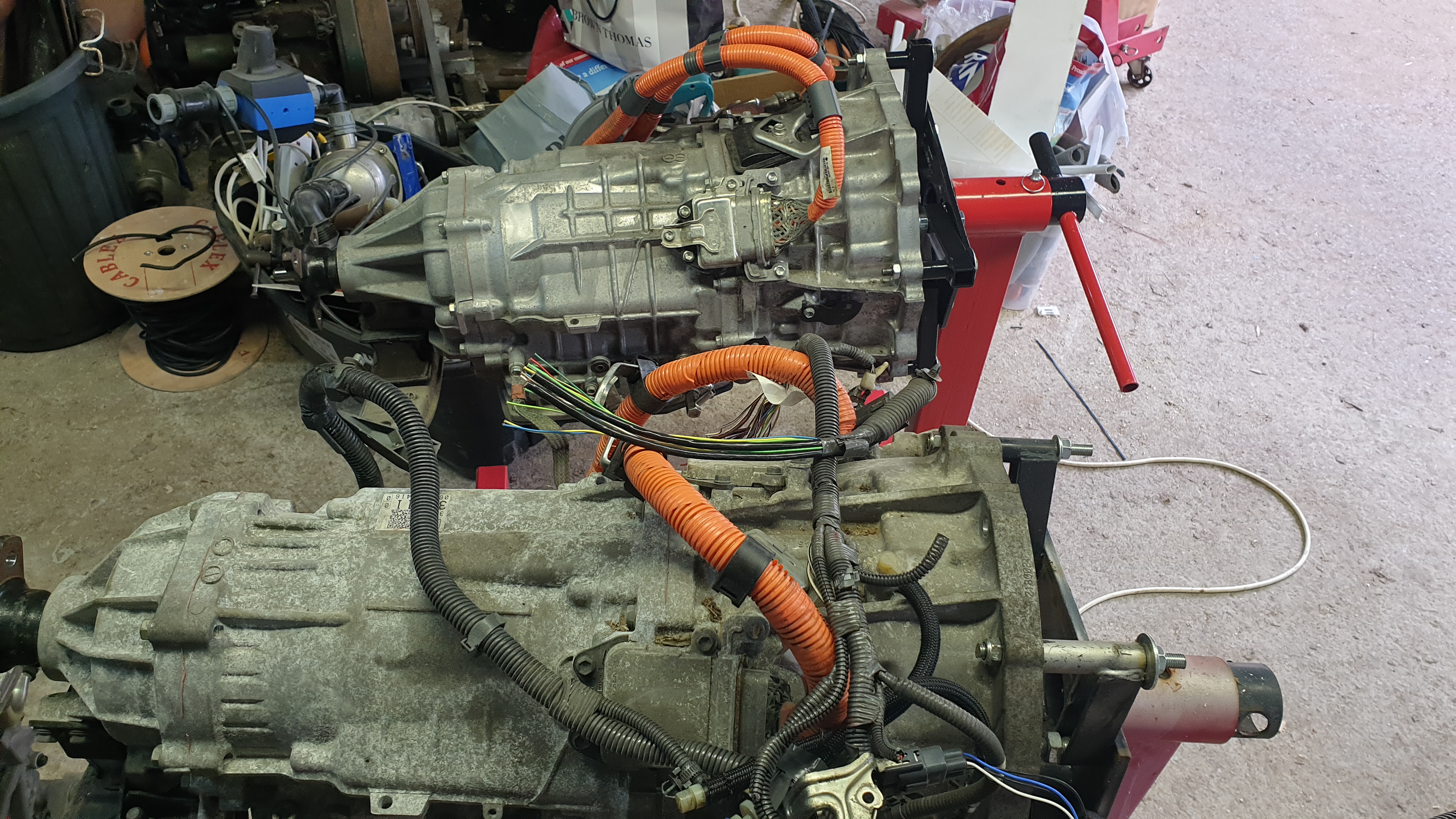

I have a bench now. And a gs450h system. Also scored a gearbox and inverter from an is300h so these will be coming to a Zombie vcu near you shortly. Next on the agenda is building a dedicated hv junction box with contactors, rig up a dash display and switch panel so all sw and hw functions can be tested on the bench before release.

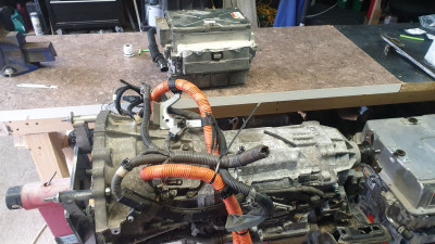

Is300h system is here.

So found one nasty software bug that was stopping the gs450h module from sending a torque request and we have spin :
I'm going to clean this up over the next few days and test in the other cars then do a commit and release and a big long boring video showing how to wire up, test and run the gs450h system. Then is300h fun starts.
