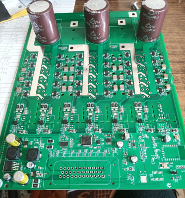

it's finally arrived!
unfortunately, not all the details are posted. now we need to make a list of the missing ones and buy them separately

hello everyone.
the story with these boards continues slowly.
I'm almost ready to start testing them. several manufacturing errors were found, they decently took out our brains)), but we found them and eliminated them.
Now I'm stuck with the inability to calibrate the high voltage reading. after two resistors of 680 kohm, a 510 ohm resistor is parallel to the signal. it seems to me that this is a mistake and the nominal value should be higher. otherwise, even 100 volts of board power supply give 0 volts at the input to the meter chip.

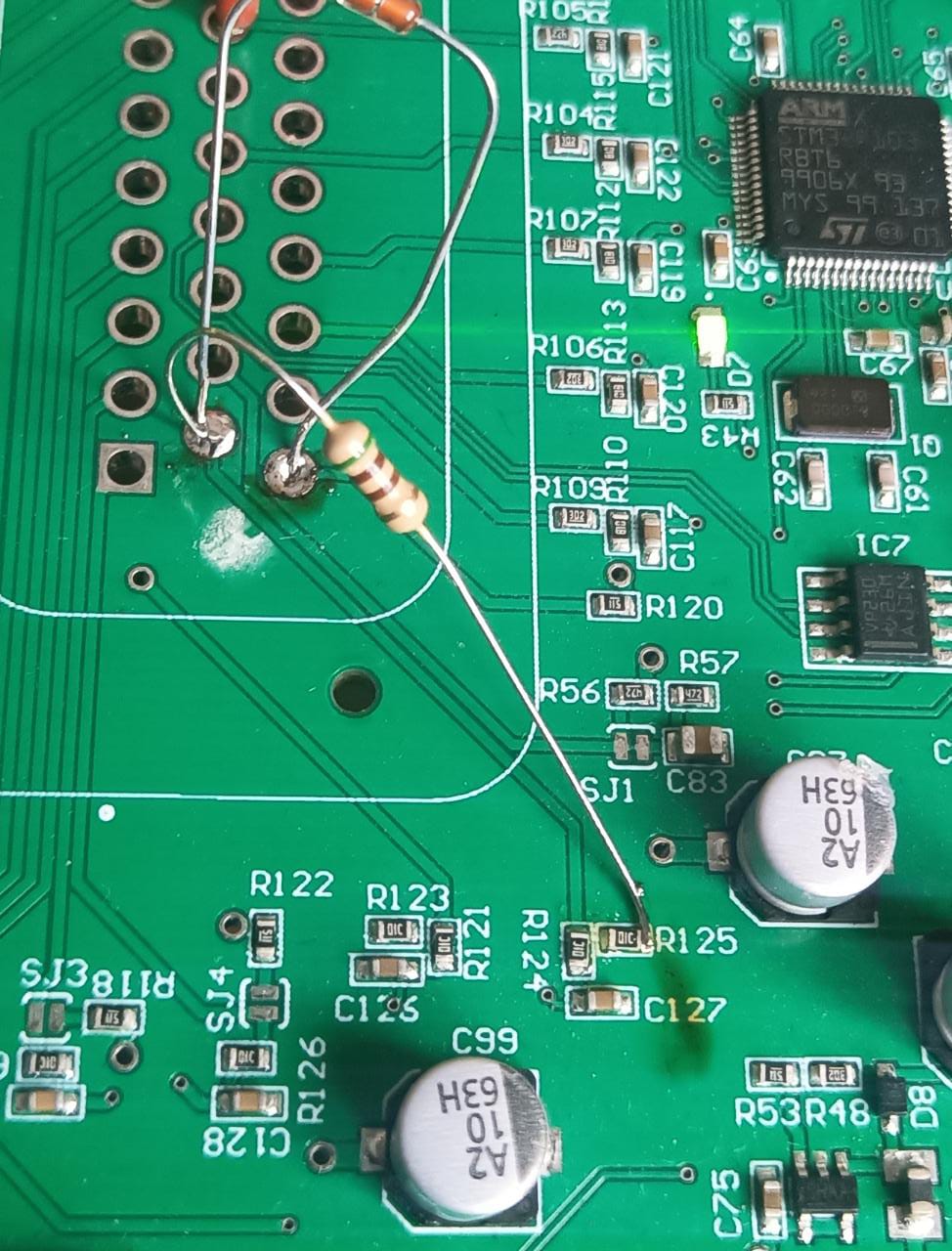

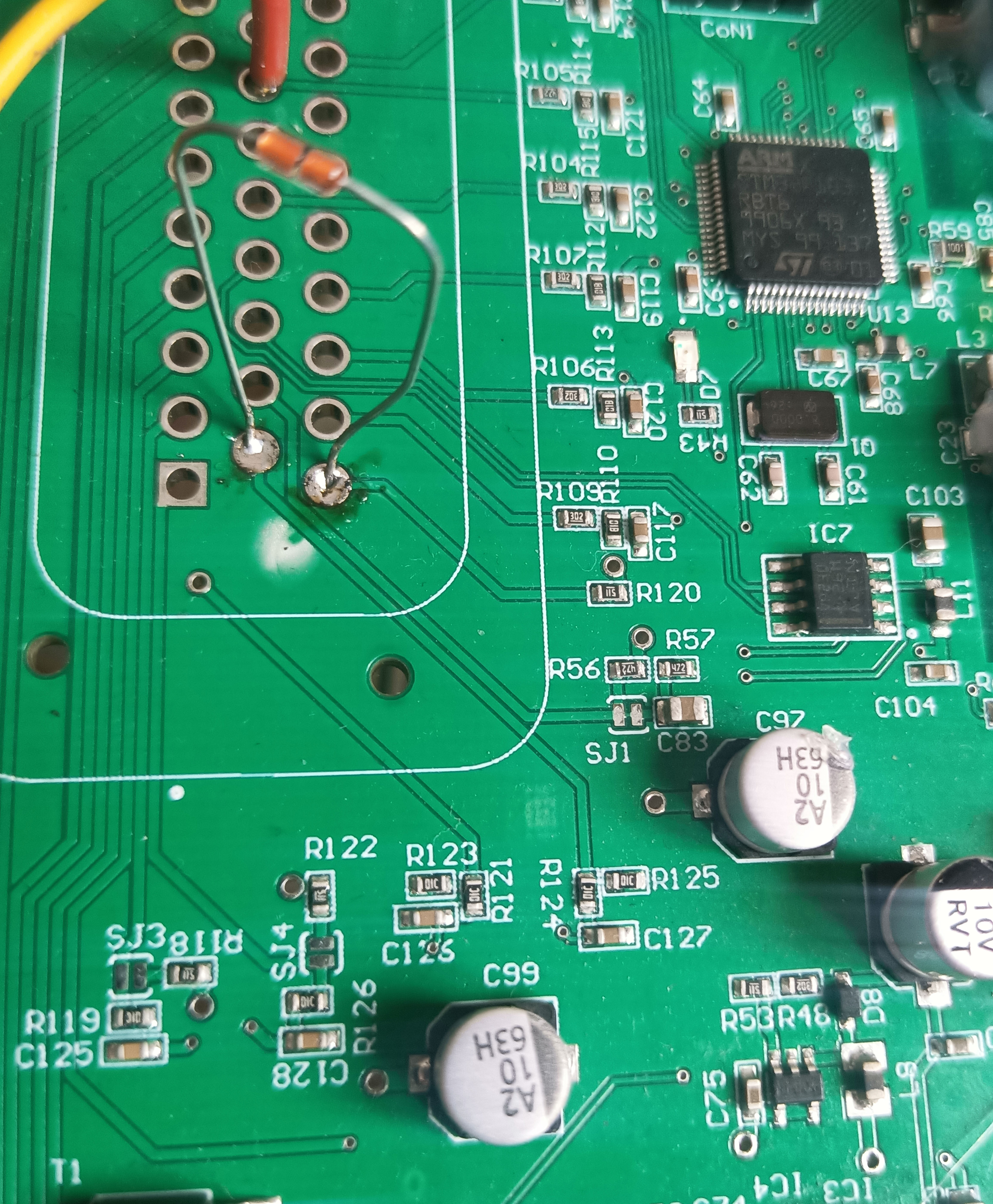

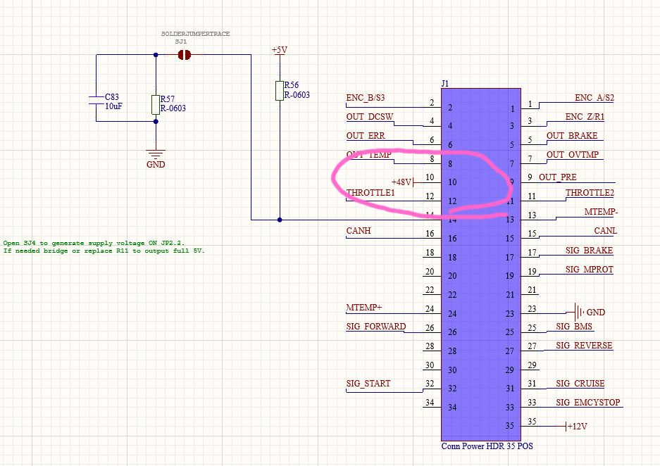

I found another mistake. or rather, only the consequence, I have not yet found out the reason itself. soldering the temperature sensor into the slots responsible for the motor temperature sensor and specifying this type of sensor in the settings gives -40 ° at room temperature and no changes when the sensor is heated.
the kty84-130 sensor itself.
probably need to add some filters or dividers?

Software expects the sensor to be between two 500 Ohm resistors, one to GND, one to 5V. Voltage is measured at the upper resistor.

johu wrote: Mon Feb 13, 2023 6:40 am Software expects the sensor to be between two 500 Ohm resistors, one to GND, one to 5V. Voltage is measured at the upper resistor.
thanks. I'll check if I really am.
Halil said that this part fully corresponds to the V3 board

This helped (I hope I haven't replaced the resistor yet) on the r125 board, who is responsible for the gnd = 2.47 kohm instead of 500 ohms.

Post by Romale »
installing a 500 ohm temporary resistor solved this problem!
Thank you so much again, Johu
