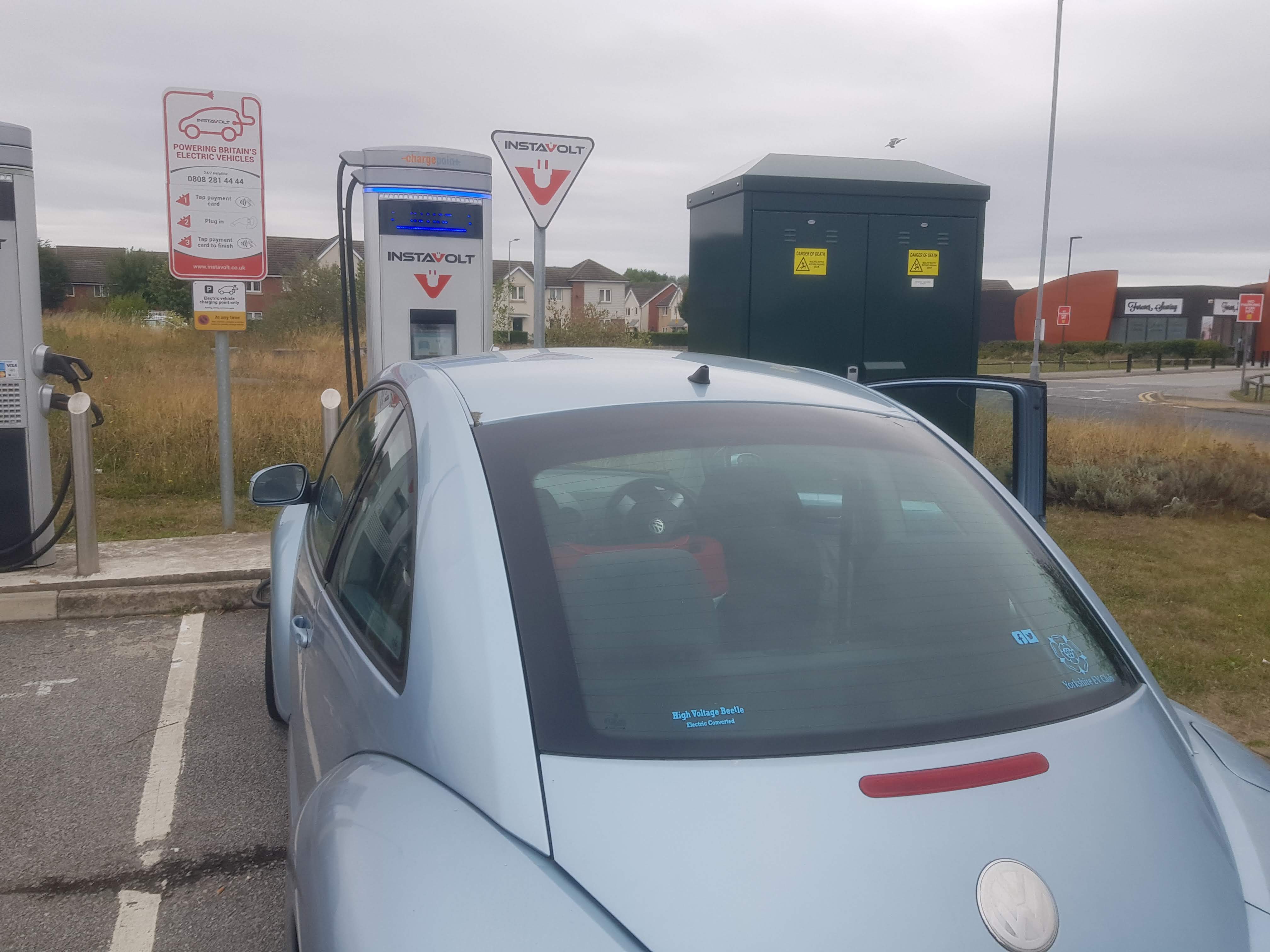

Re: InstaVolt Chademo Failure
Dont recall advertisements, but they look like this
Pretty much stumped so taking a punt, dont suppose you have any logs from these units to compare with?BMW E91 2006
