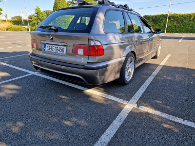

The DVLA will not update cars registered after 1st March 2001 in the UK as electric, so you'll still have to pay tax on it. There's been a few of us on at them without success. Other than that looks like a good project. I'm keeping my eyes out for pre 2001 for next project.
- Posts: 52
- Location: Maynooth
- Been thanked: 7 times
Re: E39e Touring
Hi, I'm in Ireland so no worries there.. I see the uk reg in picture, old picture
I imported the car from uk late.. 2019?
- Posts: 1779
- Has thanked: 83 times
- Been thanked: 428 times
Re: E39e Touring
Ahh, saw the UK reg and assumed
Lucky you
