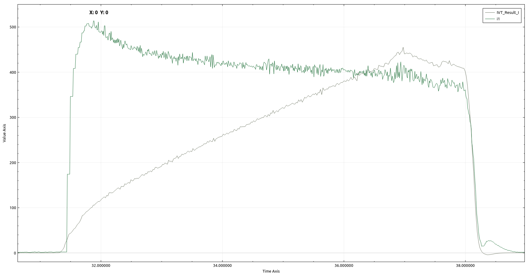

So today the ambient temperature here has fallen dramatically giving me a bit more headroom on the the temperature limit.
I thought I'd try increasing both fslipmax and boost together. This was a bit of a wild test, changing too many parameters at once to draw proper conclusions, but thought I'd post the resulting charts anyway.
fslipmax=3.5 (Damien and Peter like this value)
boost=3800 (I increased this linearly with fslipmax from my previous value of 3200)
fweak=250 (i didn't increase this, but I should have done to avoid smashing into the 500A DC limit)
0-60: 5.4s (Quite a bit faster, even with the derating)
idcmax: 550 (a value of 550 limits current aggressively to 500A)
AC current: 550A to 445A (this is quite a substantial increase on previous tests)
DC Current: 0 to 500A (it bounced off the 500A limiter before getting to 60mph, so way too high for my car)
Inverter temperature: 24C to 59C (a 35C rise is nowhere near as much as seen on previous tests with less AC current)
In any case, as per my original brief, I do not want to exceed 450A, so I will be dialing this back again, but it was an interesting test.
Current, speed and temp graphs for these settings below.

After staring at these charts for a while, I realise I'm running into a fairly simple problem that's limiting my performance significantly. My desire not to exceed 450A means 2 things:
1) I limit AC current at 0RPM to 450A by setting boost. This works perfectly.
2) I limit DC current to 450A by setting fweak. This also works perfectly. By setting this to 250, we reach 450A at exactly the same time we reach 100% battery voltage, meaning this current is never exceeded. The fact that this occurs at 60mph is a handy bonus.
The resulting AC and DC current looks like this:
In the top left we have 450A of AC current, and in the top-right we have 450A of DC current. The problem is that in the middle, there is a big area where both AC and DC current are less than 450A. For example at 80 seconds, the AC current has reduced to 400A, but the DC current has only risen to 290A. This means that for a significant portion of the acceleration, I am pushing only 90% of my target current.
When I tune more aggressively (boost=4000) to bring AC current up to 500A, the problem is even more apparent:
Here we see that the initial 500A created by increasing the boost falls off quite quickly, with fweak being the factor that determines current for the majority of the acceleration curve. This means that most of the time, the currents are well below the 500A AC and 450A DC limits.
There would seem to be 2 solutions here:
1) Add a third point in the V/Hz cure. So in addition to 10% voltage at 0Hz and 100% voltage at 250Hz, I could add some more "boost" at 125Hz which would allow current to be increased at around 30mph without changing the 0mph peak and 60mph peak that are already tuned.
2) Reduce fweak. This would allow me to push a consistent 500A AC, yay, but would cause me to hit the DC current limiter. I had hoped to avoid the limiters (derates) because right now hitting this reduces the throttle to near enough zero, making for a fairly unpleasant driving experience, however with some improvement, we could make a smoother current limiter.
In a way, this brings me back to a more fundamental question. Should we be using an open loop, as I have favoured with this tuning, or a closed loop, where we measure current and try to maintain it within idcmax. From what I've experienced so far, the closed loop DC current control in openinverter isn't fast or accurate enough to provide a good driving experience, however I haven't yet spent enough time tuning idckp to see if this can be improved upon with configuration alone. I suspect that my suggested changes to the AC current measurement maths would help here, but that's beyond the scope of this thread.

Yes I see the problem with the idc limiter - idc is not being filtered at all. In FOC software there is idcflt which sets the filtering but I obviously forgot that in sine firmware. It is in pwmgeneration-sine.cpp : ProcessCurrents() if you feel like adding it in

It sounds like you're referring to idcmax. This parameter limits DC current to a specified value. This would be ideal and would allow me to lower fweak to achieve consistent AC current. Unfortunately it doesn't work very smoothly. It results in the throttle oscillating wildly when the current limit is reached.
