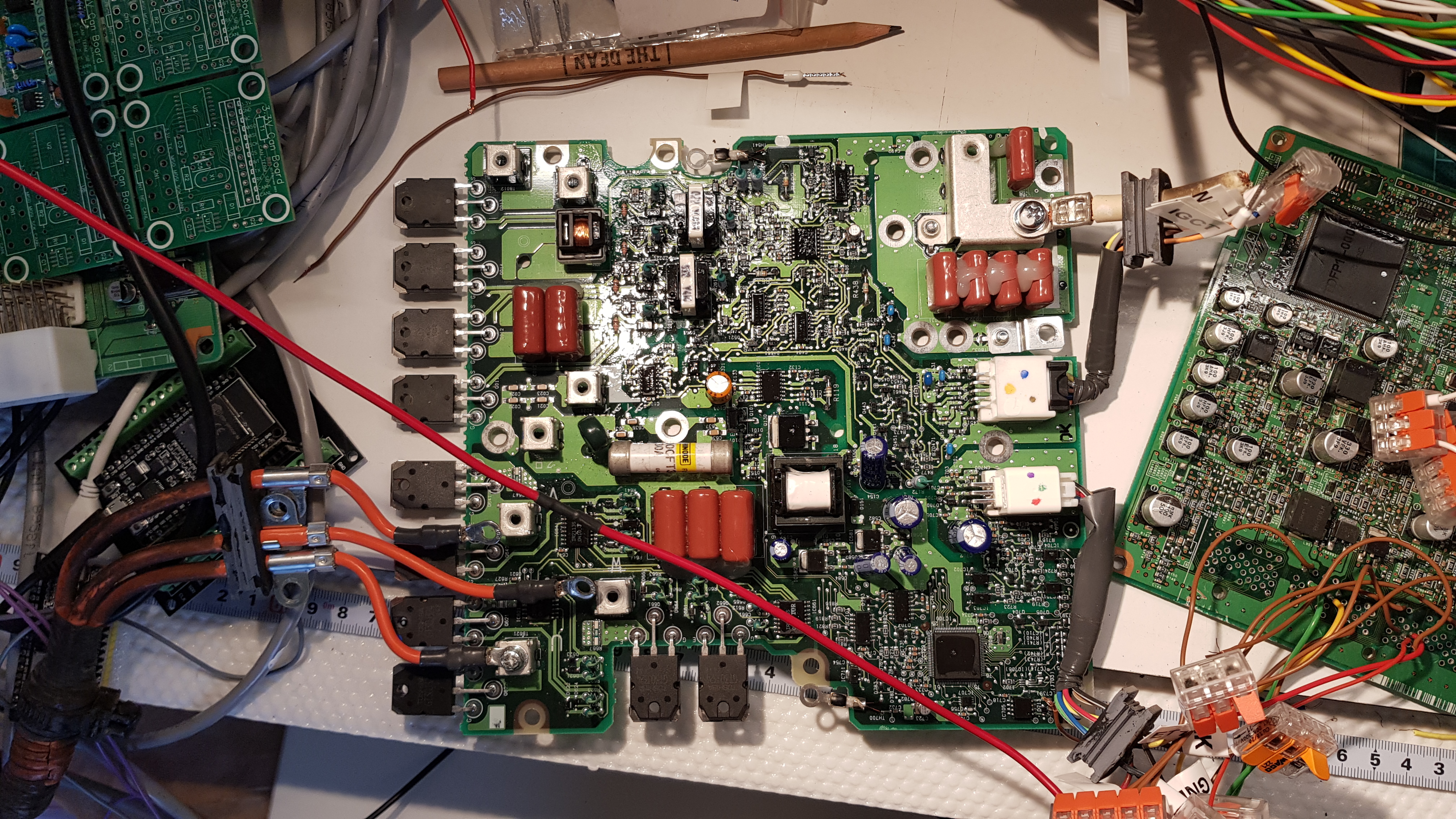

Prius Gen2 A/C compressor inverter
sure! i can confirm the gen2 a/c compressor is just a 3 wire connection from the bottom half of the inverter.
I will look for and document signals.
if anyone has a specific area of interest, it will speed up the process so I dont have to start from scratch with the schematics.
and I have a new siglent scope im eager to use
should we move that discussion somewhere ?... just give me direction

It's well established that the aircon inverter drive is on the same PCB as the DC/DC converter on a Gen 2 Prius and runs at battery voltage.

So to start out the pin mapping of the grey 6-pin LV connector of the A/C inverter needs to be researched. Apparently it runs some sort of serial protocol. In a second step that would need to be recorded with a protocol analyzer at various operational states. Most obviously A/C on and off.
The connector is on the same side as the DC/DC control connector and located below MG2 power output

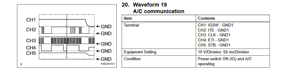

Re: Prius Gen2 A/C compressor inverter
Link to prius wire diagram:
https://priuschat.com/attachments/prius ... pdf.33780/
See page 350
Connector:
I11(C)
(I11 Inverter 90980–10988)
1C GND
2C ITE/TOECU
3C ETI/TOINV
4C CLK
5C STB
6C IG

IG 6C 12 when ignition is on
STB 5C 12/14v while inverter is starting up then drops to ~1.5v. Didn't seem to change when a/c was turned on. I'll verify when my pack is changed.

Cool, thanks. So these seem to be pretty static leaving only pins 2,3,4 to be connected to a logic analyzer, perhaps in SPI mode.

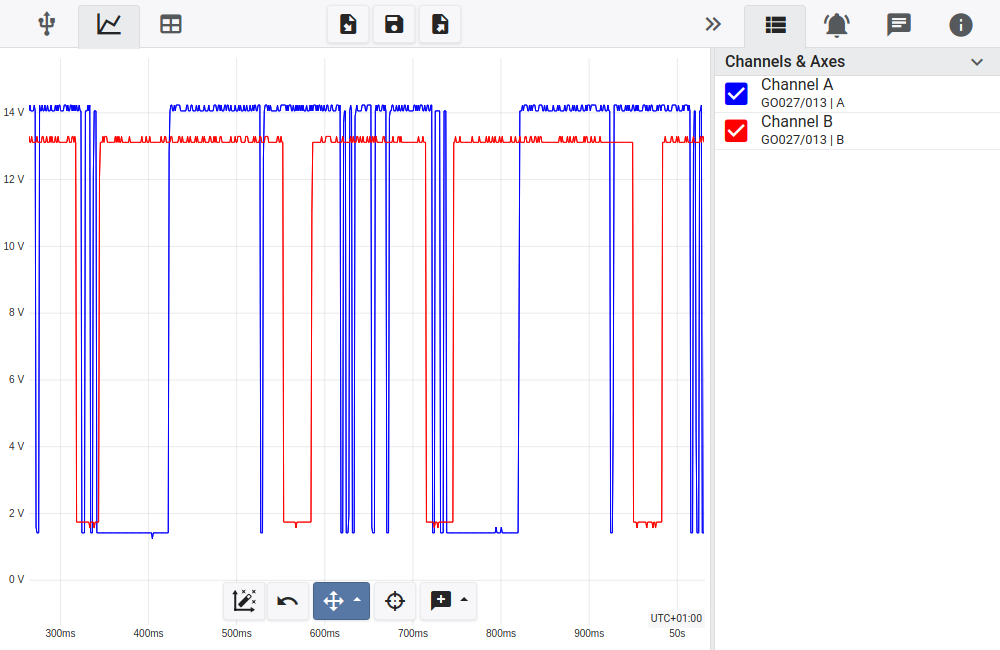

I've captured a log turing the A/C on and off with pico scope.
channel A is ITE channel B is ET1:
https://github.com/hakanrolsson/PriusHV ... 43.picolog
to view see:
https://www.picotech.com/downloads (2205A)
to view see:

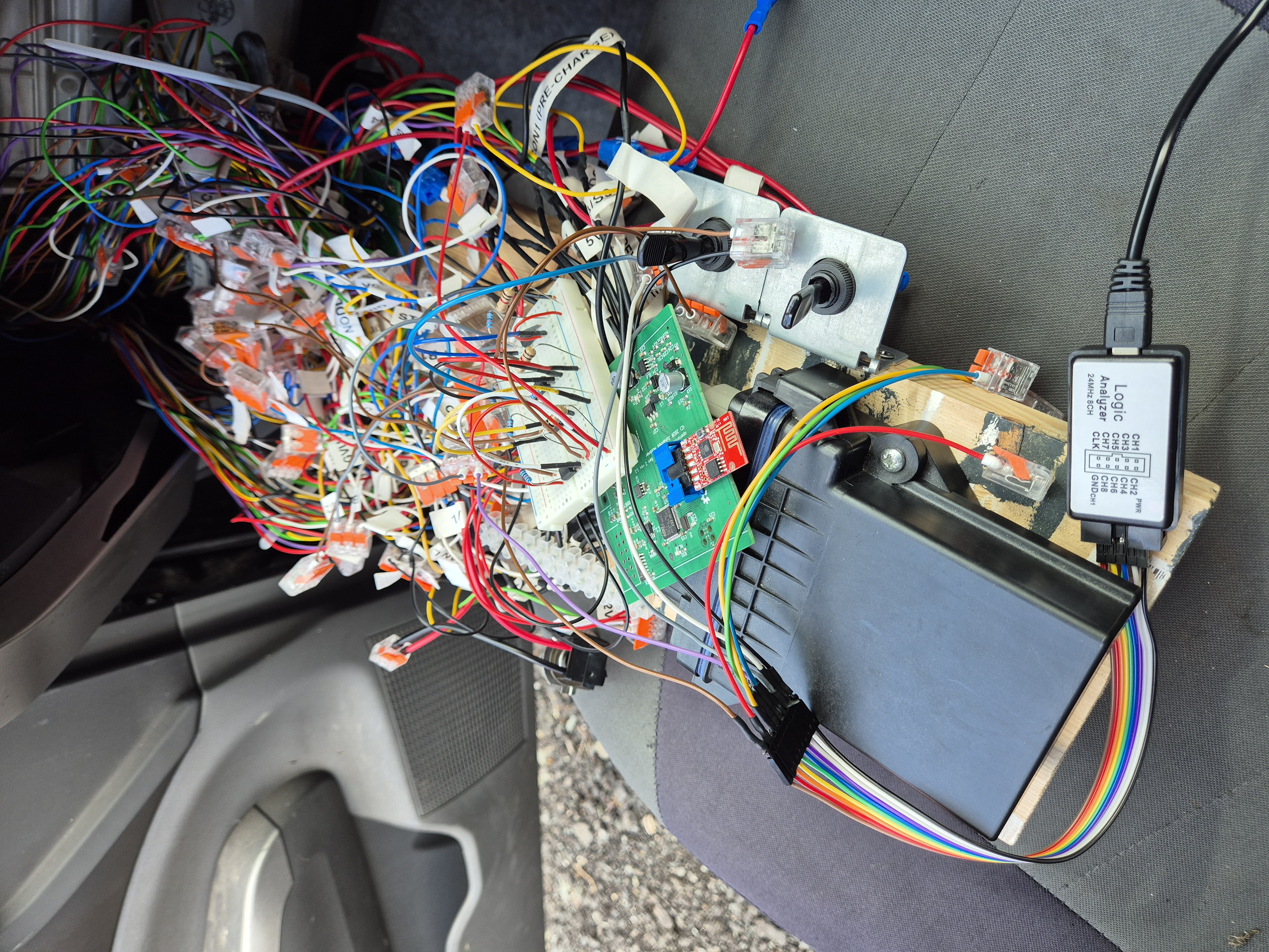

Conncted an ardunio nano with software from xp677 on the Denzo ES27C thread viewtopic.php?p=2744#p2744 Edited the software to send all the messages and now the A/C inverter is drawing 0.01 then 0.02 then 0.03 A.
STB is connected to ground
From the Denzo ES27C thread seems I now need to connect high voltage to get the inverter to wake up.
void loop()
transferpacket(1);
serialdiag(1);
transferpacket(2);
serialdiag(2);
transferpacket(2);
serialdiag(2);
transferpacket(3);
serialdiag(3);

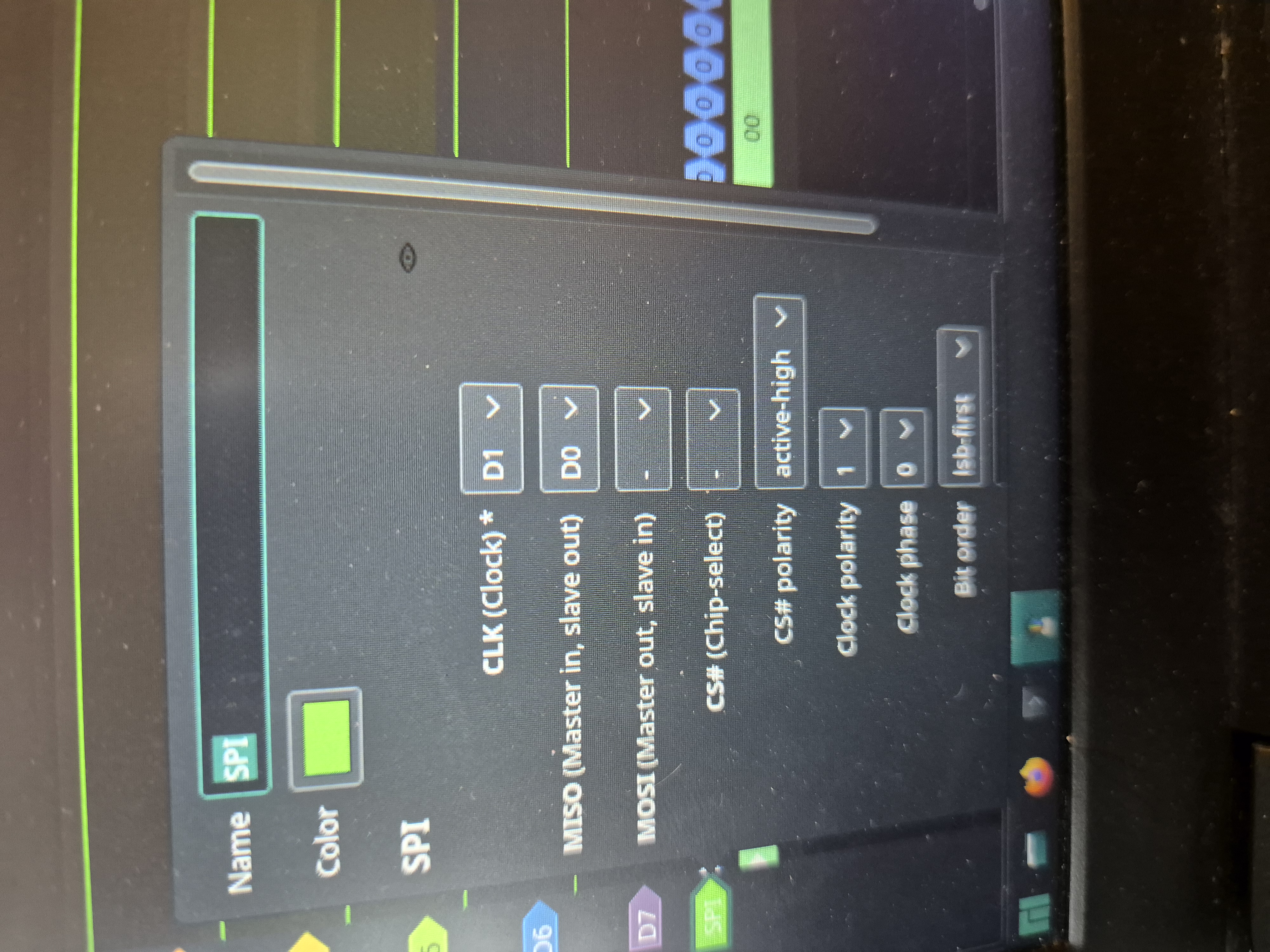

Using a logical analyser and sigrok I've captured:
2C ITE/TOECU (D0)
3C ETI/TOINV (D2)
4C CLK (D1)
5C STB (D3)
Turned ignition on, turned a/c on, off and then ignition off.
See attachments
I will test sending messages back to inverter using xp677 software and hardware solution from Denso thread.
2C ITE/TOECU (D0)
3C ETI/TOINV (D2)
4C CLK (D1)
5C STB (D3)
See attachments
