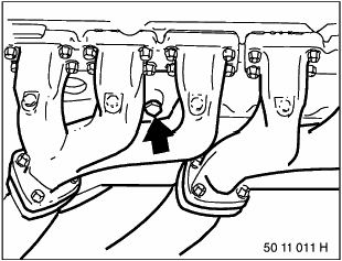

As I can't add pictures to YouTube comments, here's a picture with the drain plug on the side of the engine.
When tightening it needs a new washer and should be tightened to 25Nm. In case anyone buys the engine, it would be a nasty spot for a leak :D

Ah brilliant - thank you!
