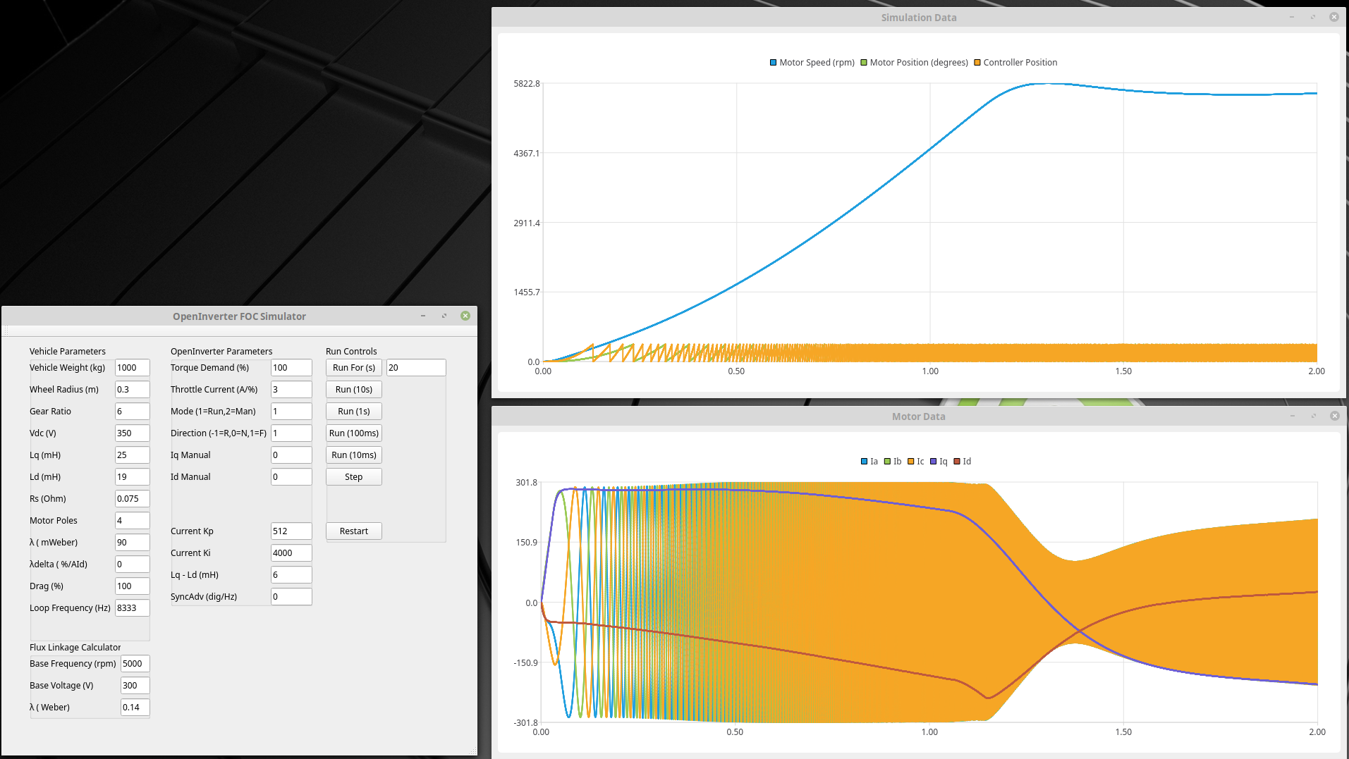

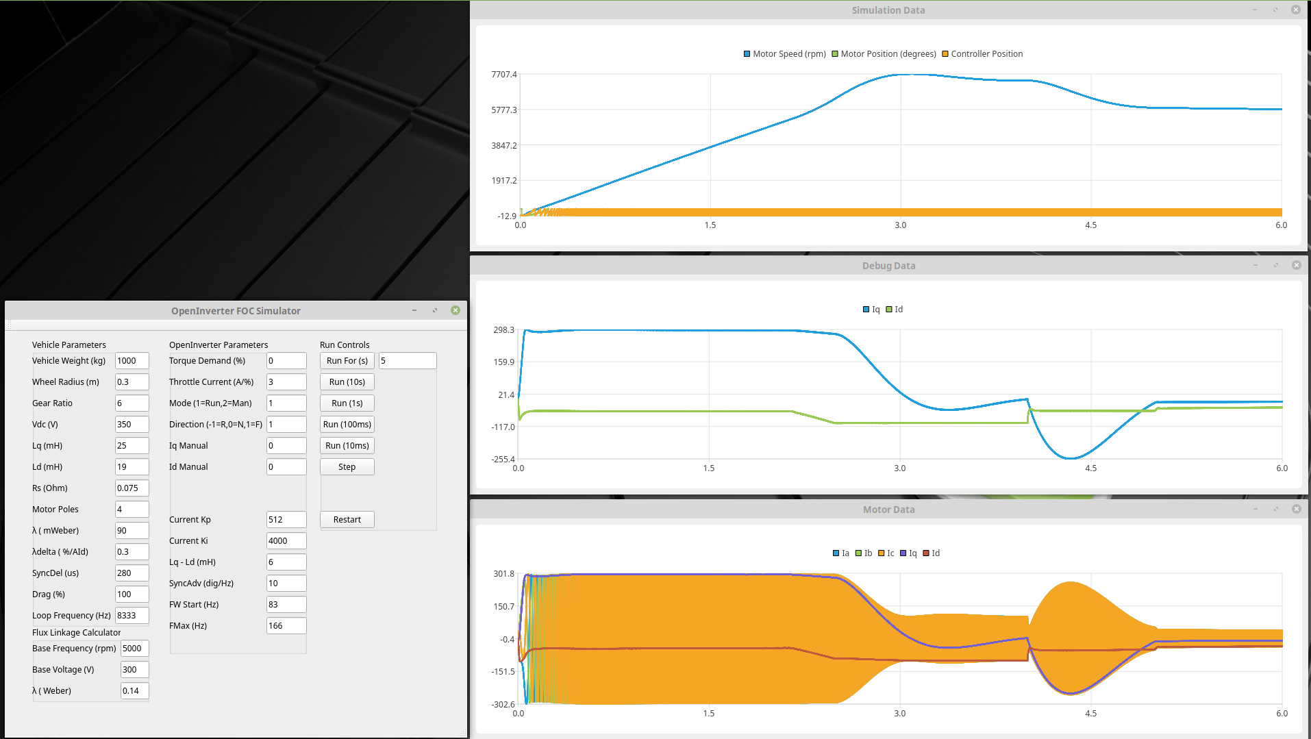

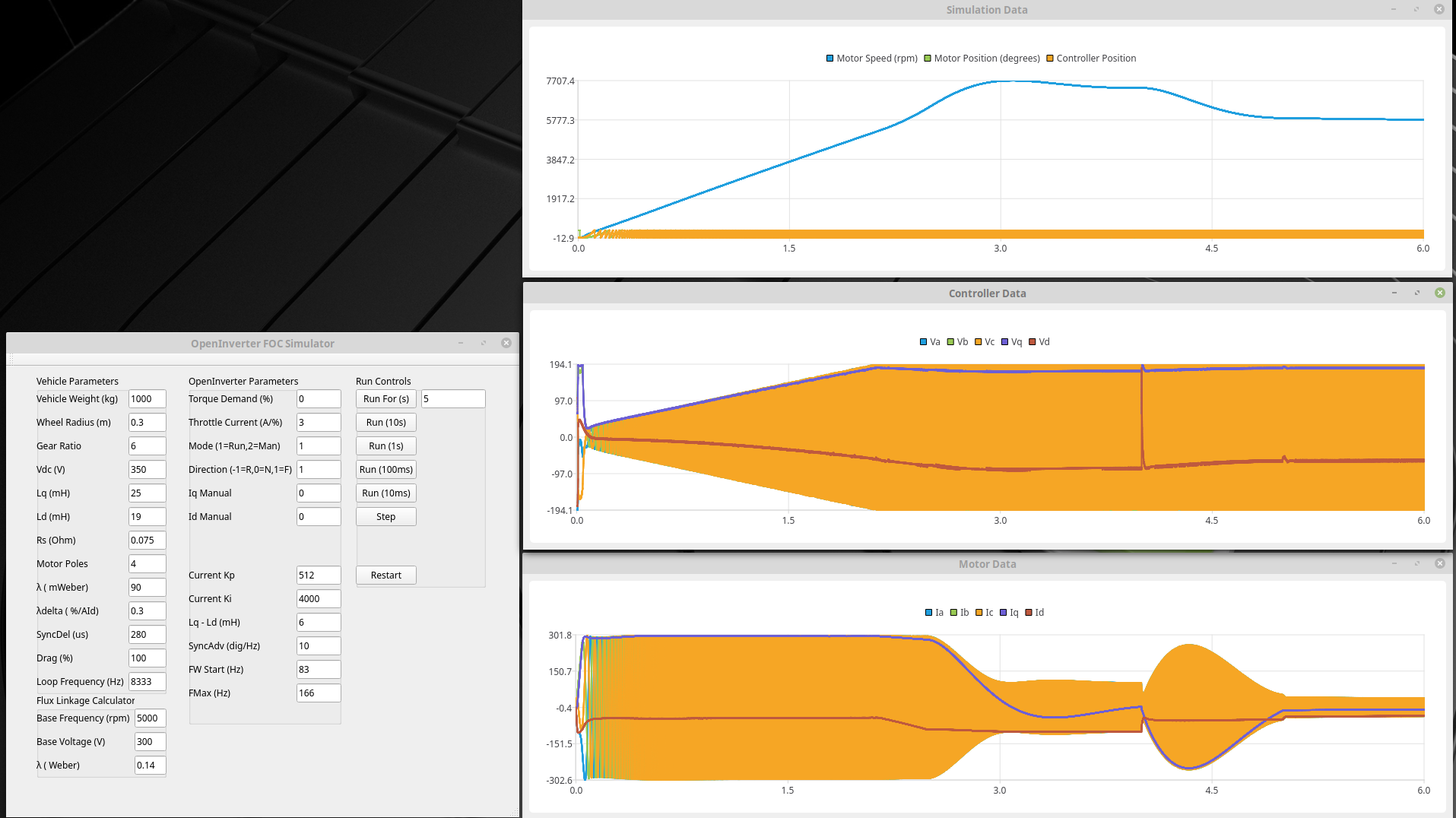

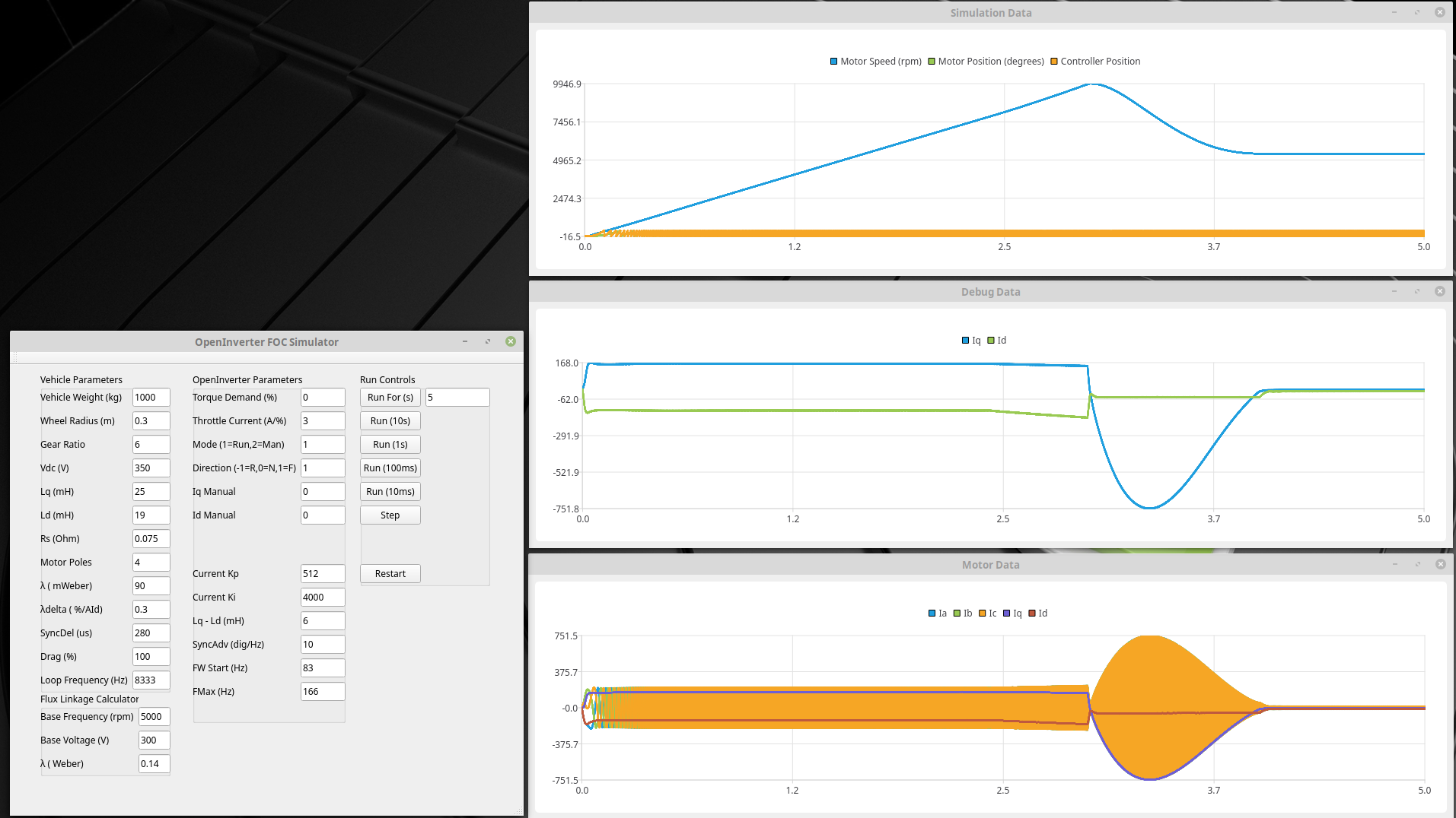

And one more interesting plot for now. It's the same as the last one but with MTPA disabled by setting Ld and Lq the same so all Iq:
Bit early to draw any conclusion but it would appear that it gives much better acceleration. It would aslo appear that I need to sort out the sync advance code as it is causing an error between the currents seen by the motor and controller. The currents as seen by the controller are in the Debug window and look correct. The motor currents are seen in the Motor Data window and it can be seen that there is an angle error increasing with speed which is causing a negative Id. This is effectively acting as FW and allowing the motor to exceed base speed!-

Been playing around with the effect of the MTPA algorithm and either there is something wrong with my simulation or something wrong with the algorithm. It seems to add much higher levels of Id than I would expect.
Going to spreadsheet the equations later to see if they make more sense that way but for now be very careful doing anything based on the above!

I'd not looked at the formulae but just have and it's not quite what I was expecting based on the mathworks reference equations: Are these the equation that should be implemented or are there other versions?johu wrote: ↑Thu Aug 25, 2022 8:46 pm Hmm, interesting! I fixed the MTPA formula at some point, so your change plus a change in the formula itself and got less performance and strange behaviour on cruise control (or probably rather at low load). So I reverted the change and never looked at it again so far.
Let me know if I can help getting your code on github
Was it the lqminusldSquaredBs10 value change that you tried before, what was the formulae change?
Re git, would it be possible to post a zip of the qt project here on the forum (once I've got it so it will work with unmodified OpenInverter builds)?

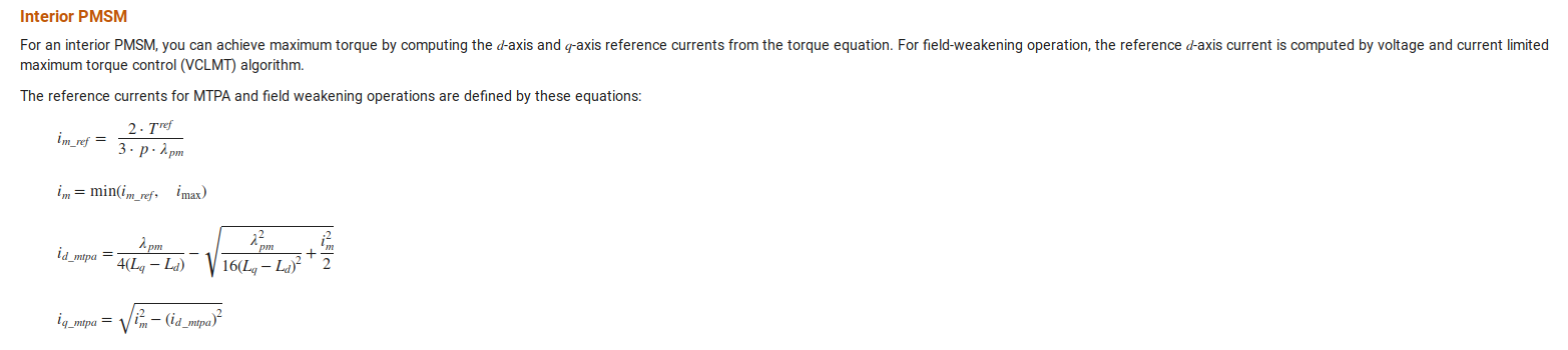

I think the MTPA algorithm in the code is:
While the Mathworks one rearranges to:
So similar but not the same, any thoughts?
Id = (1/(Lq-Ld)) x (λ - sqrt(λ2 + (Is2 x (Lq-Ld)2))))
Id = (1/(4 x (Lq-Ld))) x (λ - sqrt(λ2 + (8 x Is2 x (Lq-Ld)2))))

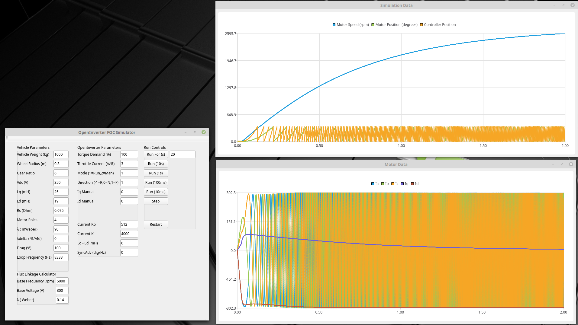

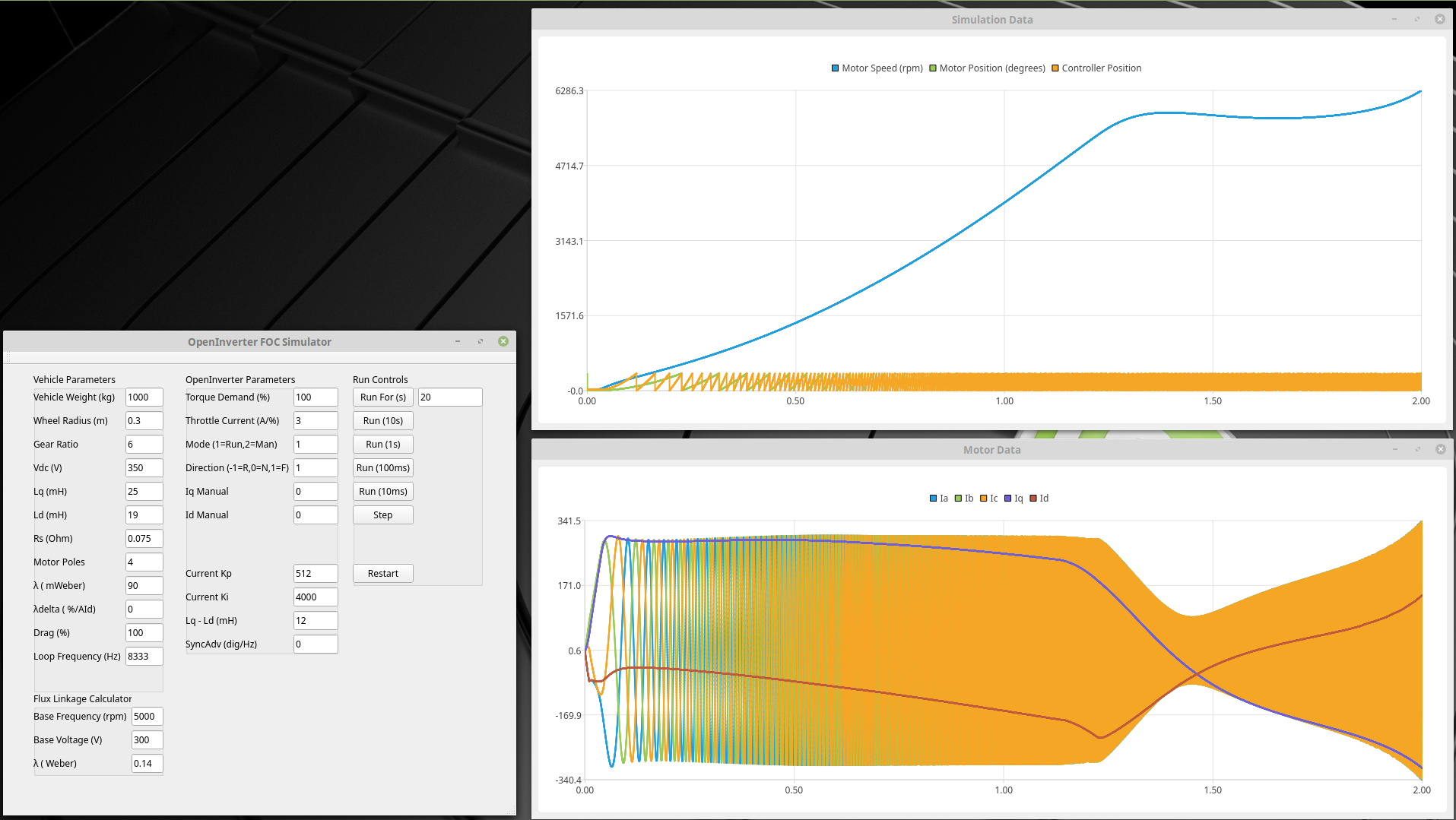

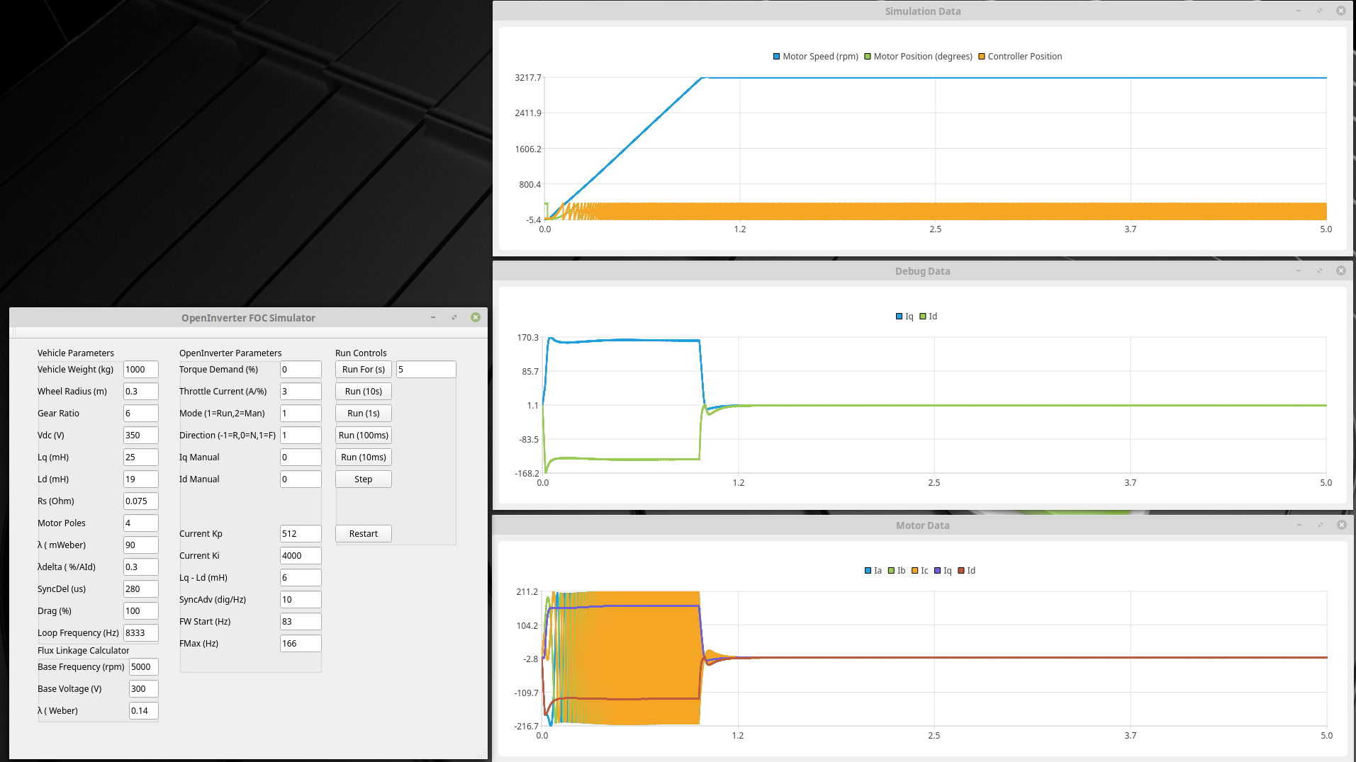

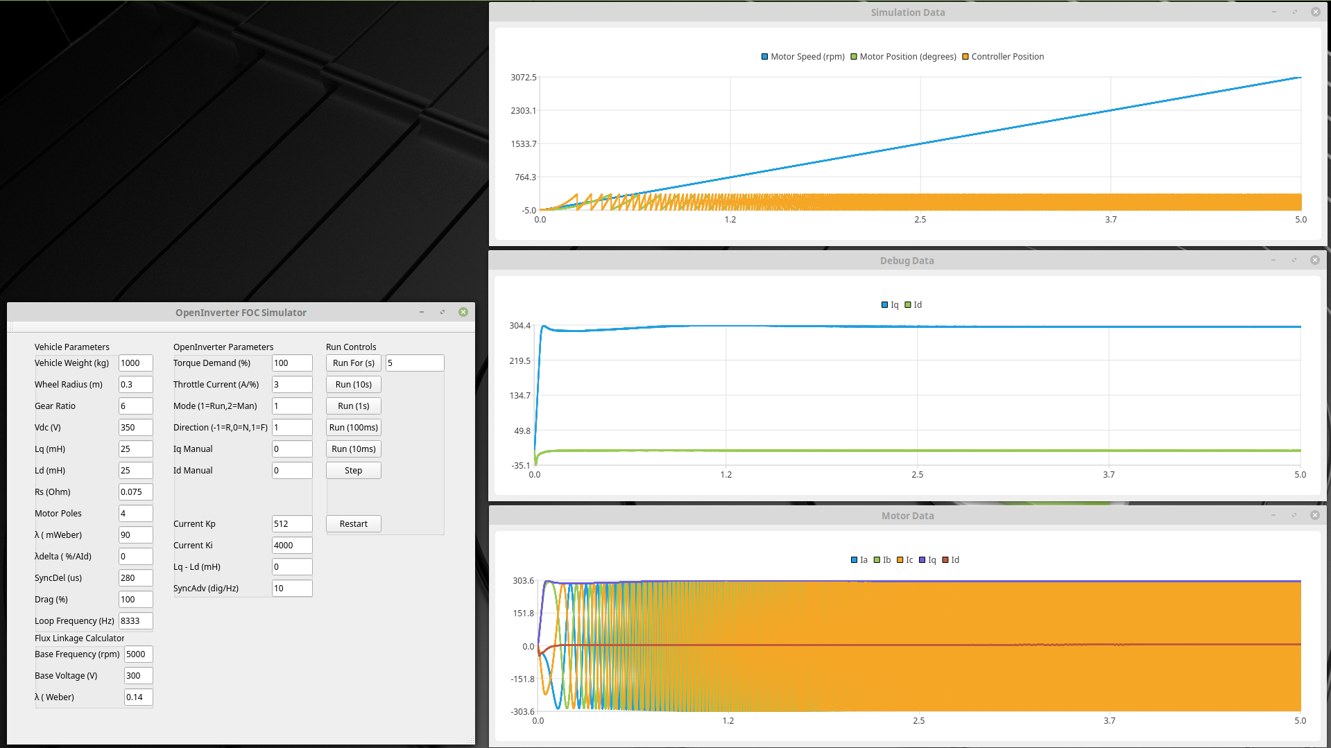

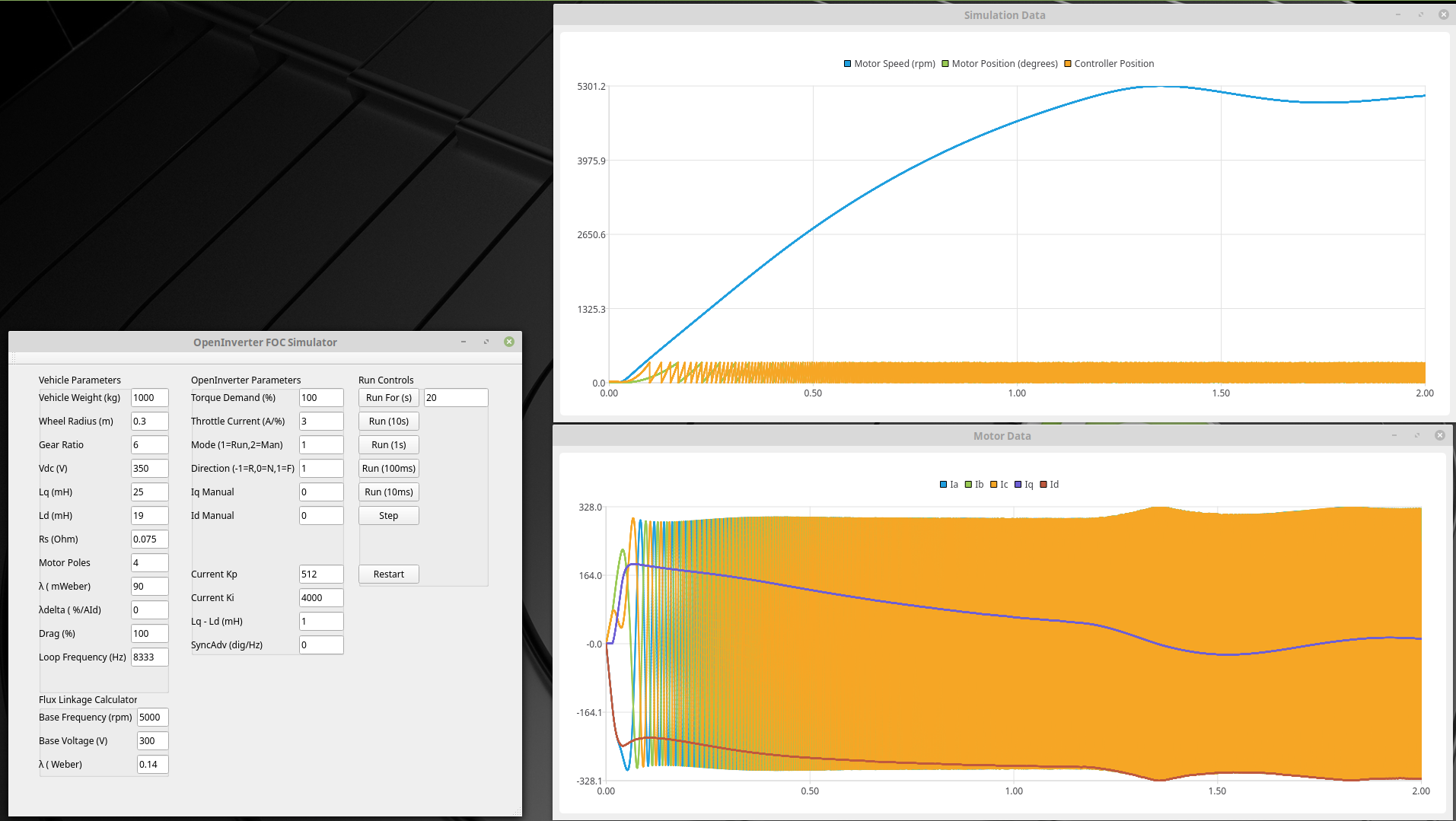

Some more plots (let me know if this is using too much forum storage space!) :
First 4 captures with the current MTPA algorithm (top equation in last post).
First is with MTPA Off Second is with the Controller Lq-Ld matched to the Motor Lq-Ld Third is with the Controller Lq-Ld lower than the Motor Lq-Ld Fourth is with the Controller Lq-Ld higher than the Motor Lq-Ld Next 4 captures with the revised MTPA algorithm (lower equation in last post).
First is with MTPA Off Second is with the Controller Lq-Ld matched to the Motor Lq-Ld Third is with the Controller Lq-Ld lower than the Motor Lq-Ld Fourth is with the Controller Lq-Ld higher than the Motor Lq-Ld Comments welcome! If I had to chose one it is the new matched, especially compared to the old matched, higher acceleration to a faster speed (note that this is all without field weakening). The old matched is particularly bad but it's interesting that the old plot with a high value of Lq-Ld is almost as good as the new matched one.

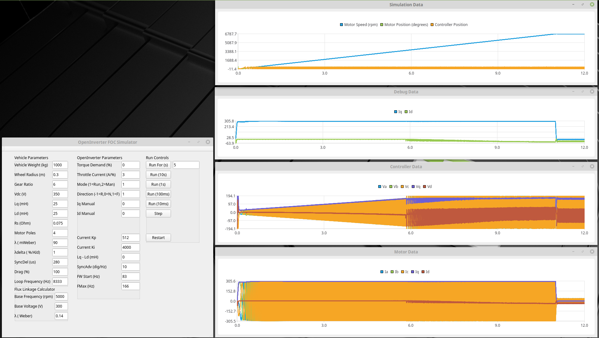

If trying this in a car (with the parameter control added) I'd start with a guessed flux linkage (note that this is in mWeber in the new param_prj.h file) somewhere in the right ballpark. Set Lq-Ld to zero (to disable MTPA) and carefully try it (based on the simulation torque should be low). Then increase Lq-Ld by 1mH at a time and see whether things improve. Based on forum posts I would guess something around 4-6mH might be best. Note that an incorrect value of Lq-Ld will have an effect on field weakening too so best stay well away from that region while testing! Please note that I'm not suggesting trying it yet (I wouldn't) but just in case anyone feels the need...
Edit - For those that noticed there are now more plots - I realised that the old low Lq-Ld was actually with MTPA turned off (Lq-Ld = 0) so have rerun the low plots with Lq-Ld = 1. Old low plots now included as MTPA Off.
And for completeness here is the revised Mtpa function (old code left for reference but commented out):

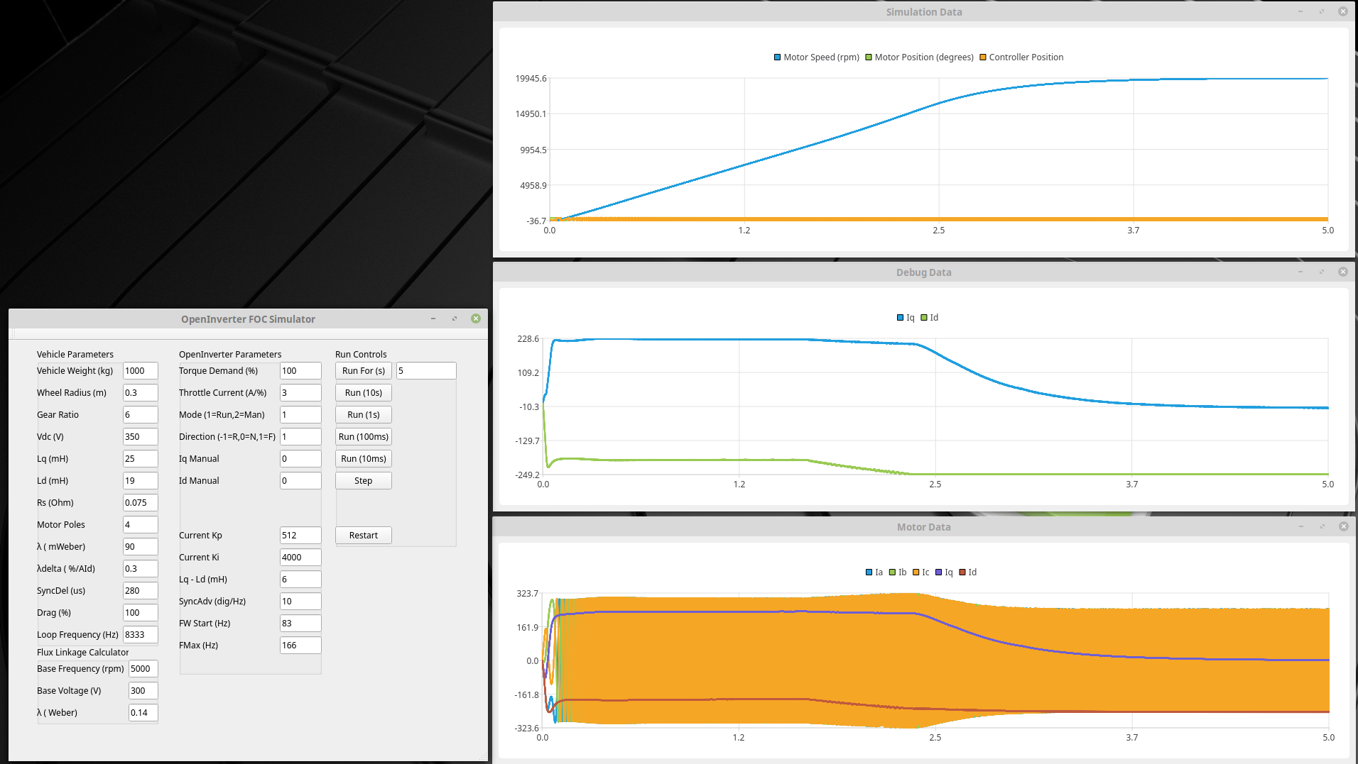

More plots! The last thing to sort out before I can look at the regen issue is to implement SyncAdv support. I've modded my model so that it can give out an offset position (controlled by the SyncDelay contol on the main window in us). The idea is that this can be tuned to compensate for the SyncAdv in the OpenInverter code and then allow the effect of discrepancies to be investigated.
First plot is with SyncAdv set to 0 (to disable it) and then SyncDel tuned till the controller (Debug window) and motor (Motor window) views of Iq and Id match : It's interesting that 113us is needed to get the match. This is exactly one control loop so I'm guessing that the model isn't quite doing the loop value update at the right moment. Not going to worry about it for now though.
Next plot is with the OpenInverter SyncAdv increased to the standard value of 10 and the model left at the zero position (actually 113 till I fix it): You can clearly see the effect this has on Iq and Id as seen by the motor - a gentle shift in value with increasing speed.
And finally with SyncDel tuned to get back to correct operation: Whats really interesting here is that it needs 280us, after allowing for the 113us error this is a advance of 167us. I was expecting a figure nearer 50us. All I can think is the the OpenInverter code is somehow giving the same 113us loop delay as the model but can't think why.
Any ideas? Is 167us possible or is the standard value of 10 for SyncAdv a bit too high?
I think this is good enough for now though so the plan is to put the old MTPA code back in and go looking for the unexpected regen!

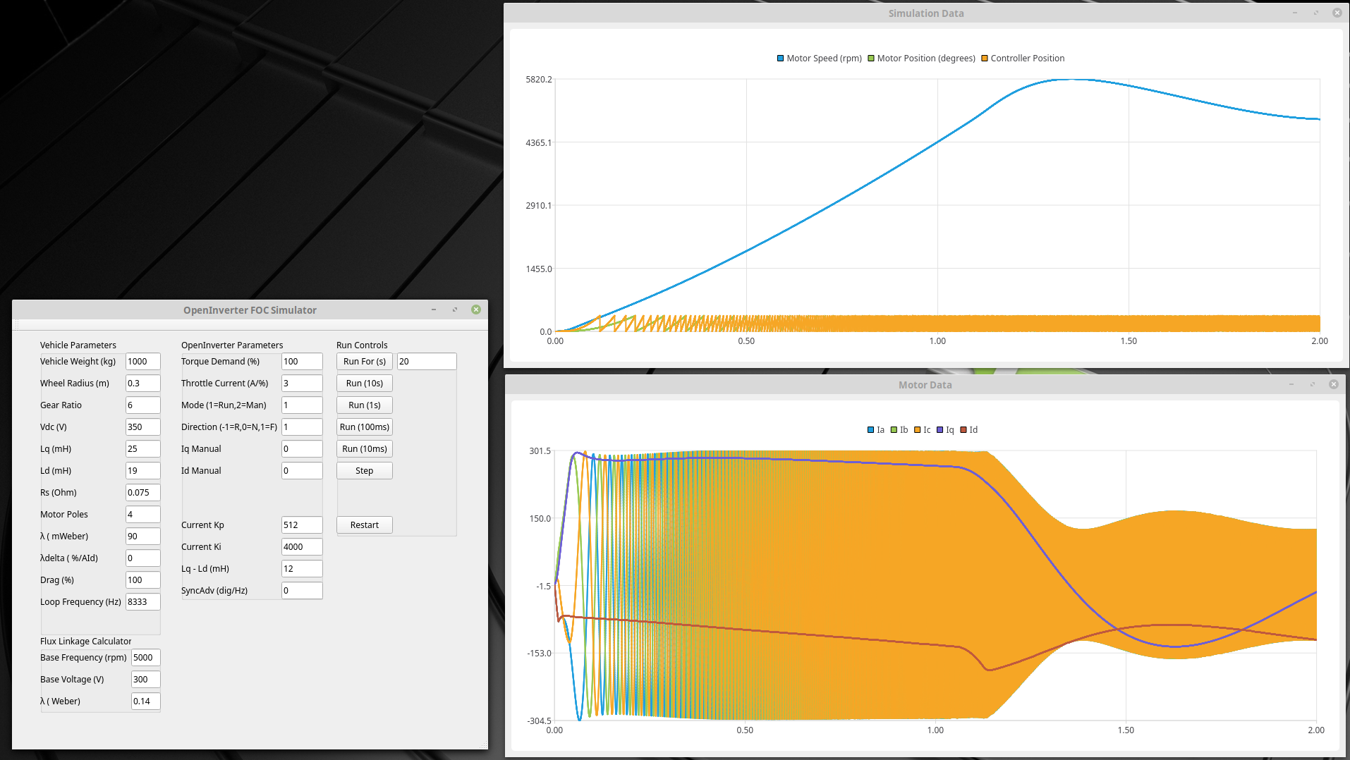

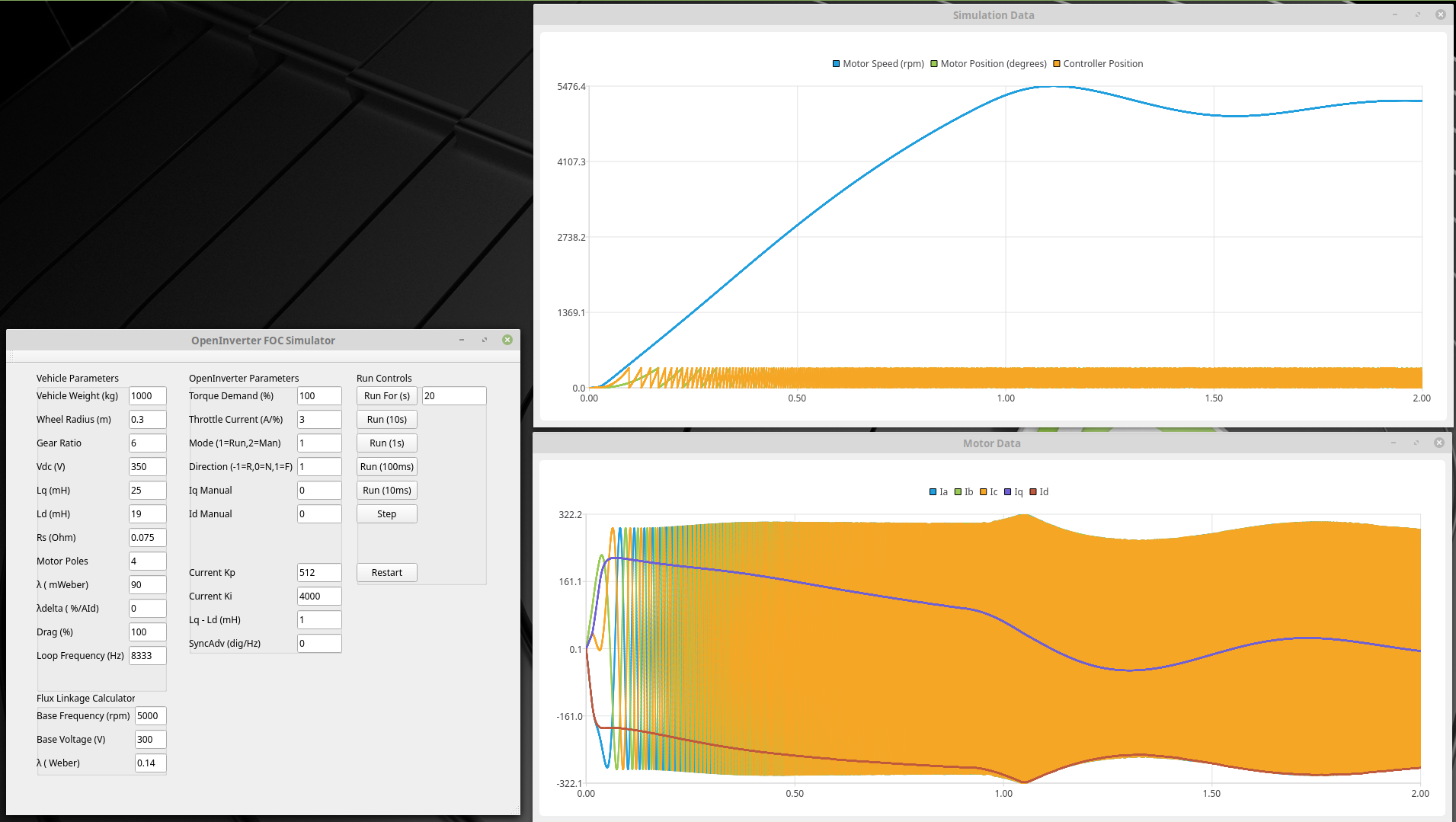

I may have modelled the unwanted regen
Have a look at the following plots and see what you think:
First plot, field weakening turned off - limits at base frequency: FW enabled, ramps up to high speed (higher than I would expect given fmax is set to 10krpm??): Accelerating to a speed below base and the reducing torque request to zero - coasts: And finally accelerate to above base freq and then come off the throttle - heavy deceleration!: Does this look like the problem people have been experiencing?
- Posts: 1801
- Has thanked: 102 times
- Been thanked: 350 times

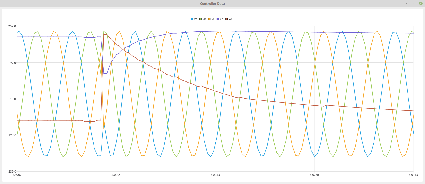

Couple more plots.
First with SyncAdv disabled: Still have the same issues, strong regen.
Second with the new MTPA algorithm: More interesting, still get the regen, although not as violent, but also now have issues with the FW (does not spin up as far) and less powerfull acceleration (previous plots were using 70% throttle, this used 100% and still slower.
So questions:
1) Has the FW been tuned to work best with the old MPTA or is there a problem with the new MTPA?
2) Do we believe the acceleration of the old MPTA? It uses very strong Id and I'm not sure I believe the torque calculation from the mathworks equations in that case )see earlier post).
3) If the regen isn't due to SyncAdv or due to the old MPTA bugs then what is causing it?
So questions:

And one more plot. Just noticed the other graph window (one I haven't been showing as it's not normally that interesting), the one that shows the voltages that the controller is generating:
Going to have a look at the frequency filtering mentioned in another thread to see what effect reducing the time constant on that has.
Whats, very interesting is that there is one blip at the point of deceleration, zooming in:
So there is a momentary blip (as the control loops stabilise) but no overall change to the commanded Vq and Vd. Don't think that this is what I expected, would expect a change.Going to have a look at the frequency filtering mentioned in another thread to see what effect reducing the time constant on that has.

Reducing the filter order from 8 to 2 gave no change so it's not that.
I don't think that this is an algorithm problem, I think it's a control loop problem. If you look at the above graphs the controller is trying to drive at max voltage on all three phases. This point also coincides with where the FW stops working properly. Essentially it has run out of control parameters, all it can change is the phase but that is only 1 parameter. It's trying to control 2, Iq and Id. Controlling 2 outputs with 1 input isn't possible. Instead of limiting the PWM outputs we need to start reducing the torque request to maintain some headroom on the pwm amplitude in order to maintain control of both amplitude and phase.
Does that make sense or am I just spouting nonsense? (just thinking out load really)

Fairly sure this is what is going on. The current firmware doesn't start adding FW current until Iq fails to meet its target value. The trouble is that this condition doesn't happen until after the voltage/pwm is already maxed out and at this point we have lost one of our control variables. Instead I think the FW controller needs to have a target of keeping the PWM output at say 97% with a controller output that can only increase -Id current (i.e. if the pwm output is low it can't force it to increase).Pete9008 wrote: ↑Fri Aug 26, 2022 3:56 pm I don't think that this is an algorithm problem, I think it's a control loop problem. If you look at the above graphs the controller is trying to drive at max voltage on all three phases. This point also coincides with where the FW stops working properly. Essentially it has run out of control parameters, all it can change is the phase but that is only 1 parameter. It's trying to control 2, Iq and Id. Controlling 2 outputs with 1 input isn't possible. Instead of limiting the PWM outputs we need to start reducing the torque request to maintain some headroom on the pwm amplitude in order to maintain control of both amplitude and phase.
@johu , what do you think?

Just tried the suggested control loop (in a very hacky way) and it looks promising:
Edit - This is with MRPA disabled.
Thoughts
Loop stability needs a bit of work but it does keep the voltage low enough to maintain full control.Edit - This is with MRPA disabled.
Thoughts
