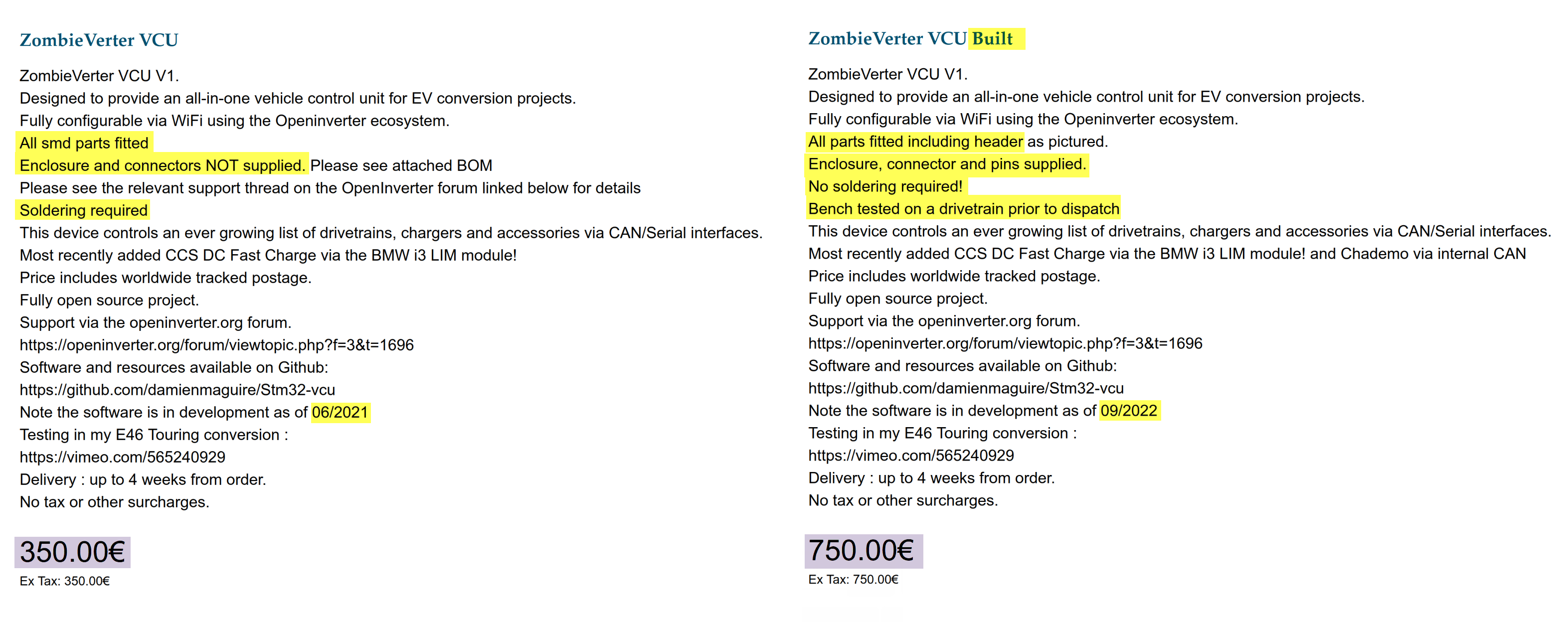

Re: ZombieVerter VCU Support
Following quite a few requests (and an easing up of parts supply) I am now offering a built and bench tested version of the VCU kit :
https://www.evbmw.com/index.php/evbmw-w ... -vcu-built
