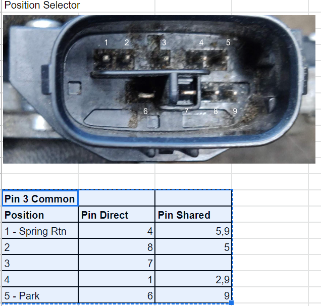

aot93
Posts: 212
Location: UK, West Sussex
Has thanked: 8 times
Been thanked: 48 times
Re: L210 gearbox
Post by aot93 »
I got one too :)
Whilst waiting for connectors to turn up I took a look at and buzzed out the gear selector switch:
part number: 89451-30010
Connector: SUMITOMO 90980-12362
Position 1 being the sprung return and 5 being park
Pin 3 is common, you can see there is a direct connection to a pin for each position and a secondary connection to either 2,5,9 this could be used as an error check
Pin numbers as per drawing:
