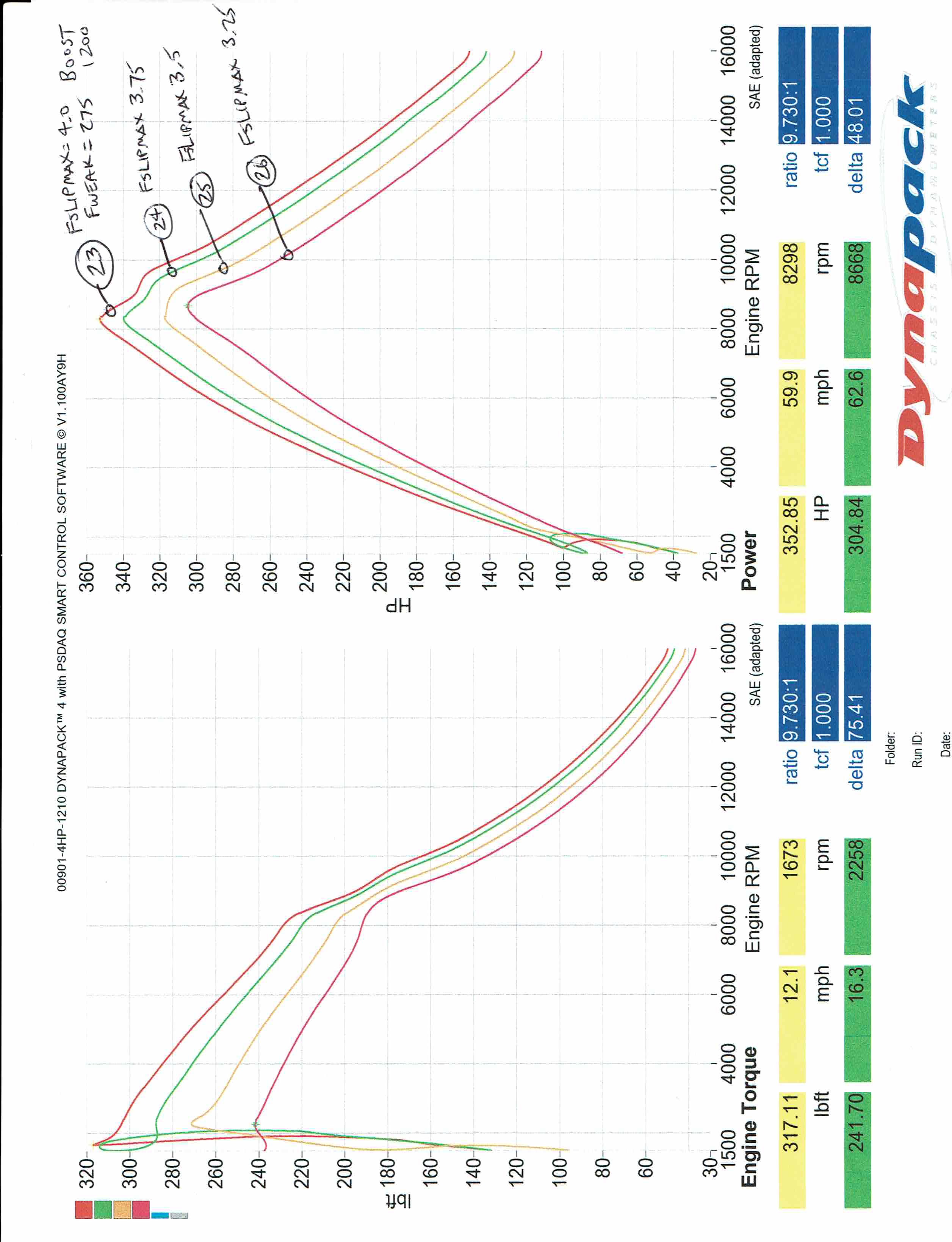

Good results at the dyno. Bottom Line: Max of 317 ft-lbs/353 HP - with low end torque limited by the dyno and conservative tune due to overcurrent errors.
Drive Unit: S85
Battery: 2/3 Chevrolet Bolt Pack 2P96S. Nominal 120Ah, 40kWh
Dyno: Dynapack Hub Dyno.
Things we learned:
- Max torque/power directly related to Fslipmax
- Fweak greatly affects peak power, not just point of max power. Looks like you would always want to be less than 300.
- Torque drops sharply after Fweak point. Fconst is very useful in boosting torque and power after fweak (thanks Jon Volk)
- With sufficient power at higher RPM stock LDU max RPM can be raised over stock Tesla. We managed to get to 17,250 RPM (fmax=575) but not 18,000 RPM
Effects of Varying FSlipMax (no use of Fconst):
Fslipmin=0, Fweak=275, Boost=1200, Fslipconstmax=Fslipmax, Fmax=550, Fconst=550, udcnom=0
Other pulls using Fconst
30- Jon Volk: Fweak=258, Fconst=450,fslipmin=0.87,fslipmax=3.06,fslipconst=450, fslipconstmax=9. Boost reduced from 1850 to 1500 to keep within dyno current limits.
31- Fweak=275, Fconst=450,fslipmin=1,fslipmax=3.25,fslipconst=450, fslipconstmax=6, Boost=1500
32 - Same as 32 but Boost = 1200
33 - Same as 32 but Fweak = 258
34 - Same as 31 but fslipconstmax=9
Drive Unit: S85

Re: LDU parameter tuning
Even with ocurlim, iacmax, and idcmax set to be out of play we were still getting overcurrent errors.
With fweak at 350, boost = 1200, couldn't raise fslipmax above 4.5
with fweak at 300, boost = 1200, couldn't raise fslipmax above 4.0
with fweak at 275, boost=1200, couldn't raise fslipmax above 3.75
Any ideas why? I see that Damien is using fslipmax =5 and the EVShop Porsche = 6
I'm a bit surprised that torque drops off with speed below your fweak. Are you running version 4.55.R or higher?
Lowering fweak OR raising slip means increasing motor current. Thats why you have to compensate on with the other.
I'm not 100% if desat errors are reported reliably on Tesla hardware. So if you say comparator is taken out of the game you might be seing desat errors declared as over current
Firmware version 4.57.R.
I am attaching a datalog file for run 23 (Fslipmax=4.0,Fweak=275). Pack volt/amps are measured at the battery by our Orion2 BMS, UDC/PotNom/Freq/IDC are logged via CAN from the open source controller. Pack Volts/UDC agree fairly well. There is a huge discrepancy between PackAmps and IDC. Either there is a reading error or huge inefficiencies.
Dyno Run 23
Fweak=275 Fslipmin=1.0 Fslipmax=4.0 Boost=1200
Dyno Run 23

Udcnom was not in use for any of the runs. Your power and torque should be better as two Volt packs have less sag and more Power capacity.
