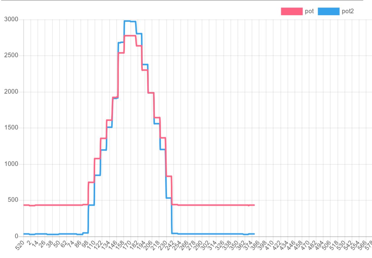

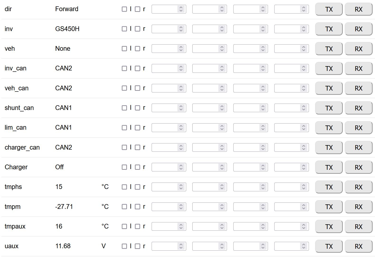

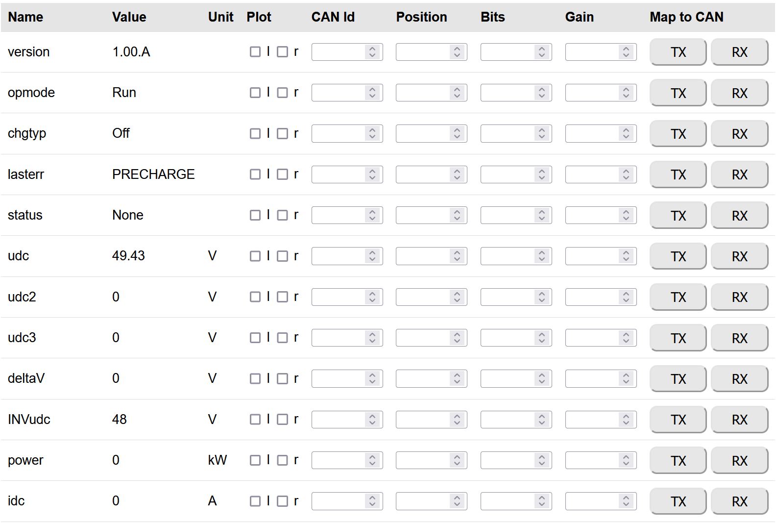

Gave it a quick run this morning. Testing with four 12V batteries for HV (approx. 49V). Initially have vehicle type set to 'none' and inv_can set to 'CAN1', the default. Is there supposed to be three CAN channels to select from the drop down? Only two showing currently.
Torque, potnom and pot1/pot2 plots below. Is torque scaling correct?
Pre-charge and contactor sequence works as expected and as before and opmode changes to 'Run' ok. But also as before, InvStat stays 'off' and no drive rotation in fwd or rev. InvUDC also reading 0V as before but I can measure 12V at the inverter power input (so Zombie has inverter power relay switched on) and 49V at the inverter HV input so inverter should be happy with HV and power (which is all it needed to run with the GS450H vcu). Attaching a few screenshots as I'm probably setting something incorrectly and someone might see it.
So changed inv_can to 'CAN2' and this time INVudc now shows the correct inverter HV (this comes from the Inverter to Zombie communication yes?) But still InvStat remains off and no rotation. Precharge error here was just first start attempt where didn't hold key to start long enough
My thoughts are that it must be something I have incorrect in my wiring (or settings) so will be taking another look at both again although the GS450H vcu still runs the setup (can still connect in either for testing). Tried changing vehicle type to classic and E65. E65 just shuts off contractors as expected as its CAN based. If InvUDC is reading ok, would that mean there is now communication between Zombie and inverter. So I still have some troubleshooting to do :D

nkiernan wrote: Sat Sep 10, 2022 10:25 am Thank you Damien, was looking forward to this update :)
ill check inv stat but I think inv stat and udc inv don't show anything but system is working otherwise. How are you loading new firmware ? through web page or st link ?

Loading through web page using phone. Laptop connection is less stable, then back to laptop for the testing. Looks to load OK with new temp parameters at the bottom of the list. Not set up for stlink

So invstat and invudc as well as other inverter params for 450h and 300h do work. The fact they dont in your setup indicates a comms problem. All I can say is that this firmware works so at least you can narrow down the problems. My first suspect would be a missing clk signal. Remember that the Toyota serial comms do not use any of the CAN channels. CAN3 is not in the menu items as of now as it is dedicated to Chademo.

Jack Bauer wrote: Sat Sep 10, 2022 2:50 pm So invstat and invudc as well as other inverter params for 450h and 300h do work. The fact they dont in your setup indicates a comms problem. All I can say is that this firmware works so at least you can narrow down the problems. My first suspect would be a missing clk signal. Remember that the Toyota serial comms do not use any of the CAN channels. CAN3 is not in the menu items as of now as it is dedicated to Chademo.
Thank you for the reply. Yes, comms appears to be the issue (my bad on the CAN bus relationship, although thought it was interesting it shows correct voltage even if coincidental). So the GS450H VCU appears to work correctly which rules out the inverter/transmission side comms. If the firmware is now working, that means its the 8 comms wires (which I checked again but going to remove the GS450H Tee in case that might have some affect), or its Zombie hardware.
Is there a relatively straightforward troubleshooting option for the Zombie hardware to check the four comms lines ('For Dummies' type thing! :) )?
Could there be a debug/error log option in the web page at some stage similar to the new Tesla Model 3 PCS firmware to help confirm comms for the Toyota stuff is ok?

InvStat is designed to show active comms from any inverter toyota or otherwise. Built In Test (BIT) or loopback test of the hardware would indeed be possible if this were a better resourced project. Sadly it would seem to be just me and between limited time and software skill I wouldn't hold my breath. That said I would very much like to get to the bottom of this in case there is some deep bug still lurking thats not triggered by my bench setup or the setup in the E65. I'll mess about this morning and try to create the problem.
Posts: 4000
Been thanked: 1117 times
Re: ZombieVerter VCU Support
On the test bench this morning with 450h inverter and gearbox connected.
cold start : ok.
restarts : ok.
select a wrong inverter, attempt start, select correct inverter. Works as long as not another toyota inverter is selected.e.g. if trying to run a 450h with 300h selected it will not self restart and a vcu power cycle is required. Other selections ok no restart required. e.g. select Leaf when trying to run 450h.
Firmware load from : Linux laptop, win 7 laptop, android phone: ok.
select a wrong vehicle : ok but wont work with E65 as its expecting CAN. Reselecting the correct vehicle or just "none" or "classic" restores operation without vcu reboot required.
load old bugged firmware with win7 laptop, attempt start, doesnt work as expected. Load new firmware. Works as expected both from warm and cold reboots.
Not sure what else to try here. InvStat and inverter params display as they should.

Jack Bauer wrote: Sun Sep 11, 2022 10:11 am Works as expected both from warm and cold reboots.
Thank you for the detailed checks. It can only be a hardware issue at this stage, I'll have to recheck my soldering. Attaching json if this might help compare settings, maybe I'm messing that up, but don't think so.
