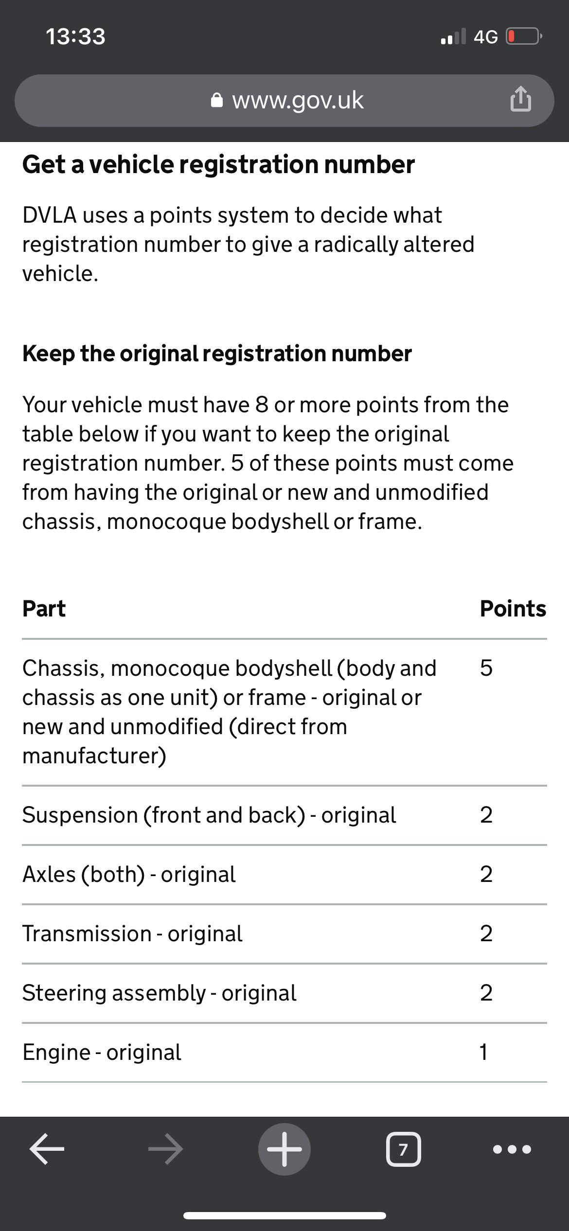

Follow this in black and white terms and no conversion gets passed.EV_Builder wrote: ↑Tue Sep 13, 2022 12:09 pm What is considered the chassis? are sub frames considered chasis if the diff is mounted in those?
- catphish
- Posts: 961
- Location: Dorset, UK
- Has thanked: 98 times
- Been thanked: 195 times
Re: UK IVA Modifications
Annoyingly I've never been able to find any law that defines what constitutes:EV_Builder wrote: ↑Tue Sep 13, 2022 12:09 pm What is considered the chassis? are sub frames considered chasis if the diff is mounted in those?
1) The chassis
2) A modification
I strongly suspect subframes are considered part of the chassis, and would definitely always attempt to use the existing gearbox/differential mounting points. I was lucky that this was possible in my car, even though it leaves the SDU hanging rather low to the ground!
I think the thing that's confused most people is what counts as a modification. Can we drill holes? Can we Weld things on? Can be glue things on?!
I really wish the DVLA (I'm not really clear why the DVLA and not the DVSA are responsible here) would publish more explicit guidelines.

Well my car will be a good showcase to answer many of these questions when it is inspected by the DVLA. It is modified in the following ways:
1. Chassis rails drilled for a new gearbox mount
2. Boot floor replaced to accommodate a battery box.
3. Rear subframe added new diff mount
4. Front subframe added new motor mounts
5. Various small holes drilled to the sheet metal for mounting brackets.
Any one of these modifications could count as 'radical' alteration...
I'll go on the journey with DVLA and see where it leads, but my suspicion is that it will need re-registering at which point the project for me will likely be over and I'll move on.
DVLA will only apply changes to v5 ... Well they used to (look at my old car gr03vnx) if the installer was registered with uklpga and you got a letter to send in with stamp on it. Yes they do cut holes!
At the moment DVLA are just being a pita ....best joke theory is someone's wife ran away with a guy with a Tesla that's why they hate EVs so much!
DVLA basically want to ban it on grounds of safety because they don't understand it, but don't have laws to do that so they are just awkward.... if they were proactive they would write a specification/publication setting out exactly what you can and cant do.
The short answer at the moment is
(1) buy pre 2001 car (X reg or older)
(2) don't even think of putting bolt or weld onto structure unless you are confident enough to blag it that it was there before from the factory
(3) if you buy a post 2001 car it's basically stuck with its original engine type...although in theory a post 2017 can be changed I suspect excuses with type approval will tie you in knots (my opinion at this stage as 2107 is too new at the moment)
