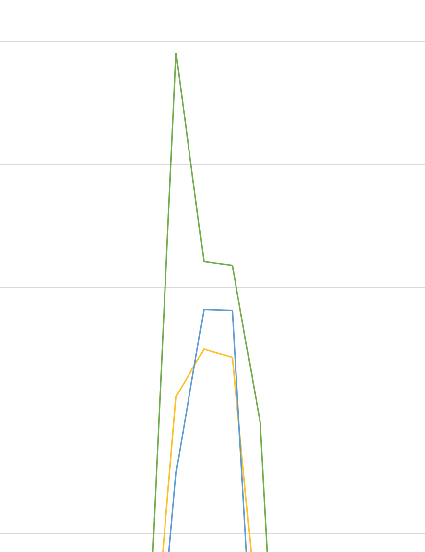

Possibly duff data over the serial connection.Pete9008 wrote: ↑Mon Sep 19, 2022 4:04 pm No idea what's going on therethere are numbers in the data that shouldn't be possible (196.12 and 1150 for potnom for example). Either they are data capture artefacts and not real (but then in previous plots they coincided with trips which indicates that they are real) or there is a noise problem in your install that can affect multiple ADC channels (Id, Id, resolver, potnom). Are there any other potential noise sources on the car?
Just looking at the moving.csv and the iq overshoots a fair bit some times, but looking at the stationary they looks good (ignoring the middle where what appears to be duff data)

They all look pretty good, still a bit surprised how low a kp and ki you need though. Is it still tripping when moving?Bigpie wrote: ↑Mon Sep 19, 2022 4:42 pm Possibly duff data over the serial connection.
Screenshot 2022-09-19 at 5.38.20 pm.png Just looking at the moving.csv and the iq overshoots a fair bit some times, but looking at the stationary they looks good (ignoring the middle where what appears to be duff data)

That all looks pretty good to me, bit of overshoot on the currents but that could be down to the throttle. Assume there were no cutouts? What kind of max speed (mph) are you getting up to on runs like this?
I'm still struggling to see why you might be getting cutouts. The angle measurement is the only thing I can think of, an error in the angle could cause some large currents to build up pretty quickly. I was hoping that moving as slowly as possible, even allowing for the relatively slow plot update, would show a nice progression on the rotor angle (ramping from 0 to 360, step down to 0 and repeat, or vice versa). Instead this is what the plot looks like: Really not sure what to make of this, either the motor was going too fast, there is something not right with the resolver setup or I am missing something.
Sanity check - I'm guessing that your gearing will be quite high with the fast spinning motor so say 10:1 (complete guess, the outlander revs to 10k with 7:1 and yours goes up to 14k). In order to plot right the motor electrical speed needs to be < say 0.4Hz (update rate is 0.6sec so 4 graph points per rev), allow for 4? poles so 0.1Hz. Say 60cm wheel so 0.6*pi*0.1/10 (m/sec) = 2cm/sec. So as long as you were going slower than that the plot should show the motor angle OK. Hmm, that's pretty slow! What do you reckon, were you going that slow?

Ahh OK, I'd been incorrectly assuming that you were using the outlander gearbox, so no gears, but having looked at your build thread you have the outlander front motor coupled to the VW box. The outlander motor looks like it should be pretty potent - in the outlander the motors are responsible for all low speed acceleration so it really surprises me that you can only pull away in 1st. I know you only have the one motor while the outlander has two but your car is only half the weight.Bigpie wrote: ↑Tue Sep 20, 2022 7:33 pm I top out at 35 mph maybe 40 in first gear which I have to use to get rolling. Though with 5.20R I can move off in second it's not usable, but I should have used that for the slow logging if not I'll find a downhill and do it in fifth. Pretty sure resolver is good. It holds nicely on hills on the throttle.
I'd have expected you to be able to pull away in pretty much any gear, just slowly in the higher ones. What happens when you try, does the car move or does the inverter trip out? Have you any feel for what kind of power you are getting out of the motor?
With the resolver I'm clutching at straws a bit. Your stationary tests show that the inverter can control the currents well and can put high currents into the motor, the current measurements look reasonable, so the resolver is the only thing left. Your comments about the car not moving with some ki/kp values also make me wonder a bit whether there could be some kind of rotor angle dependant effect too?
Edit - What would be great to see is a real log showing something similar to this: This should be possible in the real world shouldn't it?
