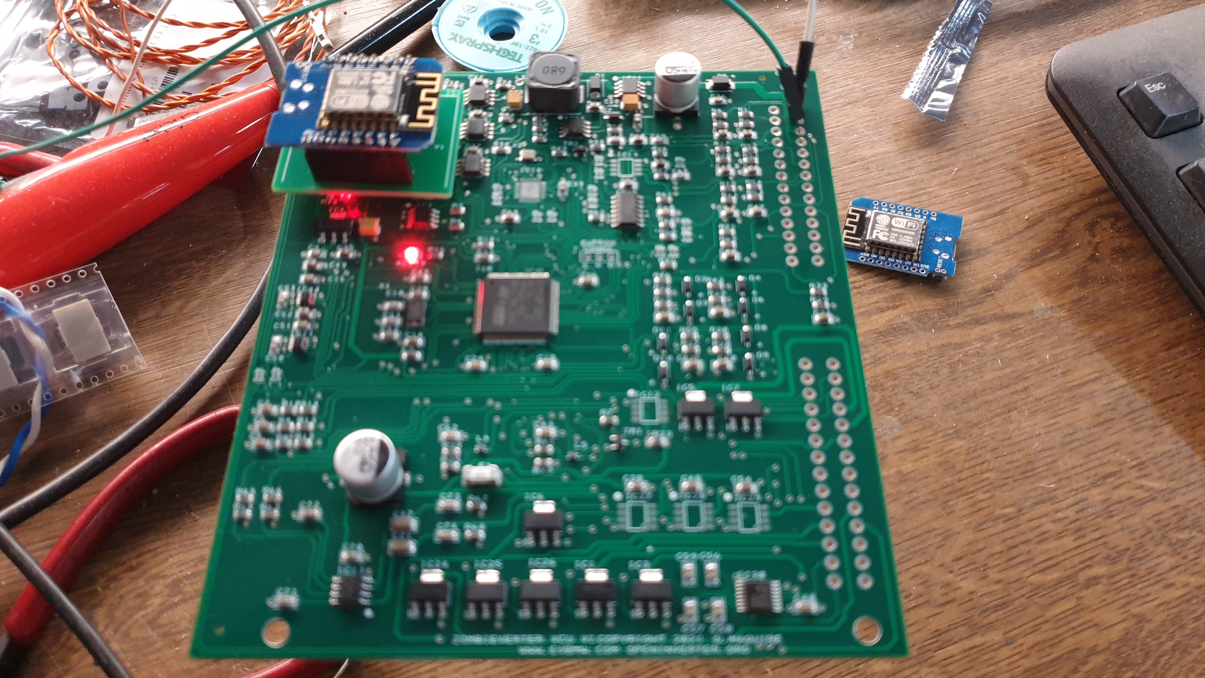

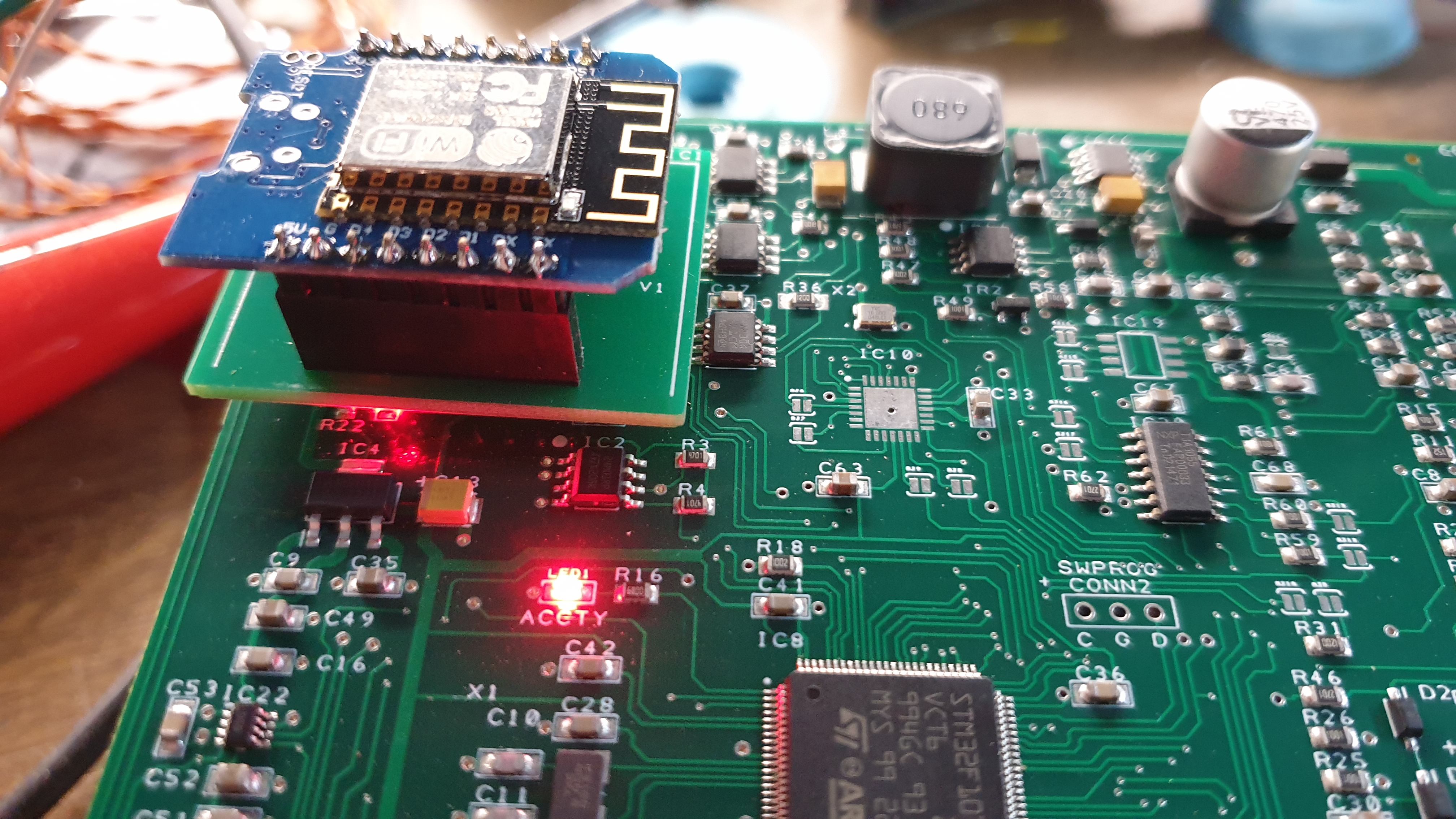

It seems I've "Bricked" my ZombieVerter !
I have a GS450h transmission and inverter (no shunt) on the bench and powered by a 20V 5A bench power supply. Using a firmware version I compiled from last March, it works fine within the power limitations with a 10k pot as throttle. - all very smooth.
I loaded the latest version (1.01) of the firmware via the onboard web front end and set the parameter settings to those that previously worked.
The first thing I noticed is the motor spindle oscillate a few degrees for a few moments when the ignition is applied, which it didn't on the earlier version. Also, I found the throttle had to be wound up much higher to get the motor spindle to move and when it did, it was a shaky rather than smooth start. At the same time, the PSU voltage was dragged down from 20V to 11V and current went to the max, but the motor didn't run smoothly.
I then went to reload the earlier working firmware version and the upload froze at 90%.
After power cycling the board, the little red led flashes but the web interface refuses to populate the form (just titles and no parameters) and the board is no longer activating relays/running the motor.
I now have a truly Zombie-ed ZombieVerter - Can anyone suggest how to bring the board back to life ?

try st link cable and just load firmware again , good chance the vci is fine just the wifi module is causing issues.

As I explained in the 3 video series linked on the VCU wiki page, a firmware lockup on upload does not equal a "bricked" vcu. Just power cycle the board and reupload as the bootloader is still running regardless of what firmware is in use on the device.
To reiterate, the released firmware has been bench tested AND car tested on 450h systems. I'm in the process of swapping my bench 450h system into the E39 for even MORE testing.

I just saw your photo here...Jack Bauer wrote: ↑Tue Sep 20, 2022 8:44 am As I've mentioned in other threads the two most recent batches of Olimex ESP8266 wifi modules I have received are terrible. I'm getting over 50% failure at programming stage. Yesterday I had to program 6 modules to get two that would work and I'm observing a number of folks here on forum with issues programming over wifi and accessing the web interface. To that end I have been experimenting with a new module that seems to be much better and have designed a little adapter board to allow it to be used on existing designs without modification. Once the prototypes arrive I will do some more testing and give an update.
I would suggest you to simply wrap insulating tape around the ESP and slot it within your casing. That may prevent any unwanted contact with some power pins.

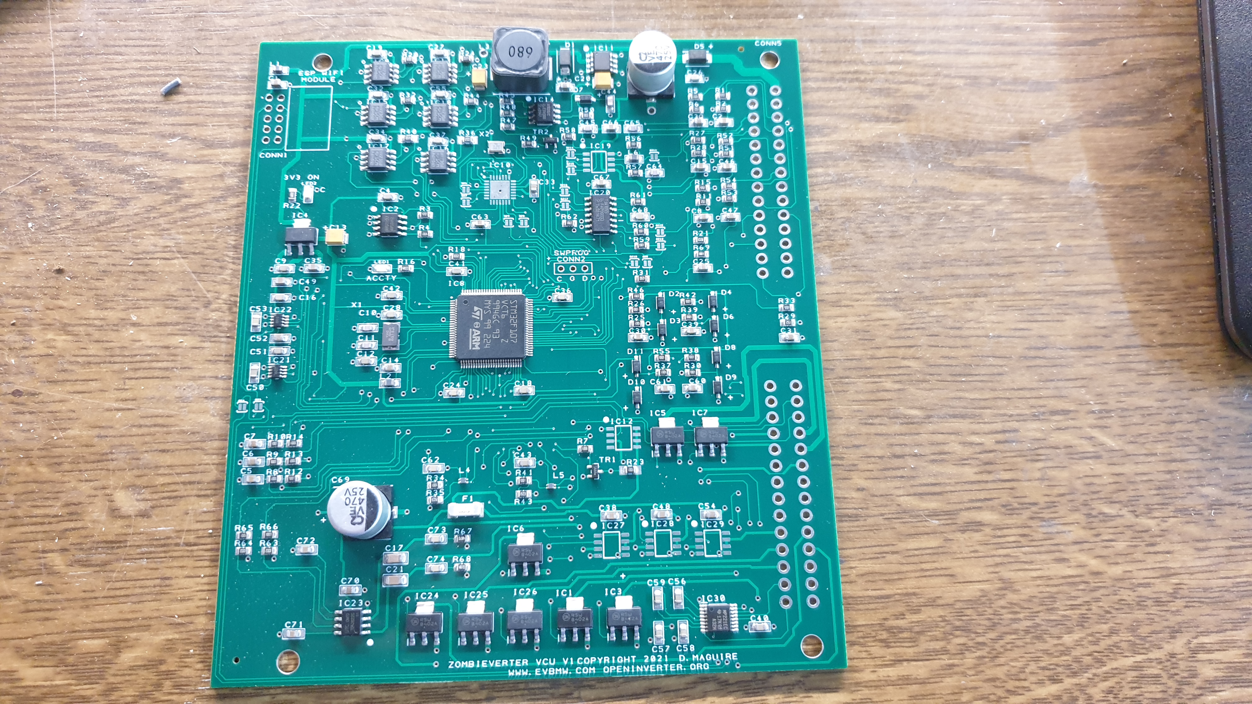

Received today the first batch of VCU board with STM32 and most other parts fitted. Been a long time:) Also Wemos wifi adapter boards received and tested working. Once current batch of Olimex modules are exhausted (and with 50% going in the bin it wont take long!) all kits will ship with Wemos modules and adapter board. We'll give it a few months to bed in then I'll do a design rev to mount the wemos on the pcb directly.
