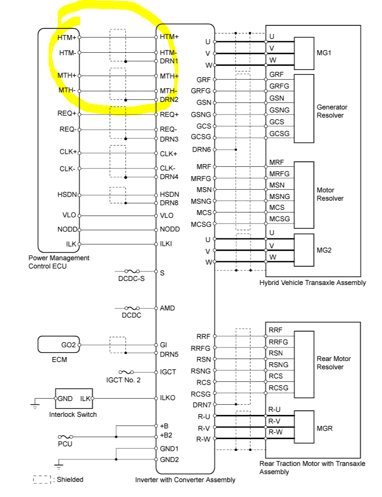

I think that not CAN log is vital here but communication between inverter and HV ECU (PMC), those 2 interfaces highlighted: .
Those are not CANs (Physical Layer is similar) but differential serial comms and you need sniffer to log the communication.
BTW: has anyone logs from Toyota/Lexus with MGR?

Where would I start reading to see what's involved in logging that data? My wife's parents have a Rav4 Prime that I could probably capture data from if it wouldn't be too intrusive, but since it's A: not my car and B: quite new I can't go too crazy with it.hombre77 wrote: ↑Thu Sep 29, 2022 12:38 pm I think that not CAN log is vital here but communication between inverter and HV ECU (PMC), those 2 interfaces highlighted:image.png.
