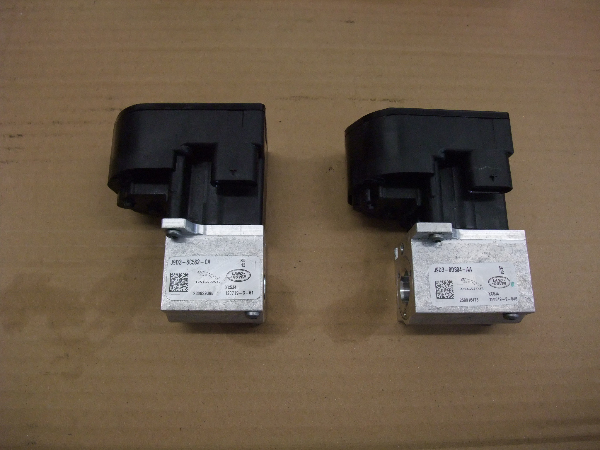

Stripped the I-Pace valve block down and ended up with these air con bits to use:
A couple of motorised ball valves. The left hand one is simple ball valve and may not get used. I'm hoping the right hand one is an expansion valve and if so it will get used to try and switch the Smart's condenser to work as an evaporator.
A standard thermal expansion valve with a solenoid valve to enable/disable flow and a heat exchanger. These will be split and the valve will be used to replace the existing one on the Smart's evaporator to give on/off control (if it can be made to fit, if not the simple ball valve above will be used), The heat exchanger will be used as a condenser for heating the cabin and battery (if it can take high side pressure - any thoughts on this?)
An electronic expansion valve with a heat exchanger. This will be used for battery pack cooling (hopefully not be needed but allowing for it in the design just in case).
There are various other bits - refrigerant pipes and connectors, water hoses and what I think is either a temperature sensor or pressure sensor for the low side refrigerant. Even if I only use half the bits it will have been worth buying the valve block.
VAG water heater as a backup for heating when it is too cold for the air con to work in heat pump mode.
