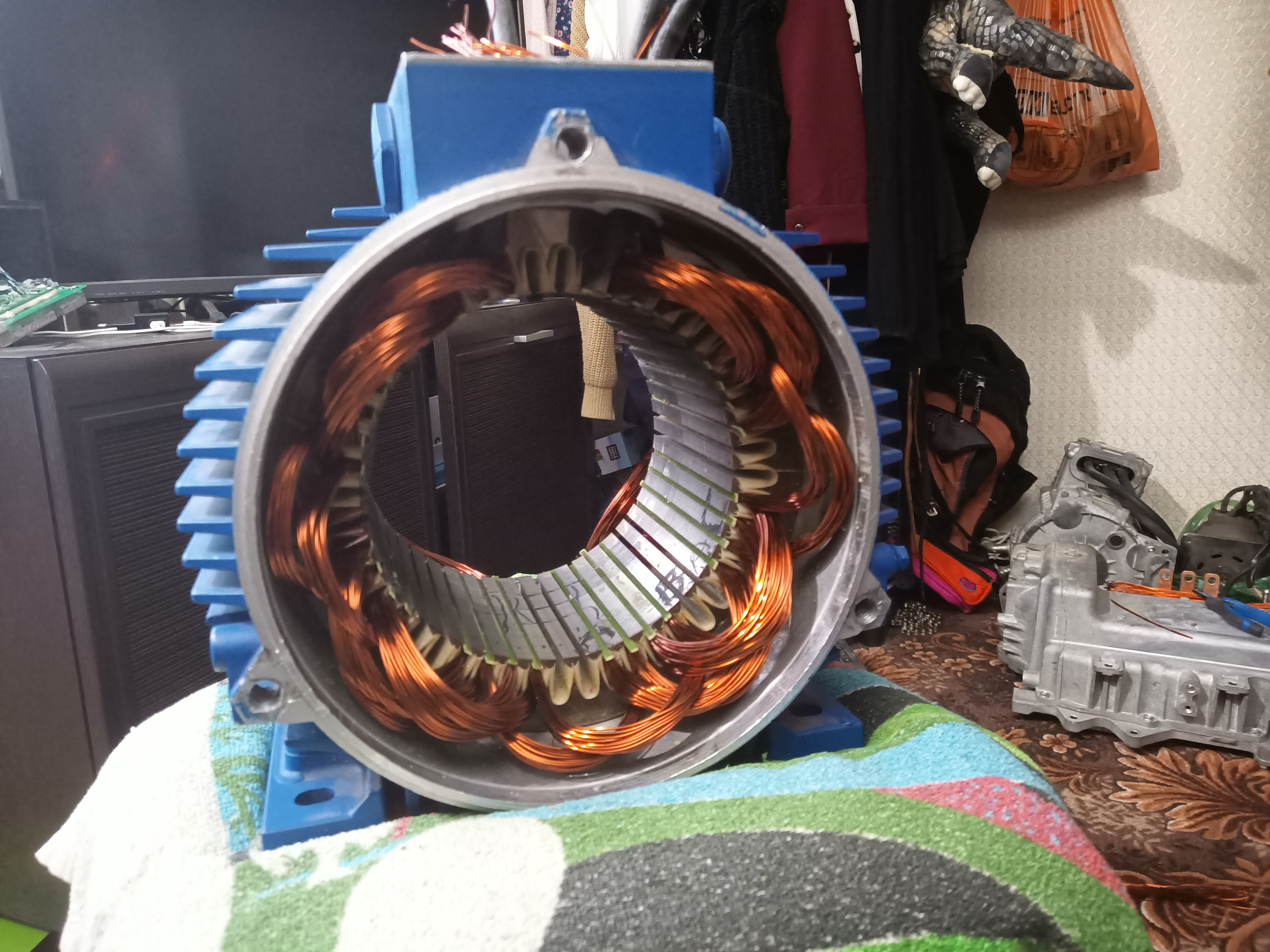

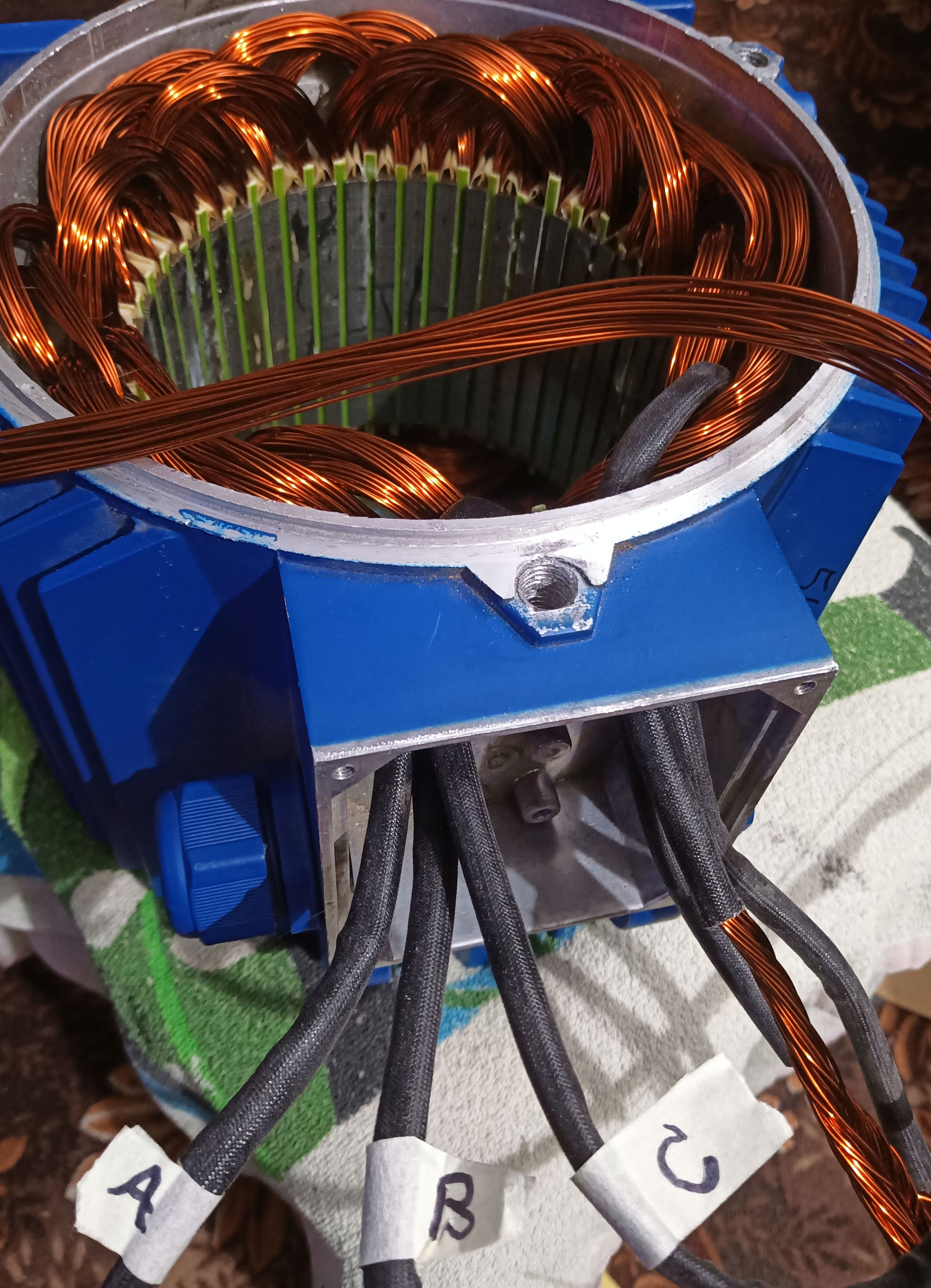

Interested to see you results, any pictures of the re wound stator?

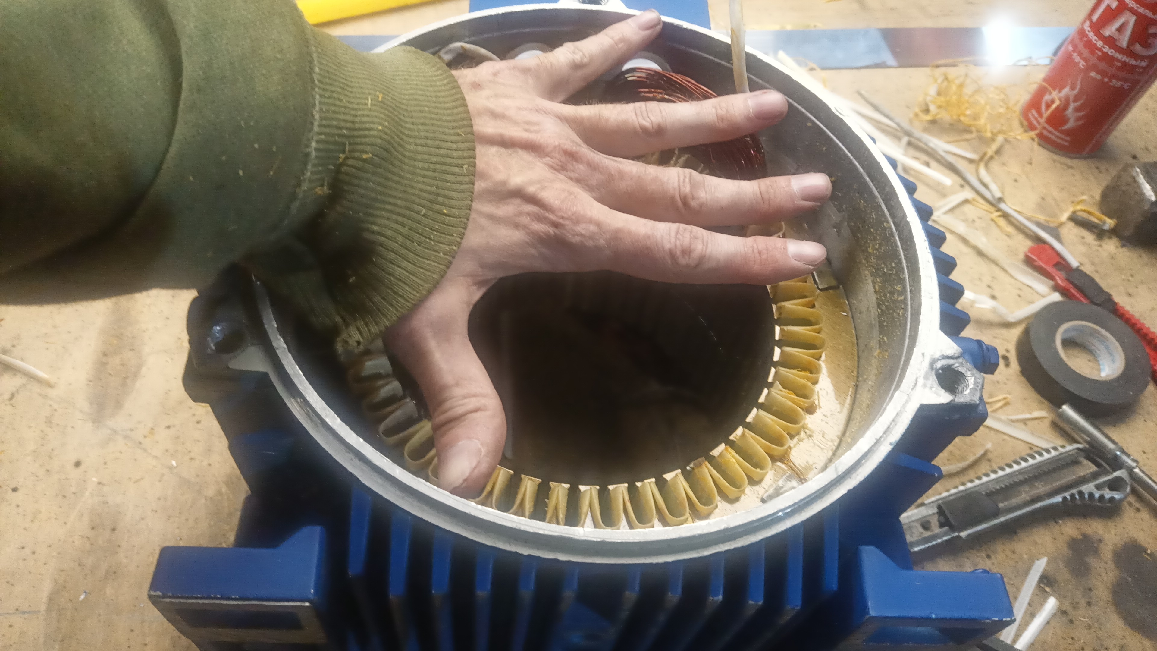

Ev8 wrote: Fri Oct 07, 2022 3:56 pm any pictures of the re wound stator?
in the second photo, two new phases have already been wound. the third phase I am winding right now))

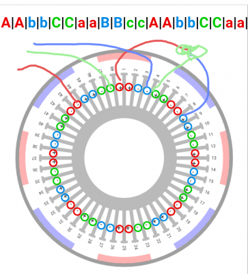

in the future, I expect to connect this with the standard gearbox of an old USSR car and see if an industrial converted motor can be compared with a small Tesla motor (the dimensions are quite comparable, I have an even closer size in the ldu motor).
my phase cross section is now 21 square mm

Romale wrote: Fri Oct 07, 2022 3:58 pm in the second photo, two new phases have already been wound. the third phase I am winding right now))
Sorry thought that was a before photo as you said you’ve rewound to 2 turns, it looks more

Ev8 wrote: Sat Oct 08, 2022 8:07 am Sorry thought that was a before photo as you said you’ve rewound to 2 turns, it looks more
so after all, the winding is performed not by one wire, but by a whole group of parallel ones. )))

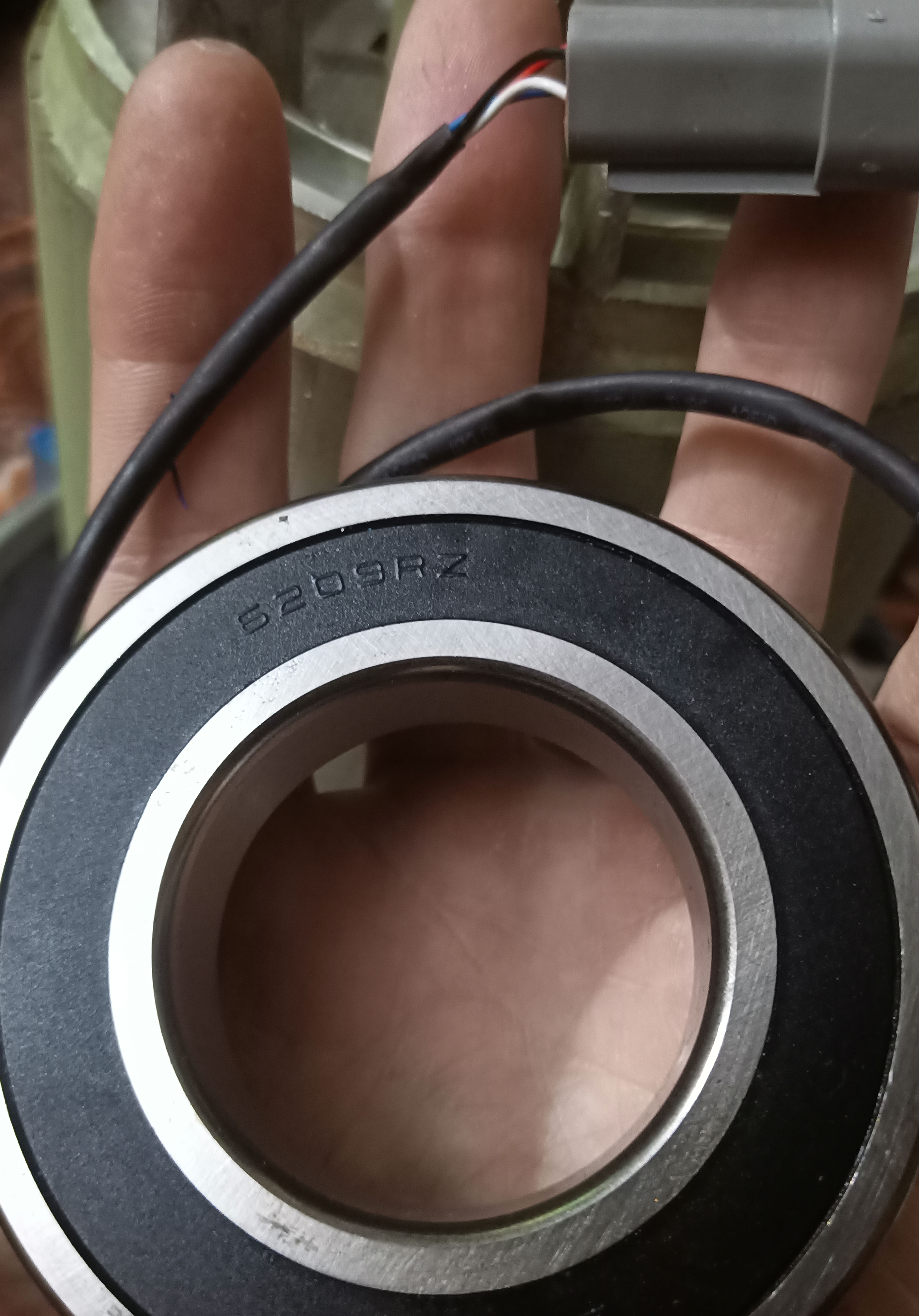

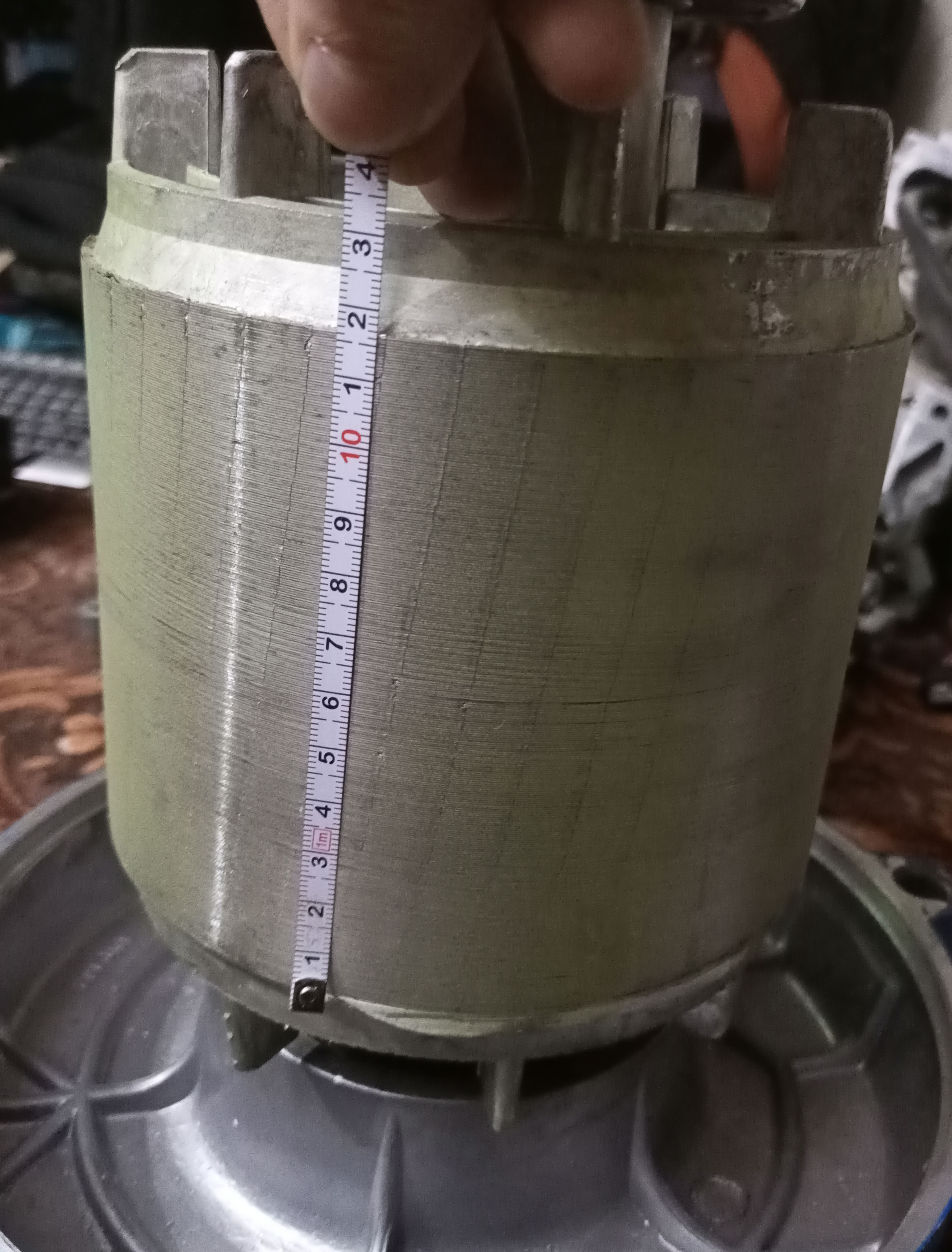

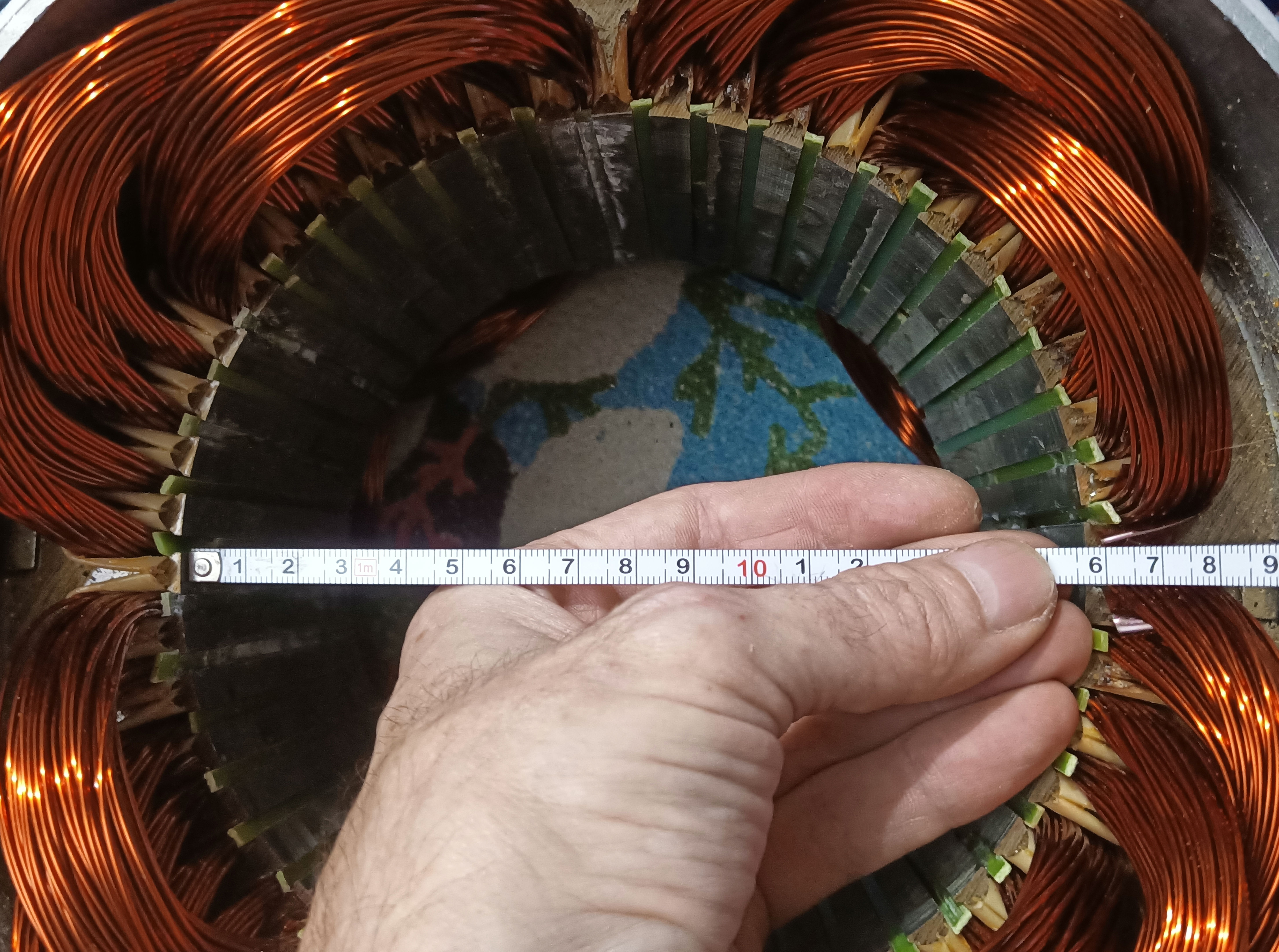

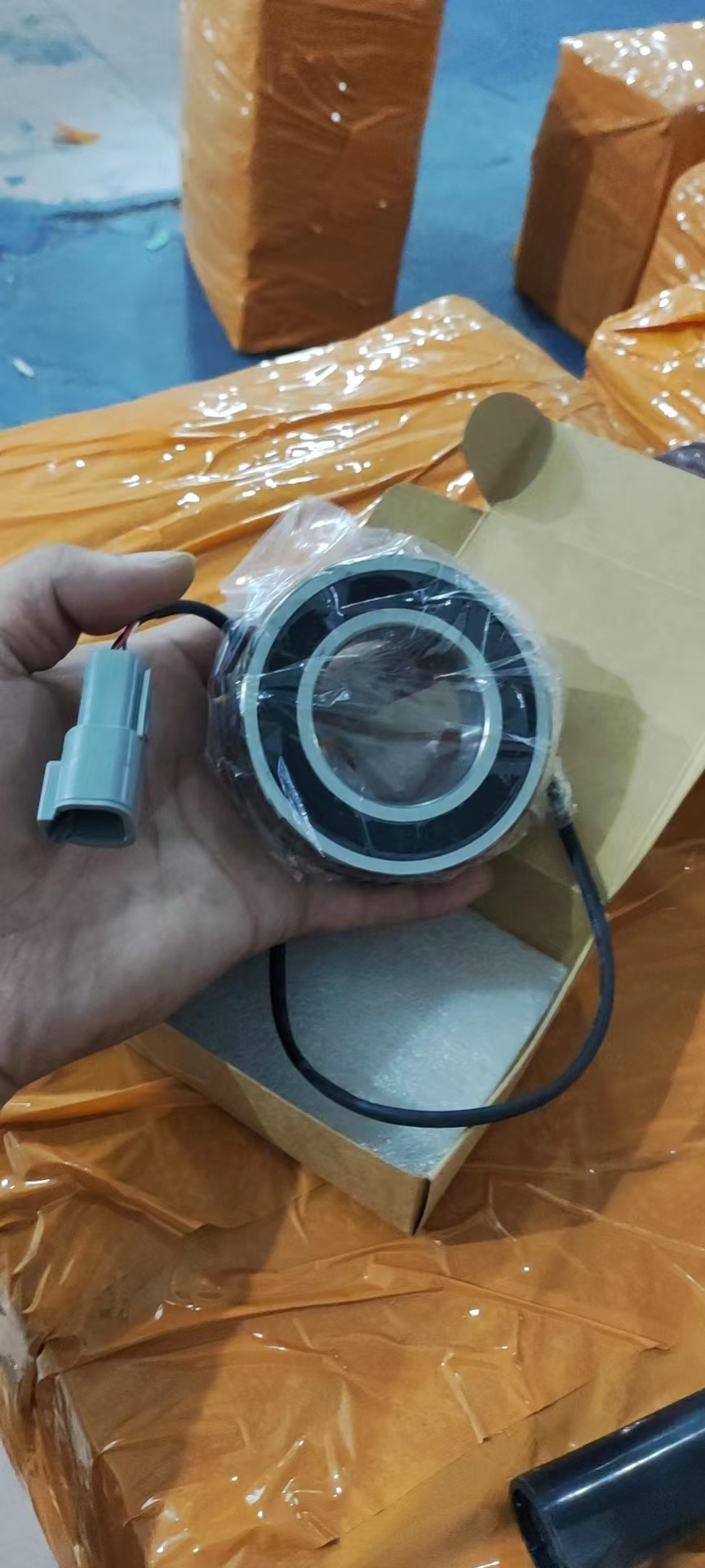

skf bearing in replacement of the regular one. The new one contains a built-in A/B signal encoder.
rotor length 120mm
inner diameter of the stator 160mm
I have completed a new winding. it remains to clean a lot of ends and make tips, tie the frontal lobes with a cord and impregnate it with electrical varnish.

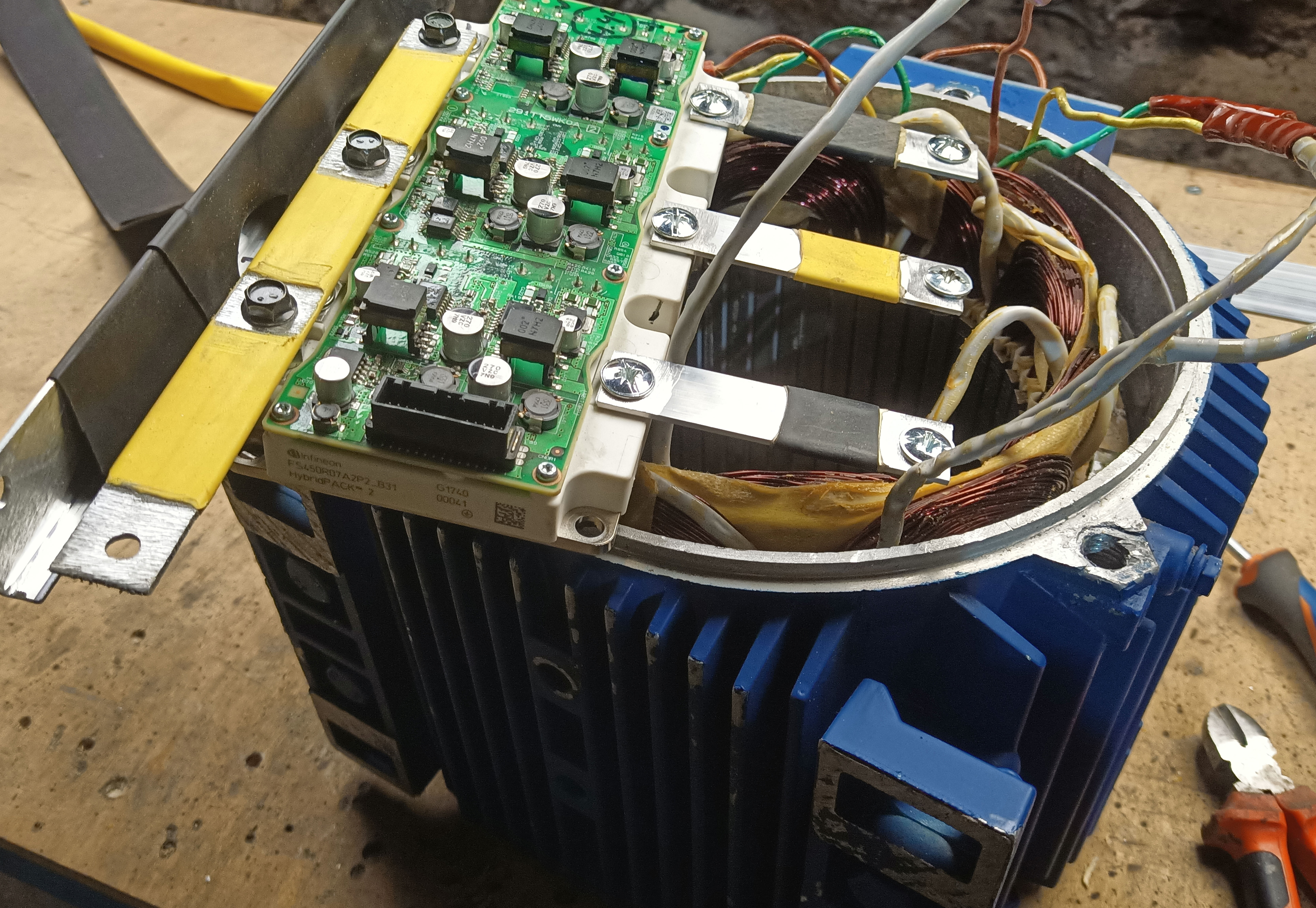

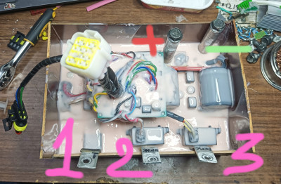

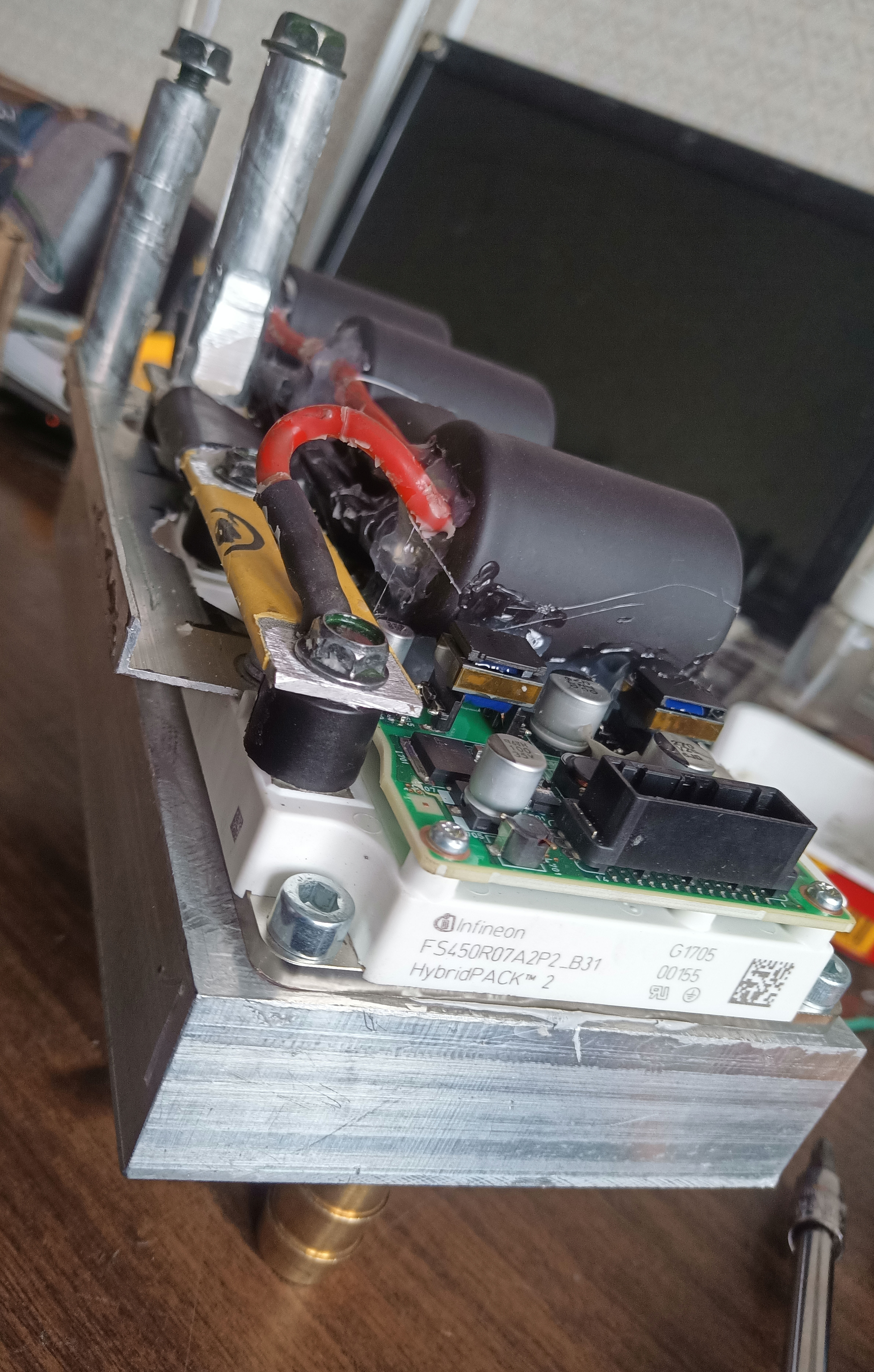

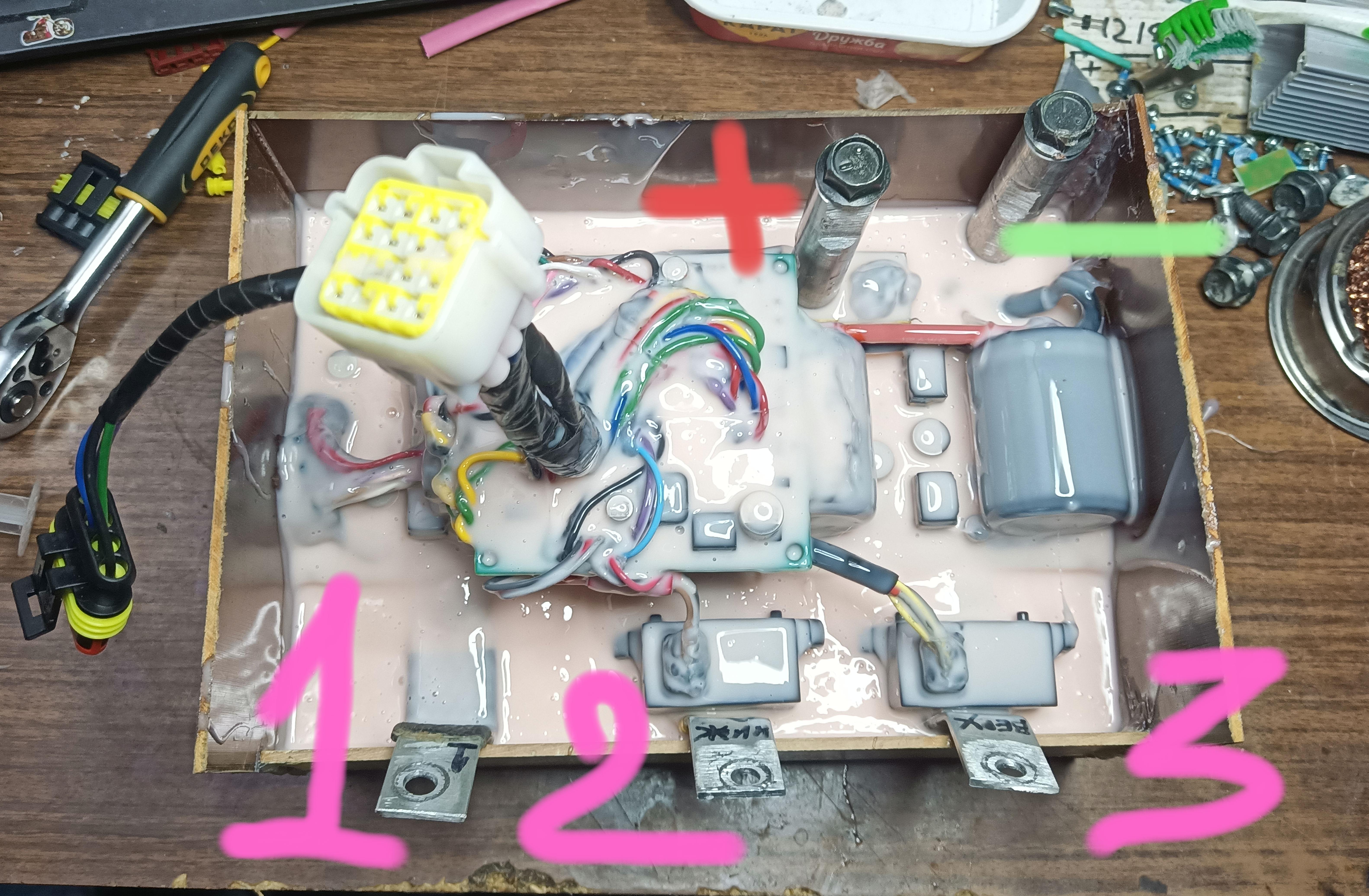

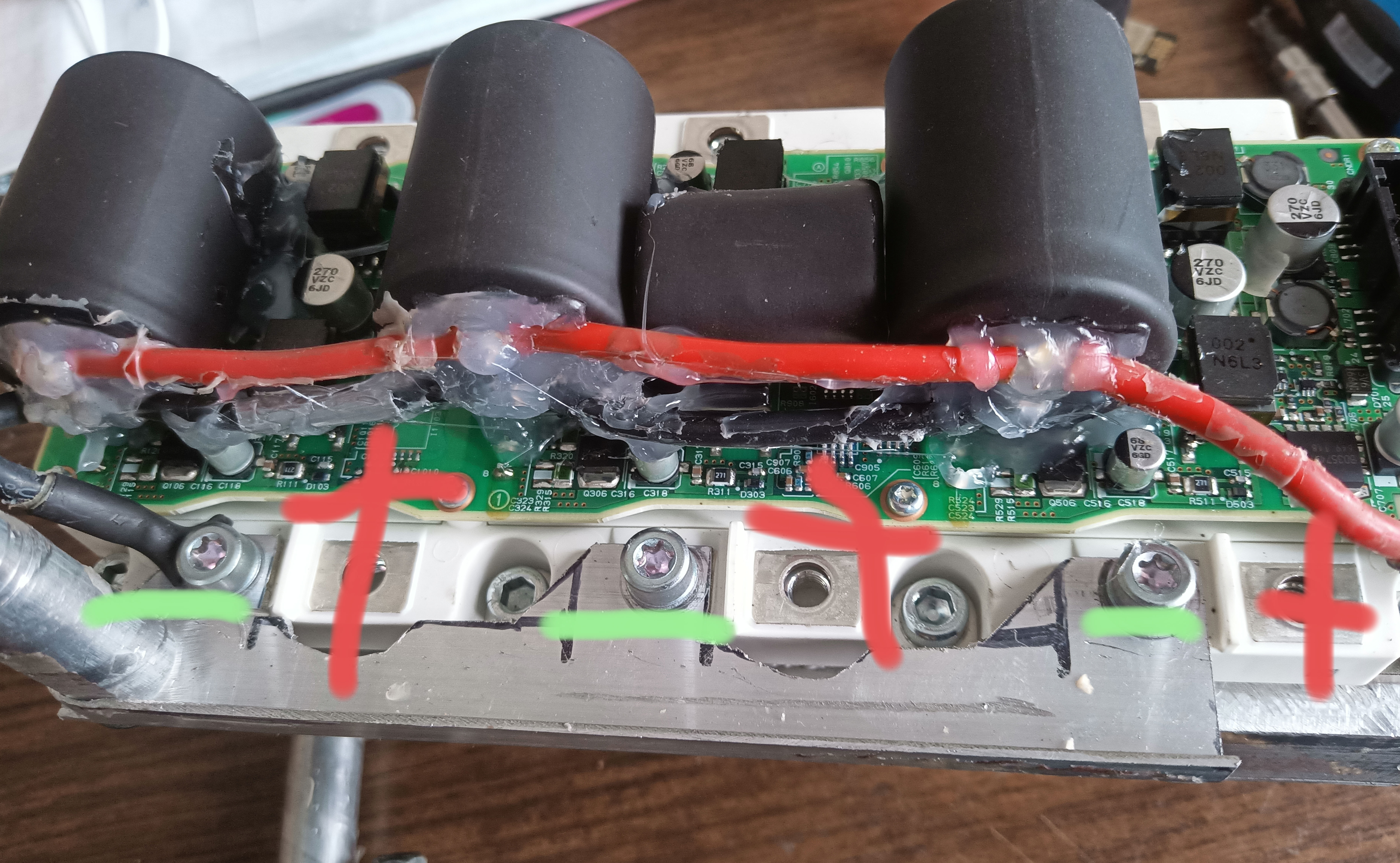

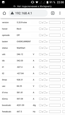

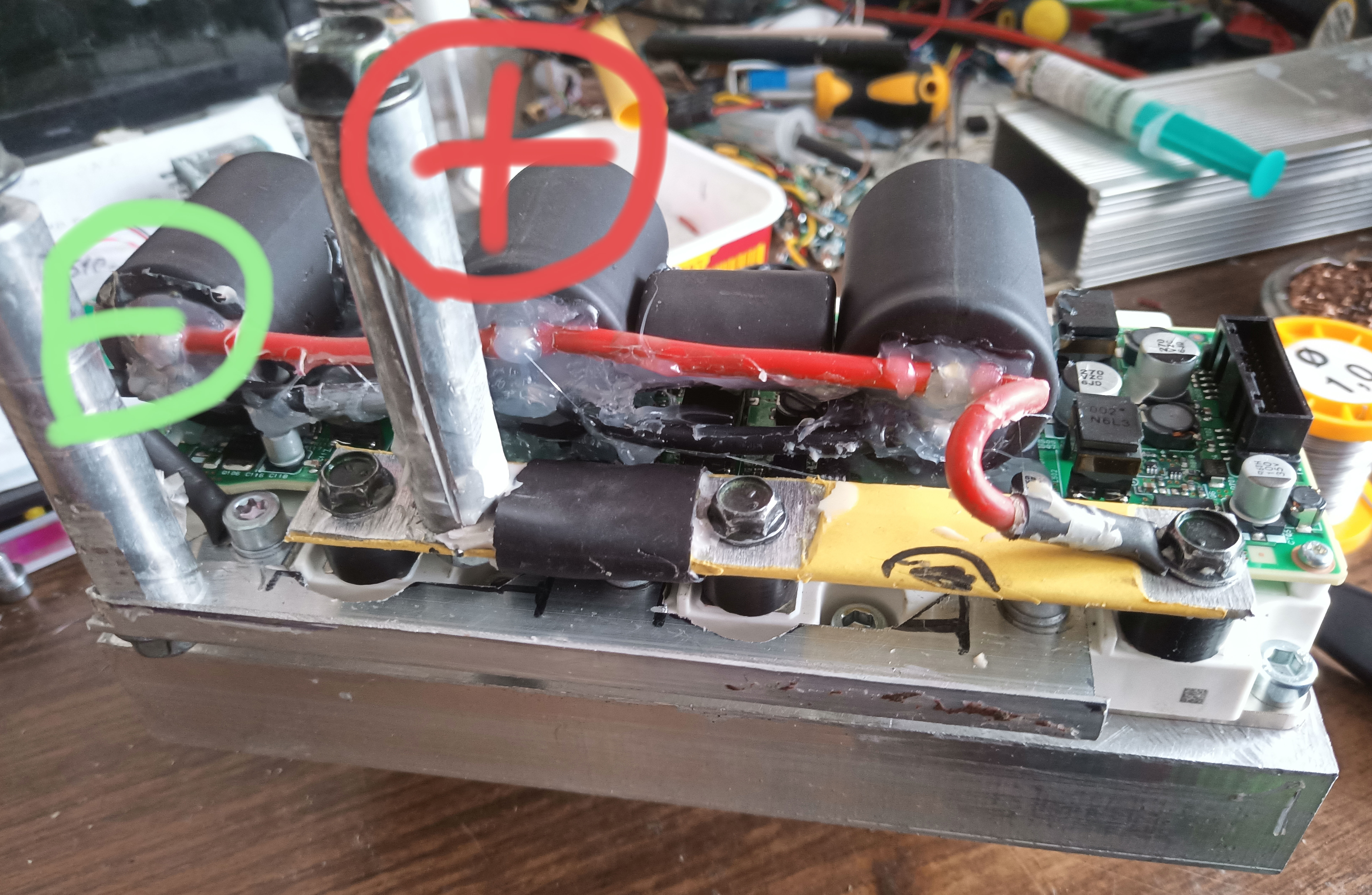

while the big motor is not ready, I decided to test the performance of the power module from Nissan note-e
evil neodymium :twisted:

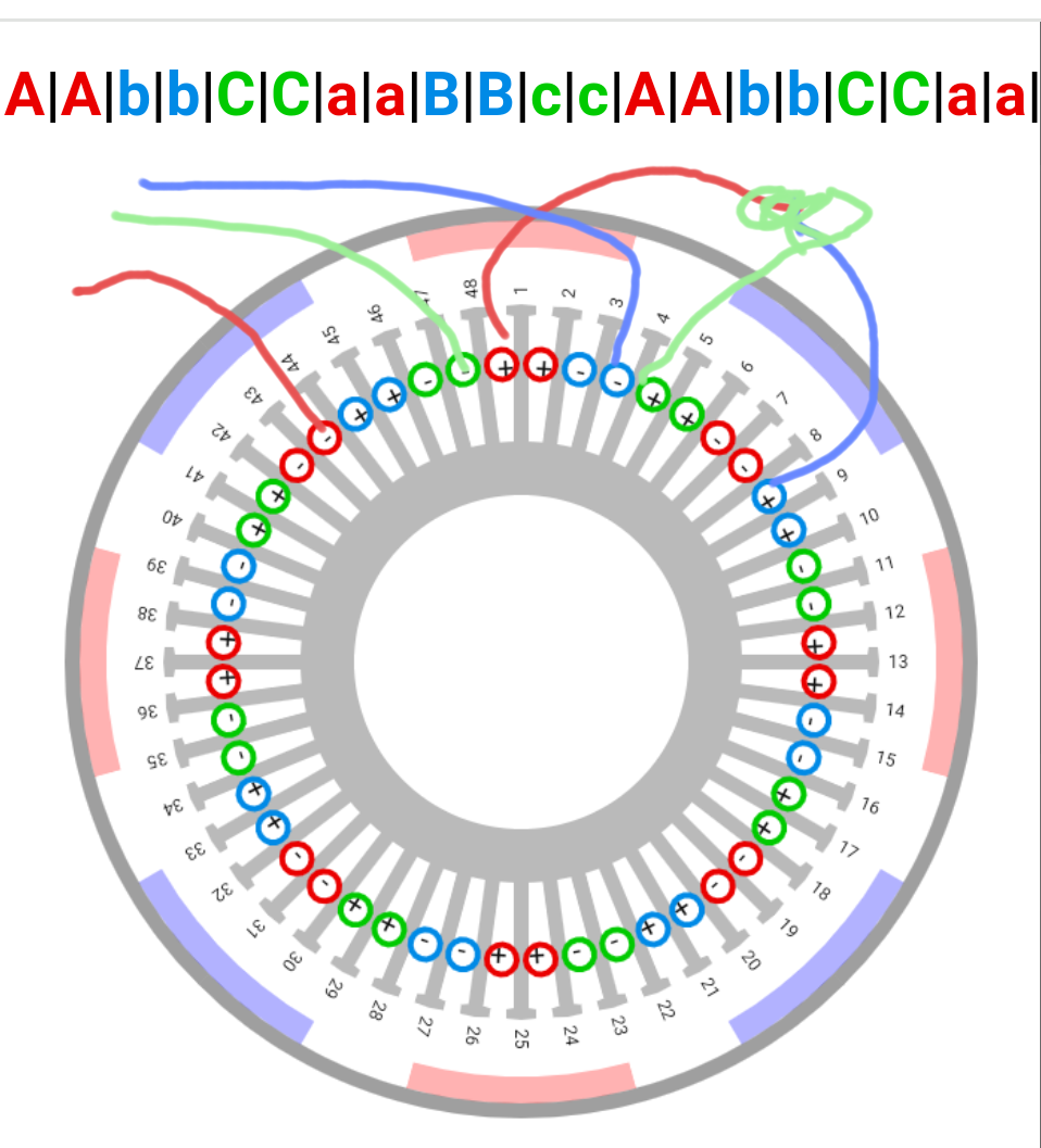

what is your total number of turns per phase? Now I use an engine rewound by 12 turns per phase if I turn it into a star. as it turned out, this is a lot and the car easily eats 60 km per hour. this is 150 Hz. then there is a strong weakening of the field. If you turn it on with a triangle, the inverter does not pull it. Protection for 500 amps rms is triggered. the ends of 16 squares come out of the engine. and the battery voltage is 132 volts.

yaroslav wrote: Tue Oct 11, 2022 8:34 pm what is your total number of turns per phase?
it depends very much on the size of the motor, the diameter of the rotor and the length of the groove. also depends on the number of poles. my motor contains 48 slots for the wire and is eight-pole (4 pairs of poles), I wound two turns in one groove. only one phase contains 16 turns (8 coils) . I do not know how well it will go. I may have to redo it after testing.

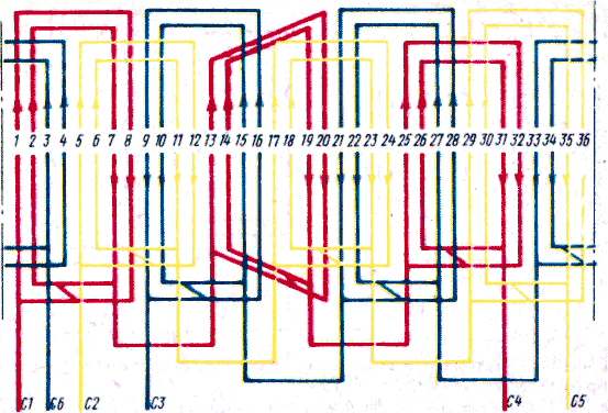

Romale wrote: Thu Oct 13, 2022 9:03 pm how many turns do you have in ONE coil?
In one coil there are 2 turns in 3 parallels, it turns out 6 turns

yaroslav wrote: Fri Oct 14, 2022 7:07 pm In one coil there are 2 turns in 3 parallels, it turns out 6 turns
3 parallels?? and what is the cross-section of one wiring? it is difficult to wind a good amount of cross section with very thick wires

Post by Romale »
I have 2 turns of 28 wires made in one coil in parallel. the diameter of one wiring is 1 mm.
