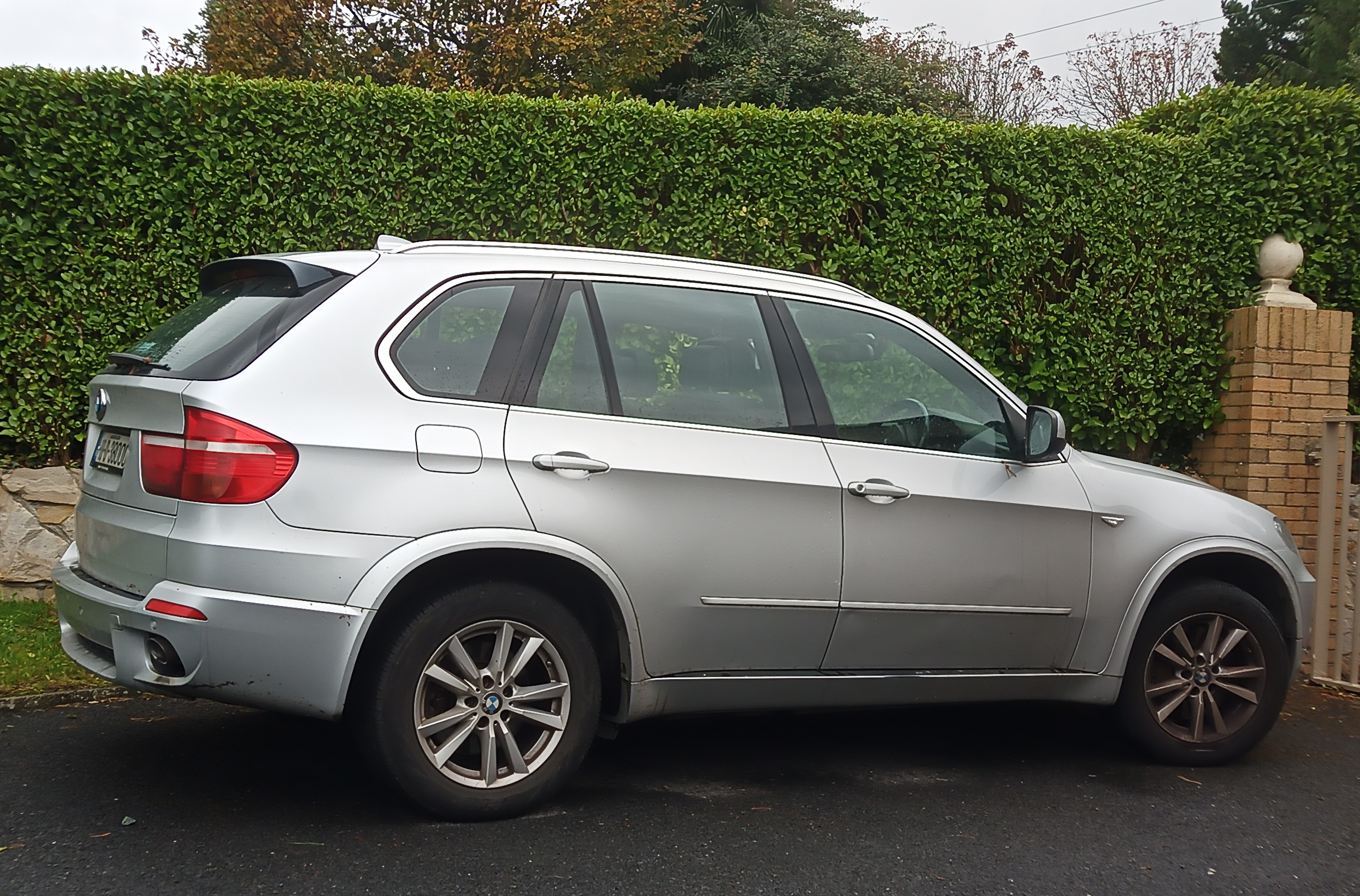

Hello there!
I'm new to the forum & a complete novice so despite the fear of making myself look like a fool I decided to post my thoughts on my project to see if I'm completely mad or just stupid!!
I've owned my X5 for many years now but recently I've been having too much hassle with turbos, particle filters, oil leaks etc etc - the car will not pass the road test & I have been advised to get rid of the car however, I love the idea of converting it to EV for a number of reasons (mostly environmental) but I also love the car & am very reluctant to get rid of it.
I've looked around & have found no one that has converted an X5 so my first question is am I completely mad to take this project on? Are there good reasons why no one else has done such a conversion?
I work in the construction industry & would love to use the car again as my daily driver. I never use a trailor or carry huge loads in the car so limiting the car to 2 wheel drive during the convertion will not be an issue. Range isn't a big thing either but we can get to that at a later stage. I have friends that are electricians that I can all on & another friend who is like McGuiver when it comes to mechanical issues so I think fabrication & general wiring should not be too much hassle, However CAN bus etc is scarying us all to bits!!
If the consensus is to proceed, I am absolutely opan to all ideas & advice but for all its worth, I was thinking of using the Lexus GS300h gearbox & inverter for no other reason than there's no need for the oil pump & controller as pointed out in Damian's video (as opposed to the GS450h) & the ZombieVerter but please feel free to tell me I'm mad to do so & I should use another drivetrain!
I have bought nothing yet & don't intend doing so until I get some advice or direction so all thoughts would really be grately appreciated.
If there is anyone interested in taking on the CAN bus side of things for this project, I'd be more than happy to pay for someone's time, advice, software, hardware whatever is required.
As I said, I'd really love to get people's thoughts & advice so all comments are most welcome.
Thank you!!

With the work going on with the Tesla Model 3 drive units, that could be a nice fit for a project like this, fit in place of the transfer case at 90 degrees to normal orientation and driving front and rear diffs. Similar setup is used on many land rover setups with the Tesla Model S units. You'll see my project in the projects section, L322 beached whale, where I've opted to keep the transfer case and using the GS450H drive, so similar to your original idea. What I've found is the drive eats up some battery space up front and alignment with the transfer case is tough when accommodating the front diff, but workable. If you're considering no transfer case and the GS300H to rear diff only, that makes if very neat and frees up the whole front area for batteries. I'm fitting batteries underneath, which affects transfer case position and so transmission position.
I'm looking forward to seeing Damians L200 conversion with the leaf setup! Could that be a nice option coupled to your transfer case!
Just dive in, CAN will get figured out :) get a set up to start recording CAN logs and record now while its still running!

I'm thinking of keeping my project as simple as possible so as you said, I was thinking of removing the transfer case & bolting the GS300H to the rear diff only. I think this will be a lot more straight forward & leave plenty of room for batteries & all the other components in the front.
