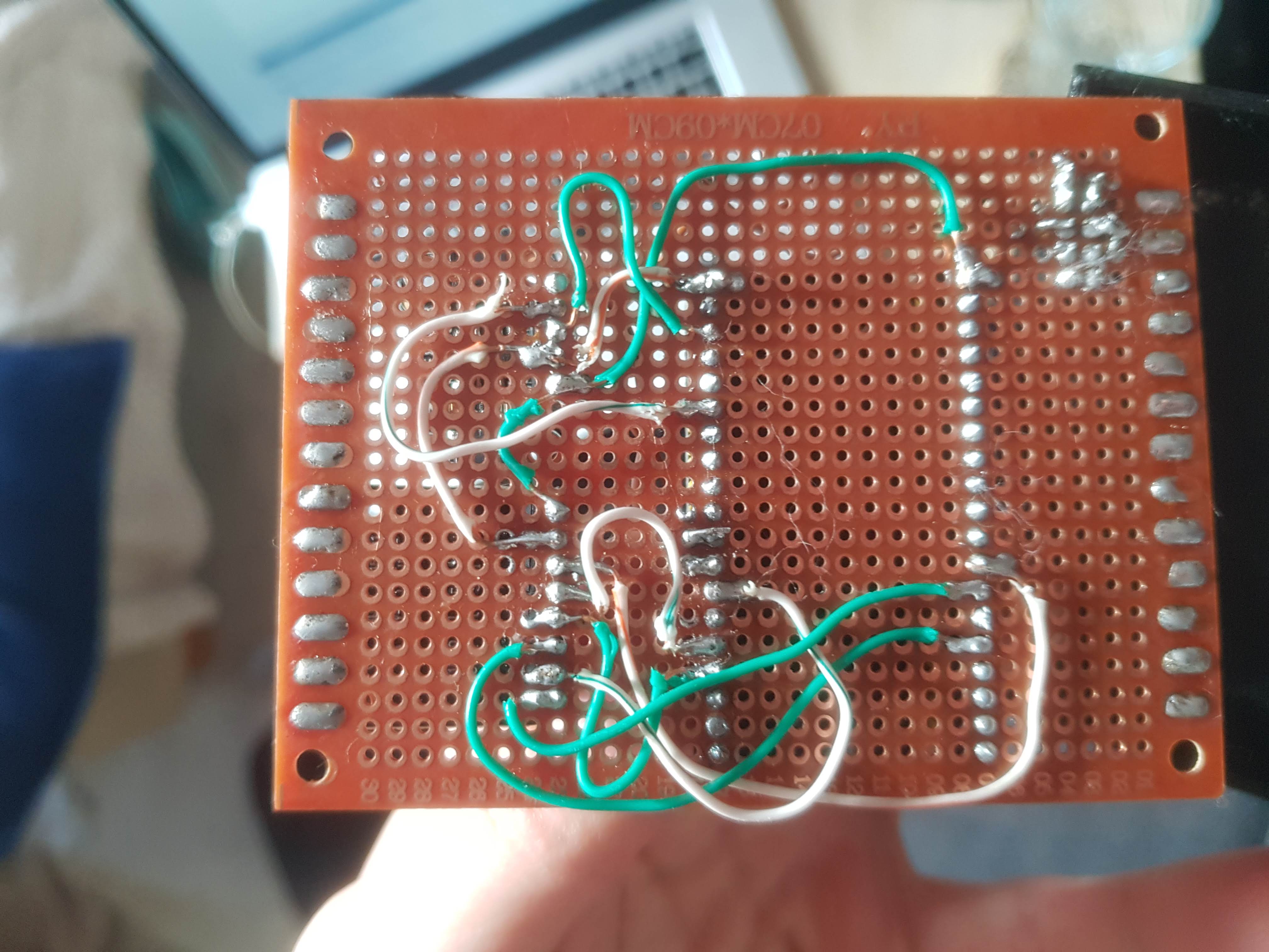

Not had any issues with the cards here at all, they mount no trouble and read and write reliably.
Wondering if there might be something on your ESP32 board that is loading one of the lines and making the pullups on the SDIO lines a bit marginal (I think the ones on my SD breakout board are 50K which is a bit high according to the Espressif specs)? If you have the bits there it might be worth trying to add some extra 10k pull ups on the lines?
Edit - one other thought, if it works ok on the bench but not in the car could it be noise pickup? How long are the connections between the esp and card? The shorter the better really.

Fairly long, they reach out of the inverter. Done a fair bit of driving today and failed to log all. Need further debugging. I did find one bug, if rolling backwards a little trying to go forward causes juddering, so want to get a log of that.
Pete9008
- Posts: 1801
- Has thanked: 102 times
- Been thanked: 351 times
Re: ESP32 Based Web Interface & Data Logger
As long as the lines between the OpenInverter board and the ESP32 are reasonably well routed and preferably screened I would have though they would be OK. Corruption on those would just affect comms and not the data not SD card mounting.
It was more the wires between the ESP32 board and the SD breakout board that I was thinking off. They are the ones that will affect the SD card mounting or reading and also run at much higher speeds so could be prone to noise pickup too.
Do the SD cards mount OK when the boards are not in car?
Is the juddering while rolling back new? If so it might be worth doing a diff of the logging code against whatever you were previously using to see if anything else has changed.

Might adjust the code to every 10 seconds try remount the SDCard and reset the startLogAttempt to 0, if it's not already mounted, maybe that'll improve the reliability of getting data. BTW added a couple more logs from today. Higher speed does have issues with the power coming on and off.
Pete9008
- Posts: 1801
Trouble is that if it is a noise problem then retries will probably get it to mount but may then produce files full of corrupted data. If the problem is only in the car then noise (or possibly power supply issues?) seem fairly likely.
Have you got a pic of the install?

I'll get a pic later when I go out to car, it's not pretty

Still think you have something marginal in the card electronics (pull ups?), noticed your earlier post where you mentioned other cards wouldn't mount, that would back this up

I'll get some 10k smd resistors to change the the pullups. I've got an LCR on the way to measure the motor.

haven't got round to it yet
Need to dig out the board and see what size the resistors are on there to get replacements
Pete9008
- Posts: 1801
Wouldn't bother trying to replace them, if it's like mine they are tiny little SIL arrays which would be a right pain to swap.
I'd leave the existing resistors in place and just bodge some extra 10kish resistors on at the header (one end to the header pin with a common wire along the other ends connected to 3V3), much easier to do and should work just as well.
- Posts: 1884
- Has thanked: 91 times
- Been thanked: 517 times
Ahh, will do that. Is it just the D0, D1, D2, D3 pins?
