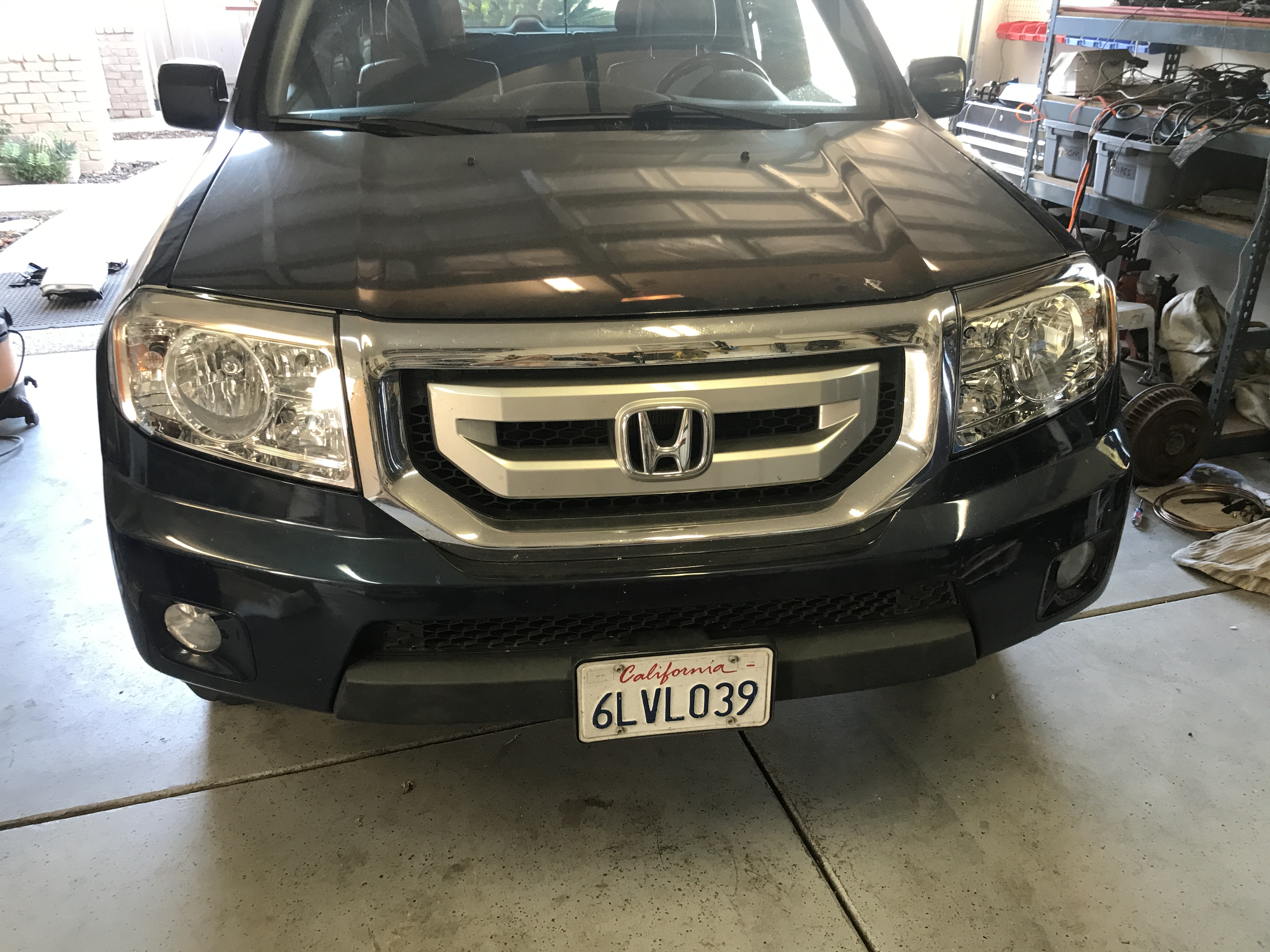

not a truck update but just letting you know what's been keeping me from updating, apparently my wife's love language is "making me do shit" so here I am finally replacing the headlight on her 2010 Honda Pilot, YES the front grille and bumper have to come off first, you read that right

Post by P.S.Mangelsdorf »
Gregski wrote: Tue Oct 25, 2022 2:24 pm not a truck update but just letting you know what's been keeping me from updating, apparently my wife's love language is "making me do shit" so here I am finally replacing the headlight on her 2010 Honda Pilot, YES the front grille and bumper have to come off first, you read that right
I feel your pain.
My father's previous truck, an '09 Sierra, called for the same thing. Turned out if you were a determined and dumb teenager, and didn't mind ending the experience bleeding, you could juuuussstttt barely squeeze your hand in to change the bulb with the vehicle still assembled.
My V6 Challenger takes the cake though: to change the plugs and coils, you have to pull the intake manifold. To get longer runners they laid the intake over and it completely covers the driver's side head.
