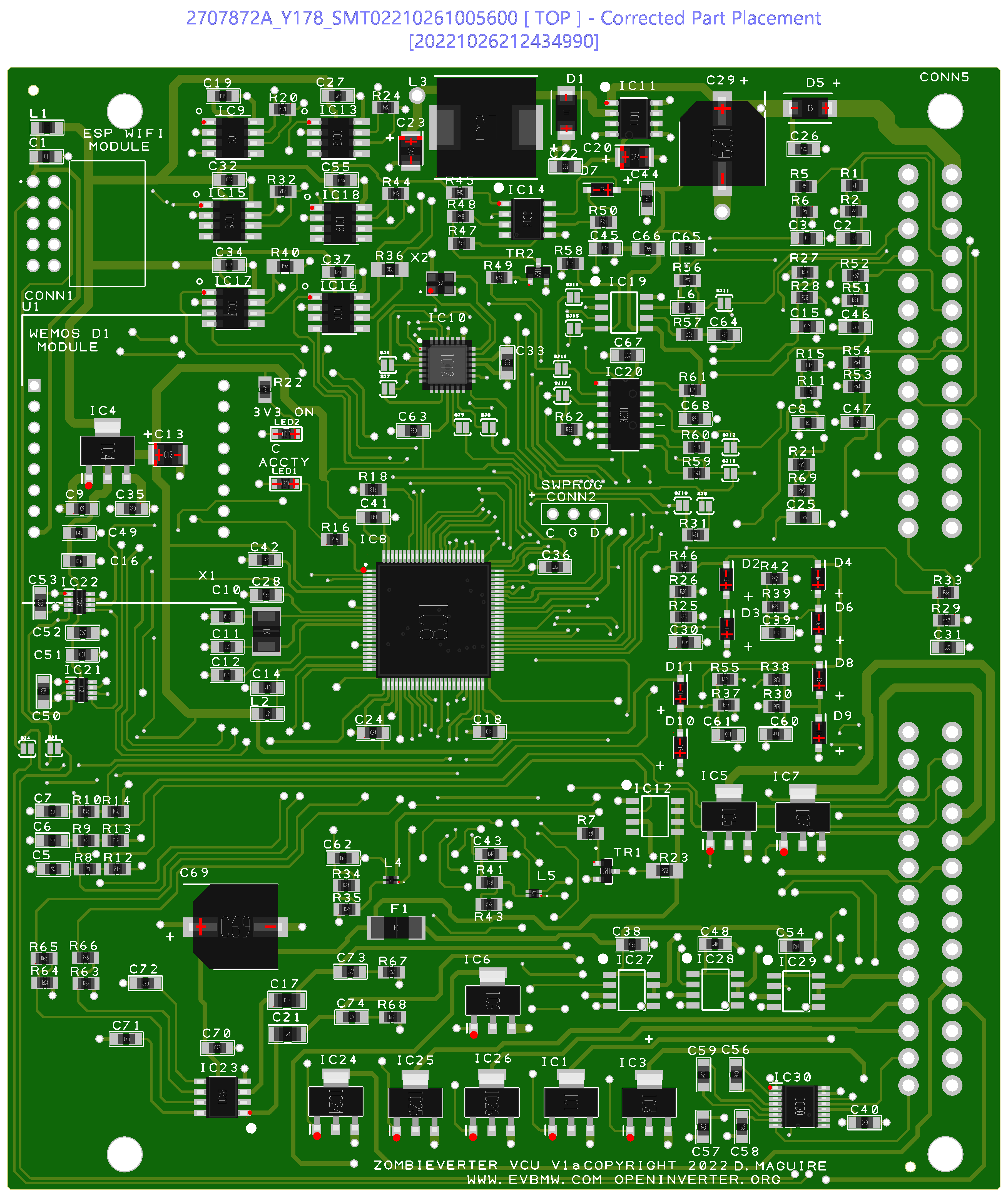

So new batch of VCU boards on the way from JLC. I have upreved the board to V1a to cover the following changes :
-Add footprint for Wemos D1 wifi module
-Move C71 and tracks to better clear mounting holes
-Remove I2C EEPROM and associated components as is unnecessary and just ads cost.
I'm also pleased to announce that as of this batch ALL parts will be included in the kits and the MCP25625 is now available from JLC for the first time since this chip shortage nonsense began.

I visited EvSteeve yesterday to assist with his STM32-VCU setup. He has an Isascale shunt and Leaf inverter running on the same CAN bus (he says this is CAN EXT2, but I didn't confirm this).
I observed the following:
* The reported version number of 1.01 is 1.00A (already confirmed and discussed)
* With firmware 1.00A the precharge process works correctly and the motor spins
* With firmware 1.01, there is a new choice of CAN1 and CAN2 for each function. When I set all options to CAN1, the precharge works (ie data is read from the shunt), but the leaf inverter does not spin the motor.
I didn't have time to debug properly (quite literally, the wifi module overheats and crashes after about 60 seconds), but it would seem that there is still some confusion around the selection of buses.
I've suggested he order some D1 minis and adapter boards to replace the bad wifi modules, but it would be helpful if anyone with an understanding of the code could suggest why setting all interfaces to CAN1 causes the shunt (on CAN EXT 2) to work, but not the leaf inverter on the same bus.

After quite a while of working on my battery assembly for the RX8 it became time to implement the associated modification to the Zombie this evening.
I flashed in my bin file and noticed that the activity led is not blinking anymore.
In previous occasions this has been due to some coding bug and the revival to operational state has been possibly by flashing in the known working FW.
Now I am facing the situation that the dam activity led just won't start blinking no matter which FW I flash in (the flash process seems to go through normally according to the web interface).
Any idea what's the problem with the Zombie and how it can be revived?
Re: ZombieVerter VCU Support
This .bin file is a blank file. I recall Damien giving me the link for it.
If you flash this file then power down and repower the Zombieverter then use the latest recommended .bin file on the github page it might cure your problem. I have tried thid method myself and it has worked for me.
[The extension bin has been deactivated and can no longer be displayed.]

Any suggestions for an unlucky individual that is trying to program a board with the GD chip? I'm sure in the end the answer will be... replace with an stm32, but due to the chip shortage here I am.
I am using an stlink programmer in win 10, passed power test with 12v but have solid "3v3 on' LED, no blinky "ACCTY" LED
I tried uploading the .hex that Damien shared in this thread for the GD chip (GD32F107VCT6), stlink utility shows program uploaded and device memory matching the .hex file
After much hair pulling, I was able to program a bare esp12f with the esp8266 web interface, so maybe I can try that after I get it connected to the zombie

You need to flash the bootloader too...

I’m got the bootloader loaded with stlink, and accty blinking now. I’m going to try uploading the firmware over wifi
