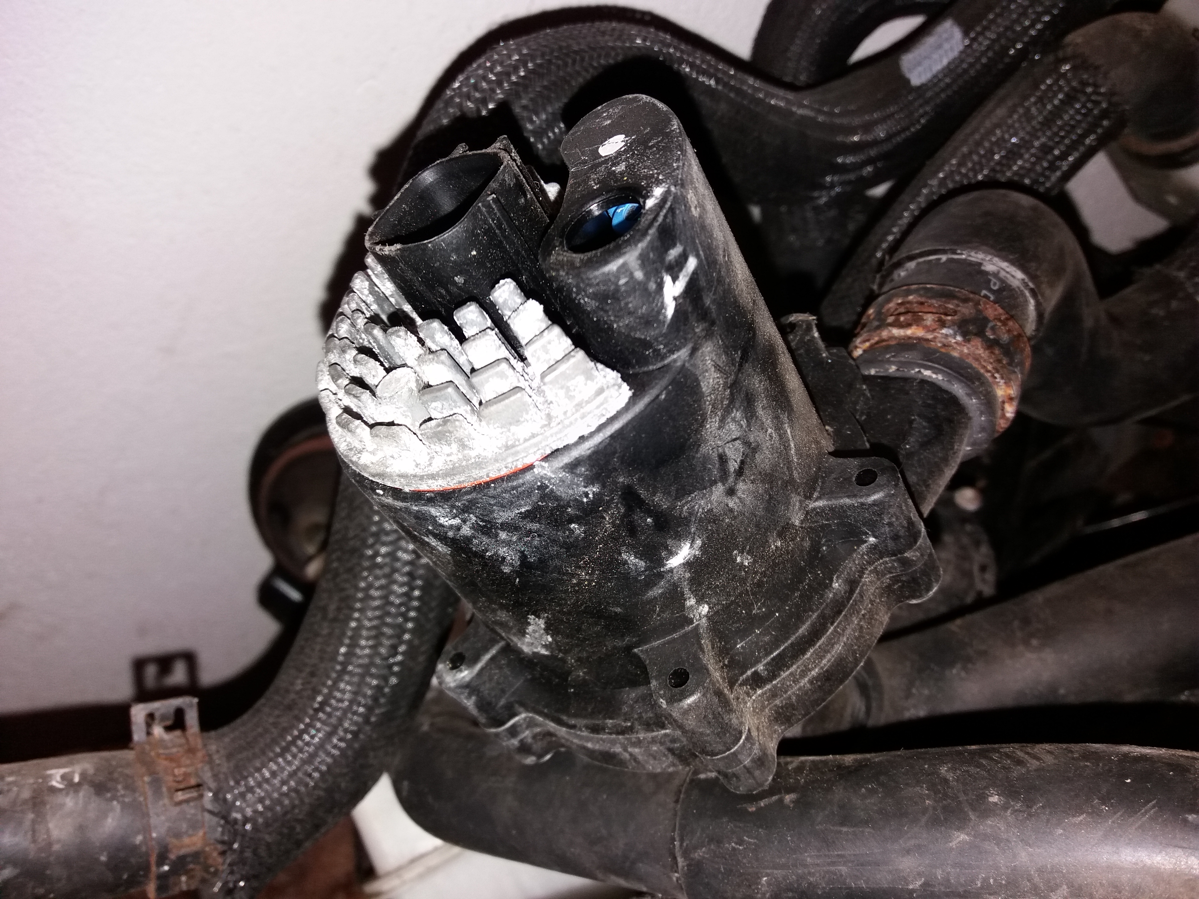

Re: Throtle 5v
Hi!
I that's the nissan leaf water pump right. I've got my schematics at home, but just try connecting +12 mad ground to two of the ports untill it works. That's what I did
Re: Throtle 5v
I have the same pump in my spare parts. It isn't PWM steering like on picture below?
- Posts: 102
- Location: France
- Has thanked: 2 times
- Been thanked: 11 times
Re: Throtle 5v
The pump is pretty easy to drive. I'm not next to my my car so i cannot check to be 100% sure but you need to connect 2 wires together and apply 12V to the other 2. I tried every combination possible and it worked. The pump has a soft start and it will stop after 5 or 10 minutes if it doesn't have liquid flowing.
Given your picture i would connect yellow and blue together, +12v to red and ground to black.
