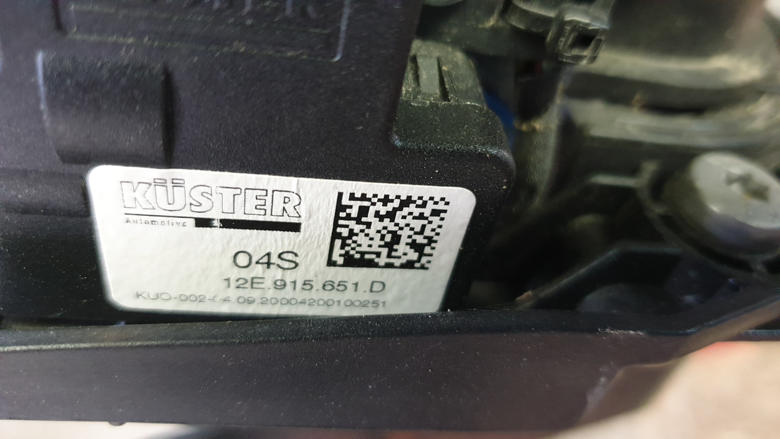

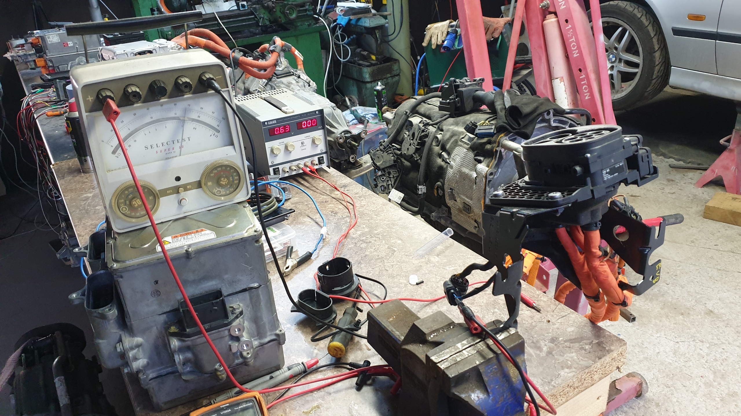

So good news is it looks like the charge port from the Mii shares the same part number with the Golf and Golf phev. The charge port actuator feedback is a bit strange so had to break out a propper multimeter to figure it. Feedback is 1k between pins 18 and 19 on the charger when the locking pin is fully in or out and 11k when in transition or stopped midway. Lock connects to Pins 16 and 17 on the charger. To close the lock the charge drives pin 16 to 12v and pin 17 to ground and vice versa to open.

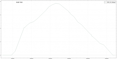

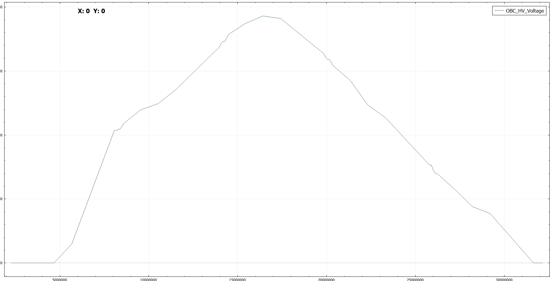

So turns out the Egolf charge I got also goes to sleep and needs to see 0x570 to wake back up.
Pulled two logs one after waking up and one with HV applied in a sweep. So now time to compare and find the reported HV.

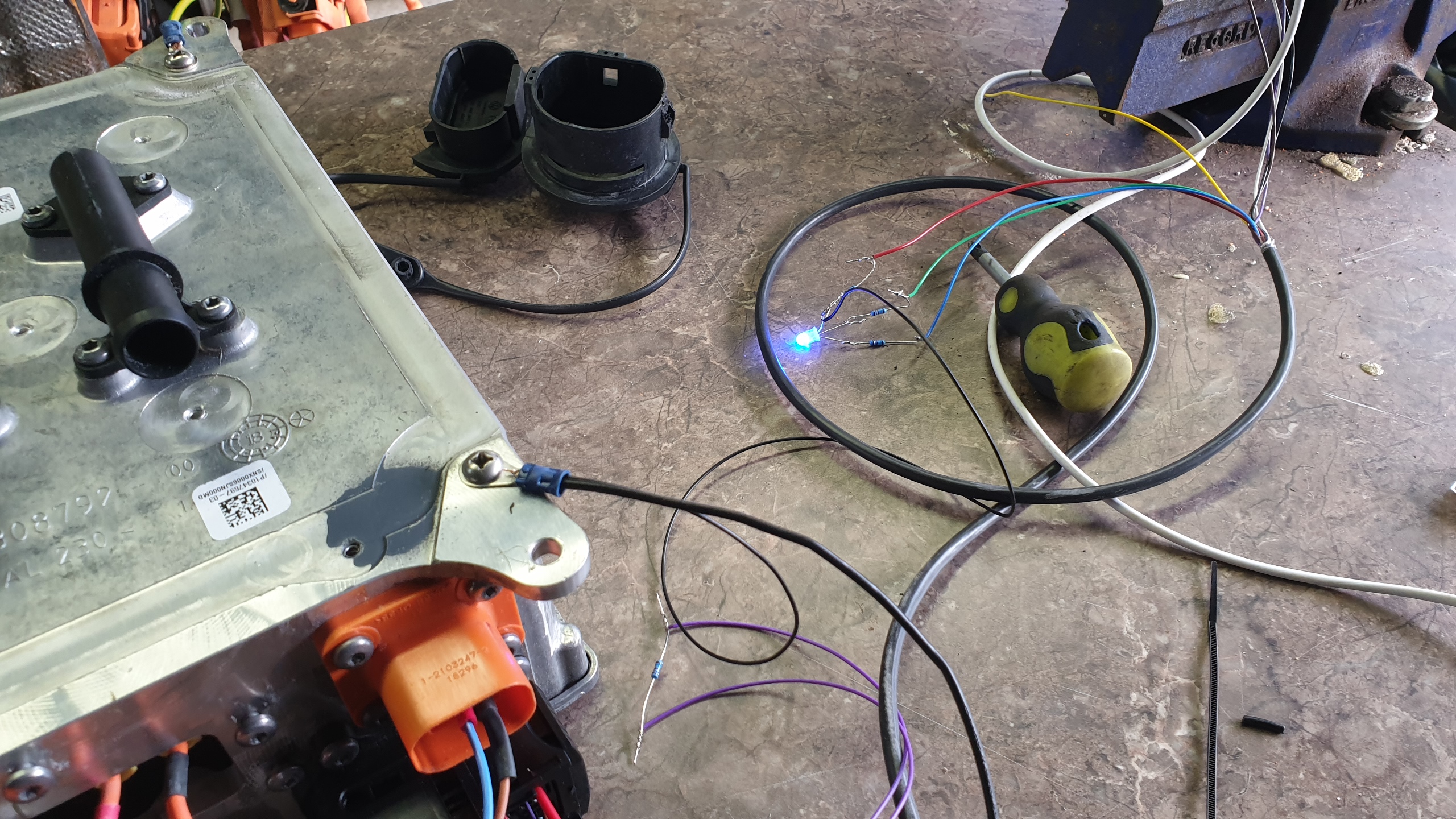

Got the pins today for the data connector and the housing is in my local vw dealer so hopefully will get some life from the PHEV variant tomorrow.

Turns out the charger does report the voltages but also "Faults Out" so measurements can jump to 0xFF, thus indicating error state.
10 bit long value. My logs and findings pushed to github now, might wire up my new variac to see if I can see the AC input voltage.

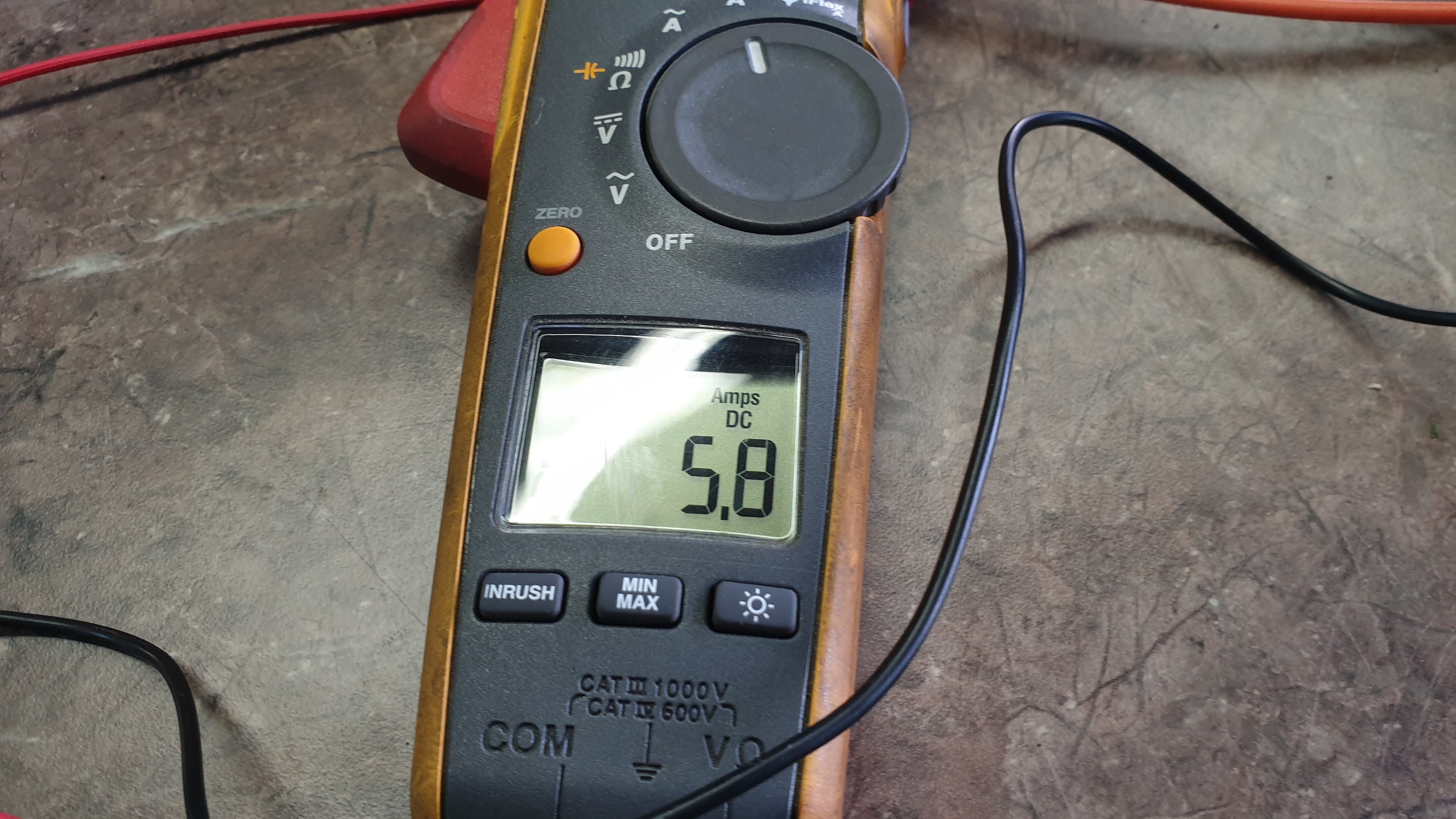

Had a bit of success today. Golf PHEV charger up and running :D

Re: MEB Chargers
Captures on the repo labeled as 6A charge sessions. Only one id need on pt can. 0x187 I think.
