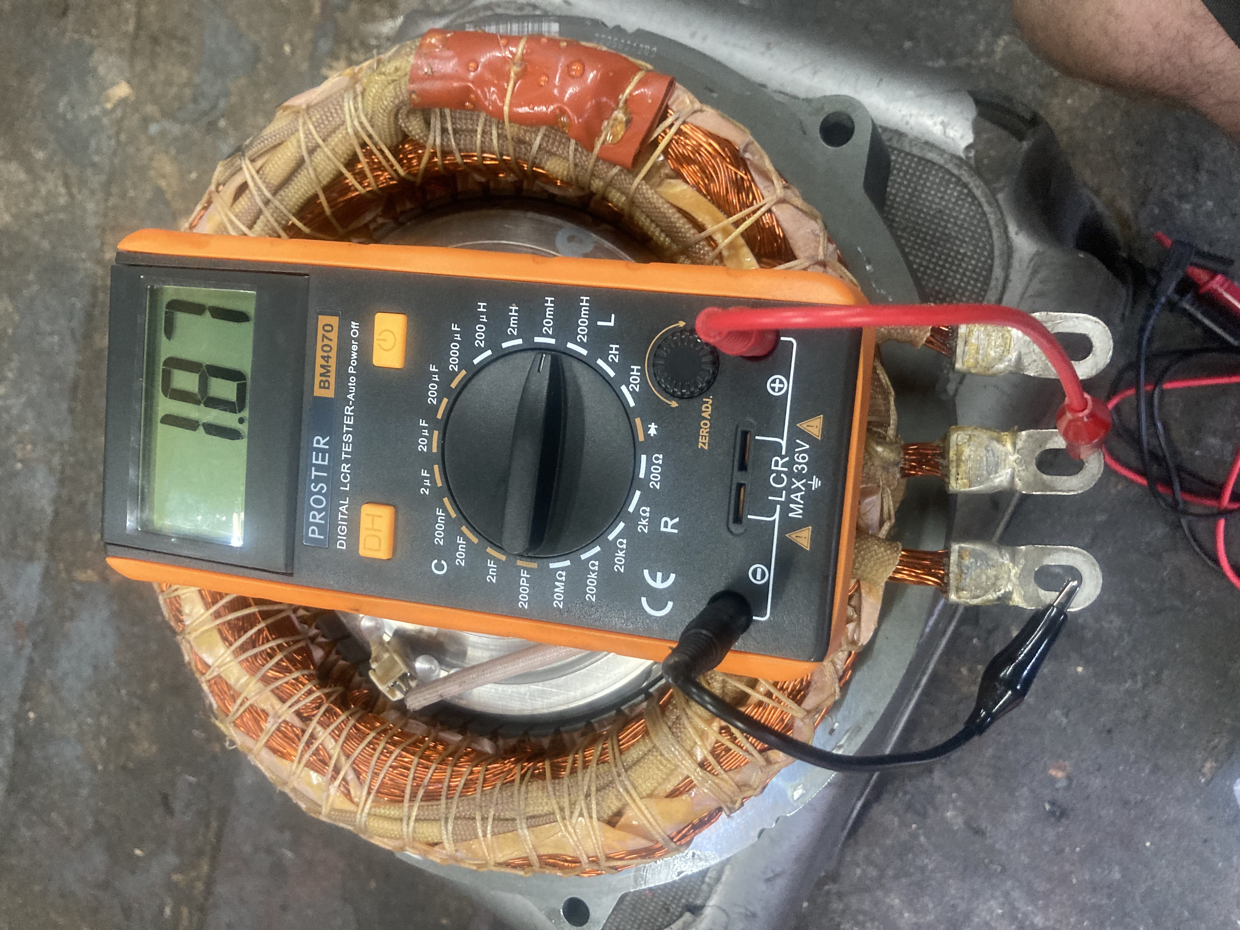

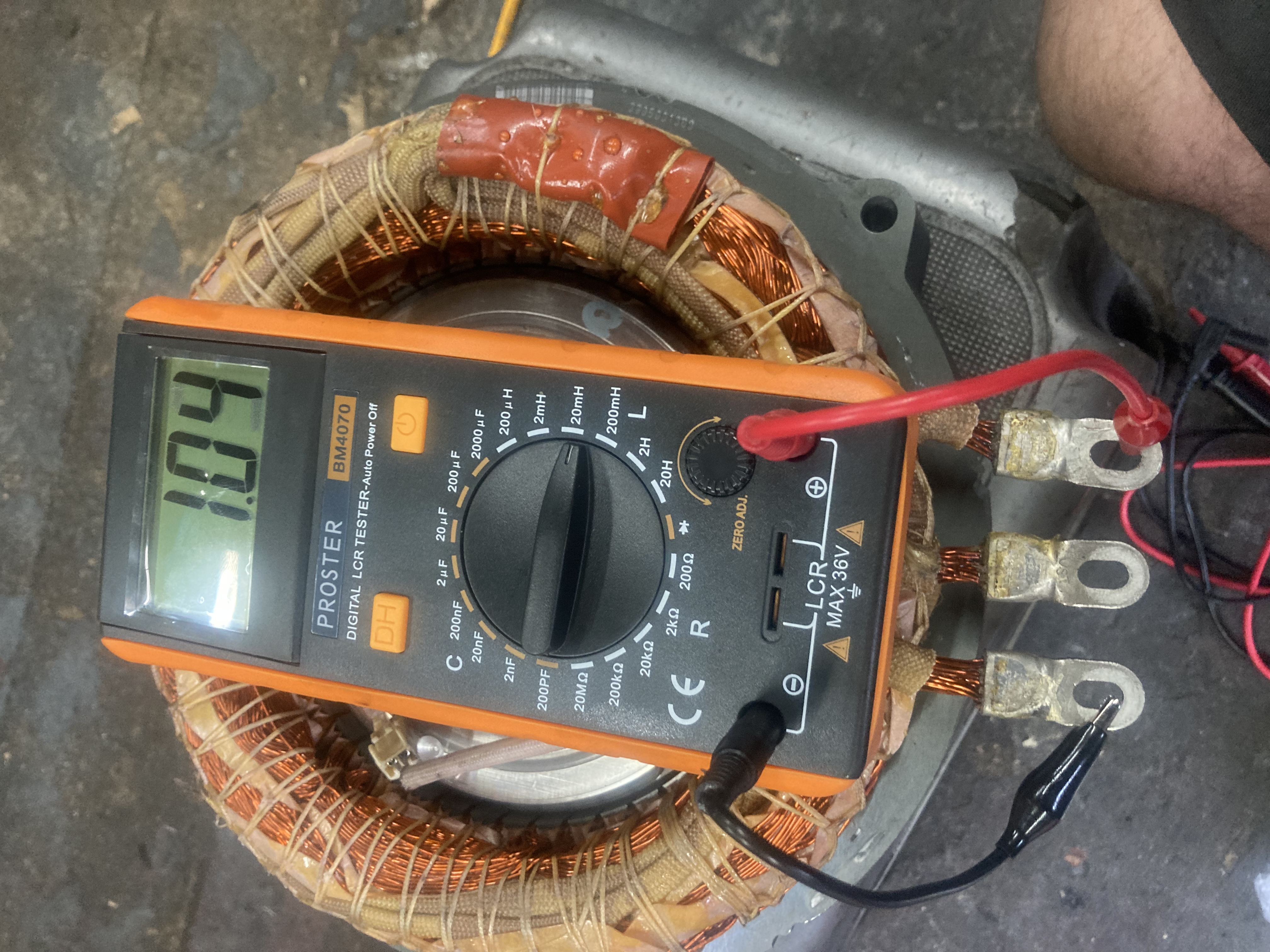

Ok I dug out some spare motor parts, only tested with stationary rotor in one position but these are Lexus rx400h transaxle
Mg2
Mg2
Mg1

Thanks for taking those but any chance you could redo them
I'm sure there is a way to convert your measurements to Lq and Ld, I just don't know what it is
Sorry, should have mentioned that before.
Edit - I'll have a google first to see if I can find how to convert them. Anyone know if these motors are star or delta wound?
Yes no problem I thought I may have got that wrong, will redo when I’m back on Monday

the motor leaf is 100% two parallel stars, their midpoints are not connected.
the rear engine of the alphard or estima is the same.
motor prius mg2 gen2 one star. the Lexus motor in the photo above is one star.

However, I may be wrong about the Lexus. there may also be two parallel stars like the nissan leaf

Thank you! Doesn't actually matter for the calculation whether it is one star or two so that's exactly the information required.
Will have a go at calculating Ld and Lq using a star configuration and Ev8's data.
Edit - Is it possible to tell the configuration from the picture or did you already know the Lexus motor configuration?

I think the converted numbers are:
MG2: Lq = 2mH, Ld = 1mH
MG1: Lq = 1.1mH, Ld = 0.6mH
Without spinning the rotor those could be plus or minus a bit but should be fairly close. The Lq measurement will be a bit low as the motor wouldn't have been correctly aligned for them so maybe 2.2mH and 1.2mH respectively??
Not low inductance but then nowhere near as high as some of the numbers we have been working with
Threw these numbers into the simulator and with 300V it gave a peak power of 100kW dropping to a steady 30kW at higher speeds for each of MG1 and MG2 (MG1 stronger at low speeds, MG2 happier spinning up to higher speeds). No idea how that compares to reality? (Edit - Hmm, those power numbers don't seem quite right, need to have another look at that)
In case the conversion equations are useful to anyone else:
Phase measurement to winding inductances La=(M1+M2-M3)/2, Lb=(M2+M3-M1)/2, Lc=(M1+M3-M2)/2
Winding inductance to Ld/Lq measurements L1 = La + ((Lb*Lc)/(Lb+Lc)), L2 = Lb + ((La*Lc)/(La+Lc)), L3 = Lc + ((La*Lb)/(La+Lb))
Assuming the motor has naturally come to rest aligned on one phase one measurement will be low and will be Ld the other two should be larger, roughly equal and a bit smaller than Lq (for example MG1 above came to 0.6mH, 1.1mH and 1.0mH).
