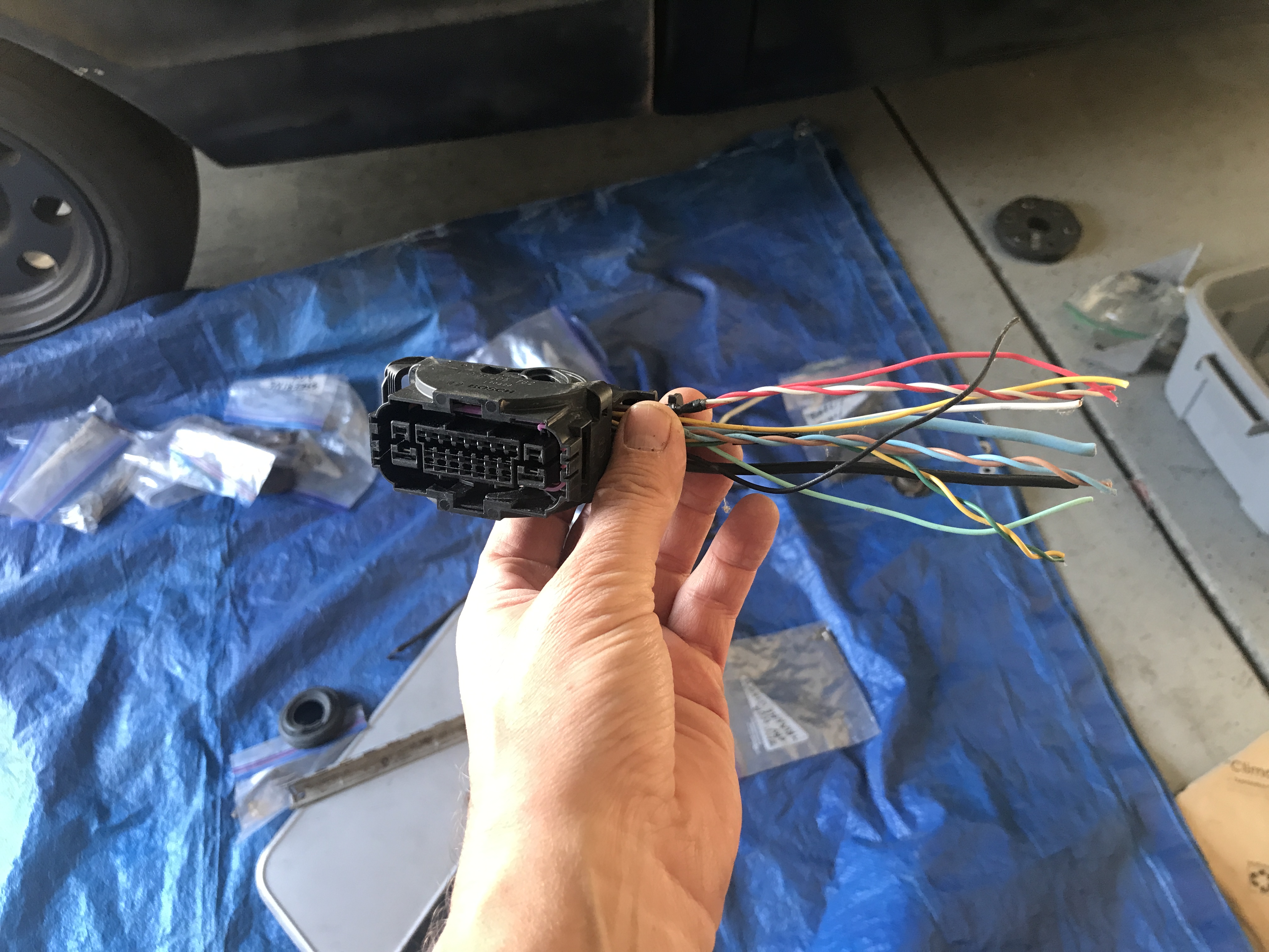

however BOSCH goes out of their way to make a connector so encapsulated that no one can tell which wire goes to where, so The Greg (and don't ask me how I did it) had to liberate the cover off of it to take a peek looksie inside
Gregski
Posts: 3161
Has thanked: 631 times
Been thanked: 1609 times
Post by Gregski »
so as per EVCreate's constructions one of the first things that needs doin' is we have to marry the small plug to the big plug. I think the small plug is for the brake pedal sensor which basically tells the brain of the iBooster how far down we pressed the pedal, so it knows how much assistance to provide, correct me if I'm off base
in my case (2018 Honda CRV) the wires colors matched, so I took four wires from the little plug (brown, yellow, light blue, and greenish) and soldered them to their matching counterparts off of the big plug, only the light blue and brown twisted together were questionable as I thought that may have been the CAN Bus, but what evs
Note To Self: send a Christmas card to the eBayer who cut the big tails just long enuff to reach each other! thank you ma'am

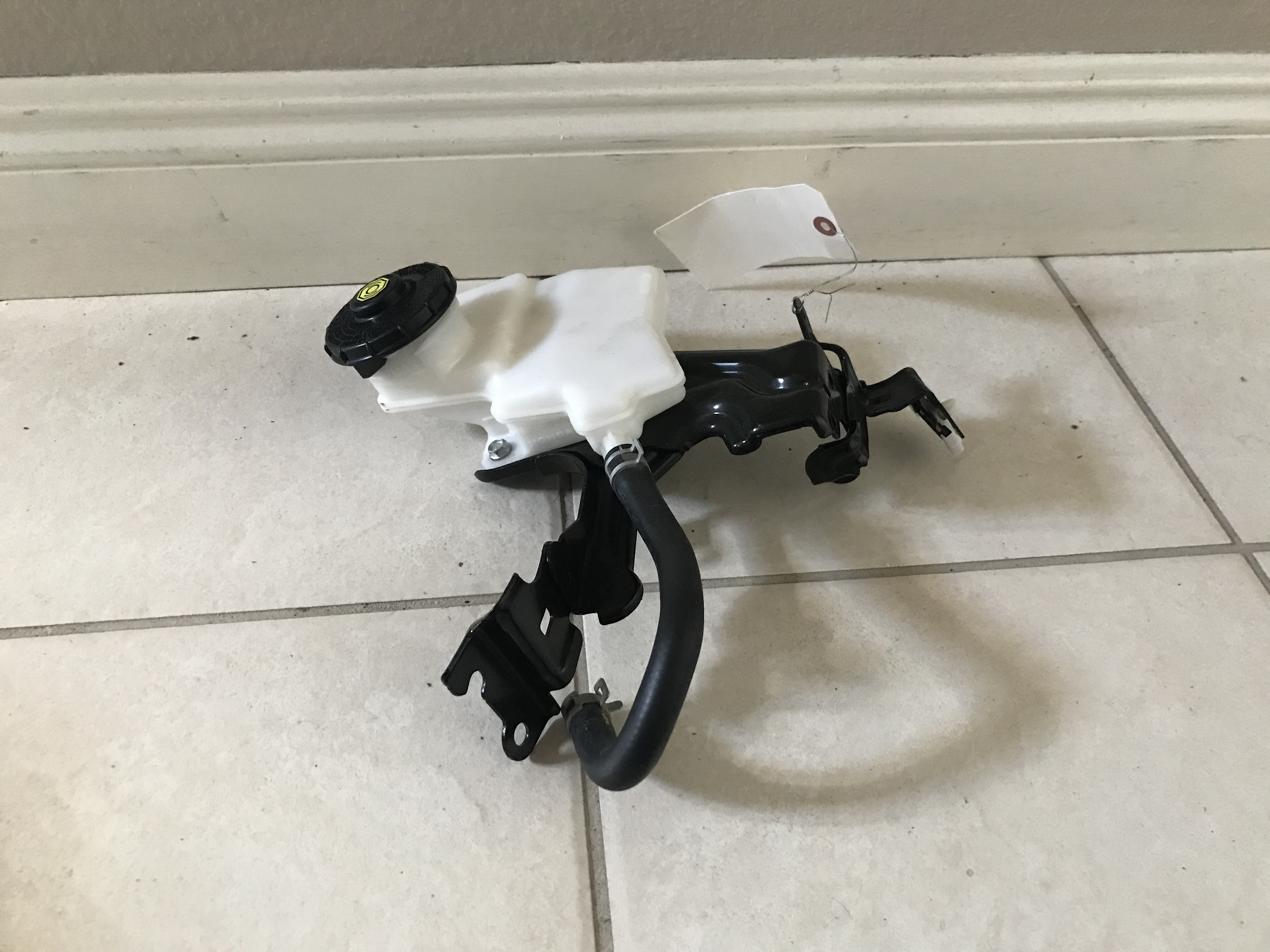

even with the residual valve installed the pedal still wiggles when fully pressed down and the master cylinder makes rhaataaata sounds, and Patrick thinks the master cylinder is faulty and leaks, something we observed with the long clear brake fluid hose going way up in the air from the fluid reservoir is that for some reason the fluid sometimes goes up the tube, that has to be strange indeed, so I did what I'm best at, I decided to throw more money at the problem and purchasized this ($406 dollar new master cylinder from the stealership) for $80 bucks used on eBay (cause common sense tells us you always replace a bad 4 year old used part, with another used part, but this one 5 years old)
and now we wait...
