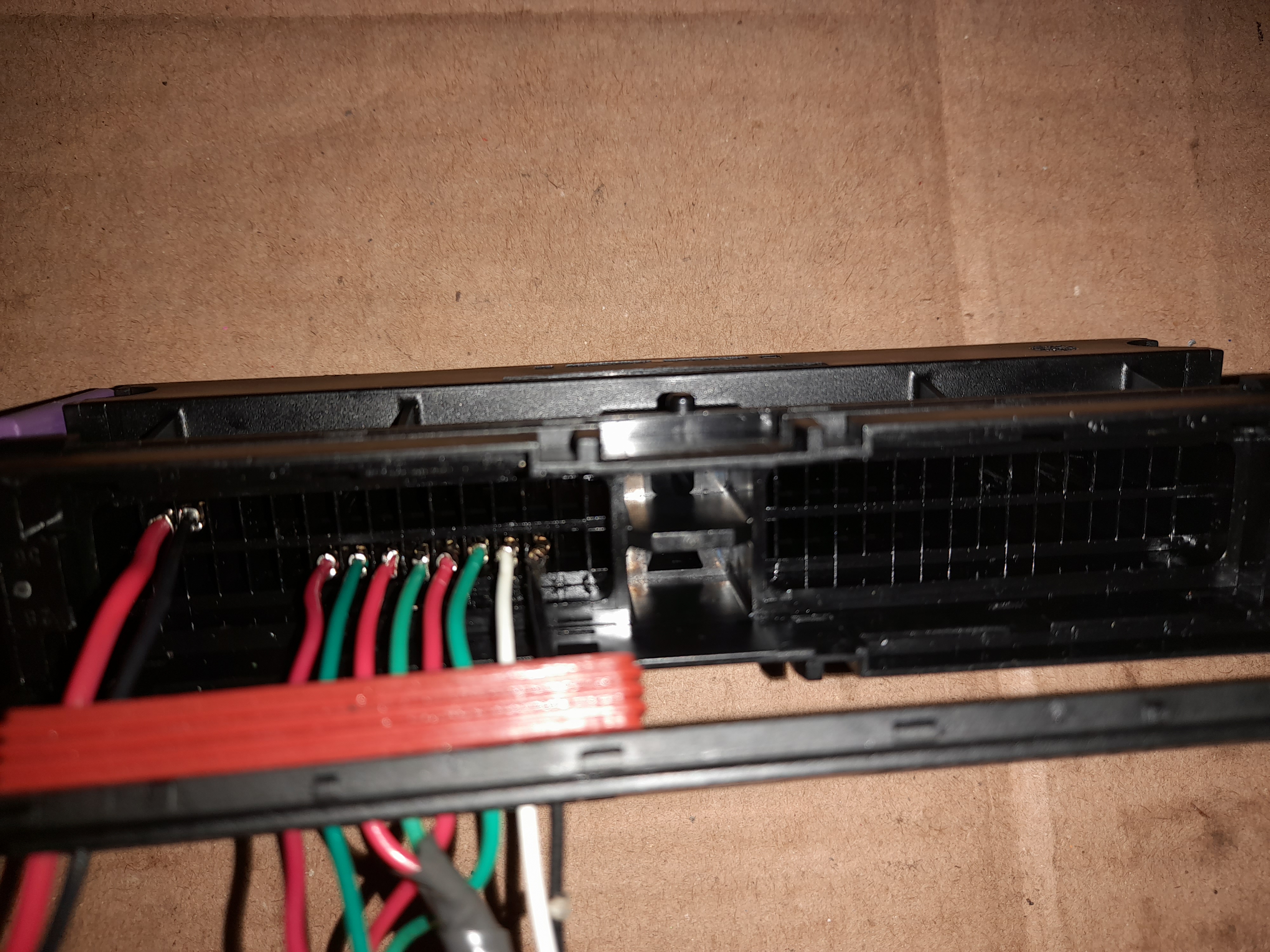

Beemer wrote: Sun Nov 06, 2022 10:03 pm Hi guys, new to the forum. Have recently purchased the zombieverter vcu from Damien and had it assembled as per video but still have to fit IC 10 as not supplied in the kit. After connecting the resolver cables and doing a basic power check using 12v volt battery the micro controller IC 8 started giving off smoke signals so I quickly disconnected. Where have I gone wrong.20221106_204748.jpg
I am using the lexus 300h and inverter.

Connections as per wiki for vcu
Pin 55 ground
Pin 56 +12v
Pin 16 REQ-
Pin 17 REQ+
Pin 18 CLK-
Pin 19 CLK+
Pin 20 MTH-
PIN 21 MTH+
PIN 22 HTM-
PIN 23 HTM+

Maybe photos of the Zombie connector and the inverter connector annotated with the signal would help also, incase those aren't correct

Also do a dc volts check between ground and your inverter signals in case the inverter is bad and killed the vcu. I recently helped a customer with a 6 month problem that we ultimately chased down to a water damaged inverter. He'll update the thread with details himself.

It is difficult to see detail in the photos as transmission + inverter are placed in a tesco shopping trolley.

You'll need to go back over those wires and double check and do a voltage test as I said earlier to ensure nothing is wrong in the inverter that caused the board to fail.
