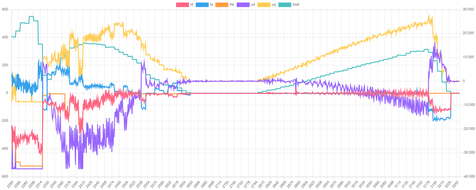

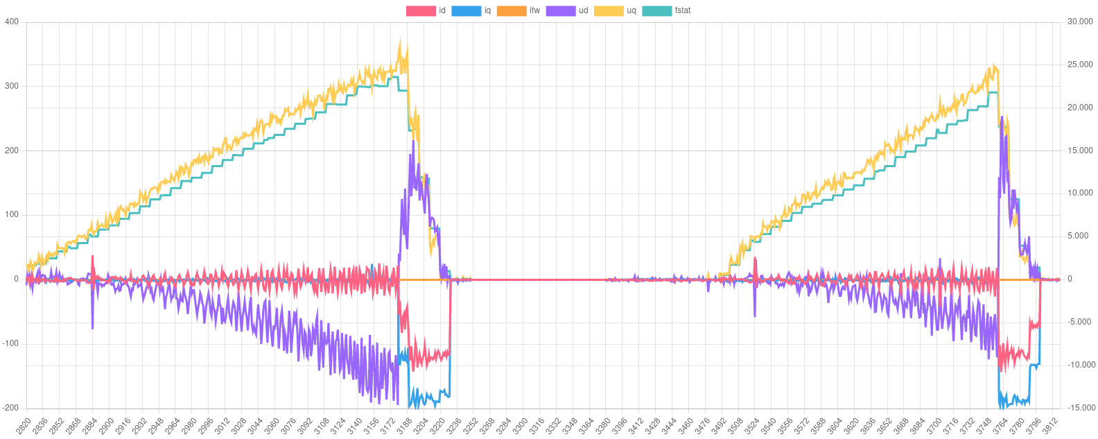

With the latest knowledge (syncadv=10) I did another test drive in the Audi. I think this is production ready now. I didn't get a single trip for the entire run even though I was pushing it and I do get a very stable 80A (x370V) battery current in the constant power region.
Here is a plot of accelerating from standstill to 120 kph and regenning back down (didn't fit entirely from and to standstill...) The d-controller is very close to saturation but is never saturated.
You can even see the DC current limit working as speed decreases iq increases. I have posted the parameters here https://openinverter.org/parameters/view.html?id=29
I will draft a new release of the firmware now. I was going to include the logging code but having some minor trouble with it, so will include it in the next release.
At this point I'd actually consider this topic solved. As you know I have been struggling with this for years and I think it would not have been possible to solve this without Petes input and his simulator. So huge thanks for that
EDIT: thanks also to the mystery forum member who brought up the critical current (and deleted his post a day later) and thanks to celeron for analyzing it further.
