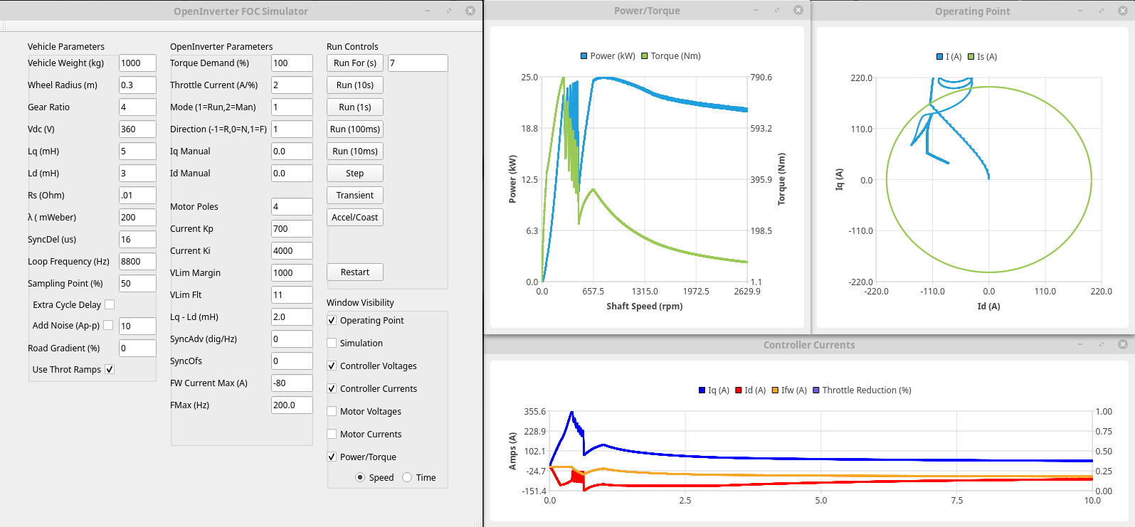

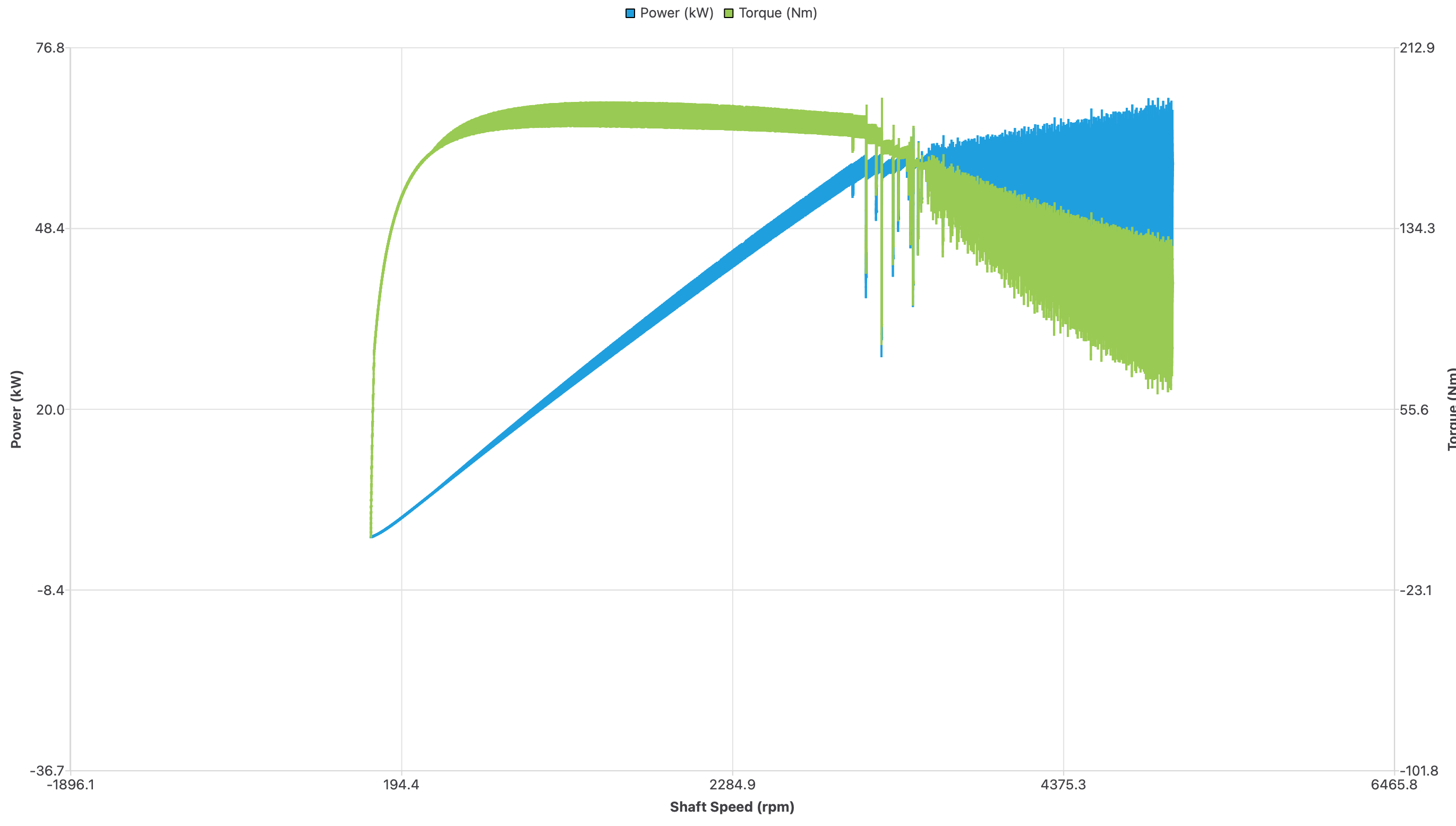

I have fmax set to 800, I've not logged what I manage to get it up to, again, I'll log it.
Pete9008
Posts: 1801
Has thanked: 102 times
Been thanked: 351 times
Post by Pete9008 »
Assuming a 4 pole motor 800Hz would be 12000rpm, the simulation is only running to 3000rpm. If you let it run to a higher speed in the simulator you will see more power. The power should level out, probably by 6000rpm, when you hit base freq and enter the constant power region. At 3k you are still in the constant torque region.
Posts: 1884
Has thanked: 91 times
Been thanked: 517 times
4 pole motor, 12000 rpm is reasonable, motor rated to 14k so might up some more.

Bigpie wrote: Wed Nov 16, 2022 1:57 pm 4 pole motor, 12000 rpm is reasonable, motor rated to 14k so might up some more.
Ahh, ok, see what you mean now. The control loops aren't't looking too happy at higher speeds at all :( which code is that, guessing mine as it does tend to do that. If so it is worth dropping curkifrqgain or fwki to see if it helps.
Johannes new IIR filter version does seem to help avoid that control loop oscillation at higher speeds.
Pete9008
Posts: 1801
Post by Pete9008 »
Just tried to reproduce and I can't get anything to stay stable in FW.
The thing that seems to make the biggest difference is Ld. I'm wondering if your bridge is under reading slightly, with a value of 0.16mH everything behaves much better and the power is back up to 75kW.
What is the resolution of your LCR bridge? If it is only 0.1mH then the actual inductance could have been up to 0.199mH??
Posts: 1884
It shows to 2 dp, one reading was 0.25 part way though a rotation, I also had a 0.13mH. Lowest was 0.10mH and highest was 0.30mH it was cheap so not expecting high accuracy.
I'm still running your code on the car and simulator for now.
Pete9008
Posts: 1801
Post by Pete9008 »
I'd use 0.15mH for the time being, 0.1mH does seem very low. Any idea what frequency the Outlander OEM inverters run at?
It's been a while since I used the master branch on the simulator (I've been running the experimental branch) and It really isn't that good in terms of stability above base freq (not too surprising as it is essentially 5.20 code plus logging).
It would be worth moving either to Johannes latest (safest but no logging yet) or my experimental (untested but has the logging). As there is no rush on data I'd probably go for the former and hope that Johannes gets the logging going before we need it. Both options are better then the old code that you are currently running.
