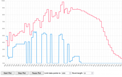

I now have a repowered Zombie. Just asking if you could publish your parameters for the GS450H just to make sure we are testing the same settings.
I did a road test but unfortunately lost my plot of torque and speed just after one of my gearbox mounts let go. It looked to me that light throttle was great but giving a little more caused a sudden drop in torque to nothing. Its almost like the inverter said you want how much? no way!
To sum up the plot looked like 2 fairly smooth curves until I pressed the throttle hard. As you have a driveable car and I have the latest software, 1.0.1A, that maybe my parameters that I have set are not right.
Once I repair the mount I will try and get a better plot.

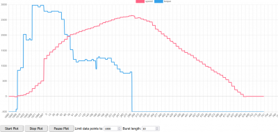

Test with the current DM_WORK branch
Torque is actually going completely to zero. I'll try removing that "torque cut" code and see it makes a difference.
With the old code (from last year) put back

et0 wrote: Wed Nov 16, 2022 10:44 am Test with the current DM_WORK branch
Now that is an actual software bug. My torque never went to zero as you will see in the plot I posted previously. So something is telling it to drop torque. from the top of my head :udcmin being hit, rpm limiter,brake in signal.

Jack Bauer wrote: Wed Nov 16, 2022 11:24 am Now that is an actual software bug. My torque never went to zero as you will see in the plot I posted previously. So something is telling it to drop torque. from the top of my head :udcmin being hit, rpm limiter,brake in signal.
Right, potnom is going to zero as well.
In the utils, processthrottle function, the limits are applied.
I've tried commenting these out in turn so that finalSpnt is just the raw value without any processing. However when I comment out UDClimitcommand, I just get immediate full power when putting it into drive. Don't understand that.
edit: commenting out IDClimitommand does seem to get rid of the problem. Have you changed the ISA setup by any chance?

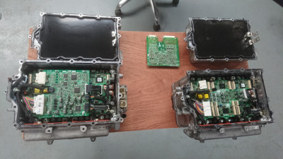

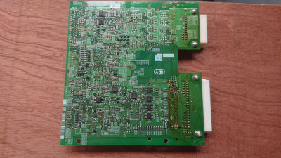

Update on my previous 'GS450H Inverter not running' posts!
As mentioned before, I had an older GS450H VCU that ran the GS450H inverter/drive setup as expected. I have two Zombieverters (one a built and bench tested unit) that would go into run mode but I couldn't get any inverter whine, Invstat stayed Off and trans wouldn't turn. As the GS450H kit worked with the old VCU, the assumption was the trans and inverter were good (lesson 1!). And the Zombie's were proven good, so the issue logically had to be with the wiring.
Well I wired and rewired many times, checked and double checked many times, but no joy. Very kindly Damien offered to take a closer look as the issue didn't make sense, so I sent the two Zombies and the inverter his way. Luckily the Land Yacht was in the shed and available to swap these parts in to test.
What Damien found:
- Both VCU's passed the bench test with the GS300H trans
- Both VCU's ran the GS450H system in the E39 with no issues
- Swap in the non-working inverter and no whine and no spin
- Scoped the clk signal on the good inverter and it looked nice and clean compared to a broken signal on the non-working inverter
- Scoped clk from the mcu side of the can transciever and all good
- Scope on output side and has breaks
- Measure approx 60R between pairs
- Measure resistance between sets. On non-working inverter get about 120k between clk and all other pairs, and infinite on good inverter
Conclusion, for some reason non-working inverter is leaking clk signal onto the comms wires and vice versa.
But the non-working inverter works on the older VCU, so Damien had a look through the code. The older vcu does not care so much about the return data on MTH. Its just for information, BUT the Zombie uses it to decide if comms have been established between inverter and VCU and wont enter the next step unless it sees valid data. On the non-working inverter it never gets there so no whine etc.
The bottom section of the inverter was removed, and so the real source of the problem becomes apparent. Photos below show the corrosion around the header pins on the PCB and on the opposite side of the PCB.
Interestingly (not really), I got my hands on a second inverter and appear to have the exact same issue again...what are the chances! On the hunt for a third inverter or replacement PCB again, third time lucky!

I agree, the CAN interfaces as set/shown on the GUI are backwards.
I have the shunt wired to CAN2 as it always has been, and with this latest software, the GUI shows that it's connected to CAN1, however it clearly is getting data from the shunt on CAN2.
So it needs correcting in the SW but I think it's a red herring as far as the "torque drop" problem goes.
As I said yesterday, getting rid of the throttle::IdcLimitCommand(finalSpnt, Param::Get(Param::idc)); call removes the symptom, and the torque application is smooth again.
There is nothing obviously wrong with the Idc value from the shunt when plotted though.
This is the function in question:
void Throttle::IdcLimitCommand(float& finalSpnt, float idc)
   static float idcFiltered = 0;
   idcFiltered = IIRFILTERF(idcFiltered, idc, 4);
   if (finalSpnt >= 0)
      float idcerr = idcmax - idcFiltered;
      float res = idcerr * 5;
      res = MAX(0, res);
      finalSpnt = MIN(res, finalSpnt);
   else
      float idcerr = idcmin - idcFiltered;
      res = MIN(0, res);
      finalSpnt = MAX(res, finalSpnt);
I'll try to debug it further. It's not easy not being able to just print out a parameter and seeing what happens though.. And I did get unexpected results from an experimental change yesterday, so it might not be a straightforward problem.
Posts: 3667
Has thanked: 12 times
Been thanked: 353 times
Re: ZombieVerter VCU Support
Interesting. That routine should only kick in if idc>idcmax or idc<idcmin. Assuming you have set those values correctly then my guess would be some number is wrapping around itself possibly due to the change from fixed point to floats as that routine has not been modified itself. as a simple test, set idc at a very low value say 5amps and see if it works as it should then increase until it fails. might give us a pointer.
et0
Posts: 132
Joined: Sun Oct 13, 2019 8:06 pm
Location: Scotland
Has thanked: 15 times
Been thanked: 6 times
Post by et0 »
You mean like
Throttle::IdcLimitCommand(finalSpnt, 5);
Never mind, I came at it another way.
-> Changed the code back to original
-> checked the problem still exists
-> changed the idcmax from 300 to 3000
Problem is gone (on the ramp at least).
So it seems to be a scaling issue, maybe just a factor of 10.

Just been doing some testing on axle stands. First run of the day and I was trying to plot the Torque drop issue after changing a few parameters.
The usual torque drop happened and the torque plot dropped to zero. I took my foot off the accelerator and then tried to re apply a small amount of throttle. It seemed that the torque drop was much worse coming in and out at much lower throttle application.
Suddenly big smokey from the battery area. Powered down everything and found that the Precharge resistor, Arcol 30Ω 100W Aluminium Chassis Mount Resistor HS100 30R F ±1% had self destructed.
I can only conclude that the main contactor had disconnected at the first torque drop and because the Precharge contactor remains powered (not sure why) until the ignition is switched off, it then, was carrying the full load that the inverter was asking for.
Ironically I have just seen Damiens parameters and they show that he has throtmax set at 10, regentravel at 0, regenmax at 0 and throtramp at 1.
Mine were all set at default except throtramp which was 0.09 which I believe is the minimum.
I will have a new precharge resistor tomorrow so I will report back on Damiens settings on my car.

dadiowe wrote: Thu Nov 17, 2022 12:10 pm Just been doing some testing on axle stands. First run of the day and I was trying to plot the Torque drop issue after changing a few parameters.
