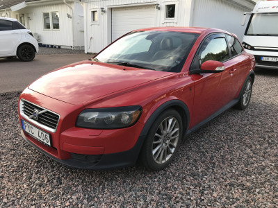

Creating this thread as I just bought my next project car, a Volvo C30.
My plan is to replace the sad old diesel engine with the motor, inverter and gearbox from a Leaf or more specific, the drivetrain I'm currently running in my Clio.
Battery is not yet decided but 80-96S and 15-20kWh is the baseline.
Charger will be based on Eltek FlatPack's.
The hardest work will most likely be to hack the HSCAN-bus to be able to emulate the removed ECM.
The C30 platform is shared with Volvo S40, V50, C70, Mazda 3 and Ford Focus. I think the S60 shares the same electric architecture as well. But I haven't found a great deal of information online.

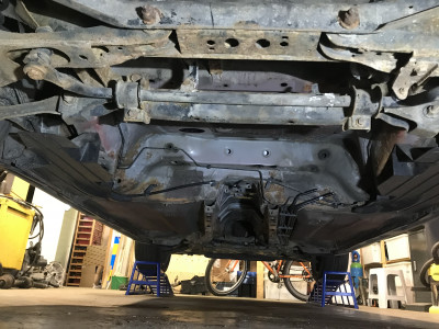

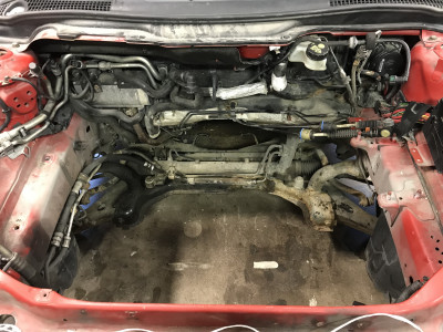

I have now removed entire exhaust system incl. cat and dpf and fueltank to find out how much space there is to use for batteries.
E-up battery is 36kWh with a weight close to 200kg for the modules.
I have found another option by using cells from Kia Niro. Will be more work but a 84S1P configuration would provide 19kWh with a weight under 100kg.
Niro option easier to fit, but I think there is enought room to fit e-up battery if some moduleas are placed above the rear axle subframe.
Leaning towards the Niro option as I really like low weight and rarely do longer trips.
I also have some ideas regarding range extension (battery trailer or IC powered pusher trailer). Will look into this more when car is converted and registered.

Oil burner removed.
Left to remove is shift linkage and diesel powered auxiliary heater before I can start fitting the electric drivetrain.

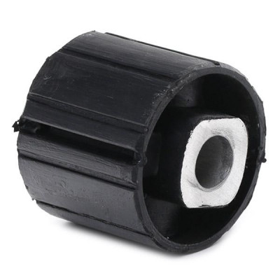

I've started mocking up drive unit mounts for the leaf motor/gearbox. In my Clio I used differential bushings from a BMW E39 as motor mount.
Fits well in a tube with ID: 53mm, 45mm length, and works well with a M14 bolt. It is very easy to use but it is quite stiff an so I ask if there are better bushings out there that might be a bit softer?
To my understanding the Outlander rear diff mounts are quite soft. Would love to use such bushings but I have not found them as lose pieces, only together with aluminium bracket?

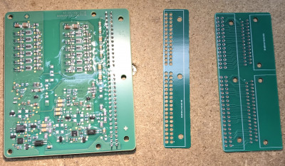

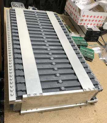

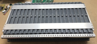

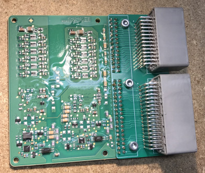

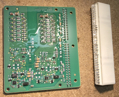

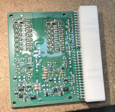

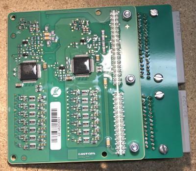

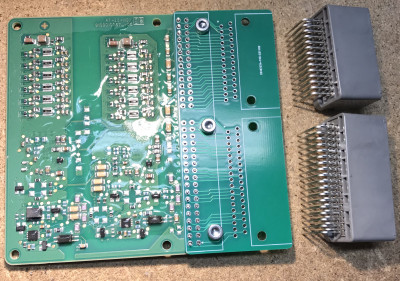

I'm currently building the battery pack and it consumes a lot more time then expected... Will post pictures once it is built.
I have made an adapter board for the connector on the E-niro BMS slave modules. I don't like pigtail wiring join mid-wire but rather connectors that can be bought with new crimp pins for neat wiring harnesses. In order to do so for the slave modules the connectors need to be replaced, hence my adapter boards.
OEM-board
OEM-board
Cut off OEM-connector
Adapter board and distance board
Distance and adapter board mounted, new connector
Complete
Complete
Complete
Complete
This mod makes the slave board 20mm longer and a few mm higher.

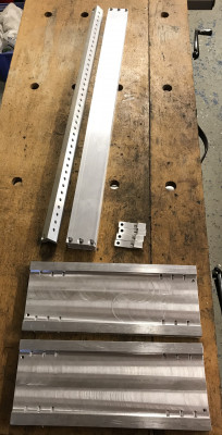

Finally some progress with the batteries. Have been spending quite some time with my mill to produce this:
Today I was finally ready to assemble:
Both modules are done even though the pictures only show one, 40S in each. Weight is just shy of 44kg per module.
Next is the contators and precharge. Also need to sort out busbars and BMS connection boards.
