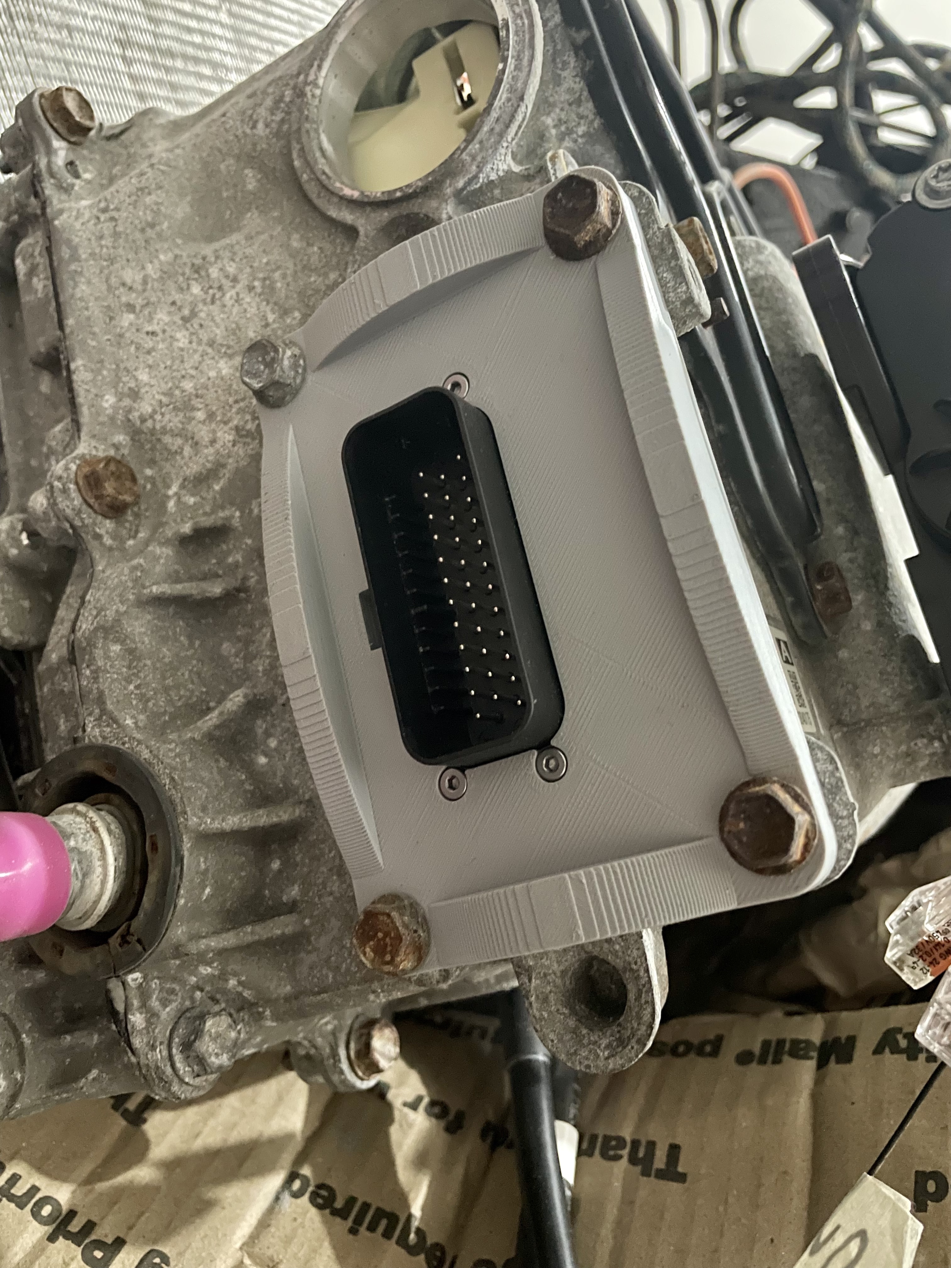

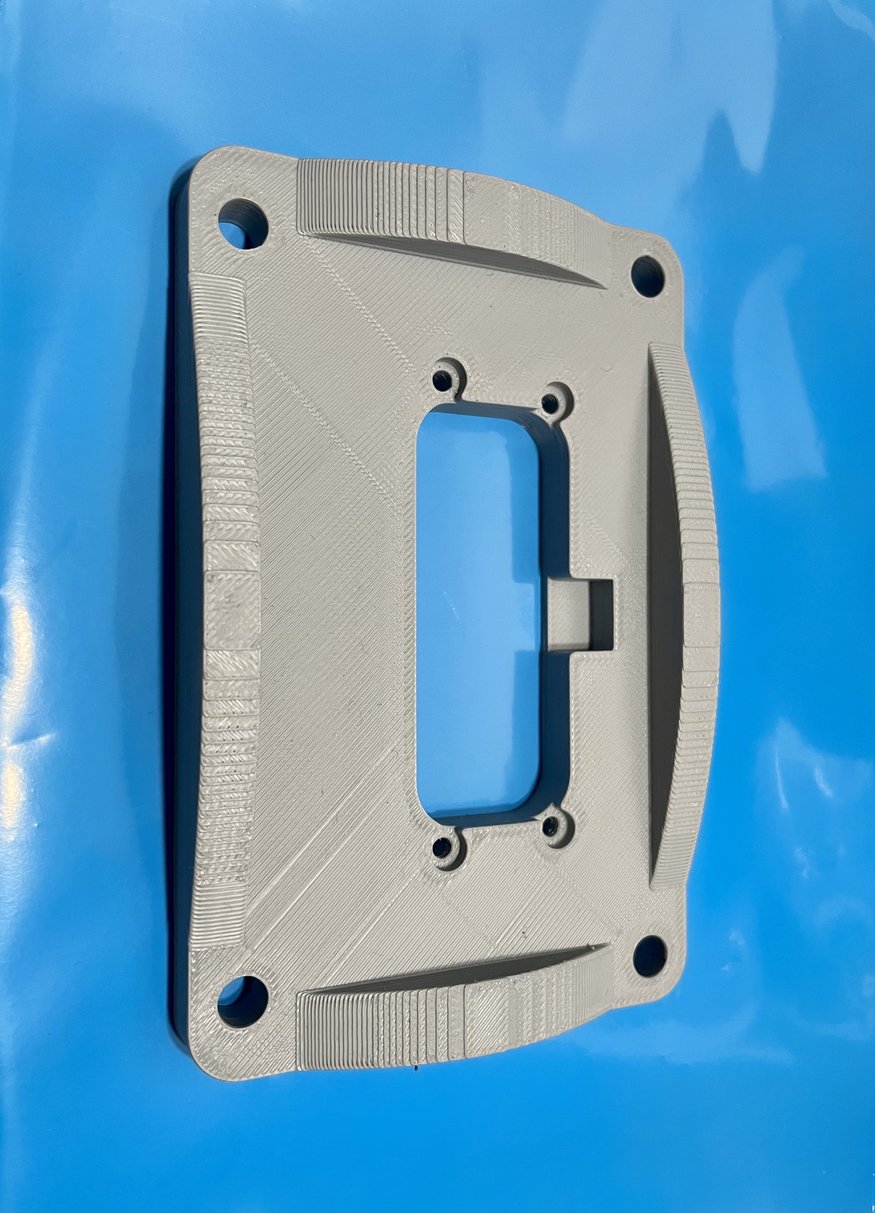

Trading these adapter plates for help tuning gen3 with em61 motor. Made from Polymaker ASA, high temp and outdoor rated, 40% infill and 4 walls, went through 9 revisions to get it just right as its a very close fit. Comes with stainless screws.

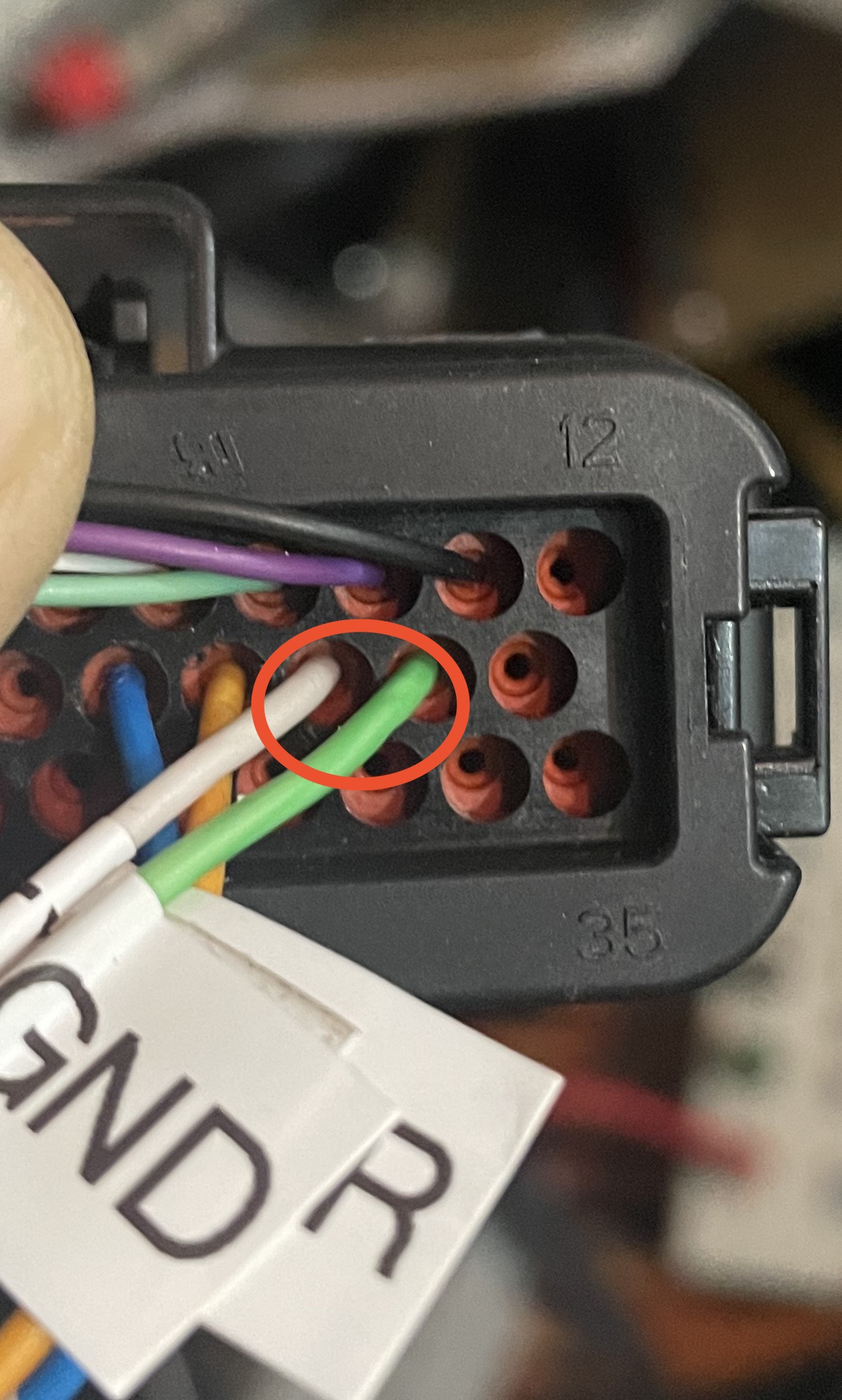

I think I burned out my resolver excite. Getting nothing on amp seal pin 21 and 22

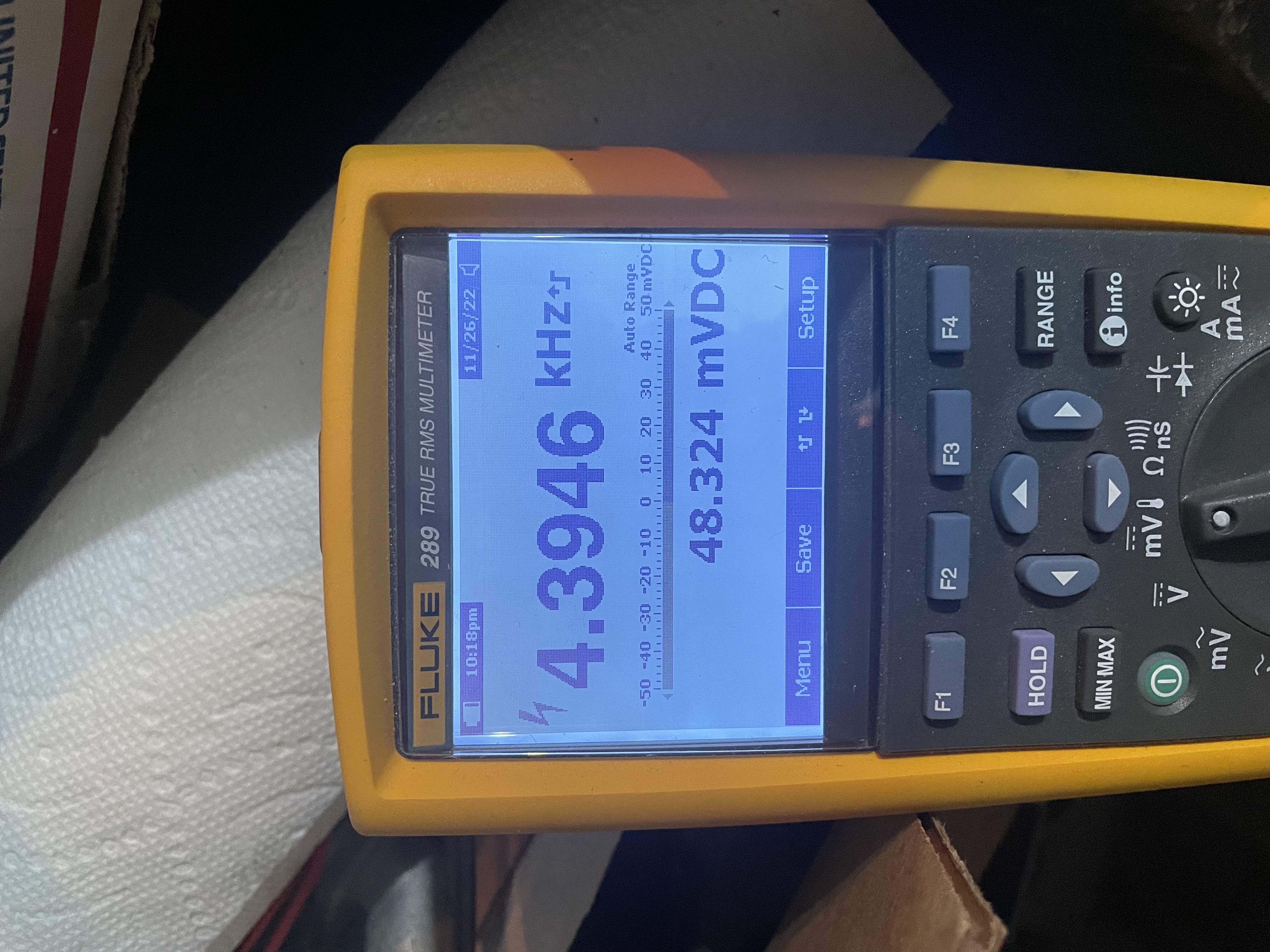

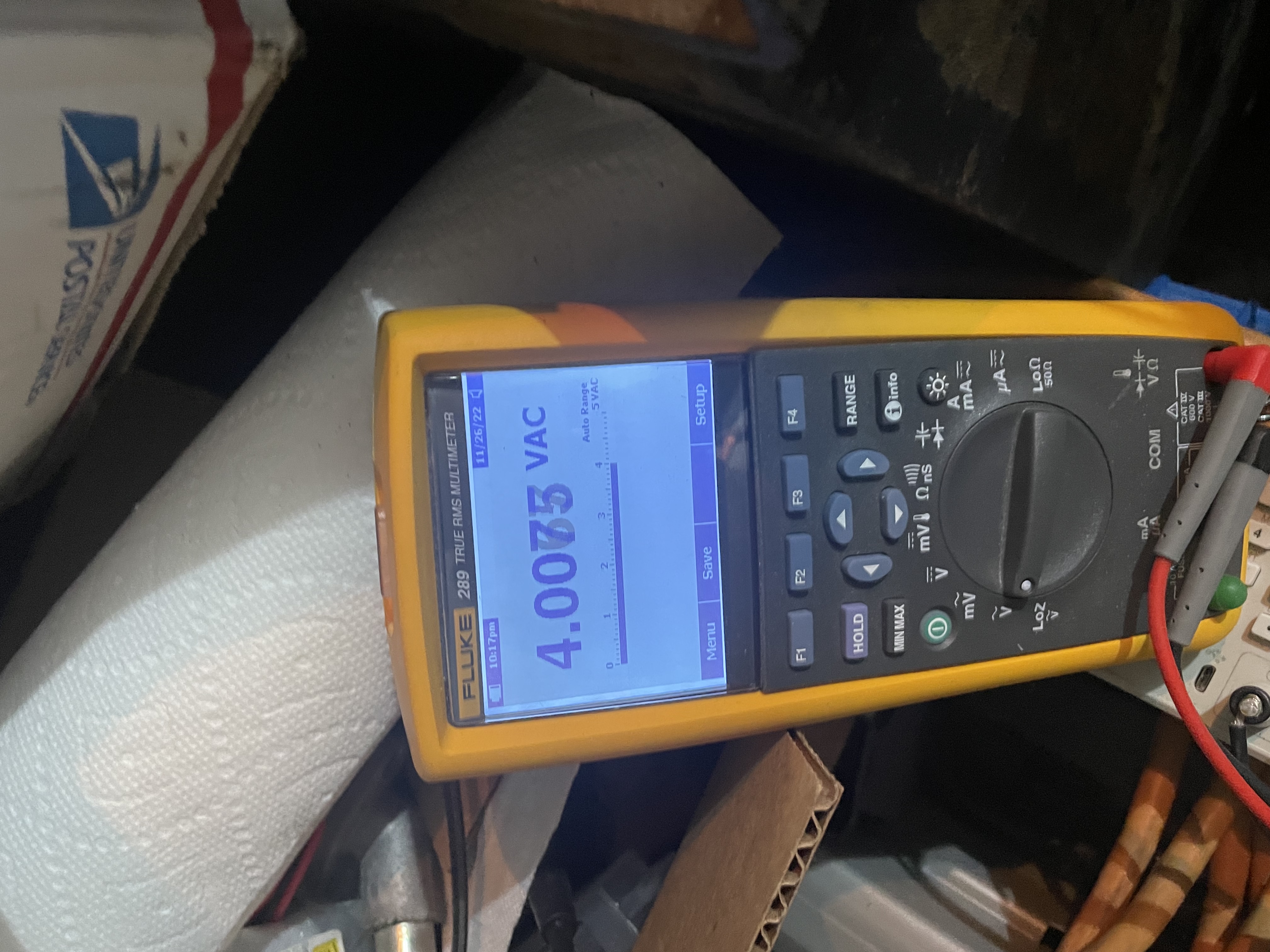

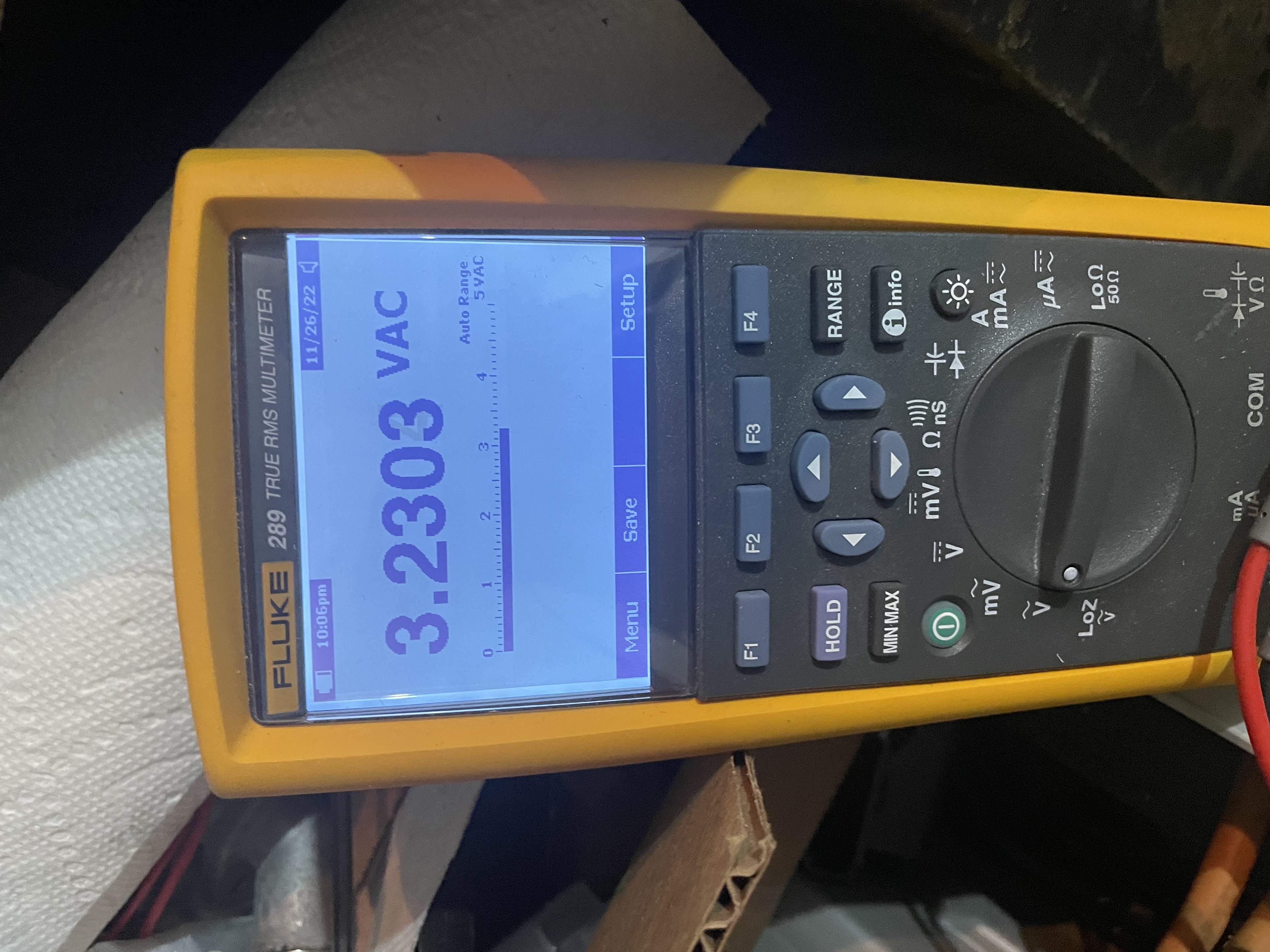

Update: got confused because idc ribbon cable and ampseal pinout are same half the time, well with resolver its all mixed up. Must be on the ampseal pinout. Also could not find this online anywhere, the open inverter excitation frequency is 4.4khz and the voltage is 3.2 volts AC no load (without anything hooked up), with the em61 motor resolver hooked up i back probed at the motor and got 4v ac. Em61 resolvedr excite winding is 17ohms. See attached photos
