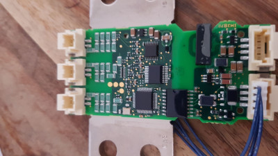

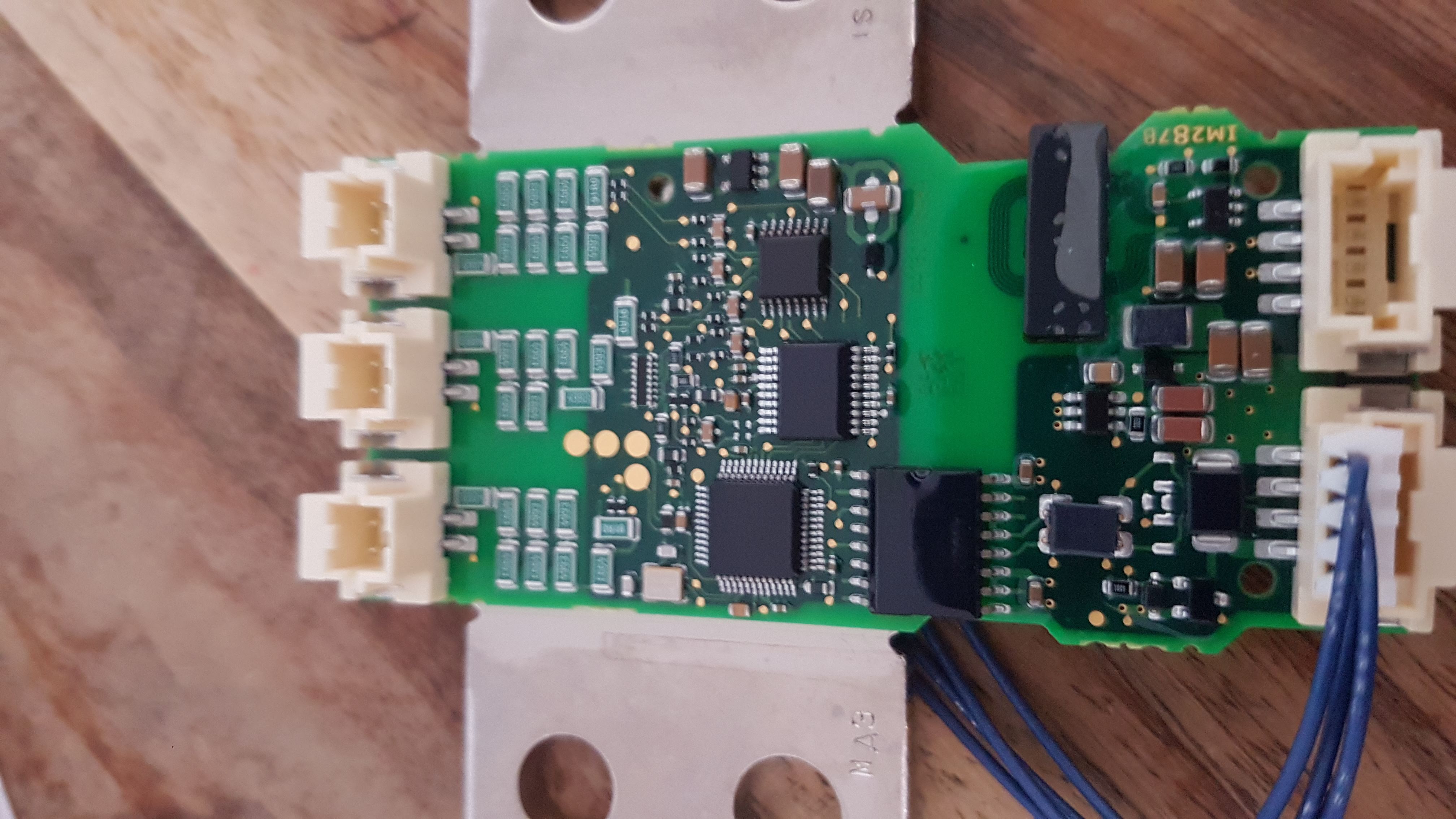

Posts: 1884
Has thanked: 91 times
Been thanked: 517 times
Re: IVT-S Shut Inquiry
Pretty sure you can open it up and remove the termination resistor
This is inside my unterminated, if you can find the termination resistor on yours and desolder it, it'll be then unterminated :D If it's the same PCB, there's a couple of unpopulated pads, maybe it has 2 x 60R instead of a single 120R

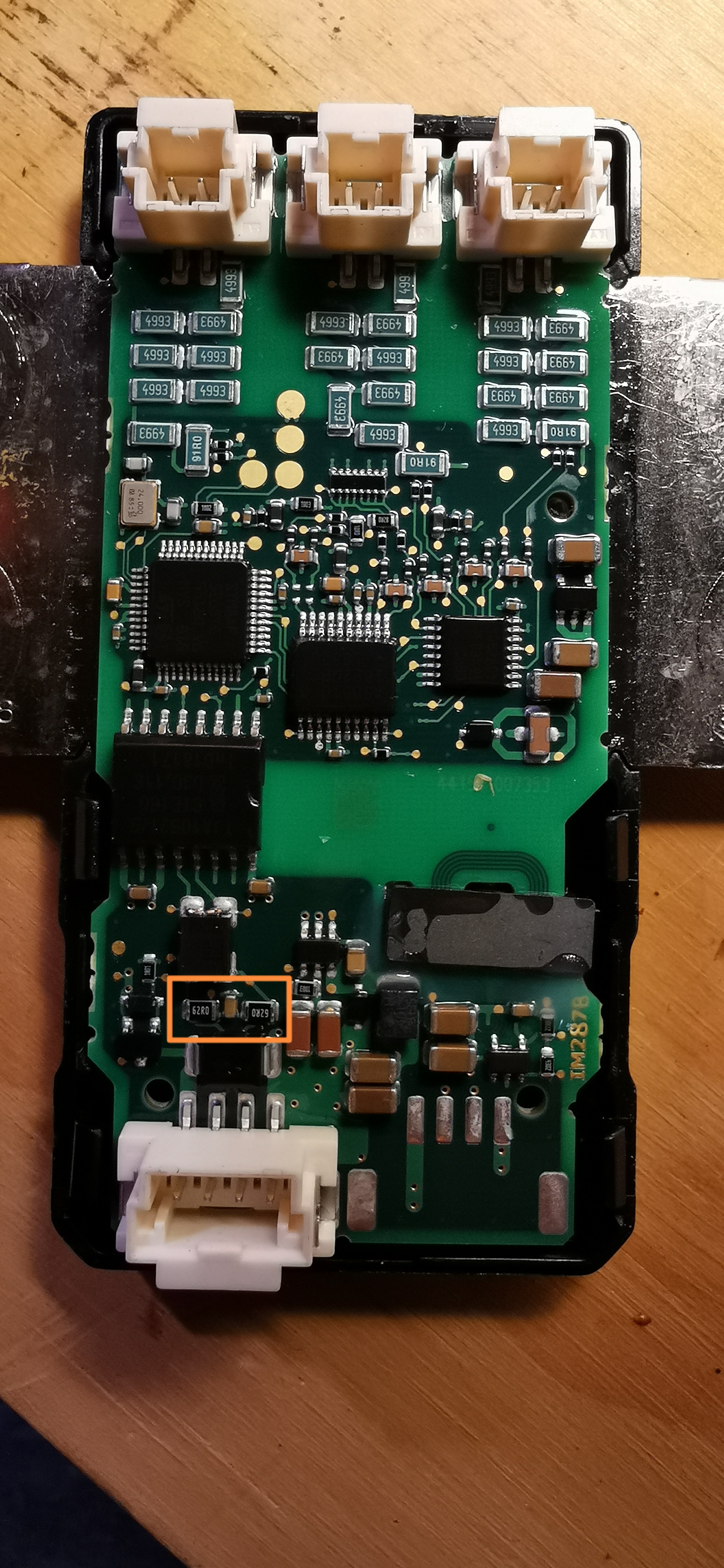

alexbeatle
Posts: 292
Has thanked: 82 times
Been thanked: 35 times
Post by alexbeatle »
Bigpie wrote: Thu Feb 16, 2023 9:07 am Pretty sure you can open it up and remove the termination resistor
Thank you!
Mine has 2x 60ohm resistors in series and a capacitor in between. Does the capacitor need to be removed too?
Posts: 1884
yep, take em off, mine looks to not have all 3.
