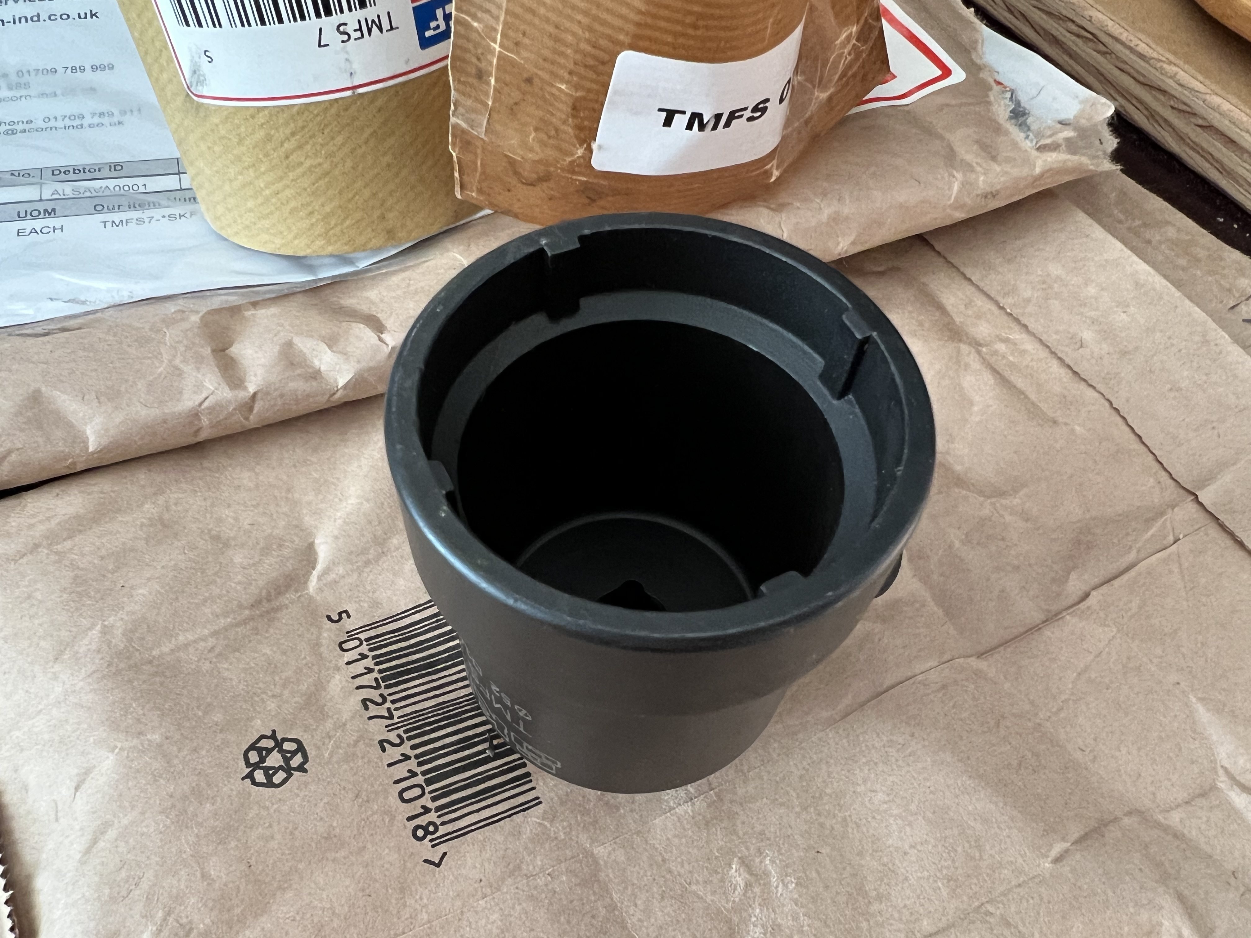

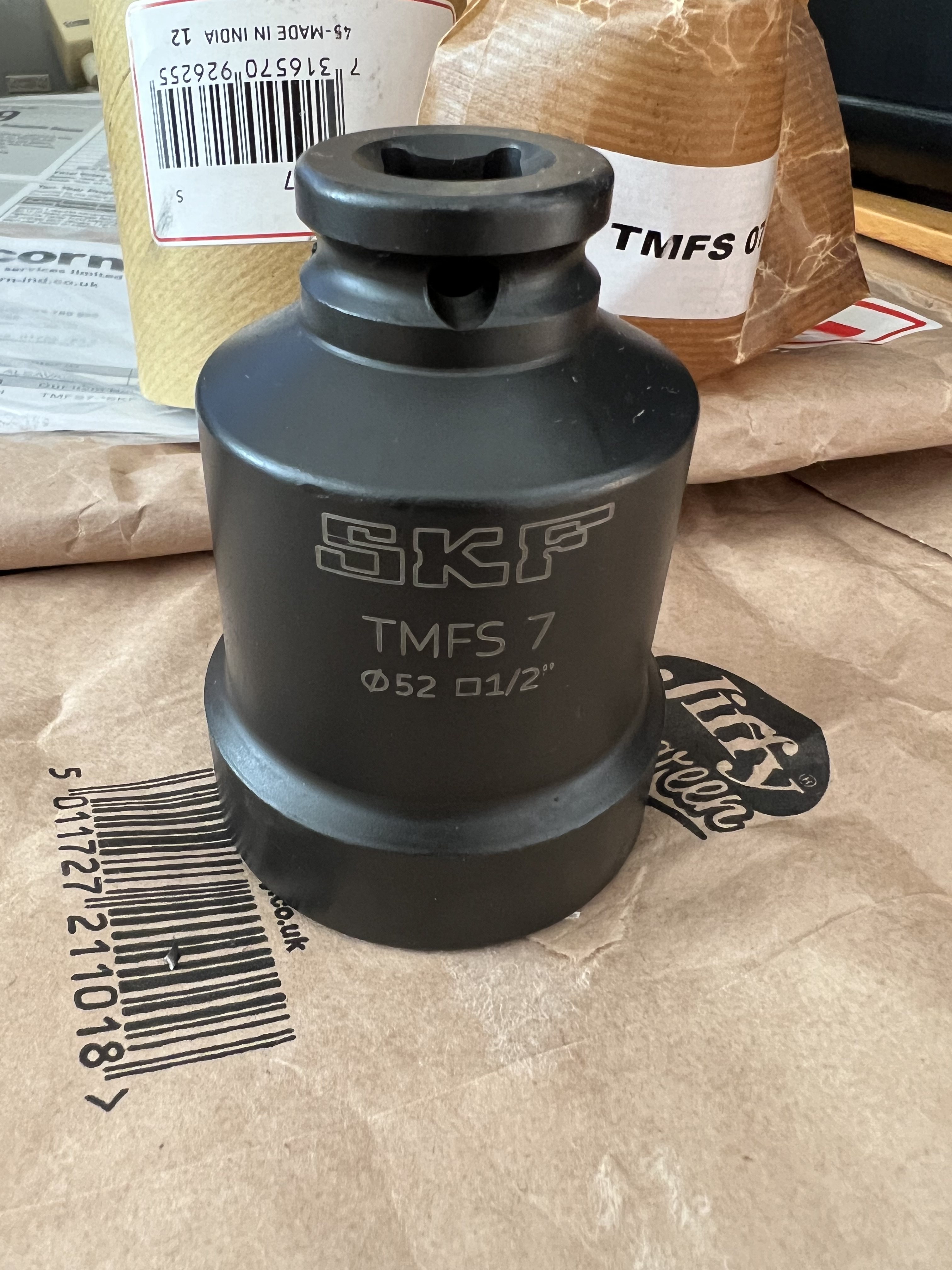

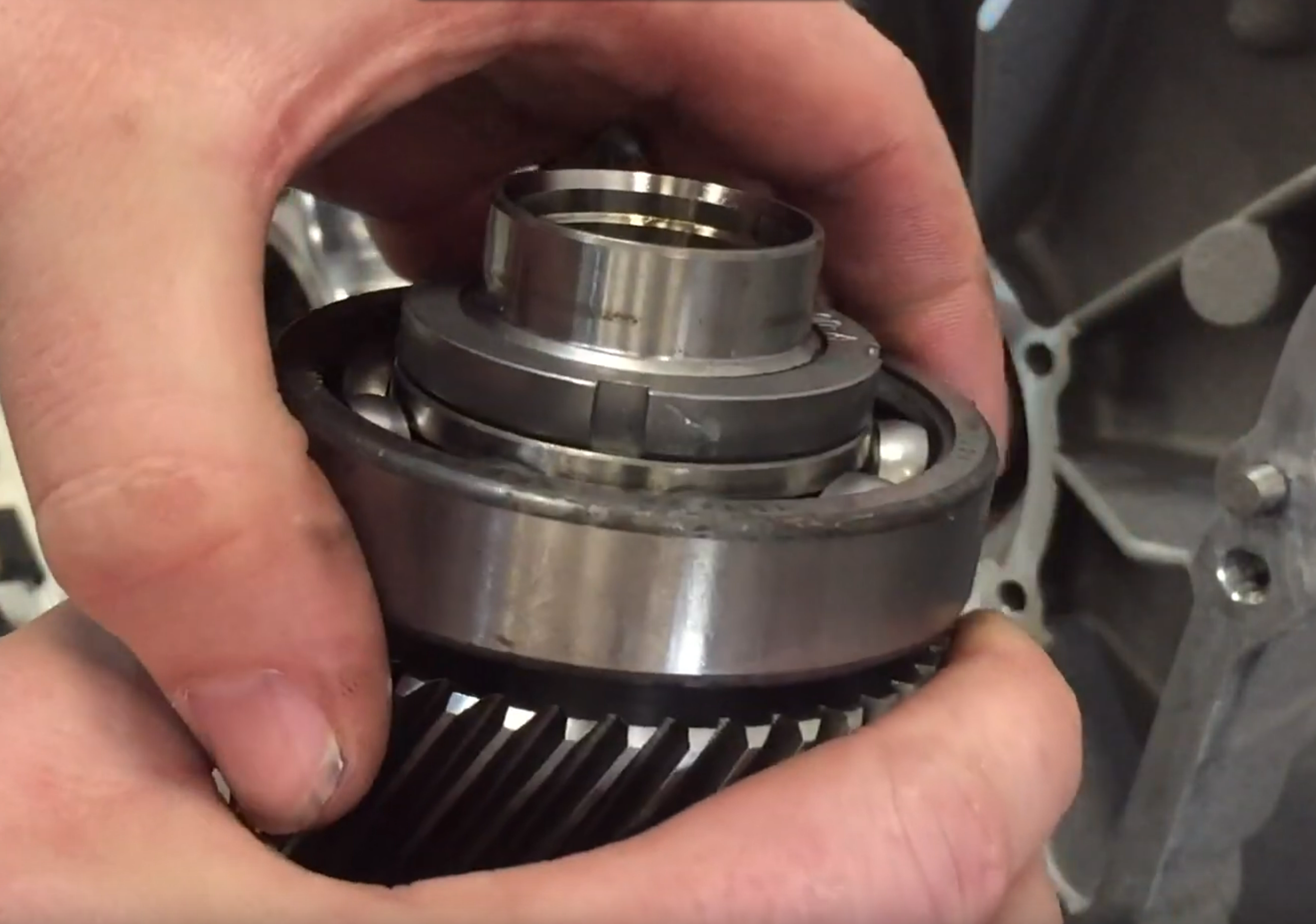

Rotor bearing at gearbox end requires locknut removal to replace
The rotor bearing at the gearbox end has a groove nut. It's the equivalent of SKF KM 7.
(https://smile.amazon.com/Whittet-Higgin ... B01EMOZQNU)
(https://youtu.be/_GigD0s47RI?t=129)

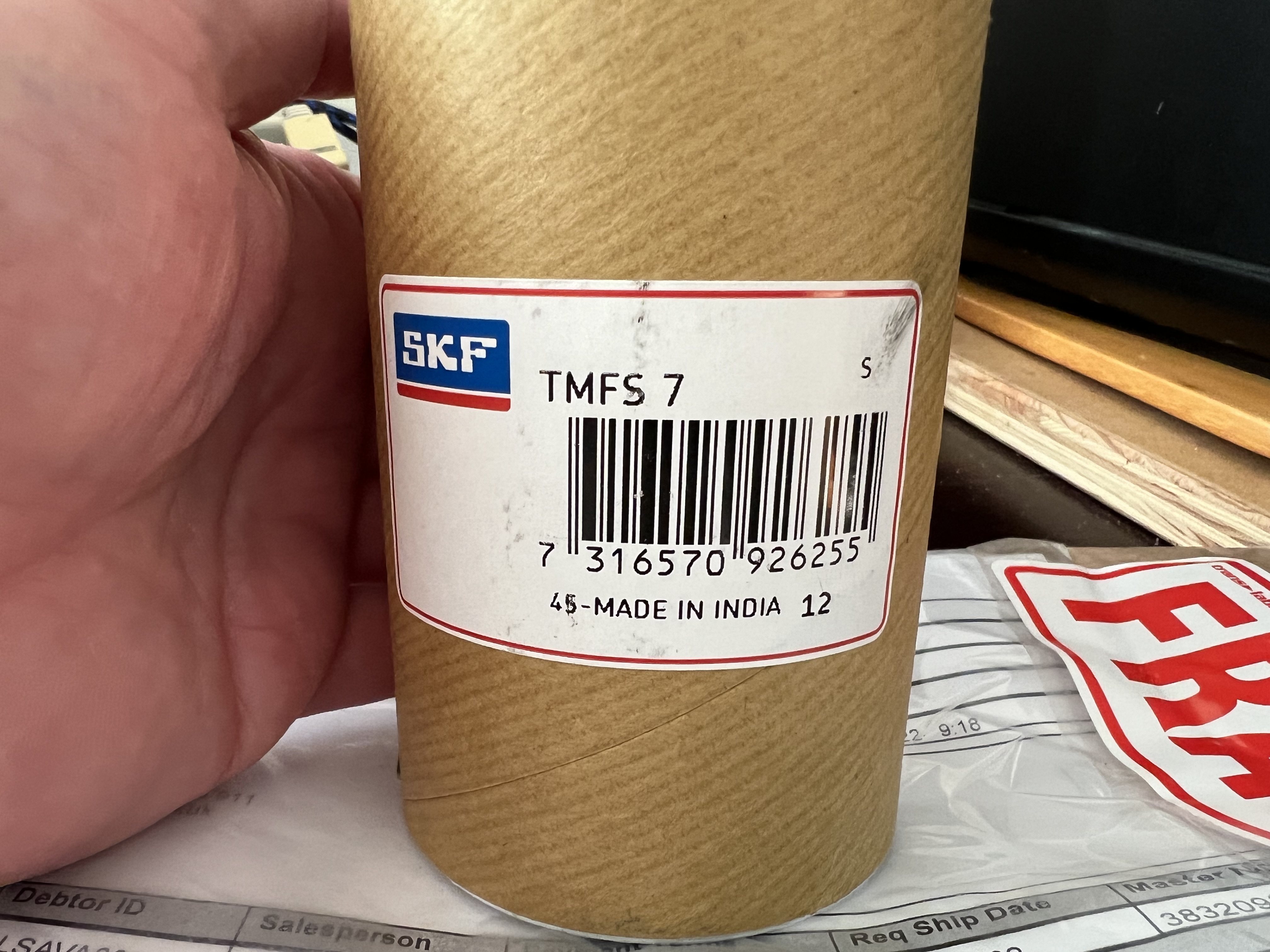

While R&R of this nut doesn't necessarily require the mating tool (workarounds exist, including a nice SKF Hook Spanner wrench), the SKF TMFS 7 socket is a "correct" tool, and allows torquing the nut to a specified value if desired. I ordered one from Acorn Industrial (UK) for USD$88 + shipping (USD$112 shipped to my doorstep, six days delivery via DHL).

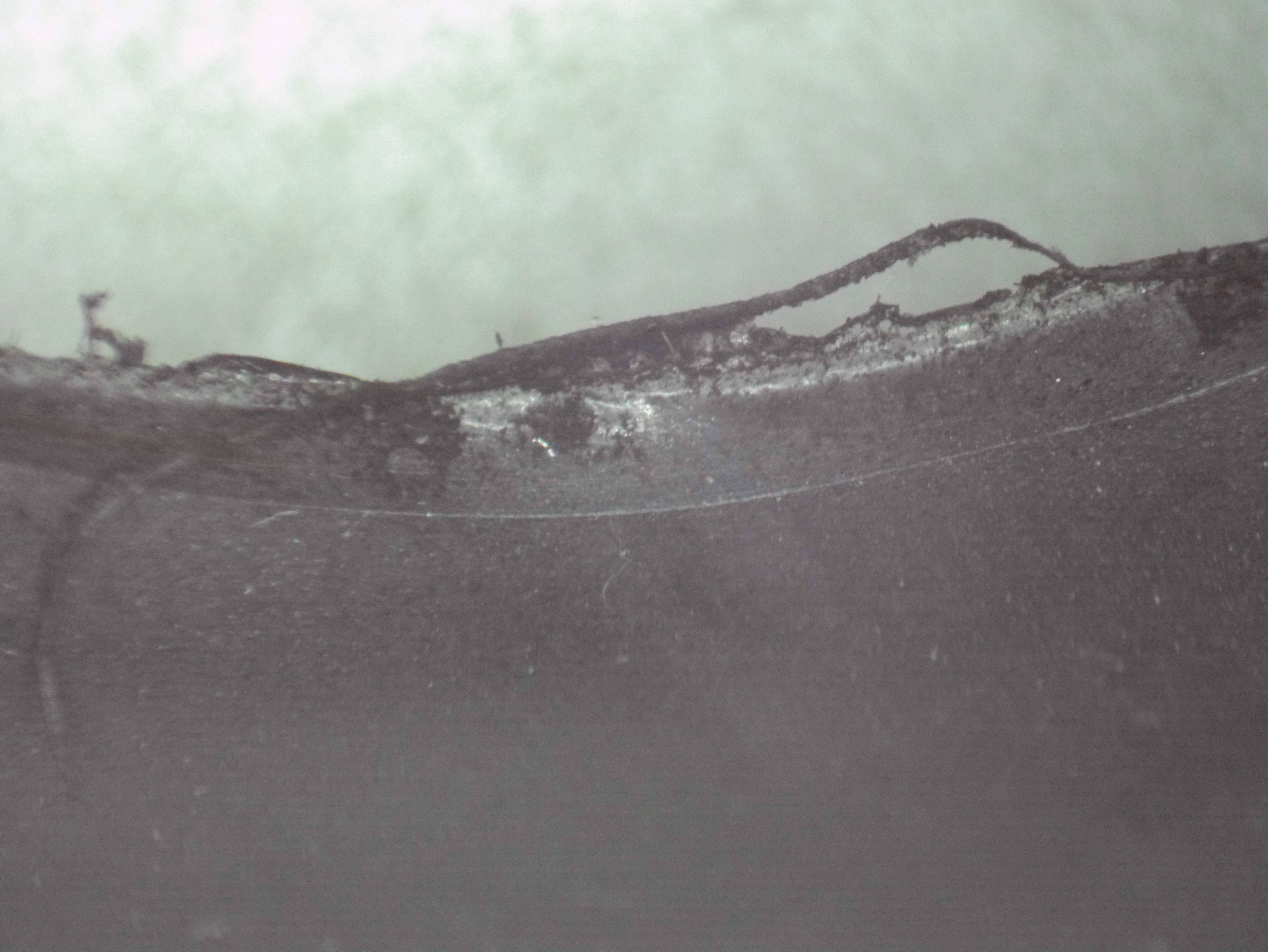

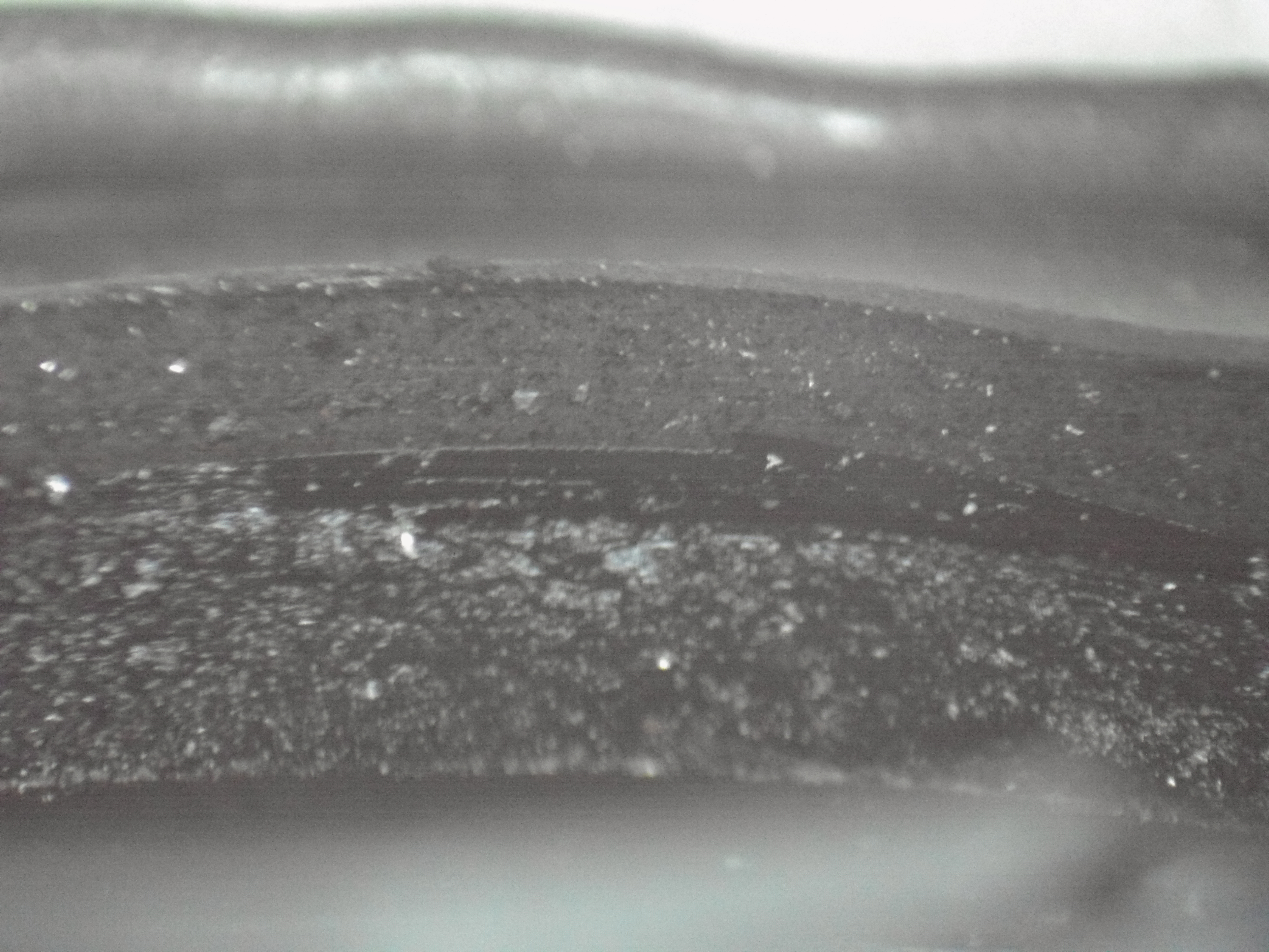

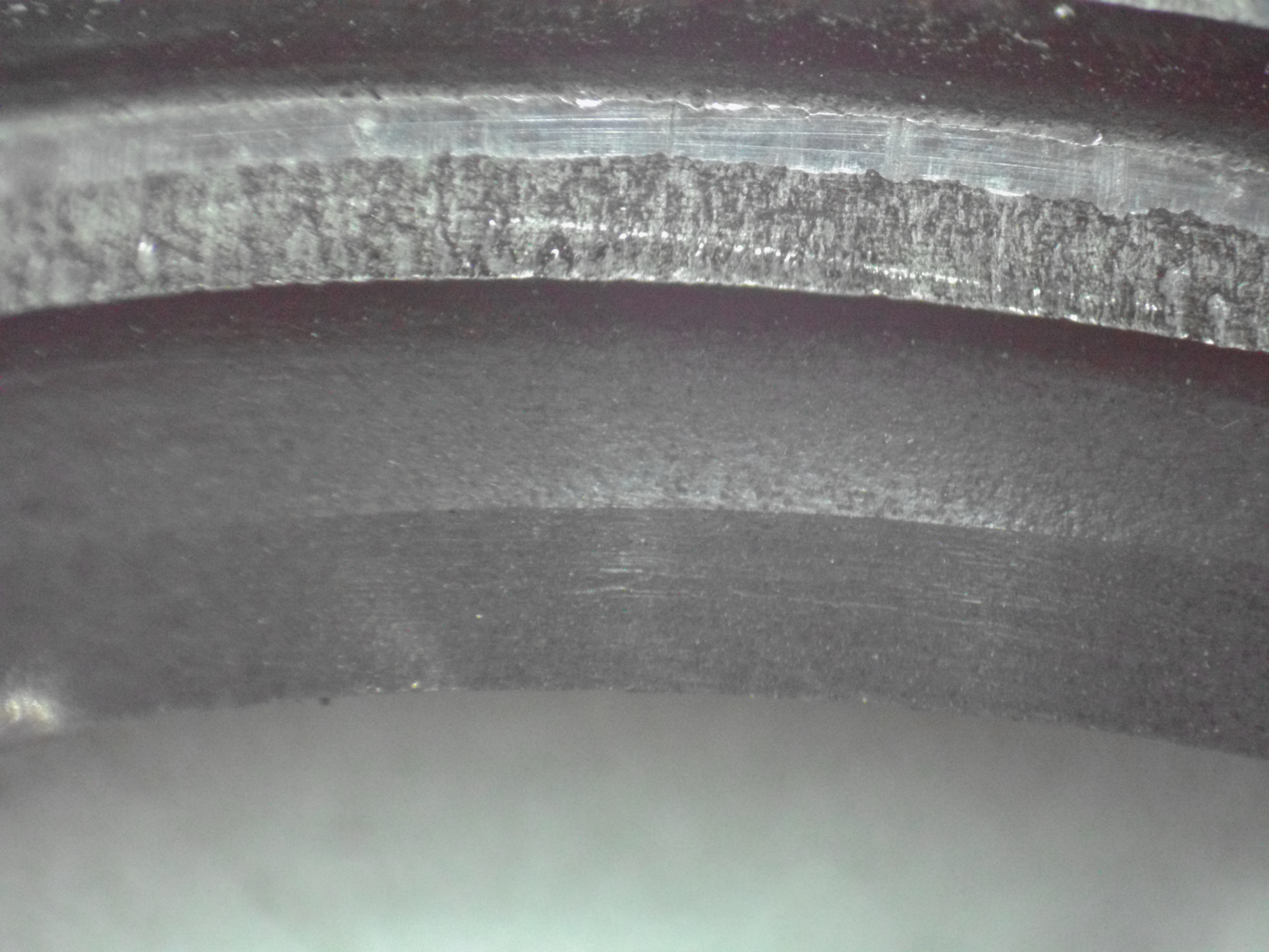

In attachment some pictures of my triple lip rev Q seal with a small leak for at least 8 months. The seal is 5 years old and 77.000 km.
All the seals are flat without concentric rings or other features. The seal at coolant side and dust lip were in pretty good shape. The middle seal was almost completely gone. There was a black sticky crust of dust between the two coolant lips, this was probably the disintegrated PTFE from the middle lip.
My rotor shaft surface was in pretty bad shape.

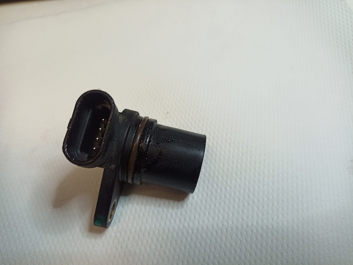

By the way: I’ve checked the speed sensor after driving 400 km with the new seal (Ceimin CTLBDYW). Well, that wasn’t what I hoped. There was condensation on the sensor. The drain was still dry (was plugged, so I would know how much it leaked). I collected about one drop of coolant when using some compressed air to flush the reluctor chamber.
I don’t think the speedi sleeves are usable with PTFE seals. I think the seal is stretched too much cause of the increase in diameter.
I’m going to keep driving for a while and keep checking the leak. If it get worse, I’ll pull the rotor to get it welded and grinded to the correct diameter and try with a new seal.
