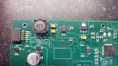

Tesla large drive unit boards now in production at JLC.

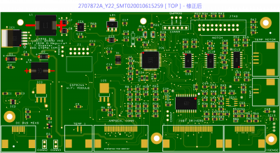

First batch of prototypes have arrived from JLCPCB. Initial observation is that this is top tier board building. As good as anything I have ever seen in my career and better than anything local who have charged a hell of a lot more.
I'd like to appeal for some calm in relation to the whole JLC build. I won't be responding to anymore "DAMIEN! WHEN ARE YOU RELEASING THE JLC BOM AND PLACEMENT FILES!" type of emails or messages on here or otherwise. The boards will be tested. Errors if found corrected. Webshop and github will then be updated and videos made. The vast majority of people are great and appreciate the effort involved but some seem to think I'm their personal design engineer. Newsflash! I'm not.
Now in relation to the webshop we'll be making a few changes. There will be three tiers of board available to buy :
1) Board direct from JLC as I receive them with listed smt placed, unprogrammed and untested. This will replace the bare boards currently on sale.
2) Board direct from JLC as I receive them with listed smt placed, programmed but untested. This gets around the need for programming the micros.
3) Board with all components both listed smt and non listed smt and through hole placed, programmed and tested.
