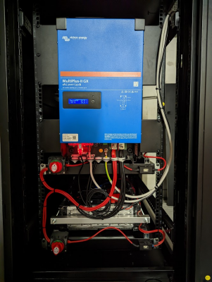

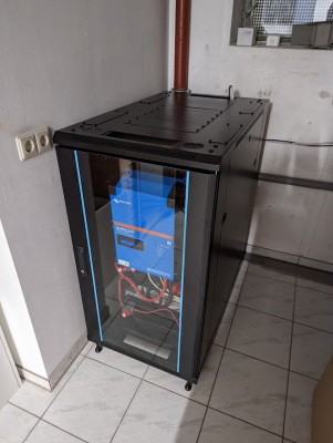

My energy supplier raised the price for 1 kWh of Energy from 0,27 EUR to 0,67 EUR. I then sold my 10 kWh Senec energy storage and decided to built my own, bigger 18kWh and better ESS.

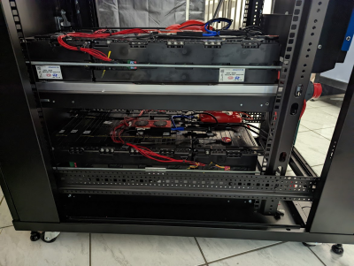

I used a 19" server rack with rack inserts where the batteries are mounted on. For controlling the ESS i bought a Victron Multiplus 2 GX 48v. It's a 14S3P system with 218Wh for each cell. 2 of the 14S3P packs are in parallel. It's fairly easy to upgrade to two more for a total capacity of 36 kWh.

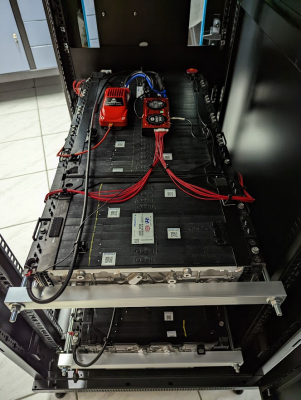

The BMS is a Daly BMS RS485, can Bus, Bluetooth and the ability to parallel the packs.
To achieve the 14 s pack i used a whole 10s3p out of the Kona and cut another one down to 4s3p. Of course i took the batteries out for cutting it!!!
I used threated rods and Aluminium bars to apply compression to the batteries as in the 4S configuration it's not properly there anymore.

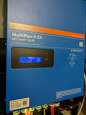

Meanwhile the system is running and i'm more than pleased with the functionality of the Victron Multiplus 2 GX device. With this device it is definately possible to retrofit a ESS (Energy Storage System) into any existing solar grid installation.
I now have a tariff for energy that is billed by the hour. On my energy meter i installed a little device that reads the values optically and sends it to the energy provider via WiFi. Due to the fact that photovoltaic energy is barely there at the moment (winter in Germany) i set the ESS up that it charges from the power grid every night until a certain SoC. So i get the cheaper energy all day long (35-49 cents at night compared to 65 - 90 cents during the day).
