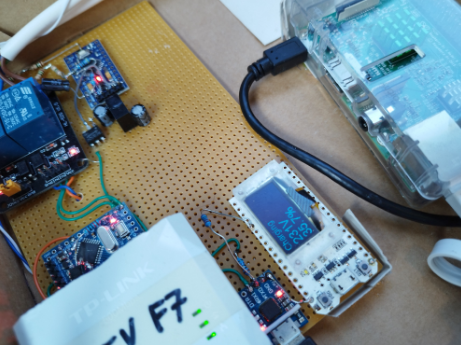

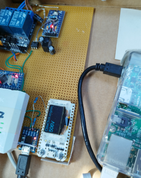

Some small progress on the Tesla SuperCharger: SLAC and TCP connections work perfect, also with the headless Raspberry3 as controller. In contrast to the other chargers, the SuperCharger use only 8 characters session ID instead of 16. This case is not yet considered in the OpenV2Gx. At the moment the SuperCharger complains (correctly) about wrong session ID. Updates are ongoing.
- uhi22
- Posts: 1117
- Has thanked: 206 times
- Been thanked: 618 times
In cold days it's always a good idea to have a hot tea during the charging breaks. And here we go:
Version v0.6 released.You do not have the required permissions to view the files attached to this post.
