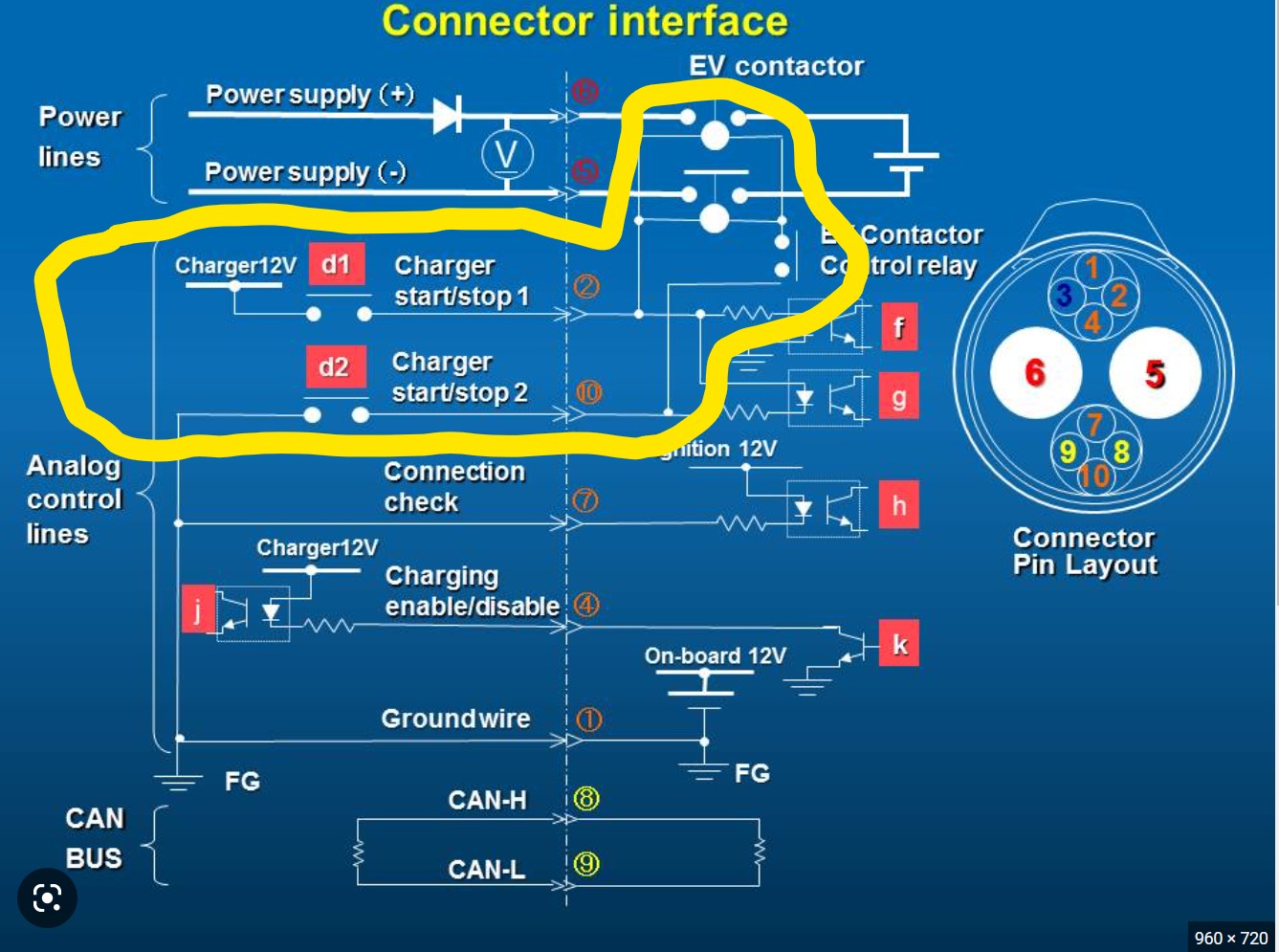

I'm on another CHAdeMO trip with a London taxi. We added CHAdeMO to it but on many stations we can't charge.
When looking at CAN it looks mostly similar:
- startup works ok
- Stations ramps up its test voltage to 500V
- Station closes EV contactors briefly but sees no voltage
- Charge is aborted
The contactors are stock Nissan with stock economizer board

I had the same issue on my last CHAdeMO conversion. All seemed straight and nicely timed on the CAN and signals implementation, but my sessions were failing on SOME stations around town. I even learned by trial and error which brand and generation of EVSEs were rejecting my car.
The failure timing was similar to yours:
- startup works ok
- Charge is aborted
After having access to one of them to investigate closer, I was able to scope everything and pinpoint the culprit.
My hardware was textbook example of the CHAdeMO schematic, as is. Meaning that I connected the coils of my two chademo contactors (some gigavacs with economizers) as pictured in the schematic: to be powered by D1 (start stop 1 / 12V) and D2 (start stop 2 / GND) coming directly from the station. Yes, on the vehicle side you have a relay (called "EV contactor control relay" on the right) to accept this power, but the current itself in your coils is coming from the EVSE.
I discovered that having two gigavac contactors to power was too much current for some stations. Right after they close the contactors, they asses the current / voltage going through D1 D2 and they simply open everything and fail the session.
My solution what quite simple: I did what you would do... I routed D1 and D2 to energize the coil of a smaller relay, that powers the two large CHAdeMO coils in the vehicle WITH vehicle-supplied 12V.
It solved everything. On every problematic station.
The 11V voltage you read on some stations is just a hint that they can't supply your coils with enough current. Use smaller contactors or add a small relay to power everything from your (infinite) onboard known-good 12V.
That would be an easy thing to try.

Max allowed current draw is 2A

Indeed... but as with every implementation, the EVSE builders sometimes differ one way or another with their final setup. (just like us, on the vehicle end). I guess sometimes they go for "2A continuous" and sometimes they go for "no more than 2A at any time"... and sometimes they just go with the label of their internal 12V power supply and they substract their own current consumption.larsrengersen wrote: ↑Fri Dec 23, 2022 7:36 pm Max allowed current draw is 2A
https://www.evcreate.nl/chademo-fast-charging-in-diy/
Same goes for a few other signals where the designer can interpret things. I've seen first gen Kia Soul EVs not being detected by some CHAdeMO stations around here.
