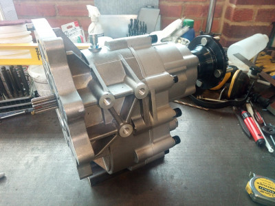

My friendly local UPS driver brought me a box from Zero-EV today. This was inside.

Mind disclosing how much it cost? They provide any specifications with it to allow you to make couplers for it and adapter plates?

Yeah, what is this thing? Pre-production? What's the mating face and output? It's not something one can go to their site, click and buy...

Chris asked me not to share the CAD file or cost right now. They're still changing the design and exchange rates keep fluctuating.
However, if you were to buy the version designed to bolt up to a Hyper 9, you should be looking at less than £2000 all in. They're expecting to soon have a version with an integral Hyper 9 mounting face that would be a bit cheaper and will have versions designed to mate up with their new Zonic motor lineup.
The imput spline on mine is a DIN 5480 N25x1.25x30x18x9H

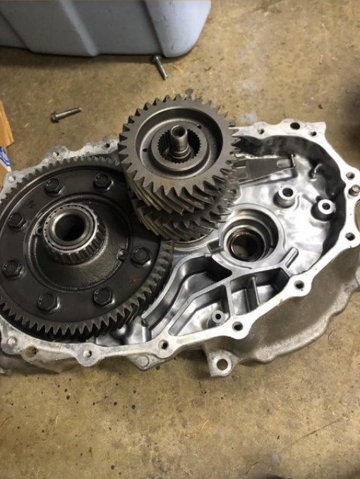

some late-night shenanigan's...
so you can swap gen1/gen2 ratios.
the rings gears are the same, gen2 is about 5mm thicker...
(gen2 removable gear sitting on top)
gen 1 intermediate shaft/gear just dropped right into a gen2 box. from first glance, the shafts are the same! just the removable gear is a different pitch!so you can swap gen1/gen2 ratios.

What does that buy you? Aren't the ratios between Leaf years very, very similar (pretty much just 8:1)?

well being that the em61 have larger magnets and higher torque output, and the em57 gearbox has bigger gears... and slightly more reduction...a race car drive train!
