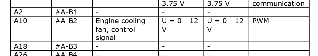

Very interesting idea. In the C30 (my other project car) I think uses exactly the controller you linked to. (C30, S40, V50 and C70 uses the same platform, Volvo P1).
In the wiring diagram for my car it looks like this:
CoolingFanVolvoC30.pdf
(32.55 KiB) Downloaded 209 times
And then reading the pinout explanation for the 2.0D ECM pin A:B2:
It shure looks like the ECM is just sending a 12V PWM signal to the fan controller. The fan controller is mounted very close to the fan motor in the car.
I do not have the C30 in the garage at the moment but I still have all parts needed to hook it up and maybe possible to measure the PWM frequency even if I don't have the IC motor and all the other signals to the ECM. Let me know if I should look into this when the car is back in the garage?
