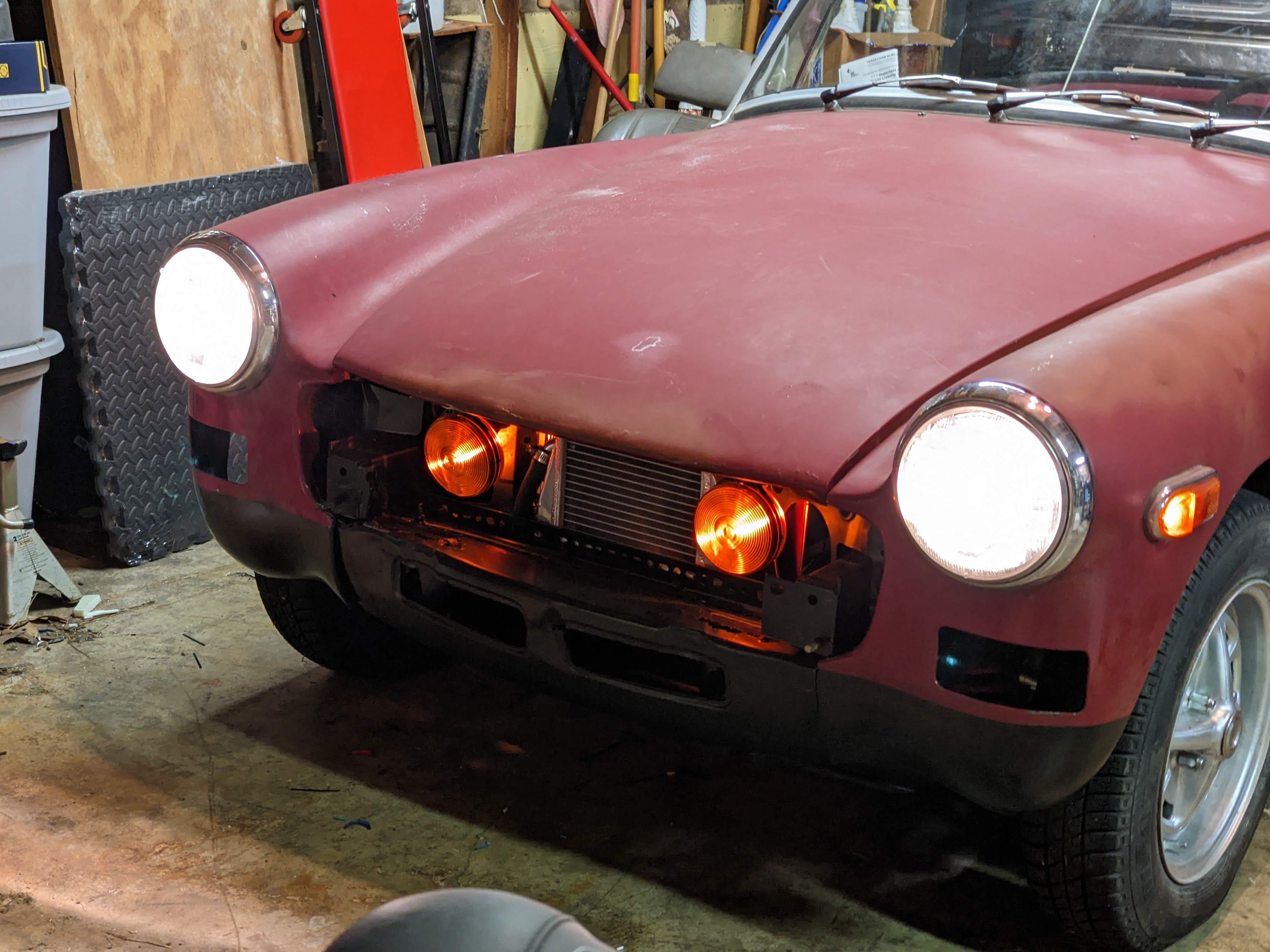

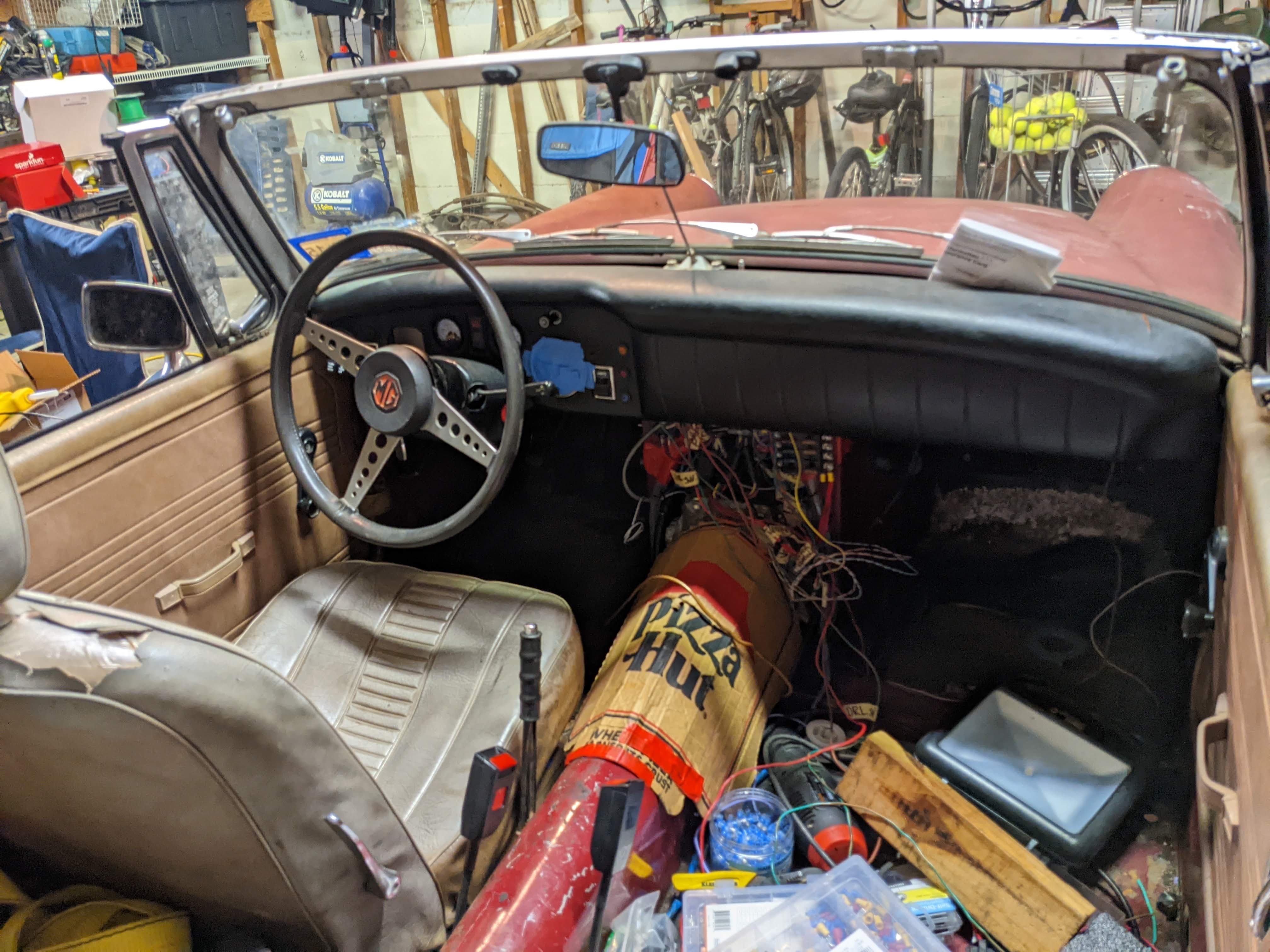

A quick update. Dash is back in with new gauges and all lights working. Turn signals, headlights, hazards, parking, license plate, etc. all good to go. Next steps is center console and some relays to force driver to put system in Park and depress brake to place in Drive. Reverse will be called up by pushing the windshield washer function on the right stalk. Pics attached. Gauges from left to right: Thunderstruck/Dilithium BMS display screen, 500v meter, 15v meter, AutoMeter electronic speedo coming right off the pulse pin of the 450h trans.

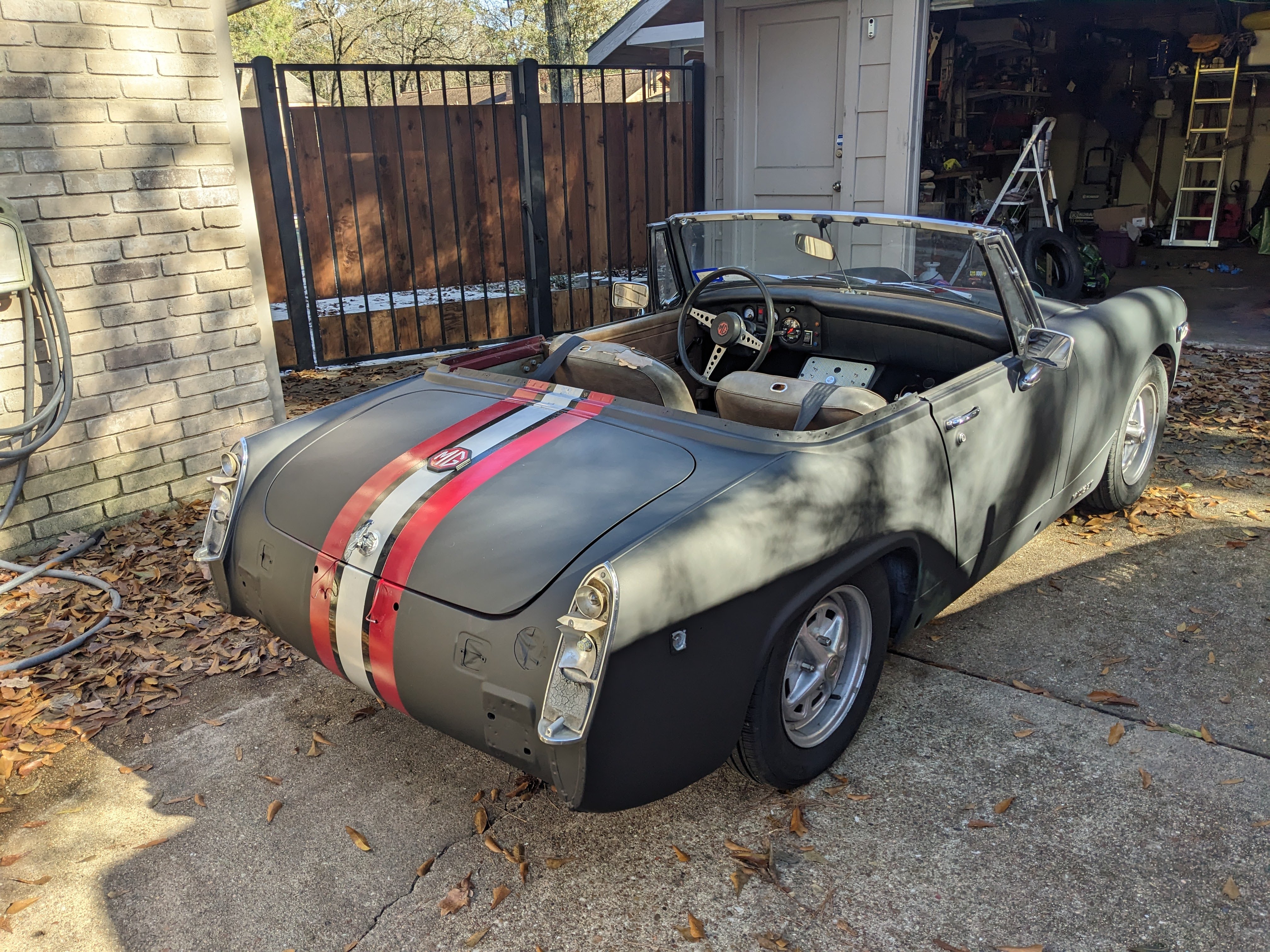

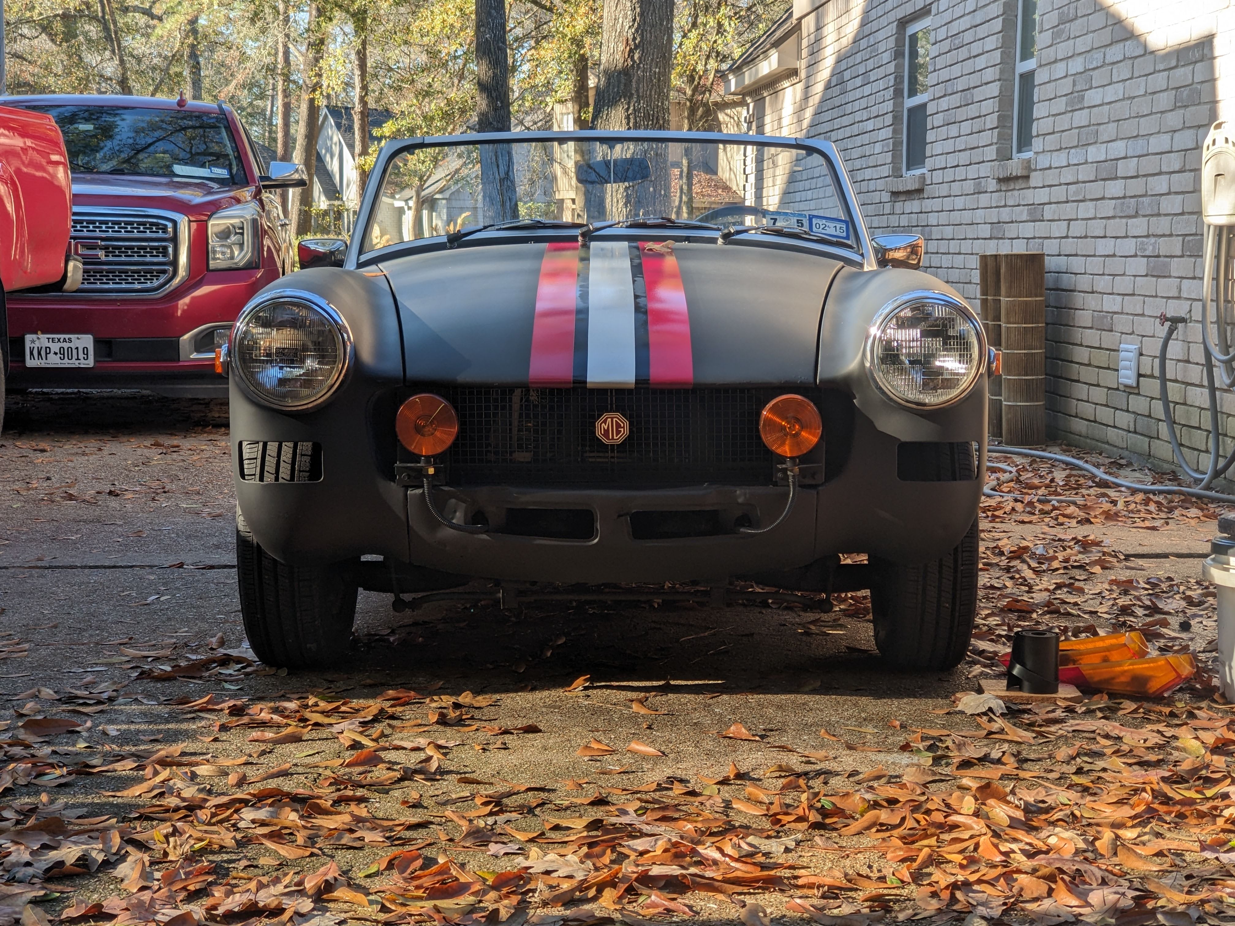

NEW PICS --
Rust-o-leum paint job complete. Officially 2 full years since I started work on the car.
