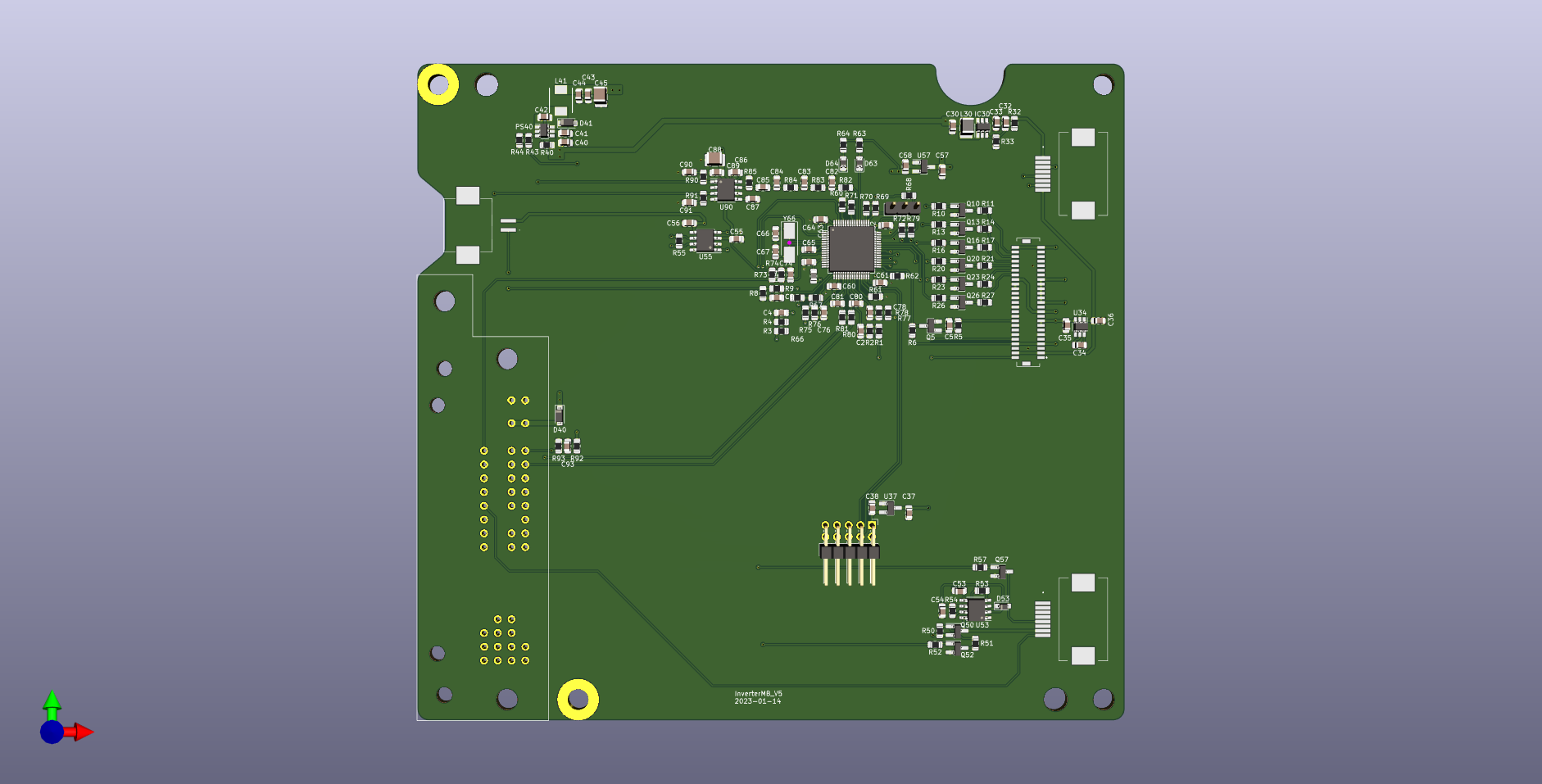

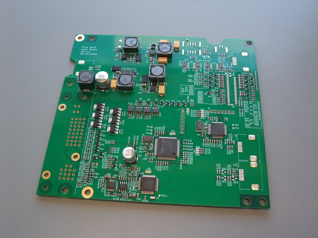

Progress (well hopefully - if it all works!):
Power supplies are coming up, resolver to digital converter IC is clocking and generating the resolver drive waveforms and I can talk to both processors with the debugger. I've tried putting the code on the STM32F407 processor and it programs OK and in the debugger it single steps through main and completes all the initialisation code but when allowed to free run it ends up in the blocking_handler interrupt so I'm guessing I've messed up an interrupt configuration somewhere. Hopefully spend some time on it in the evenings, get it all tested and if it's OK get the rest of the bits ordered and look at hooking it up to the inverter and HSG.
Forgot how much of a pain hand assembly is! I've left all the difficult to replace bits off for now (mainly the Toyota connectors) until I know whether it works. Couple of slight problems, one diode on backward which stopped the -5V rail from working and there are a few components that I managed to miss when ordering but it generally looks OK. Power supplies are coming up, resolver to digital converter IC is clocking and generating the resolver drive waveforms and I can talk to both processors with the debugger. I've tried putting the code on the STM32F407 processor and it programs OK and in the debugger it single steps through main and completes all the initialisation code but when allowed to free run it ends up in the blocking_handler interrupt so I'm guessing I've messed up an interrupt configuration somewhere. Hopefully spend some time on it in the evenings, get it all tested and if it's OK get the rest of the bits ordered and look at hooking it up to the inverter and HSG.

Re: Smart Roadster (with Prius Gen3 Inverter and Outlander Rear Motor)
Looks good!
I see you have gone for the all in design with a lot of capabillities. I have started my own design for a Yaris logic board but with the bare minimum capabillity. Looks silly sparse compared to yours.

I thought this was fairly stripped out compared to the first design (viewtopic.php?p=39624#p39624)!
I've moved most the VCU related stuff out to a second unit. The contactor control bits are only there temporarily to allow the car to be used before the VCU is in.
What else are you cutting out of yours? Are you using Kicad for it?
Yes, using kicad. Removed everything I don't need. Using STM32 and stock design, so no fancy stuff like yours.
No input/outputs as it's done via CAN.
Removed MG1 current sensor.
Added DC/DC voltage control via NE555 timer.
Power supplies,
Top left, PS40 is the 5V, high frequency buck
Top right, IC30 is 26V, high frequency boost
Right of 50pin connector, u34 is -5v, switched capacitor inverter
Top right of CPU, U57 is 3,3V, LDO
Right of WIFI module connector, U37 is 3,3V, LDO
NE555 creates fixed PWM frequency of ~20Hz and 51% duty cycle for a solid 14,0V output from the DC/DC. No adjustment other then HW change.
EDIT: 51% duty results in 13,8V DC/DC output.

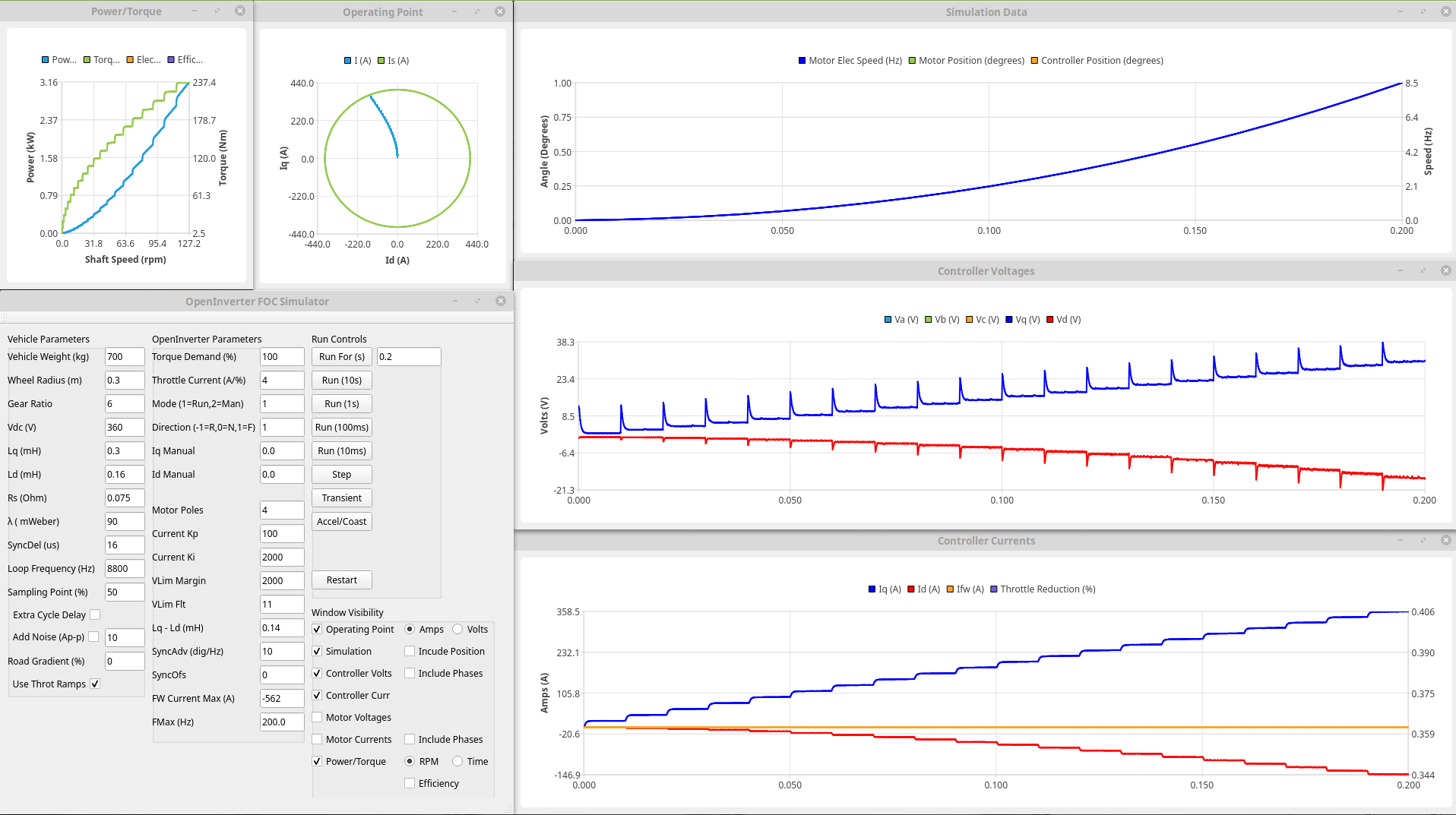

Edit2 - Re-measured the phase delay of the filter concentrating on the area below cutoff (the actual operating region) and it is worse than I thought - 190us. Looks like the cutoff frequency will need to increase by a factor of 10 (to 20kHz) to have a low enough delay so will definitely have to move to reload point sampling. The question at that point is it worth keeping at all? Do I bypass it completely (can be done by fitting zero ohm links) and save the power consumption and reduce component count or leave it in but set to a higher freq to remove any other noise that may be present?
These are there because I'm a little worried about the low inductance of the Outlander motor (0.15mH) causing excessive ripple. The idea of the filter is to allow the commutation frequency components through while blocking the PWM frequency components. It should also block switching frequency components pretty well.
First problem, I didn't put pull down resistors on the filter inputs (becoming a bit of a theme!) which meant that the op-amp bias currents pulled the outputs up to full scale when the CTs isn't connected; luckily I had included some schottky protection diodes in the circuit so the processor ADC inputs survived. Also luckily there was a suitable ground pad next to the filter input so 100k pull-downs are now bodged on.
The measured filter response looks like this: The yellow line is the max commutation frequency for the Outlander motor (running up to 10krpm) while the orange line is the PWM ripple frequency (assuming PWM running at 8kHz). While it doesn't look too bad I'm not sure it is quite right, the filter cut-off was chosen when I was planning on running 4.4kHz PWM so it's a bit low now. I have also just measured the phase delay and at 100-150us it is enough to lose all the latency gains made moving to the stm32F4.
I'm now wondering what the best compromise is. I had planned to sample the resolver/current at the mid PWM timer reload point which would minimise the measure to output latency (30us) but doing that means that the ADC is sampling at points of the PWM waveforms where IGBT switching is occurring. If the sample point and a switch event coincide there will be lots of noise on the signal. Also, depending on PWM duty cycle, the motor current could be rising or falling so adding PWM frequency noise. Hence the filters, but if the filters add another 125us latency I'm up to 155us which is not much better than the 180us starting point (but hopefully with lower noise current samples).
It's possible that a better compromise is to sample at the reload point. Now this means that it will be 60us till the measurement has an effect on the PWM duty cycles but because it is guaranteed that there will not be a switching event you can get away with a much worse, and lower phase delay filter. Say I could get the phase delay down to nearer 40us that would give a total latency of nearer 100us. It also means that you are always measuring on the same point on the PWM ripple so there should be no beating effect. So the latency isn't as low as I'd like but the current sampling should be very clean.
Not sure what the best compromise is? It's either change the cut-off from 2kHz to 4kHz and stick with mid-point sampling or change it from 2kHz to 8kHz and go with reload point sampling. Both will be pretty similar in terms of total latency at ~100us but the later should give cleaner current signals so currently erring in that direction. Comments welcome!
Edit - think I'm going to move to sampling at the PWM reload point. The filter cutoff frequency will be lifted to ~12kHz (chosen because I already have the cap values needed!) which should drop the phase delay to around 20us while still giving a bit of attenuation to PWM frequency (~9dB) and good attenuation to switching noise (which will still help with data logging via the non synchronised sampling on the other ADC). Total latency will be around 80us. Not as good as I'd like but still a worthwhile improvement.

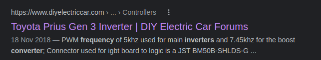

I agree with celeron55, the buck-boost is very noisy, even at 10kHz but at 4kHz you need hearing protection to stand close...
The buck-boost in prius gen3 seem to run at 7,45kHz. When I google it I find this, but if I click the link I can't find the post containing that information?
It would be very surprising if it's not possible to run the inverter at 8kHz.
