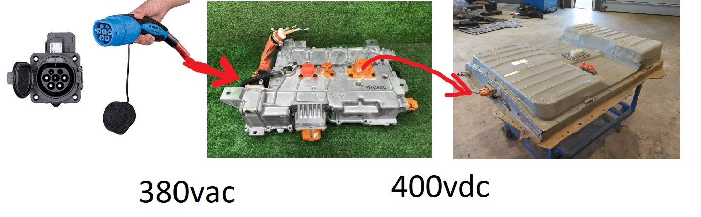

Re: Leaf Gen 1 Inverter Board
Hi all!
tell me if it is possible to use the factory inverter from nissan leaf ze0 in a somewhat non-standard mode for it, namely, as shown in the diagram:
that is, instead of the EM61 motor, connect an alternating 3-phase current from a socket or from a type 2 charging station, somehow start the inverter and make it work in recovery mode, thereby charging the machine’s battery.
I'm not very good at development and programming, and therefore I would like some ready-made solution, or at least some instructions on how to run it and get the result. and in general, is it possible in principle? It seems like an investor does this every day.
- Posts: 990
- Location: Northern Ireland
- Has thanked: 370 times
- Been thanked: 222 times
Isn't the item in the photo a high voltage junction box and dc to dc converter?LeonMN wrote: ↑Fri May 26, 2023 1:44 pm Hi all!
it might be, i could take a wrong picture
anyway the question is the same - is it possible to start the inverter and make it work in recovery mode, thereby charging the nissan leaf battery ?
