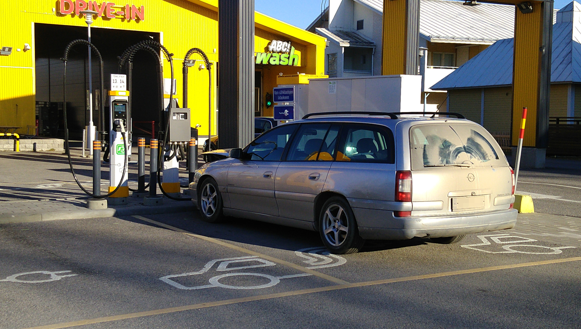

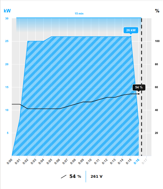

Here's a list of the chargers tested on this trip, if I'm able to remember all of them, in order. I added an identifying letter in () to the chargers just to remind myself. I don't want to name them publicly.
- 50kW Tritium (o): ok
- 50kW Tritium (k): ok
- 50kW Tritium (c): Didn't fully work but it was due to internal problems in the car
- 50kW ABB (h): ok
- 50kW Tritium (r): ok
- 20kW(?) Kempower: Charging stopped after a random duration between 0 to 10 minutes during numerous attempts. I got the charger logs and they stated the charge permission line from the car deactivated momentarily. The car's logs didn't show that this should have happened.
- 50kW Efacec (kh): Detected the car but showed an error code on screen that could be looked up to mean the charger's internal fuse was blown
- 150kW Kempower (kh): Detected the car but said on screen that the battery was incompatible (when testing using chademo version 1.0). When testing using chademo version 0.9 the charger said the car was incompatible.
- 50kW Circontrol (kh): ok
- 50kW Tritium (kk): ok
- 50kW Tritium (n): ok
- 50kW Efacec/Garo (h): ok
- 50kW ABB (jp): Screen stated charger was out of order
- 75kW Tritium (t): Tested two chargers, neither detected the vehicle at all. A Tesla Model Y was charging via CCS on one of them.
- (There was a charging attempt on some super random charger here that I've never seen and won't ever see again. It didn't work.)
- 50kW Tritium (m): ok
- 50kW Tritium (j): Didn't detect the car at all. CCS seemed to be working. Looks like there are very bad reviews about the Chademo here so it might very well be broken.
- 200kW Delta (j): Didn't detect the car at all. CCS was definitely working. Tested 2 chargers.
- 50kW Circontrol (j): ok
- 50kW ABB (p): ok
This makes it 11 succesful charging sessions, or 172km per succesful charging session. 21 charging attempts total.

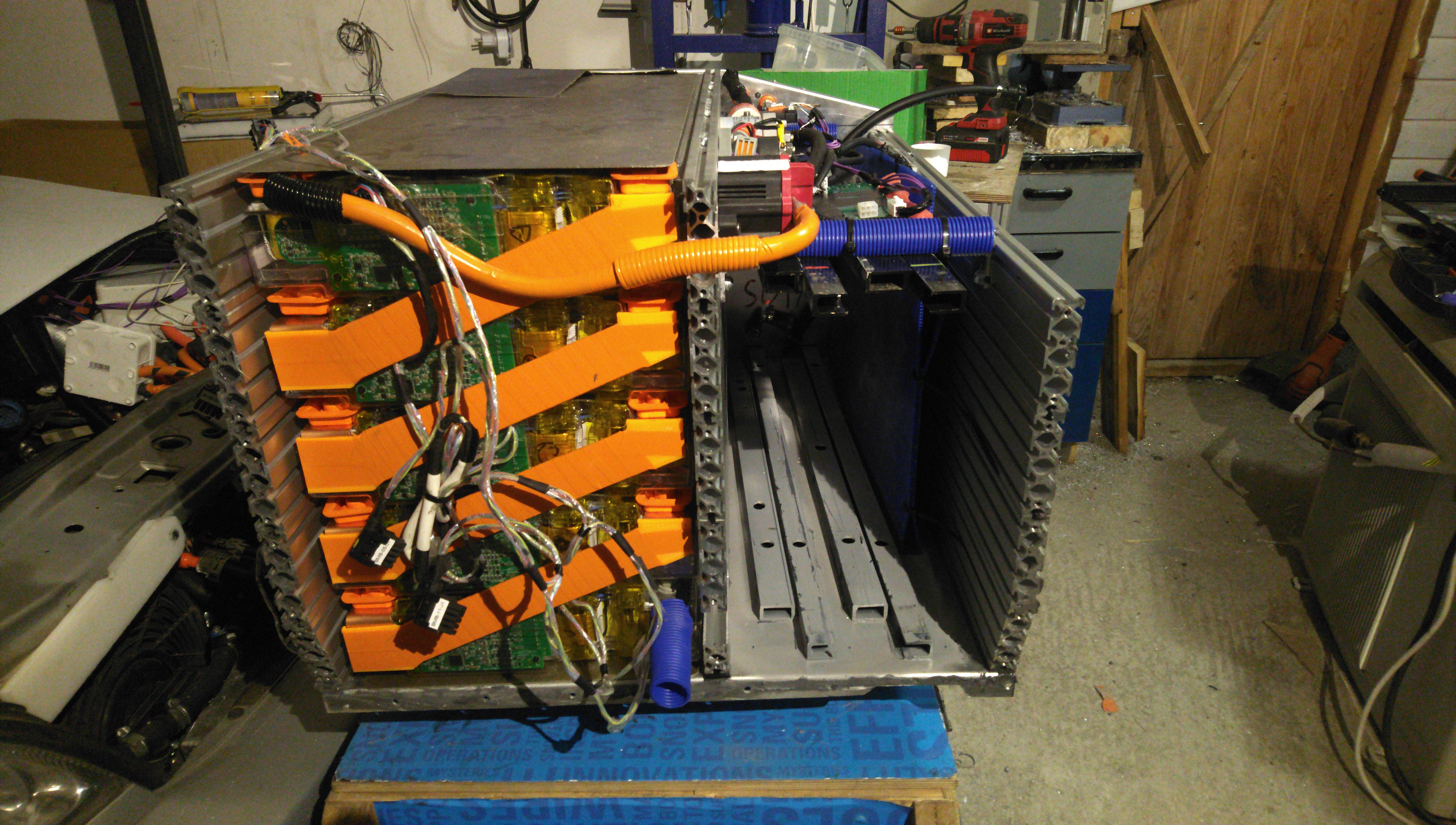

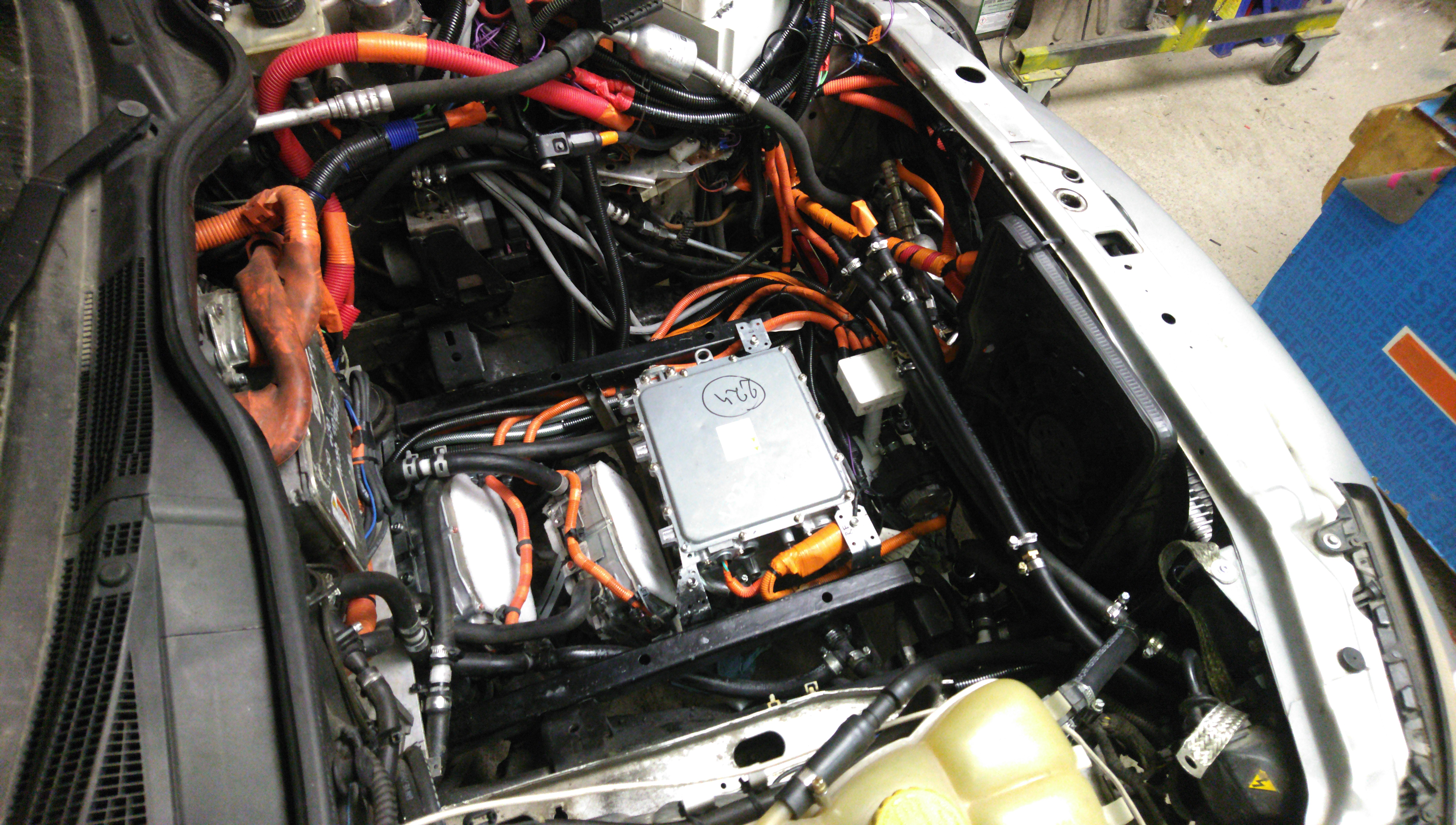

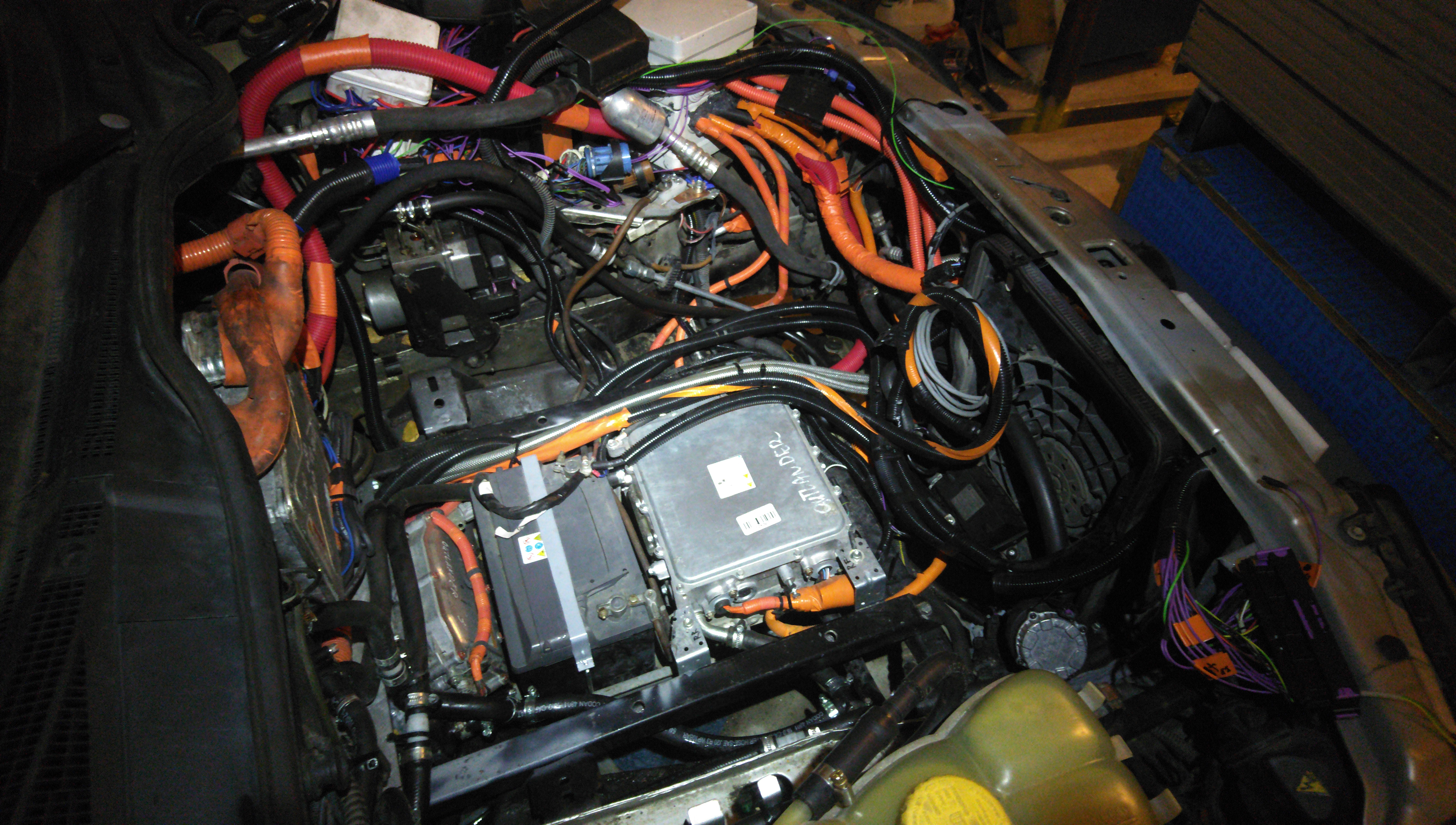

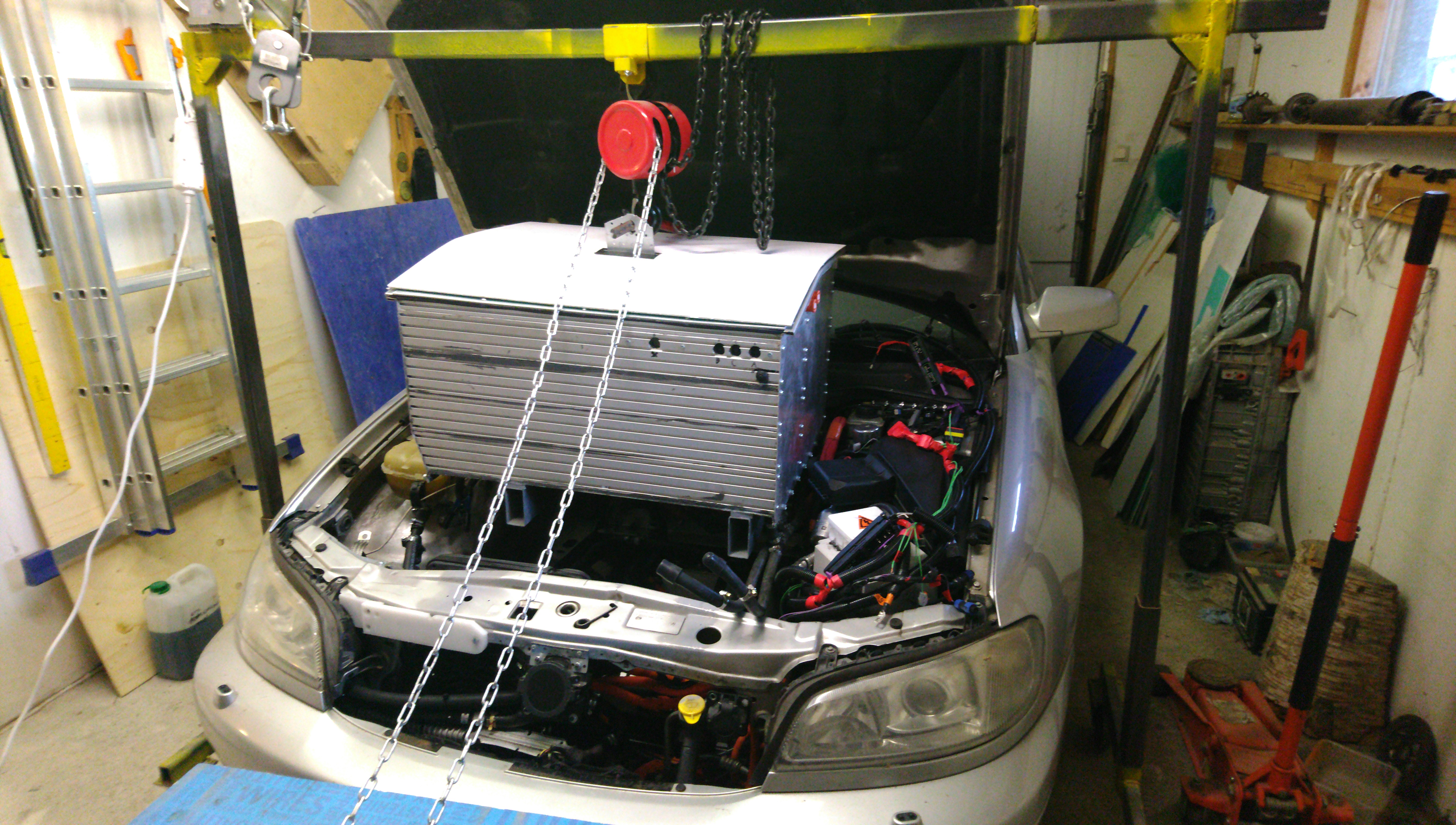

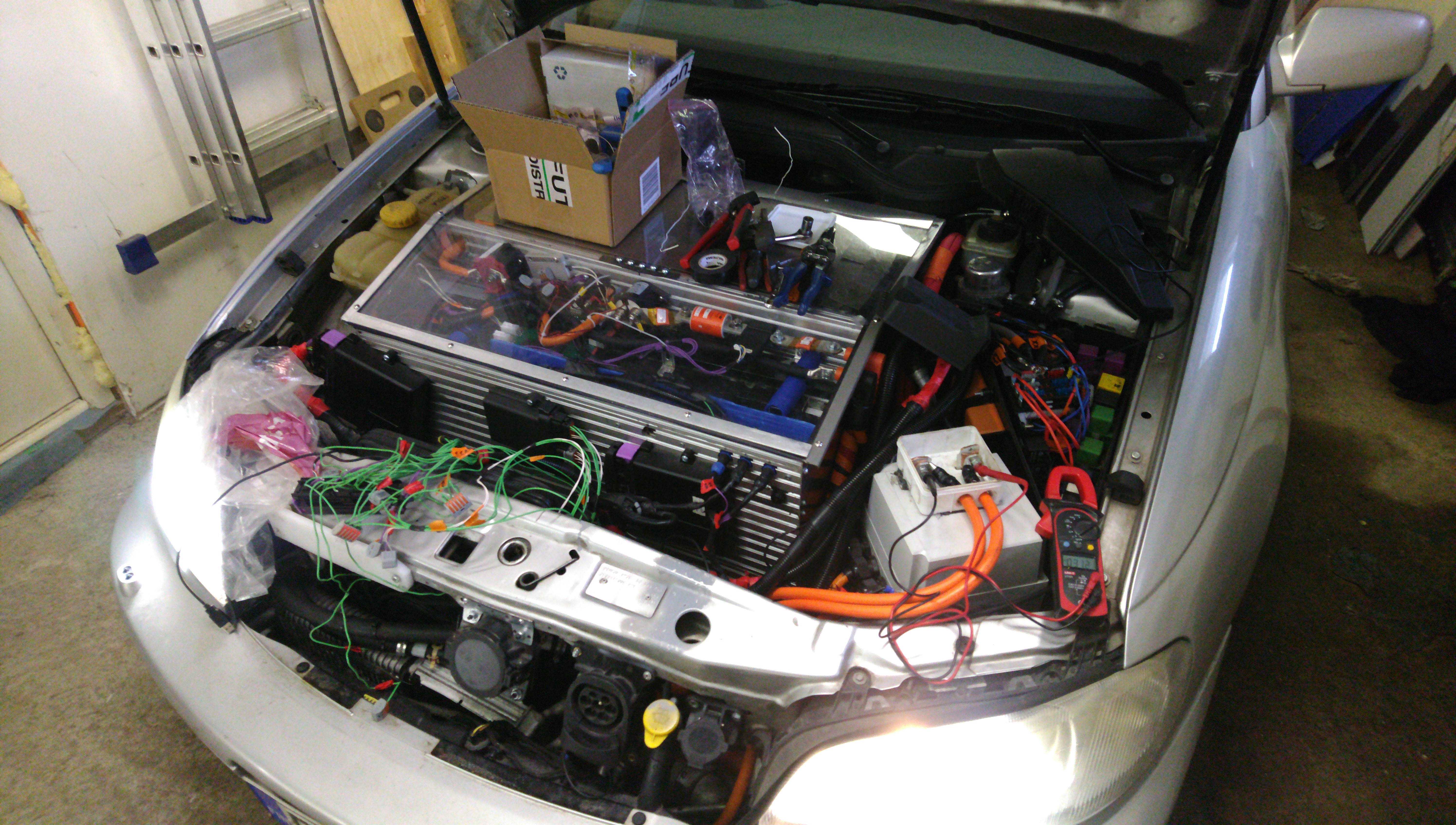

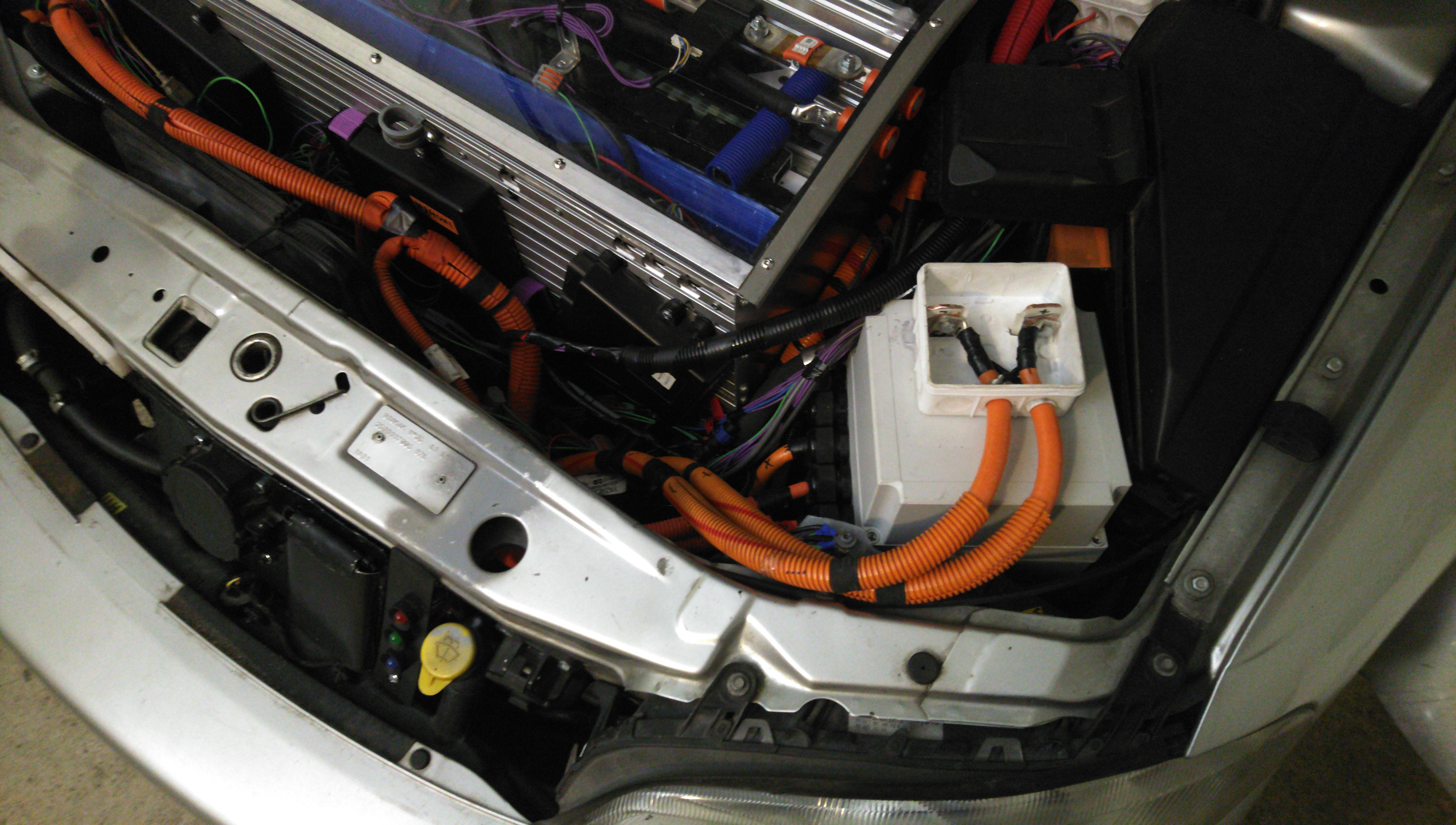

I'm now in the process of finalizing the million details needed to shorten the front battery box by 2 modules, to get the front axle mass to the legal range for this car, so that I can get it inspected as an EV. I have also moved the BMS PCB inside the battery box. I was able to shorten it only by about 78mm due to having to leave space for safe access to the battery terminals and also leave room for the BMS, but that will already make a big difference at the front - I should have enough room for some sort of A/C system when I want to look into that later.
While I'm here, I'll also have to replace the battery loop pump with a much more powerful Bosch PCE unit to get rid of problems bleeding the system, and I'll need to add a battery coolant heater and a bypass valve to the battery radiator. And of course implement control to all these. It's soon going to be only freezing temperatures for about 4 months so the car would be inoperable without battery heating.
My summer vacation is long gone, so progress is slow.
I did the first version of the next version of the rear battery box about a month ago. I'll post photos of it once I revisit it when adding the remaining 2 modules in the rear, that I had to remove from the front.

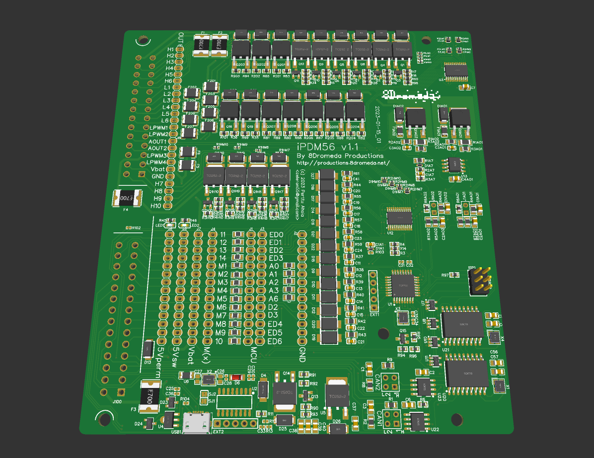

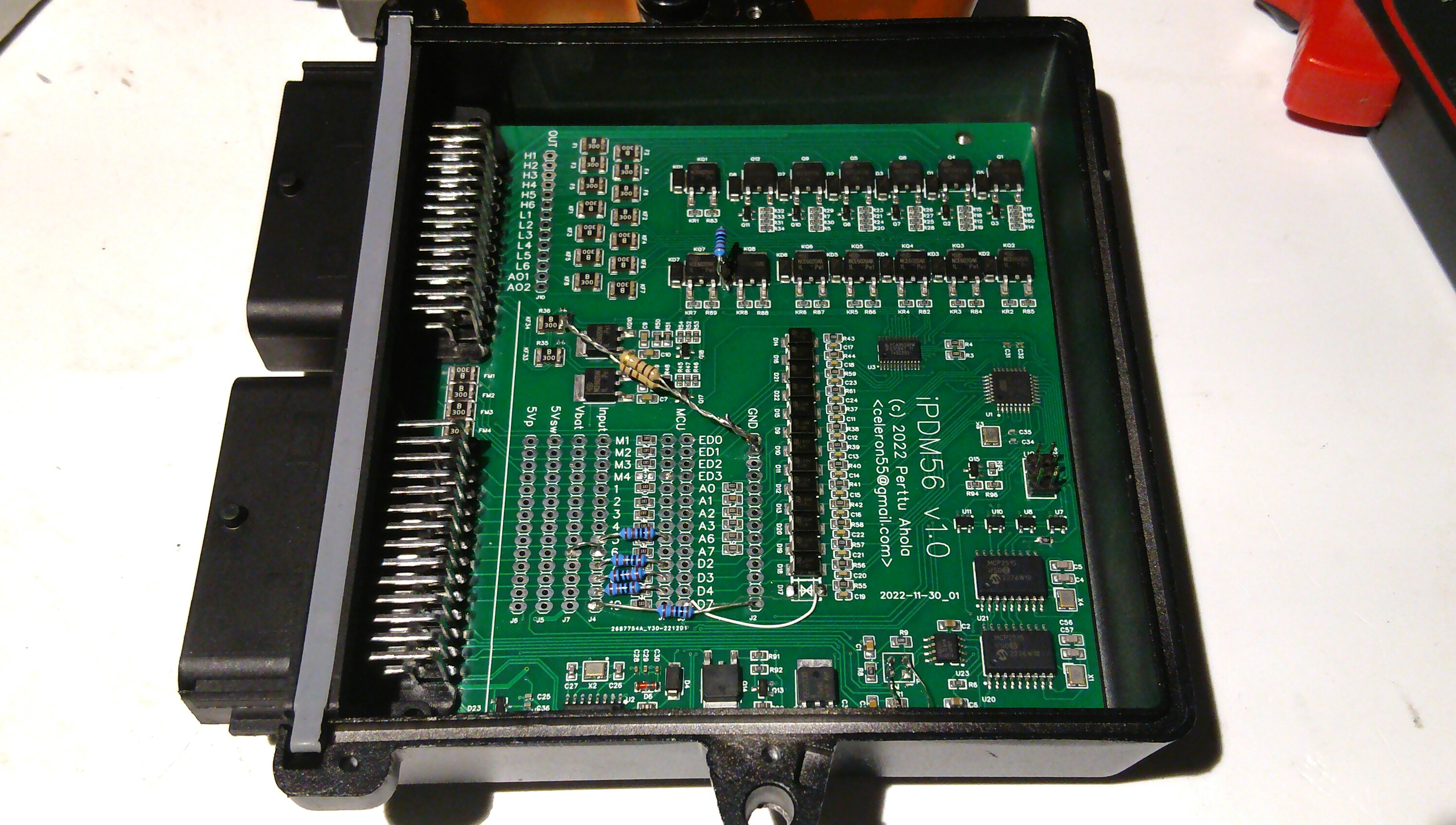

I ended up with lots of needs for extra inputs and outputs in addition to the GS450H VCU or the ZombieVerter (to which I'll swap at some point):
- Shifter LEDs are controlled by 4 lines
- Cruise control inputs
- Driver door needs to be monitored and warning alarm to be sounded in certain situation according to Finnish legislation for EV conversions
- Vacuum pump control based on sensor
- Cabin heating pump
- Radiator cooling fan
- System needs to be powered up in situations other than ignition key operation (charging by OBC or fast charging; remote operated heating in the future, maybe 12V top-up if it gets low)
- I wanted to have extra logic for controlling the power steering pump and the vacuum pump so that when the car is charging they don't turn on even if ignition is on
- Battery heater PWM control
- Battery coolant loop pump power (maybe PWM in the future)
- Battery cooling/heating solenoid valve
- OBC 12V feed needs to be switched separately from the rest of the system for cable plug-in monitoring
- Fuel gauge needs to be driven
- I want to drive some other gauges in the future too
- I'd like to do CHAdeMO comms with this in the future too. Generally I need a piece of hardware where I can reliably run my own embedded software and have all the protections and outputs that I need.
- Other uses in the future. A project like this is never finished and always needs spare i/o for extensions.
So, I came up with the design for essentially what's a slightly weirdly designed VCU but which I dubbed the iPDM56, an intelligent power distribution module in the chinese 56-pin enclosure.
I'm seeing if I can make this into a product for anyone to use.
It is characterized by a large number of power outputs, both low and high side, and by the input/logic side solderable jumper/pull-up/pull-down/filter matrix which allows integrating it into one-off systems in some ways that are not generally possible with common VCU style controllers. It has a relatively wimpy MCU.
It is meant to act as an I/O extender module alongside another VCU, but you could wire it up to a throttle pedal and a CAN controlled inverter if you don't need much code or want to specifically minimize the amount of code and have control and knowledge over all of your code (like me).
It is programmed as an Arduino Uno, by uploading your sketch to it. There is no other programming interface, no UIs, nothing. It runs the code you upload to it, and that's it.
The USB port is brought to the waterproof 56-pin connector so that continuous development of the code is possible while it is installed in a vehicle, without the need for Wi-Fi, bluetooth, laptop CAN adapters or anything fancy like that. You just plug the thing into your laptop via USB, just like an Arduino Uno. In case you want to just program it once, there's a USB Micro-B connector on board.
Included with the documentation, there is an open source software template which includes a utility library, specifically designed for the hardware, which I personally also use. It makes programming common functions a breeze, given that you have some Arduino programming experience.
The hardware is well documented, with well laid out schematics, board layouts and easy to read connector pinouts, but I will keep the hardware production files to myself for now, and sell the boards myself. I am not planning to get rich, but I would like to stay strongly in the development loop and be able to maintain the quality of the hardware. Once I get bored of that, I'll publish the HW project files. No promises, but you've seen me publish open source before.
I want this to cost 100€ inc. VAT and shipping, without enclosure, or 150€ for 2, but I'll still have to run the numbers. The price will include absolutely no support of any kind, and you shouldn't buy it unless you're comfortable developing code for Arduinos. By default, it does nothing, there is no software, and also the default software template does nothing unless you add your own code to it.
Github link: https://github.com/celeron55/ipdm56
I also made this VCU comparison table in the Wiki to learn about the differences between VCUs. It only has a couple in the table and even those are missing some data for now, but I think it's already interesting. There's also a to-do list for adding other ones: https://openinverter.org/wiki/VCU_Comparison
Photo of v1.0 with some jumpers added for a specific use case. Note that the white wire is replacing a trace I burned up by accidentally trying to destroy the MCU by feeding 12V not to the external connector, but to the internal jumper strip (even then the protection kind of worked, yay for those absolutely massive TVSes!) and the output pull-down resistor has a better GND location in v1.1:
Render of v1.1, which I'm currently having a batch made of:

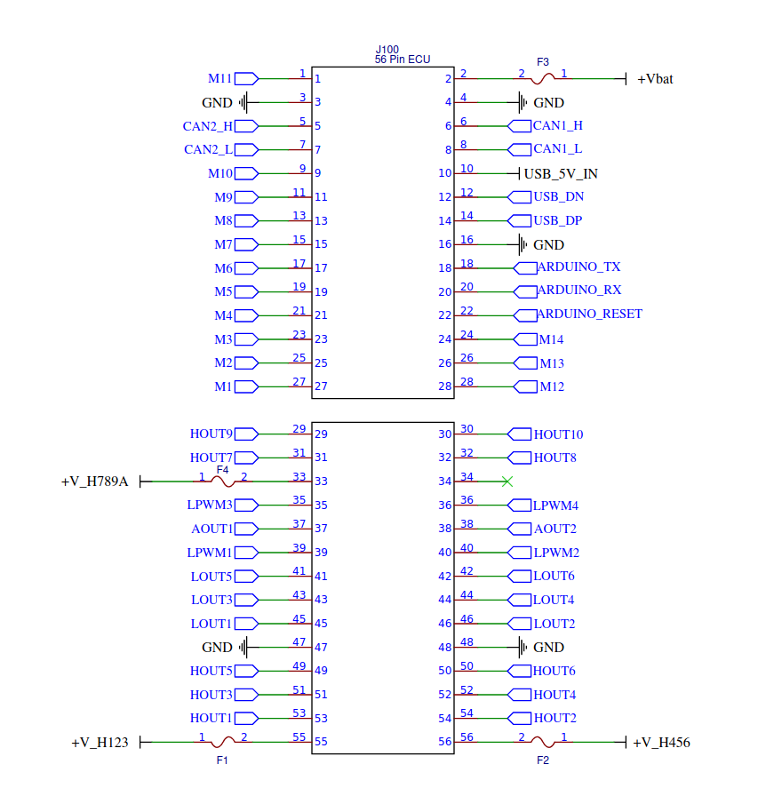

The v1.1 connector pinout:

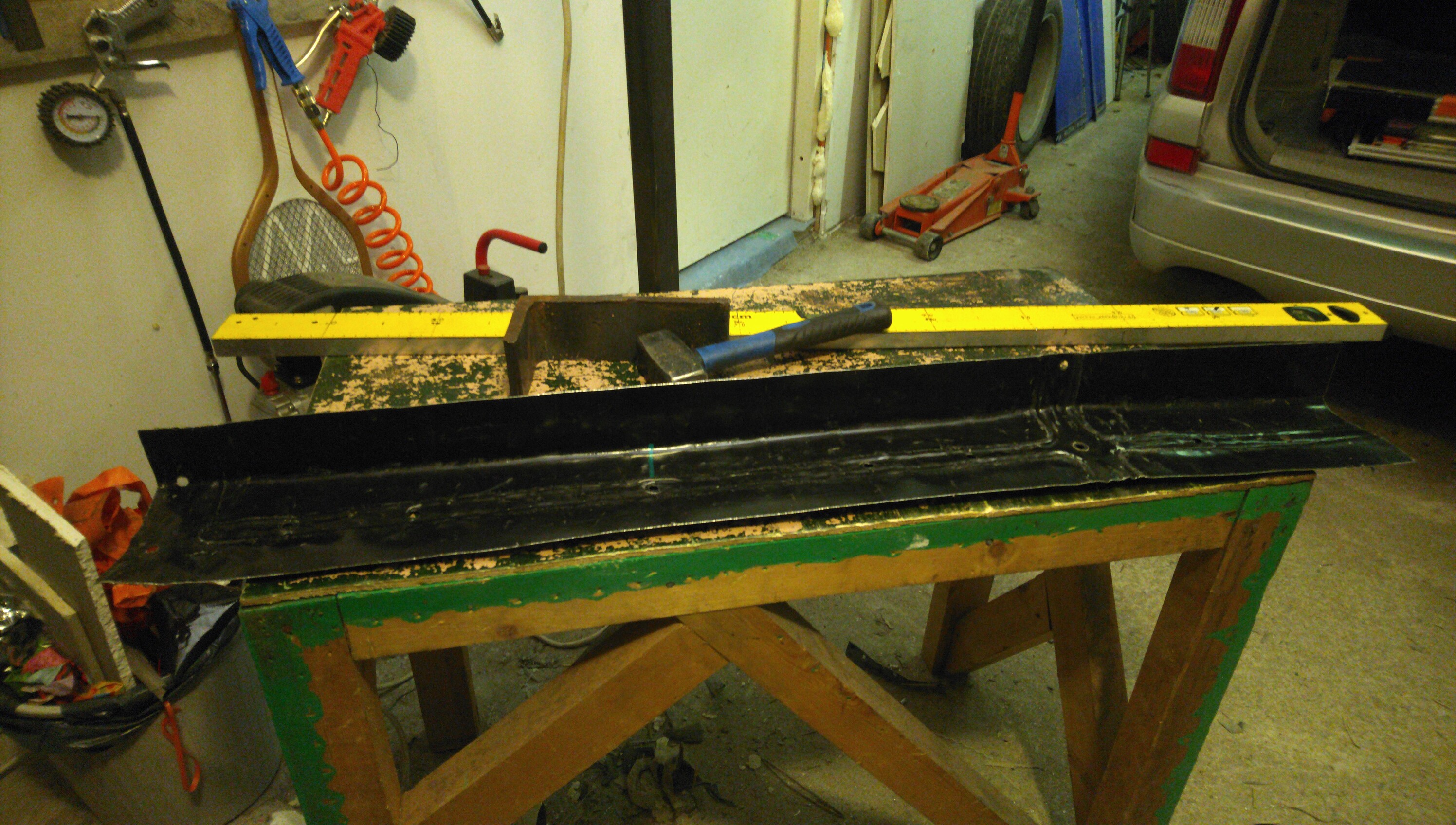

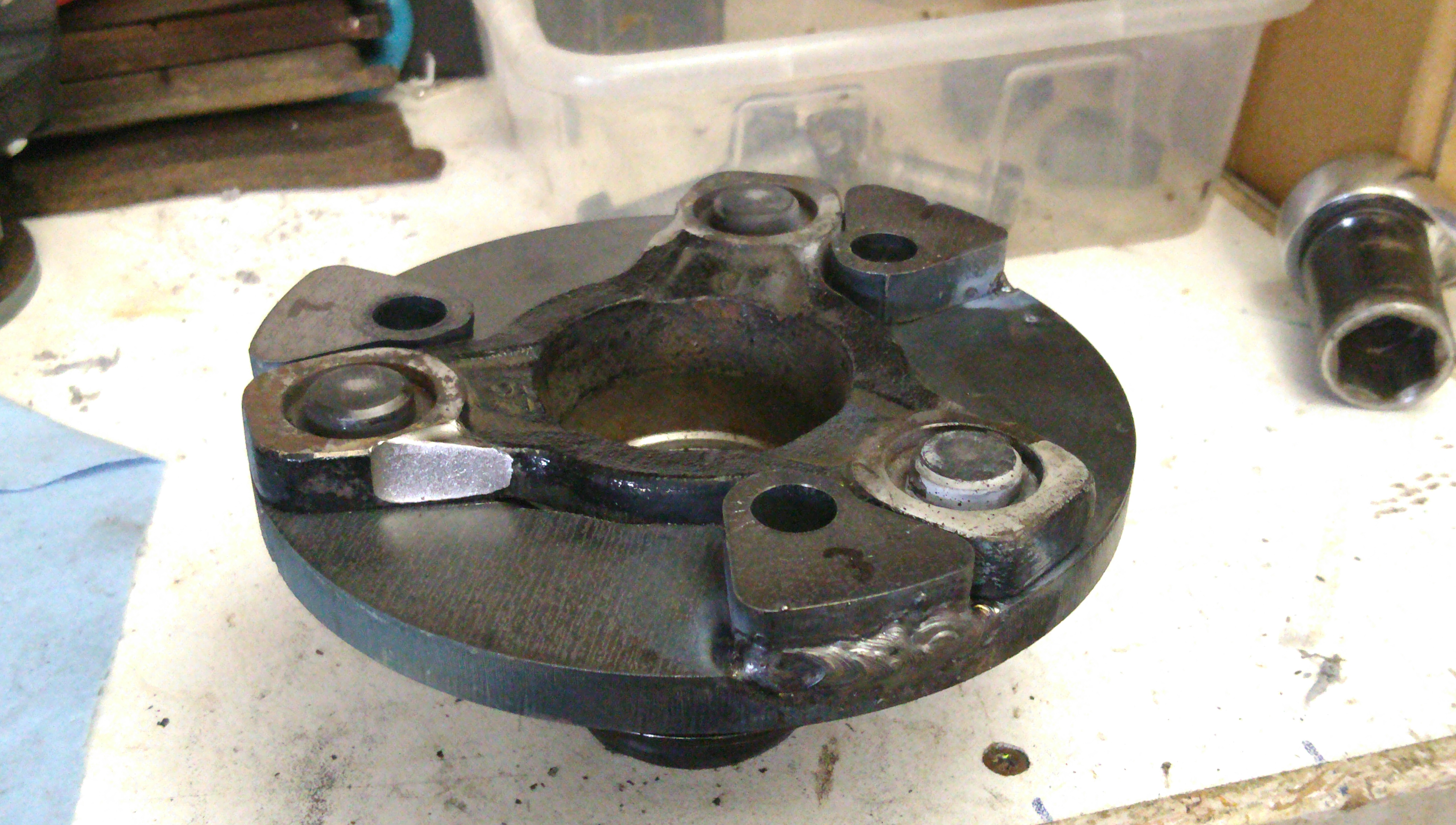

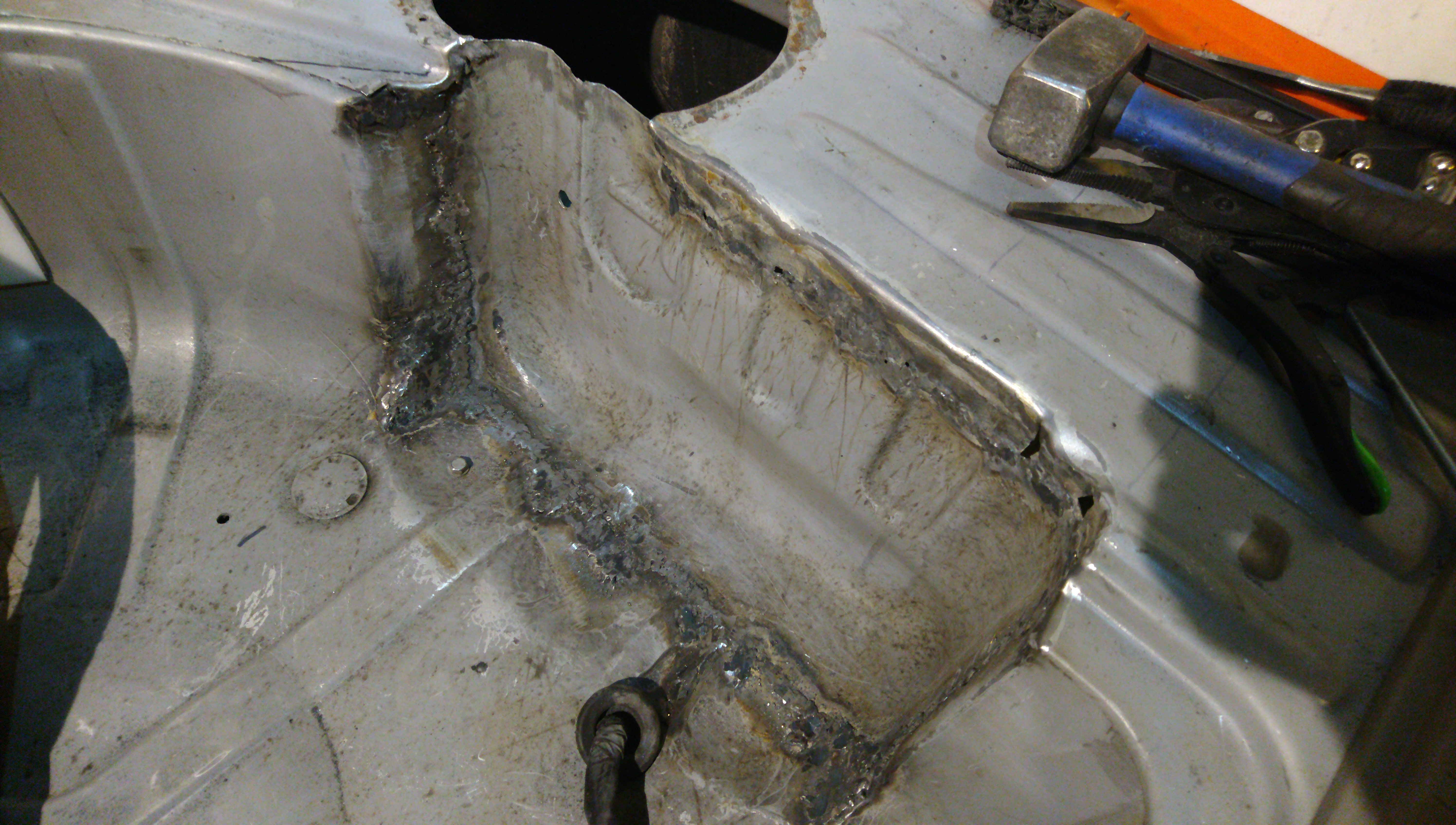

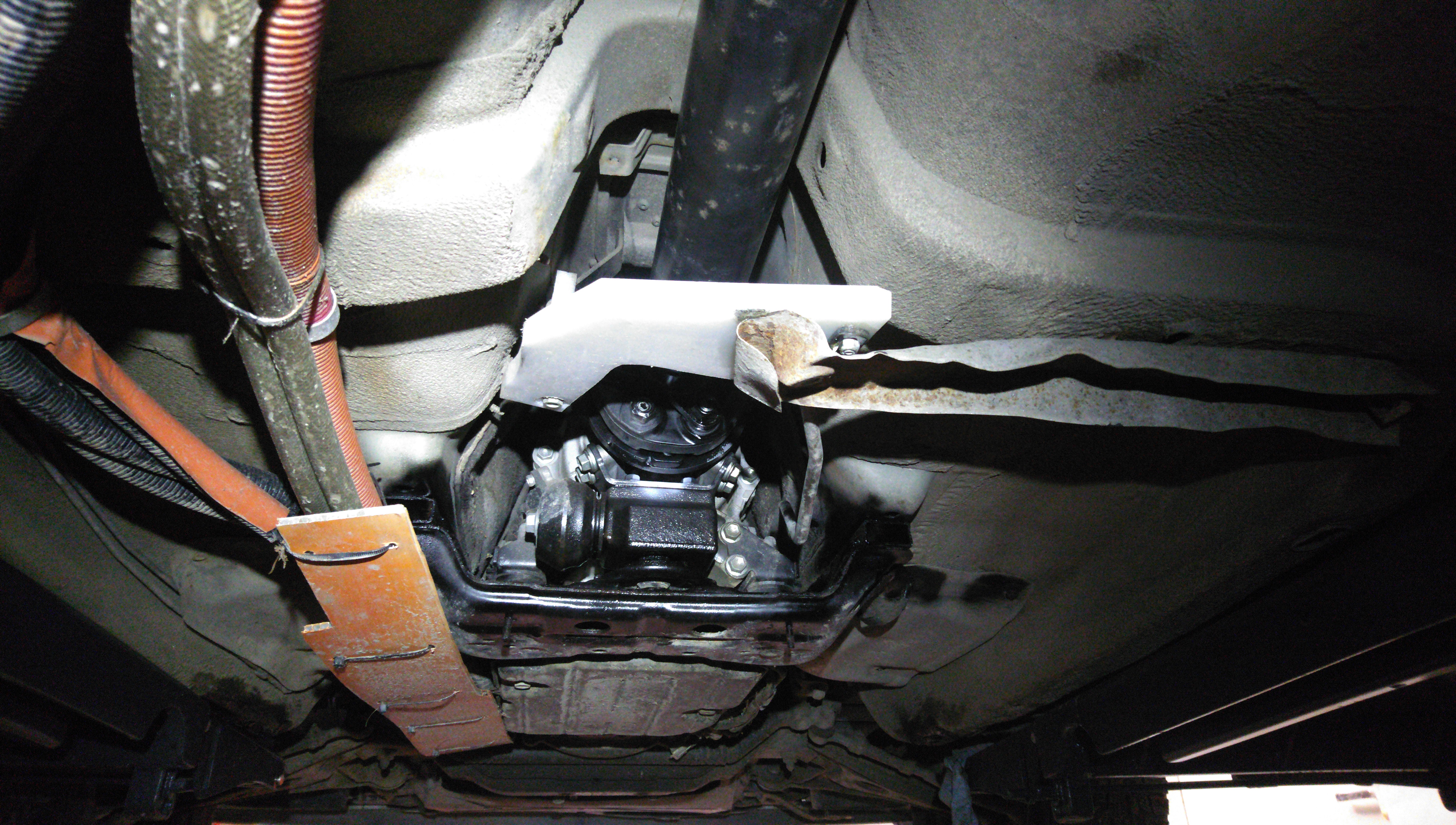

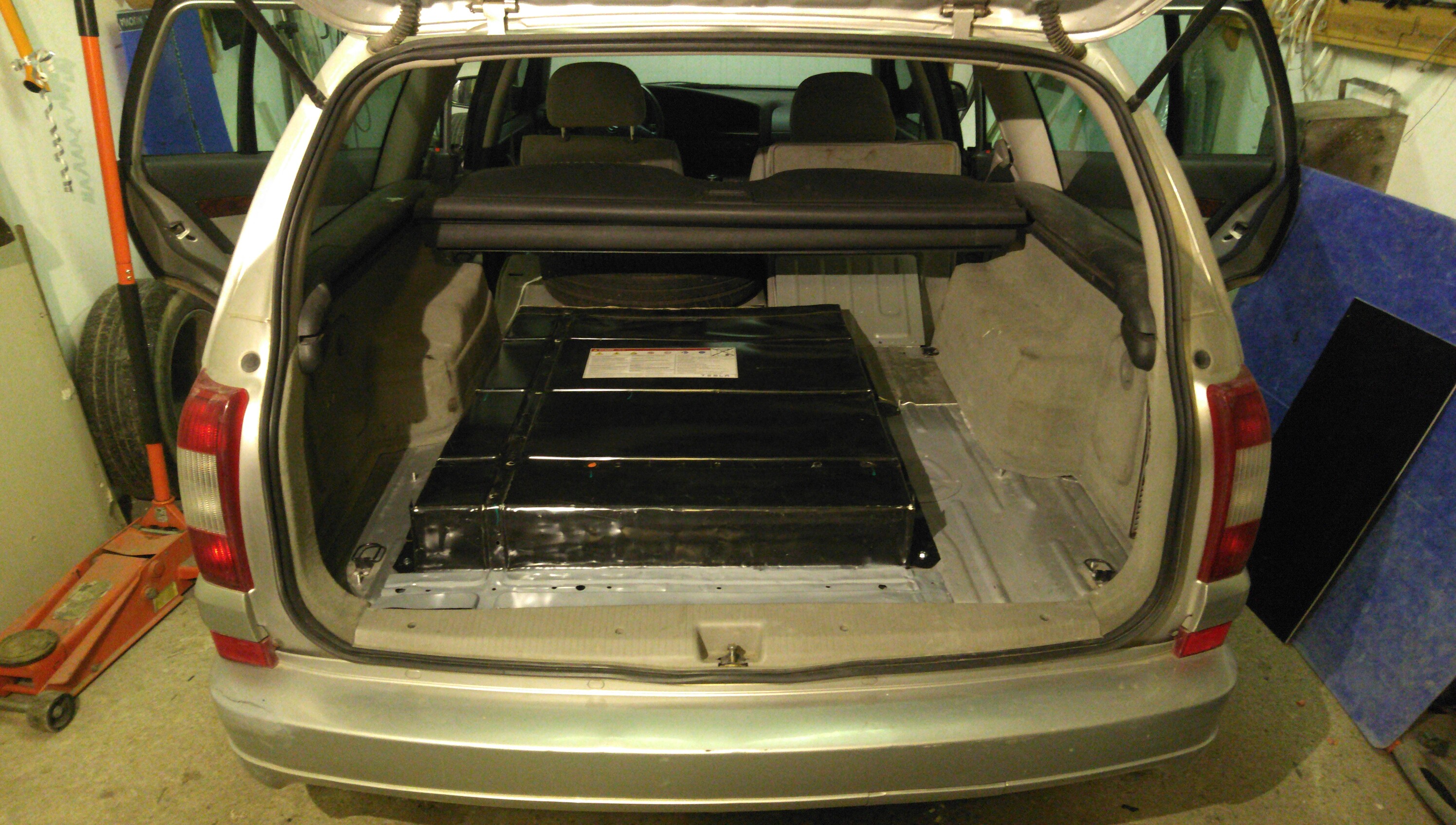

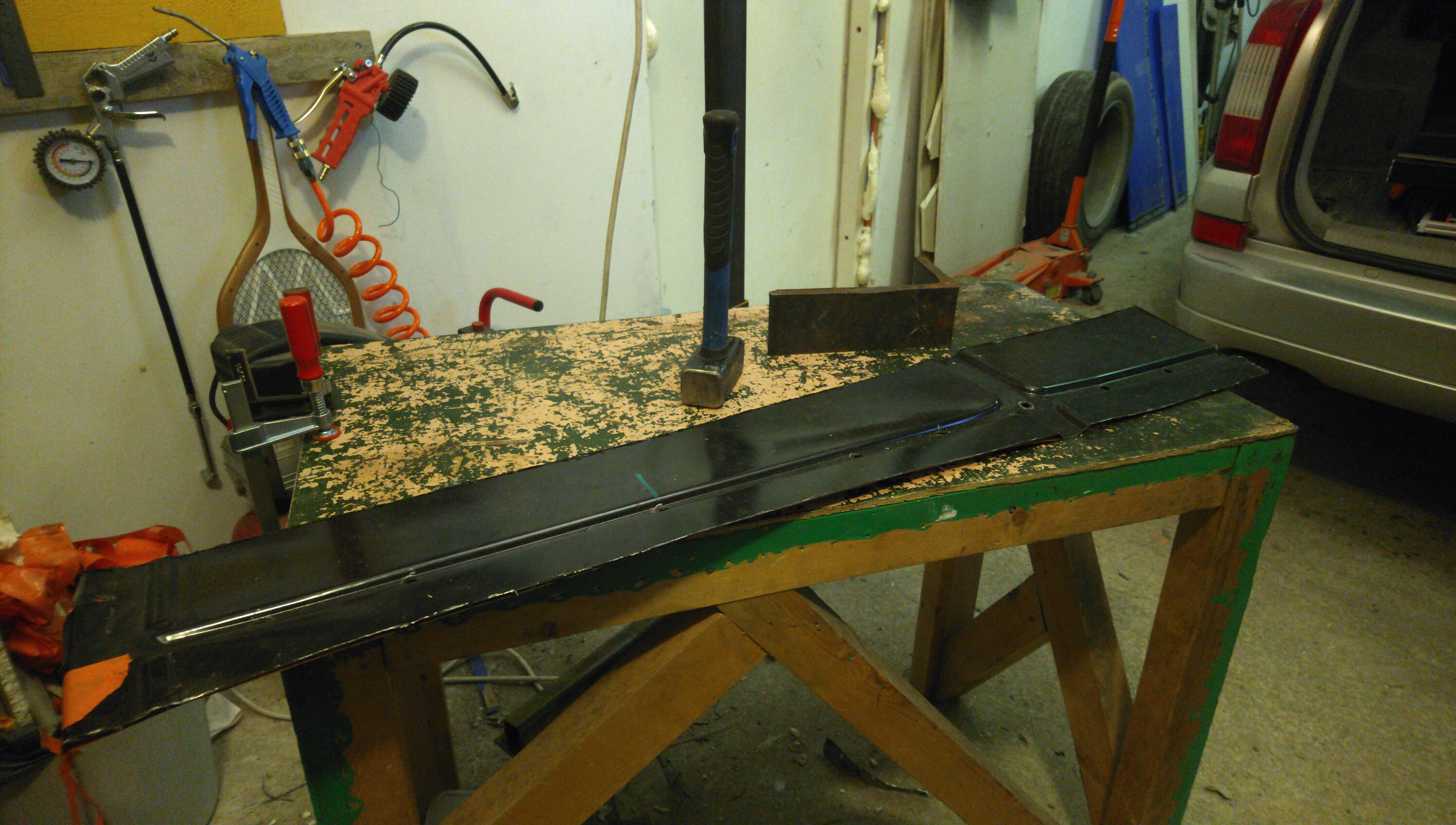

Getting some welding done at the rear. That's all that I need extra in the spare wheel well in order to fit the Tesla modules with electricals and cooling. Still a lot of work with my cheap welder.
EDIT: After looking at these photos of my work for a while, I decided to order a cheap inverter flux core MIG welder. Spending so much time to get such a result using the rectifier-less AC welder is not a good use of my time, given I could find an inverter version for 126€ including tax and shipping.
EDIT: Here's an Aliexpress affiliate link. I want to see how these work. Keep in mind I just ordered it for myself, I have no idea whether it's actually any good
: https://s.click.aliexpress.com/e/_DEVCpA7

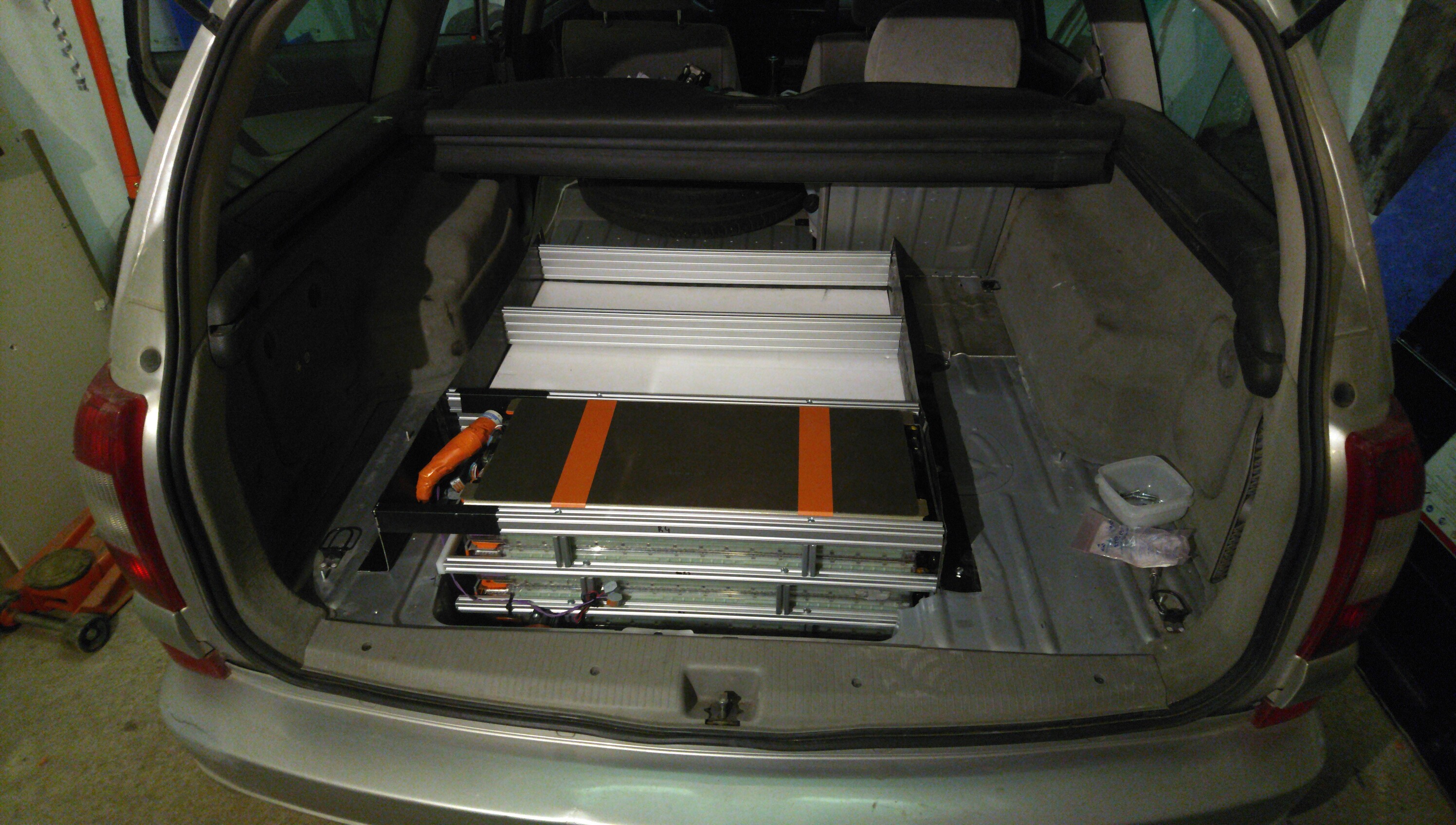

Mounting the rear batteries using a mix of expensive new cut-to-spec aluminium extrusions and scrap steel from a Tesla battery pack. Without proper sheet metal tools, of course.
Let's say it has lots of character?
I like it. Especially the bonus sticker.
This design should be able to take quite some load on top, even point loads, after I add a sheet of plastic between the modules and the steel cover. That's fairly critical given the pack is literally the cargo floor.
Ruudi S
- Posts: 105
- Joined: Sun Apr 12, 2020 2:02 pm
- Location: EU Estonia
- Has thanked: 67 times
- Been thanked: 32 times
Re: Opel Omega B2 + GS450H
Nicely built this rear battery pack and real repurpose/reuse way to do it. What holds these battery modules in place can they be fixed somehow with bolts or something?
- celeron55
- Posts: 805
- Has thanked: 39 times
- Been thanked: 136 times
They have side rails that slot into the extrusions with the help of some 3D printed parts to eat up the slop.

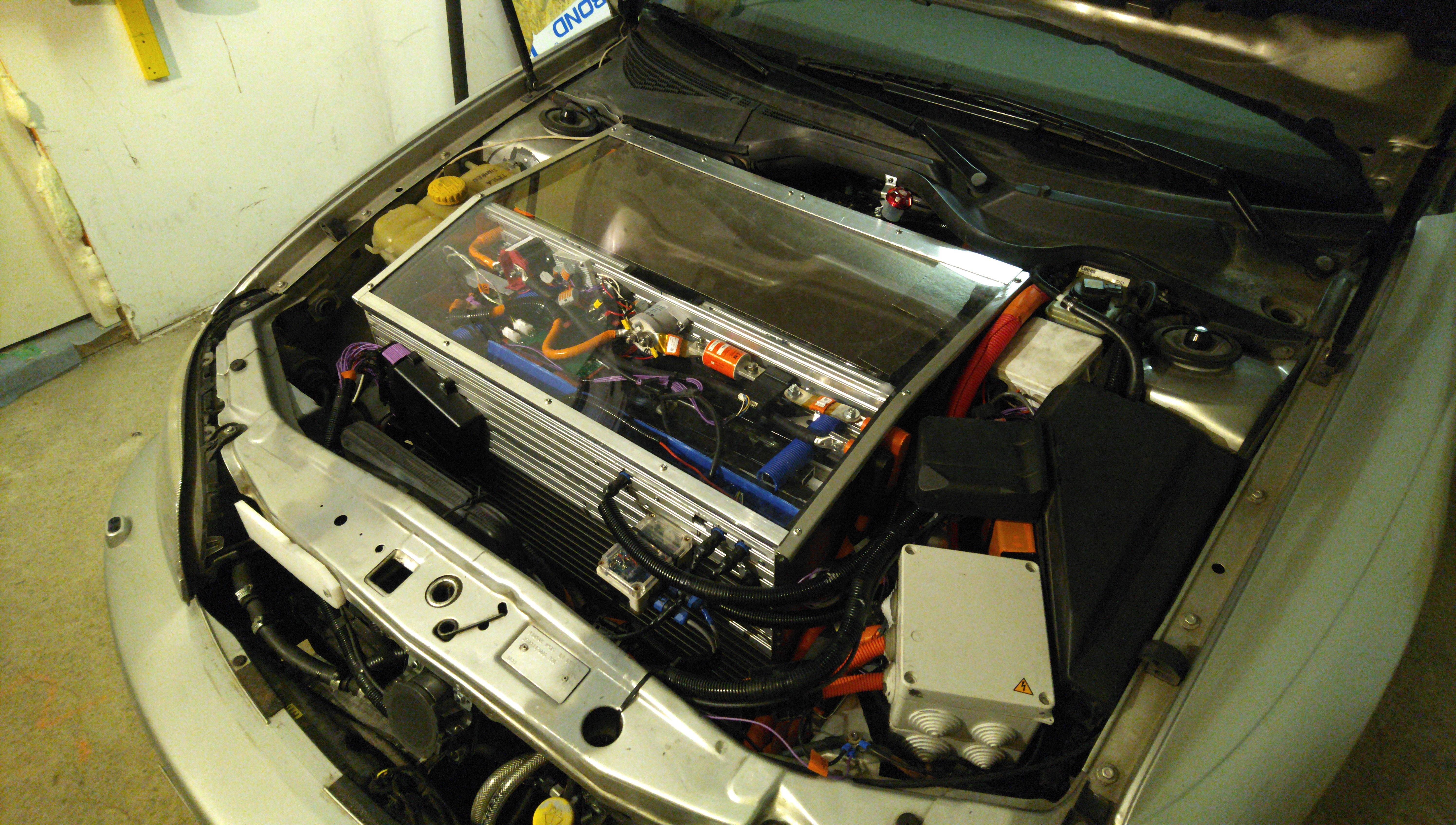

The front starts to look ok from the top. I think visually this should pass.
Now that I think of it, some rule probably says I need to add a ground strap from the battery box to chassis... well, that's not a big deal.
Guess who left all the annoying work beneath the car at the end of the to-do list? Here are some items:
- Balance the propshaft adapter
- Appropriately upport the shifter linkage adapter thing
- Support, protect and tidy up the under-floor cabling
- Make a proper mount for the power steering pump
- Attach the plastic wheel well linings and any other underbody plastic I've removed, using fasteners I've probably already lost
- Adjust parking brake
After this I'll have to get the windshield replaced and document all the changes I've made.
After I've gotten this inspected, I'll have to disassemble the front again in order to redesign the cabin heating coolant system and think about relocating stuff (12V battey and/or OBC) to the rear in order to be able to fit the A/C compressor later this spring. But for now, this is all about getting the papers signed.

I just did the world's first open source CCS charging session using a real car, into a real battery. No LIM or anything like that was used. Only pyPLC plus a bit of custom hardware integration to make it control the contactors and talk to the BMS. (The HomePlug modem firmware is closed source though. Who's taking the challenge?)
Check the details (and logs, if you want proof) at viewtopic.php?p=56188#p56188
- celeron55
- Posts: 805
Re: Opel Omega B2 + GS450H (the "EVOmega")
A spring CCS photo with the summer wheels and new tyres. My tyre choice was a mid priced fuel economy focused one: Hankook Ventus Prime 3. I like them so far. Not sponsored.

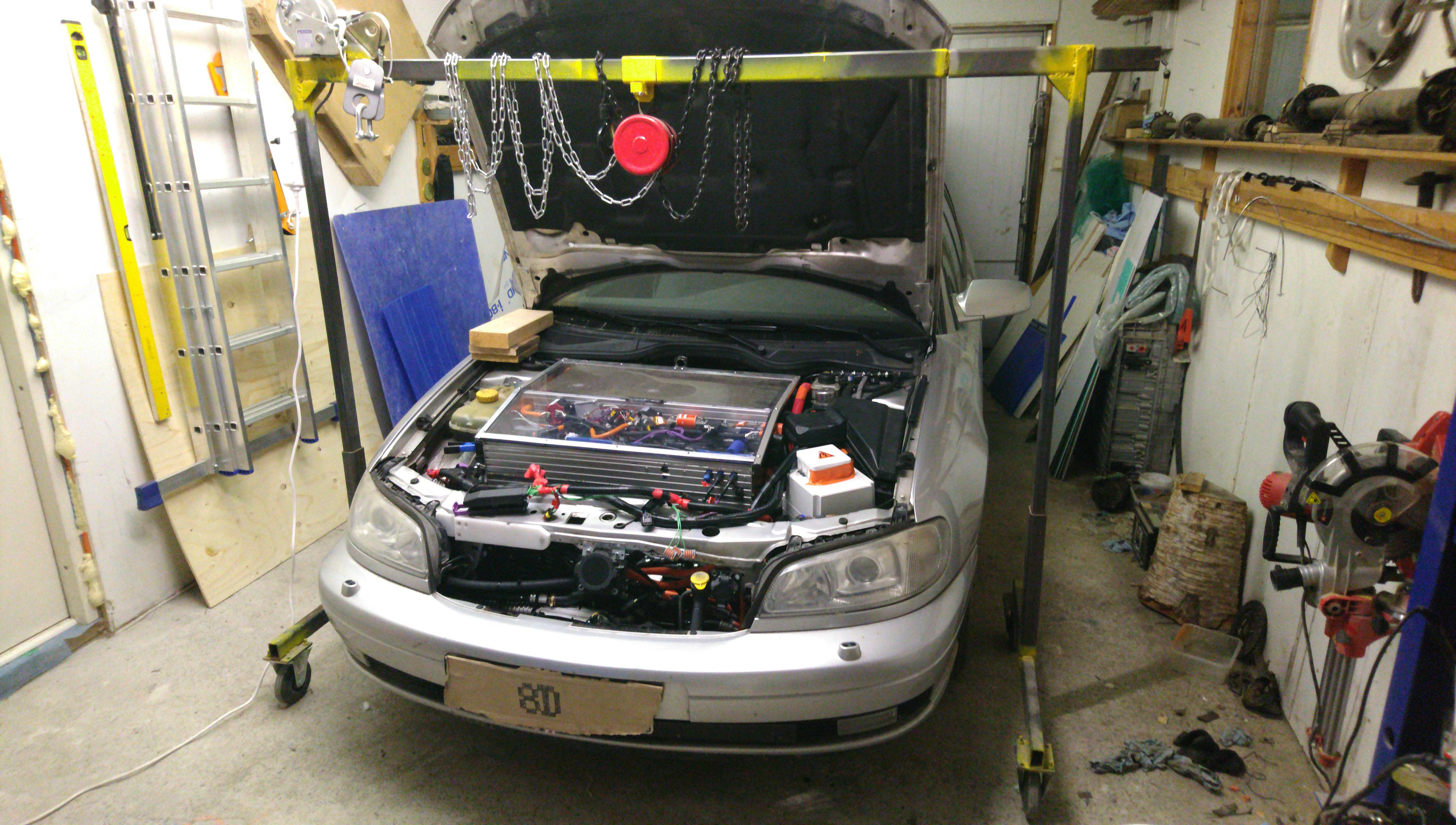

Re: [DRIVING] Opel Omega B2 + GS450H (the "EVOmega")
Got this thing put back together.
I did:
- Removed broken front-mounted 12V battery
- Removed broken OBC and heater
- Swapped the locations of the vacuum pump and the additional 12V fuse and relay blocks
- Installed two new (second hand) heaters, one in the place where the 12V battery was. The winters here are brutal, one wasn't nearly enough last winter.
- Installed new (second hand) OBC
- A massive amount of tidying everything up. I cannot count the amount of cables and hoses I shortened, lengthened and moved around.
- Continued the effort of trying to make space for the A/C condenser. It has a chance of fitting in now. Now, the entire system would have to be completely cleaned up from the old refrigerant. And, I do not have room for the compressor. To make that room, the OBC has to be moved to the rear of the car, including its cooling system. A royal pain, but theoretically doable.
- Found at least one rubbing hose that would have left me stranded in a few months. Added a protective sleeve over it.
My to-do list is still hundreds (or thousands?) of lines, but I think this might do until spring. Well one thing I still have to do:
- Mount the two iPDM56s, one for general 12V distribution and control and the other for Chademo. I'm thinking of making some sort of snap-fit 3D printed mounts on the front side of the battery. I already grew tired of alu profile T nuts and screws. Those are annoying to access in their mounting location.
I need to work on the software a bit though:
- I want to give it a chance of surviving a bad contactor if that happens in the future, without blowing up expensive parts
- I'll need to finish development for winter usage. I hope the current battery heater is enough with some smart enough software. If not, I already have the next hardware iterations in mind.
These photos aren't great but here's a bad attempt at a before and after shot (as you can see I installed some "new" lighting at the garage (well, not even new-to-me... just some fluorescent tubes headed for recycling)):
Then hoisted the insanely big box in again:
Everything is now mounted in place and most of the system is filled with coolant, but I haven't taken a test drive yet. It does power on, torque is available at the motor. The OBC, DCDC, heater, vacuum pump and power steering appear to work.

- celeron55
- Posts: 805

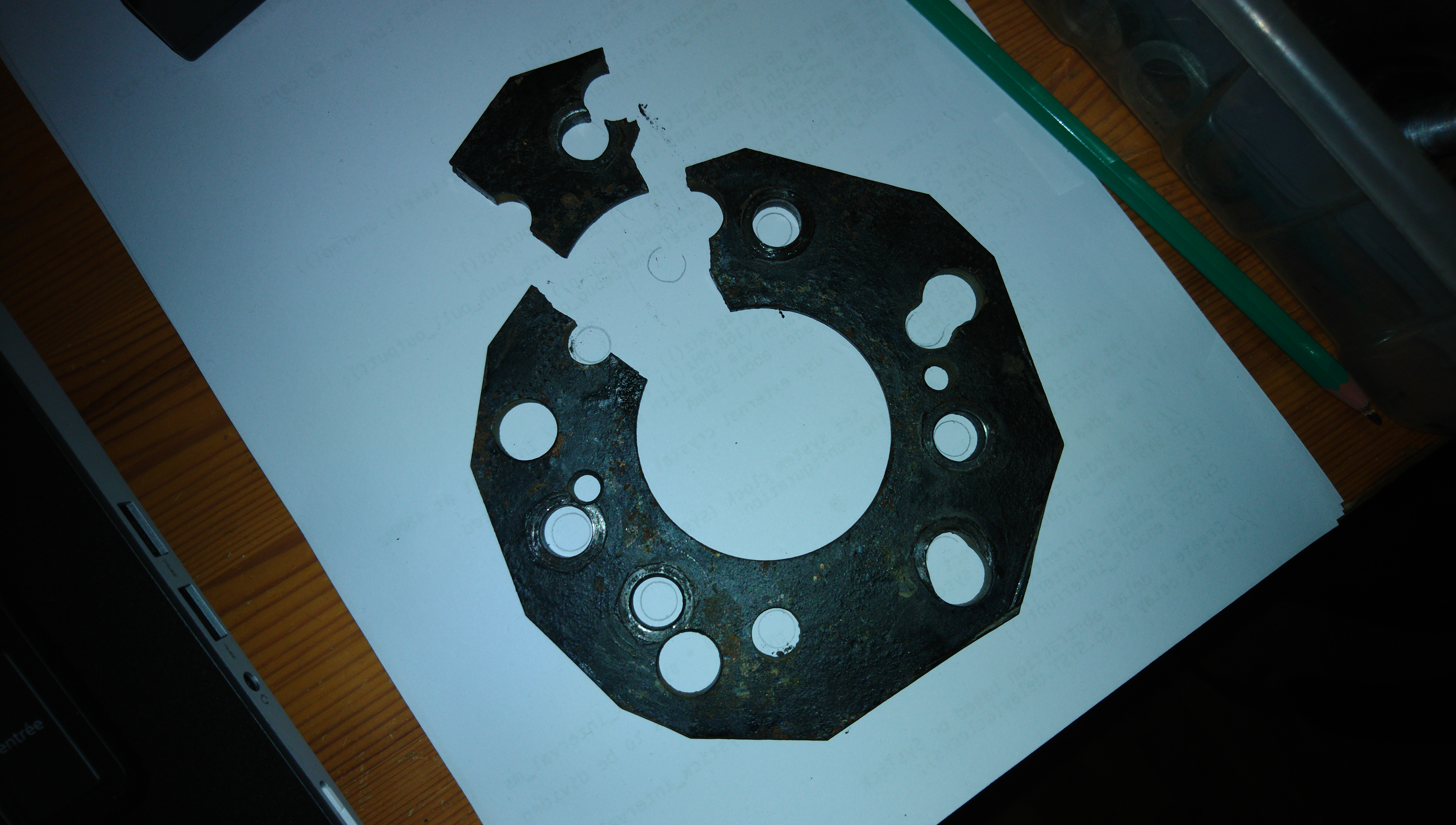

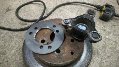

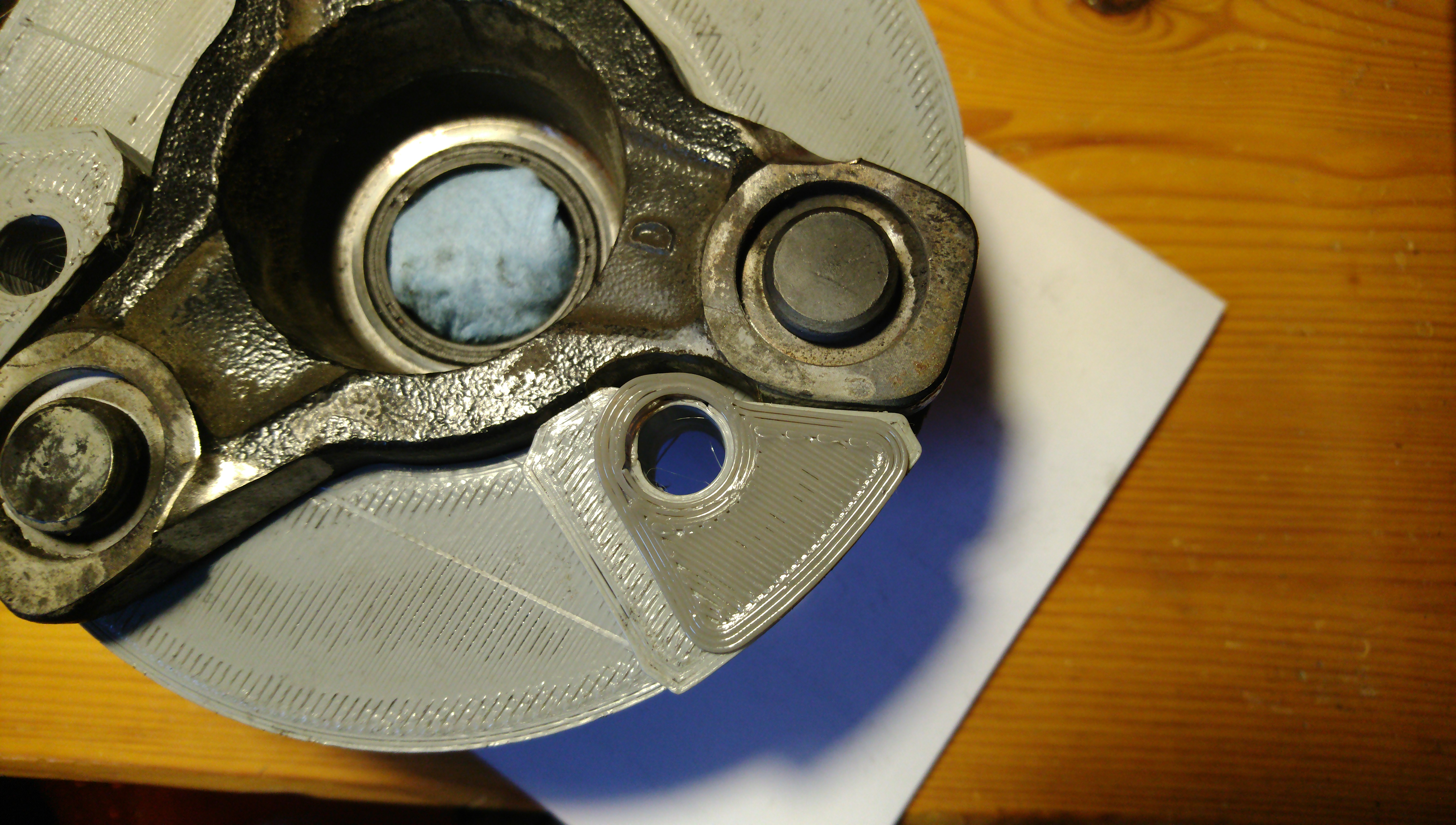

The original propshaft flange adapter cracked and started to vibrate, so I had to make a new one.
This one is pretty simple, it's laser cut from 10mm steel plate, then ground and welded a bit and bolted on the backside of the gearbox output flange just like the original. The flange and some of the bolts are also ground a bit, to get the necessary clearances. I developed it as a 3D print before ordering the lasercut metal parts. I also installed a new flex coupler. This should last the lifetime of the gearbox now I think.
I attached the FreeCAD file also, if someone needs something similar. And I do have 2 extra adapters, in case someone nearby needs one exactly like this...
