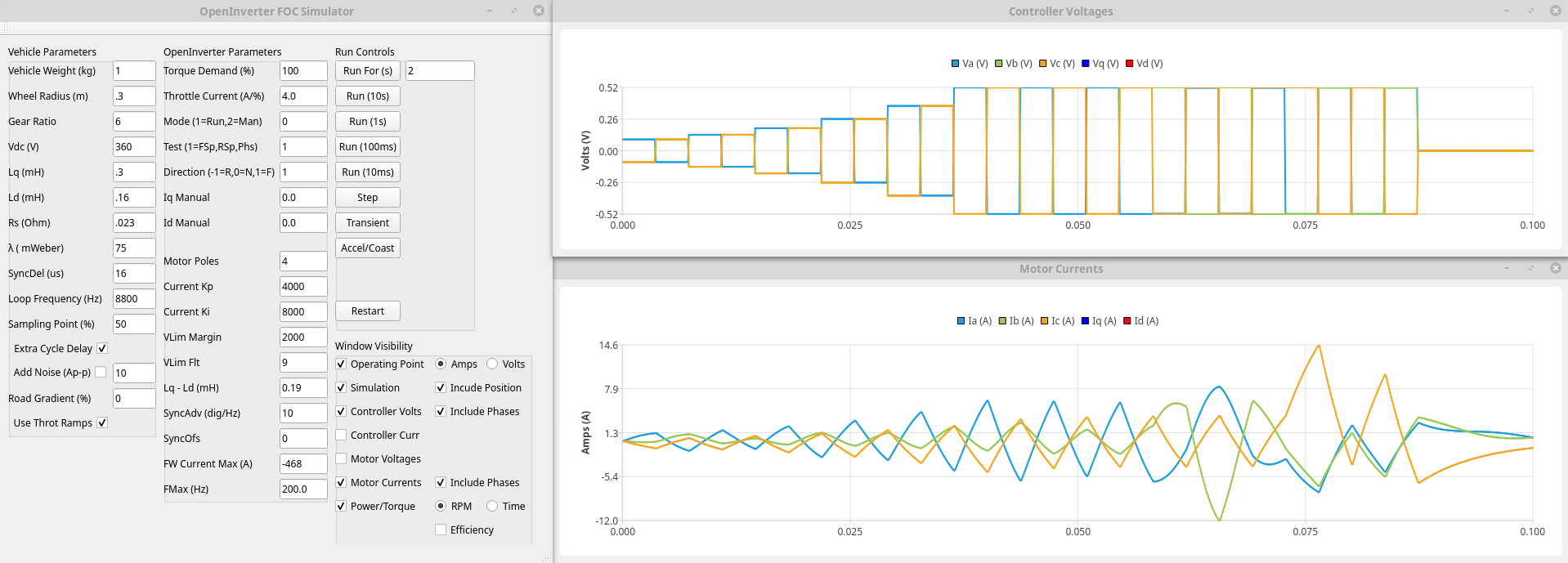

Finally got back to having a look at the automatic detection of the CT vs IGBT phasing/polarity.
The initial idea didn't work too well - essentially performing the measurement quickly means that the motor inductance adds phase lag to the current which messes up the measurements. Doing it slowly means you can ignore the inductance but allows the rotor to start to move which also invalidates all the results. Was about to give up when I realised I was being a bit dim - the trick is to do it quickly but then use the rate of change of current rather than the absolute value (a positive signal on phase 1 should cause the current on phase 1 to ramp up). This has the advantage that it works whether the rotor is free to move or locked.
Only run in the simulator so far bit it seems to work. Plot of the measurement process:
The first bit where the voltages are ramping up is the firmware trying to find a safe level to perform the measurement. It tries to use the smallest PWM value that will give 5A measurement current. It also trips out if any phase current exceeds 20A. It then generates phase voltages with the rotor field at 0, 120 and 240 degrees and looks to see what the currents do. The current waveform doesn't make a lot of sense unless you look at rates of change rather than amplitude.
Currently the results are only available via the debugger and look like this:
Could be clearer but you can see that:
On check 1 (c1) only phase 1 (p1) is positive
On check 2 (c2) only phase 2 (p2) is positive
On check 3 (c3) only phase 3 (p3) is positive.
Which indicates that the phasing is correct. Eventually this will be presented as described in the above post.
The idea mentioned in the last post about checking current ratios doesn't really work because of motor saliency and variable rotor position.
Still need to test it on a real motor but it's looking promising.

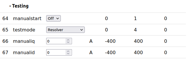

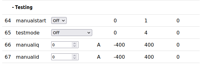

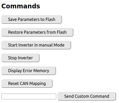

Had a first go at an inverter/motor setup using the new technique and so far it seems to work quite well.
Basically I've reintroduced the manual run mode which now has 4 modes of operation. I'll cover each in a separate post as it's probably a bit long to do all in one. In this one I'll just cover the basics.

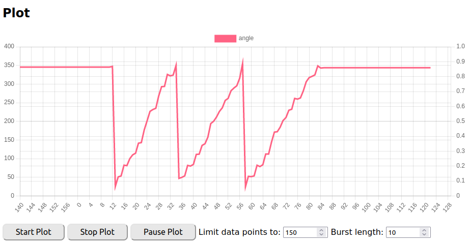

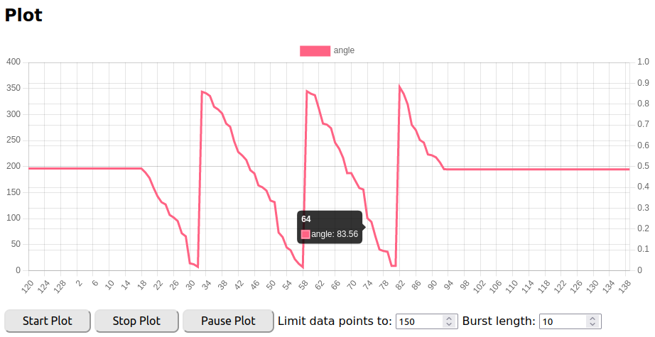

First up Resolver testing. To use you first go to the Testing section of Parameters in the web page:
Change 'testmode' to 'Resolver' (note this parameter always defaults to off on power up):
Then go to the commands section and hit 'Start Inverter in manual Mode':
You should see this in the Messages section of the web interface:
This will start sampling the resolver but without starting the PWM (so there is no power to the motor). The motor shaft can then be rotated while plotting the 'angle' parameter so see the result. You are looking for something like this:
Now this is with the motor being turned in my notional forward direction but it can be seen that the angle is decreasing. To fix this swap the wires on either the sin or cos resolver connections to get:
Final thing worth noting. If the motor and resolver pole pairs are both set to 1:
Then this plot can be used to determine the resolver pole pairs. On the above plots you can see that a single rotation of the motor shaft gives three rotation on the plot so this resolver has 3 pole pairs.
The resolver pole pairs should then be set to the value found. If the resolver came with the motor then safe bet is to also set the motor pole pairs to the same value (later steps will check whether this is correct).

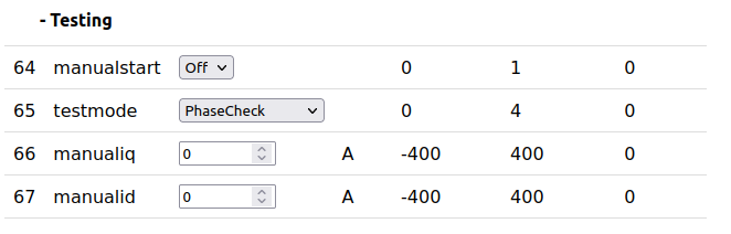

Next is the PhaseCheck.
This is used to make sure that the CTs are on the correct PWM phases and that their polarity is correct.
This test needs a HV supply to be connected although it doesn't actually need to be high voltage, I'm using around 20V. The udc parameter also needs to be reading correctly (udcofs and udcgain correctly set) as it uses the value to scale how much PWM value is needed to achieve the desired motor voltage (the higher the voltage the smaller the PWM value for the same motor voltage). The ilxgains should also be in the right ballpark.
First change the testmode to PhaseCheck:
An then 'Start Inverter in manual Mode' as before. This will start the PWM up, perform the test, disable the PWM and then the result will be reported in the message are of the web interface. At the end of the test the inverter opmode will be back to the Off state.

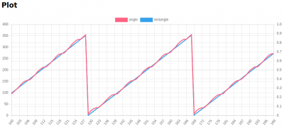

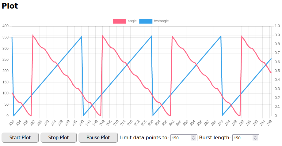

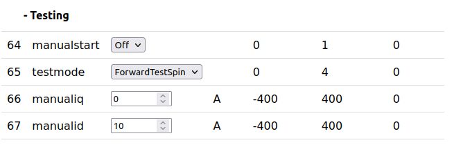

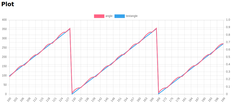

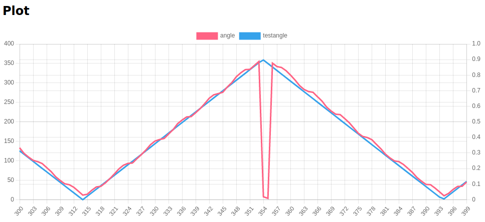

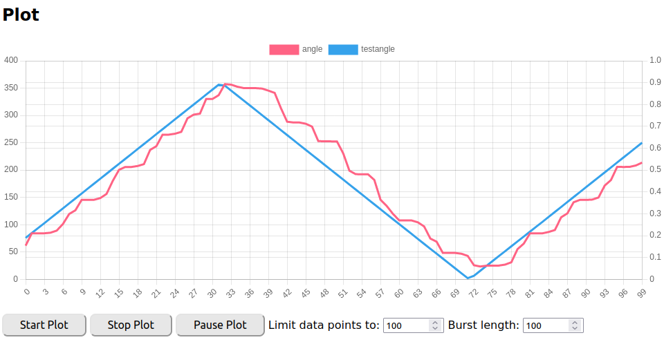

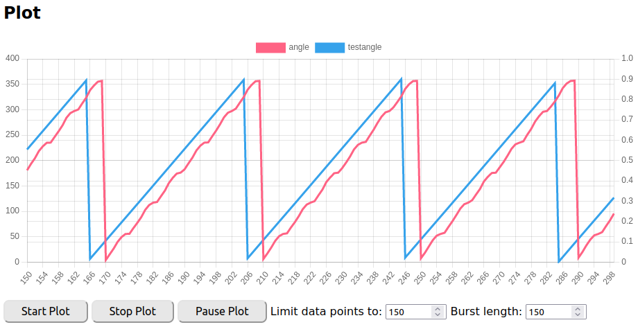

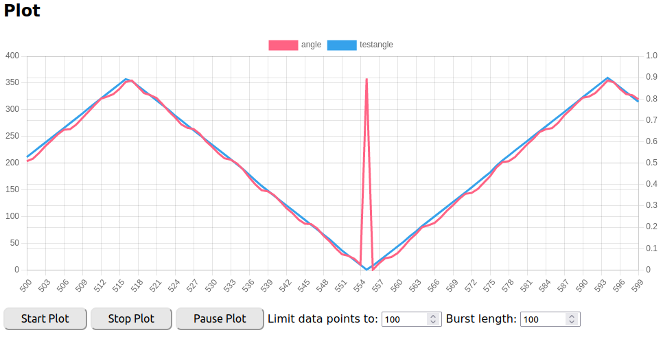

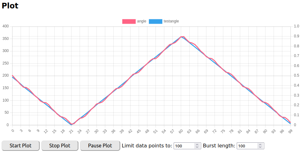

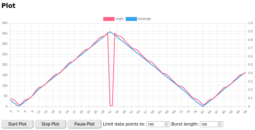

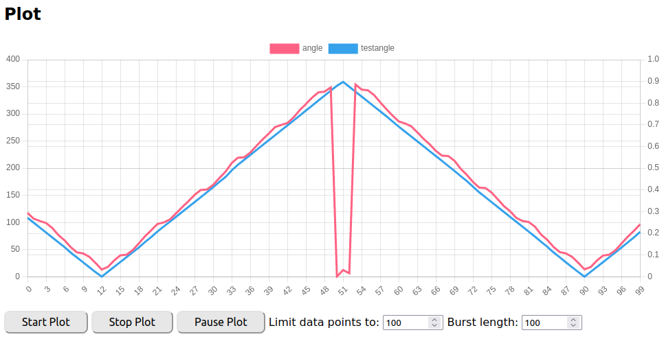

And finally syncofs tuning using the ForwardTestSpin and BidirTestSpin modes.
These modes simply run the motor with pure D current but very slowly so that the motor has time to align itself closely to the field. In this mode the torque is pretty limited so it's best done with the motor shaft isolated from any gearbox or clutch.
The first mode to use is ForwardTestSpin. It is selected in testmode as before, the value of Id to be used is set (10A seems a safe starting value):
and then start the inverter in manual mode as before (note the inverter will continue to run in this mode until stopped using the Stop Inverter button).
The motor should turn slowly and on plotting 'angle' and 'testangle' something like this should be seen:
Now the thing to check on this plot is that the two plots move together, they clearly don't on this one and that is because the motor is actually spinning backwards! Swapping two of the motor phases and re-running gives:
The plots are now moving together and are parallel to each other. If they are this is an indication that the ratio of motor poles to resolver poles is correct. If the resolver poles have already been set in the resolver step you can be confident that the motor poles value set is also right. If one trace is moving faster than the other adjust the motor poles till the pair move together.
There is still an offset between the two. This is because syncofs hasn't been set up yet. To do that just measure the vertical separation between the two plots using the web page cursor. I measured 198.71deg for angle and 236.06deg for testangle. The difference here is 37.35deg. This needs to be multiplied by 65536 (syncofs for 360deg) and then divided by 360 to give the value for syncofs. So 37.35*65536/360 = 6799, call it 6800. Now because the angle is lagging testangle this value needs adding (if it was leading it would need subtracting) to whatever value was in syncofs (ideally 0) when the above test was run. So setting syncofs to 6800 and re-running gives:
Much better but not quite there yet. Because of the low torque on the motor in D only mode any drag on the rotor will cause an offset. To try and address this the BidirTestSpin mode is used. To use stop the inverter, change the mode and restart. On plotting again this is seen:
This looks reasonable but it can be seen that on the forward rotation the angle is actually leading slightly and on the reverse rotation the angle is lagging. This is because the measurement above is compensating for lag in one direction but making things worse in the other. To show the effect reducing the D current from 10A to 2A makes things worse:
The lower torque means more lag and it angle is now lagging in both directions. To minimise this the D current is increased a bit to 15A (in real life you could go a lot higher but I'm running this from a bench PSU) giving a new baseline plot of:
The next thing is to swing the syncofs value by 1000 in each direction and see which way helps. So increasing to 7800 gives:
And decreasing to 5800 gives:
So 5800 is better. Going another 1000 down to check - 4800:
Worse again so 5800 is the optimum value for syncofs.
